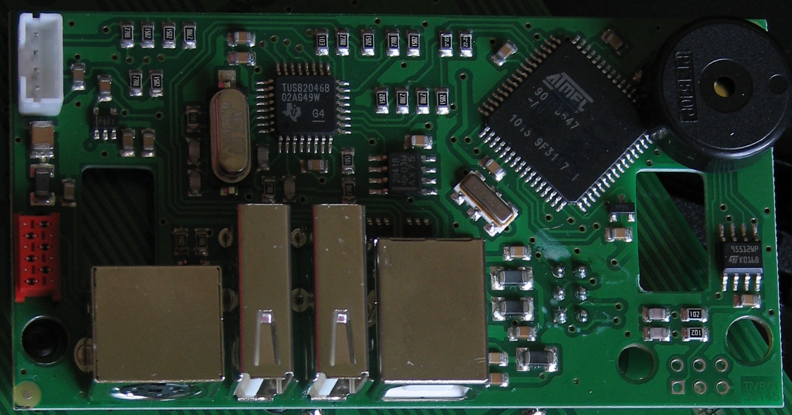

Posted: 14 Jun 2012, 20:16
by Soarer
Where's that from? Looks pretty good already!
Posted: 14 Jun 2012, 20:19
by RC-1140
That's apparently an USB Tipro Controller board. I wish I had an USB one too. I only have two PS/2 ones.
Posted: 14 Jun 2012, 20:26
by Soarer
Ah, right. Yeah, that would need some rework :ugeek:
Posted: 14 Jun 2012, 22:26
by Maarten
Well yeah, would need quite a bit of work actually but at least it has something very close to your beloved AT90USB128x ;)
Posted: 14 Jun 2012, 22:41
by Soarer
x?! The good bit is the 7!!!
AT90USB647 would be fine too, but seems even more rare than the '1287.

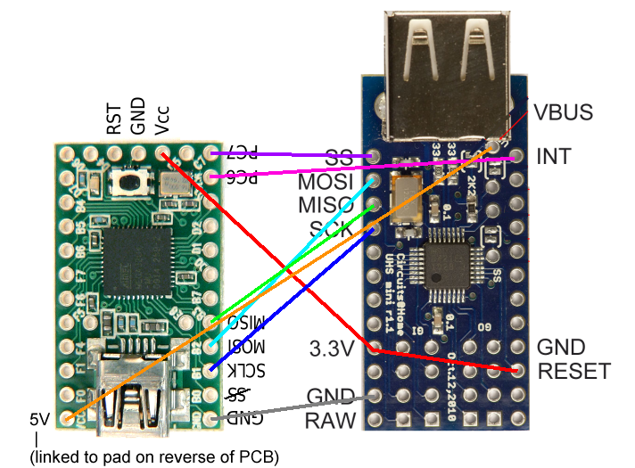

Heh, I hadn't seen this (since it's in the teensyduino section): teensy + usb host shield.

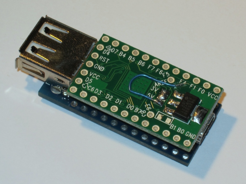

Posted: 23 Jun 2012, 17:48
by Soarer
These two fit together really nicely...
Note: to put that link on the back (so that one of the Vcc pins is still +5v) requires cutting the PCB track to that pin first.
