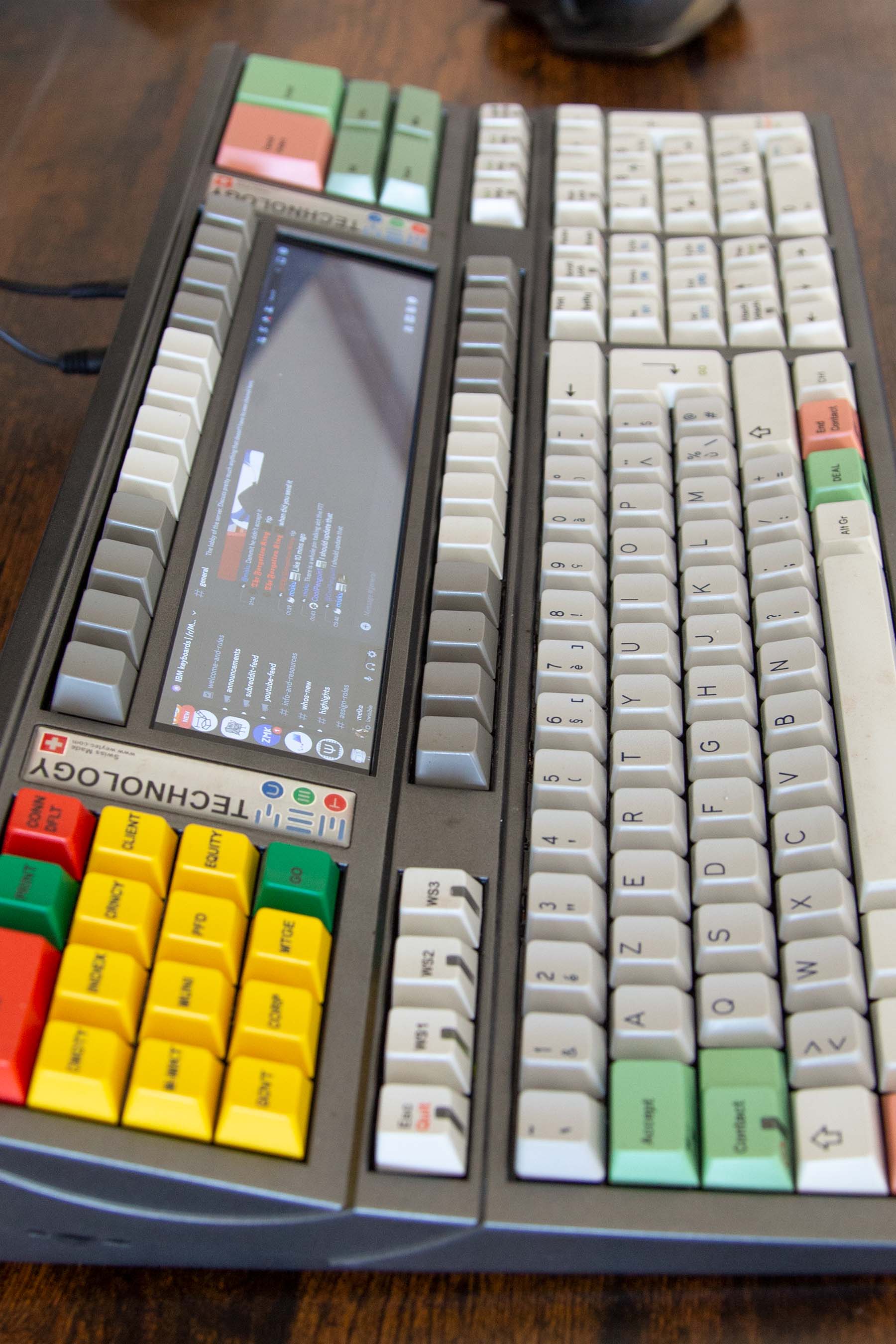

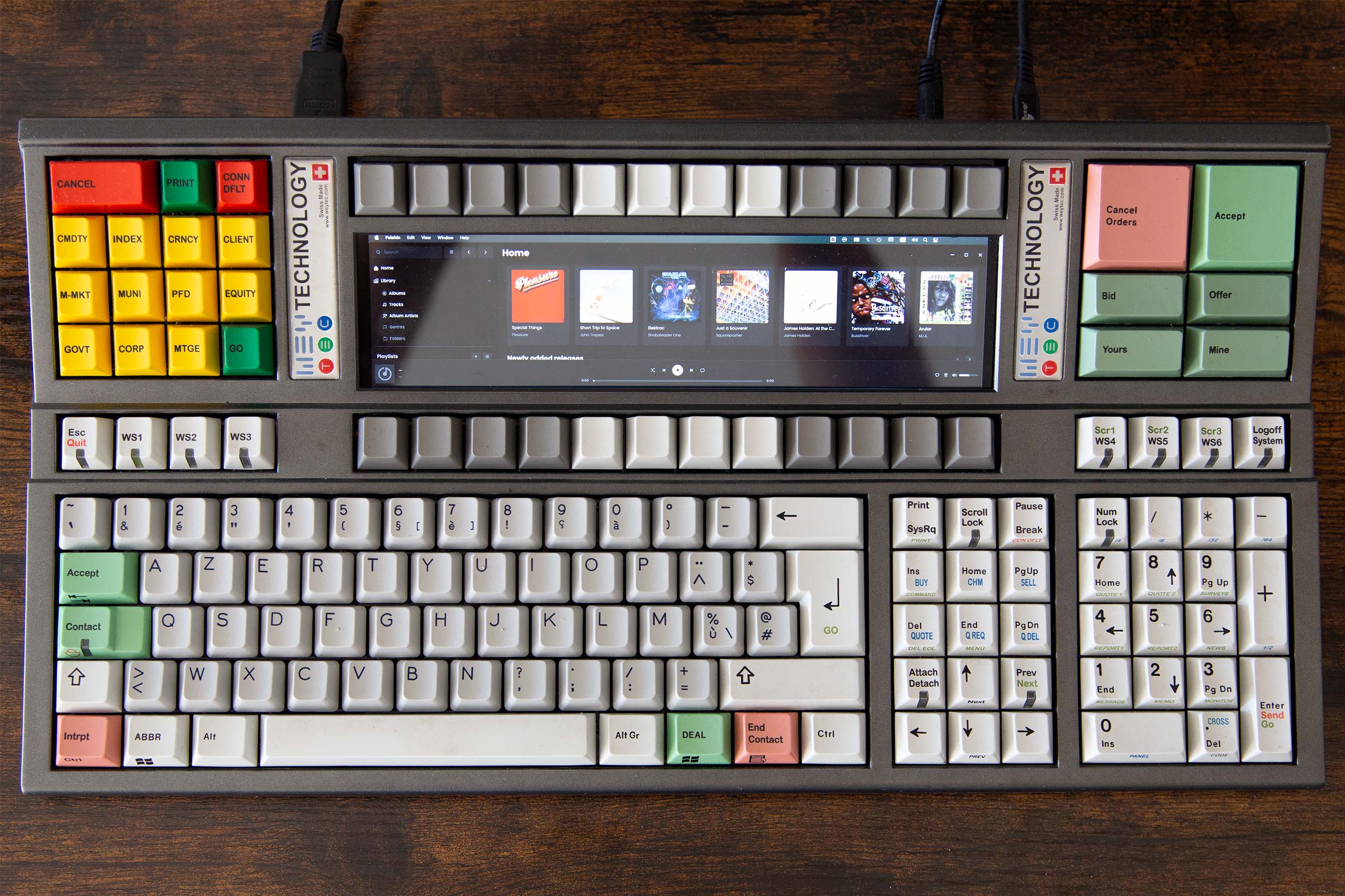

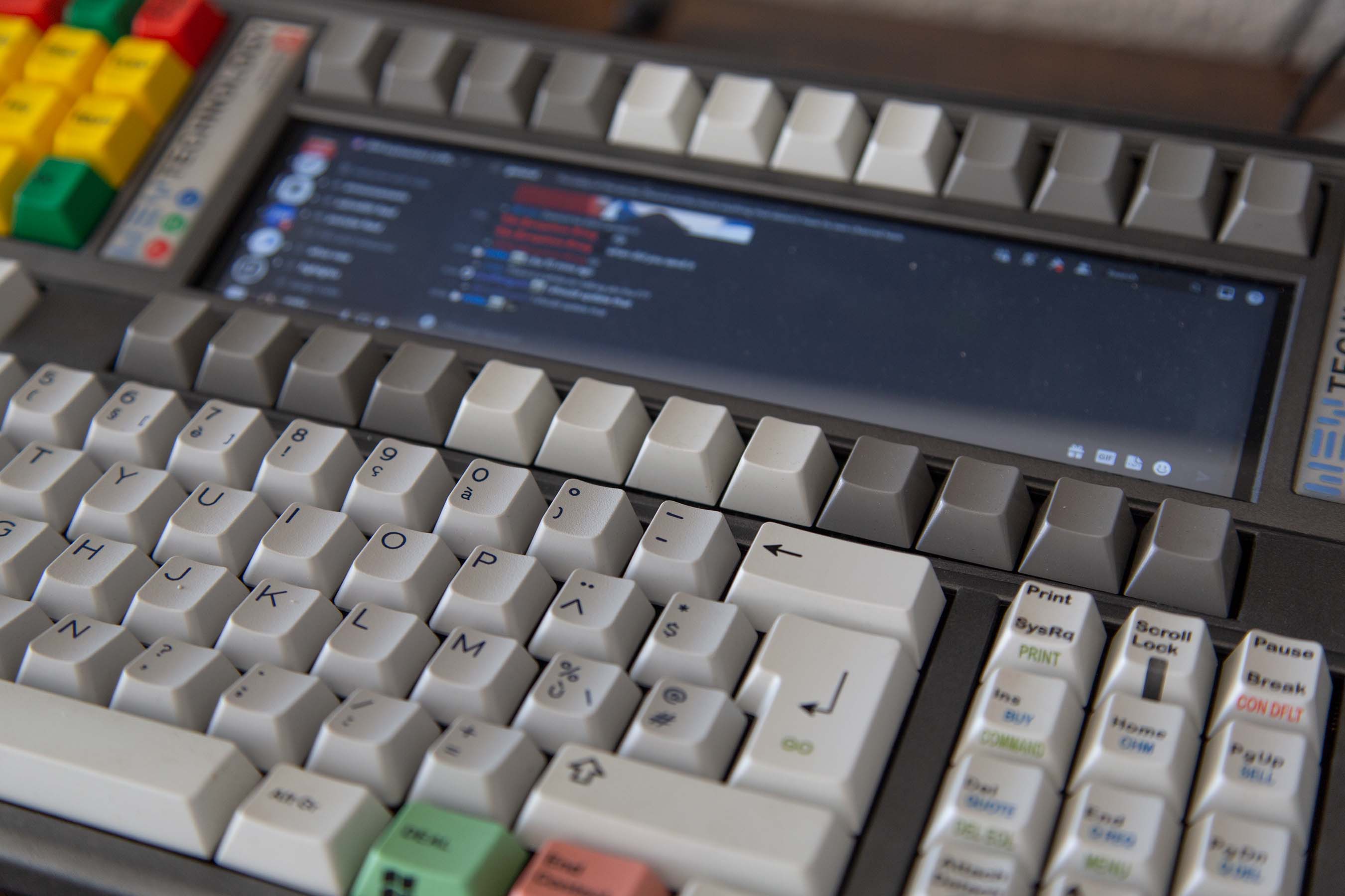

Thanks to the awesome work by @MMcM, I was able to get my MK06 working without the external converter.

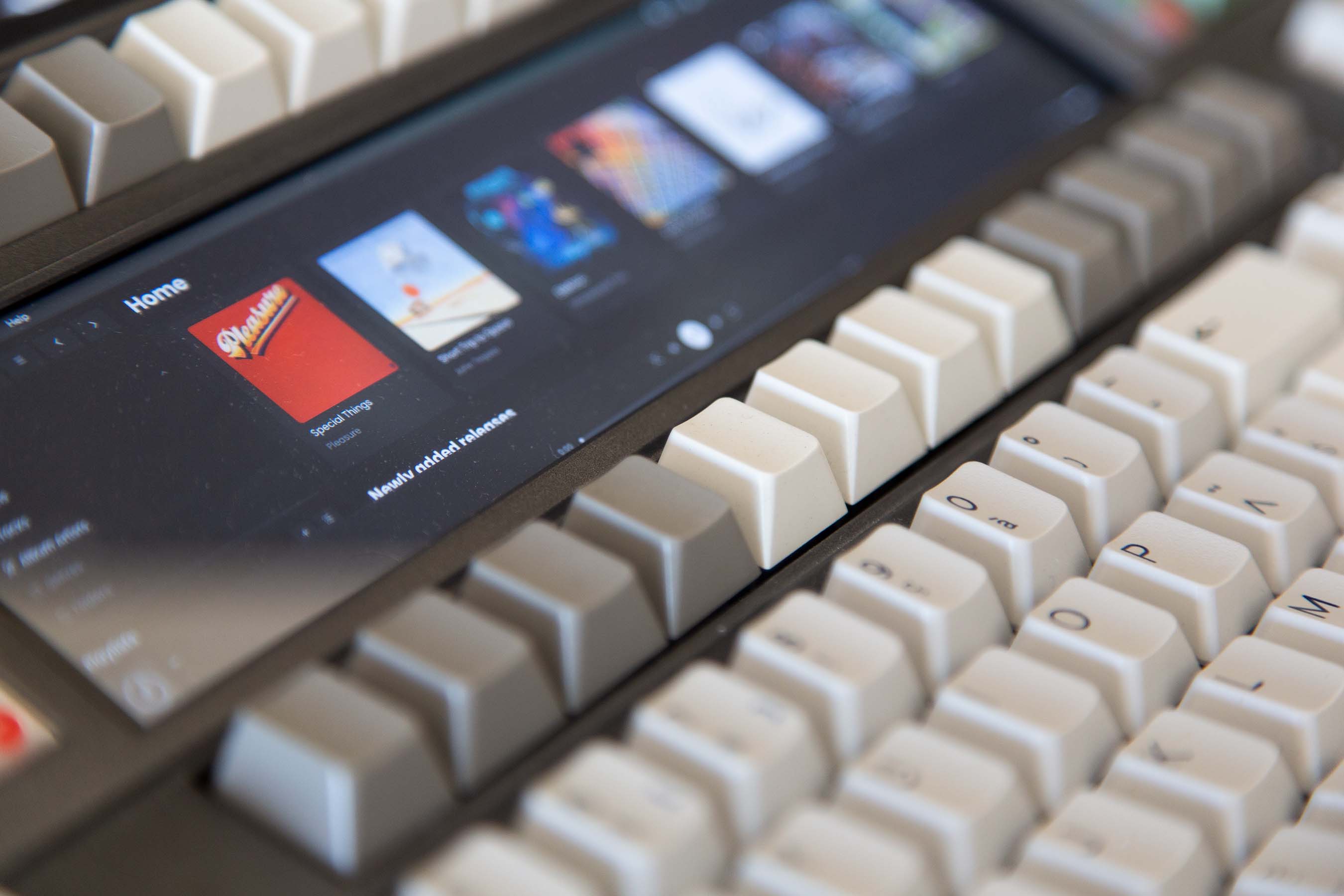

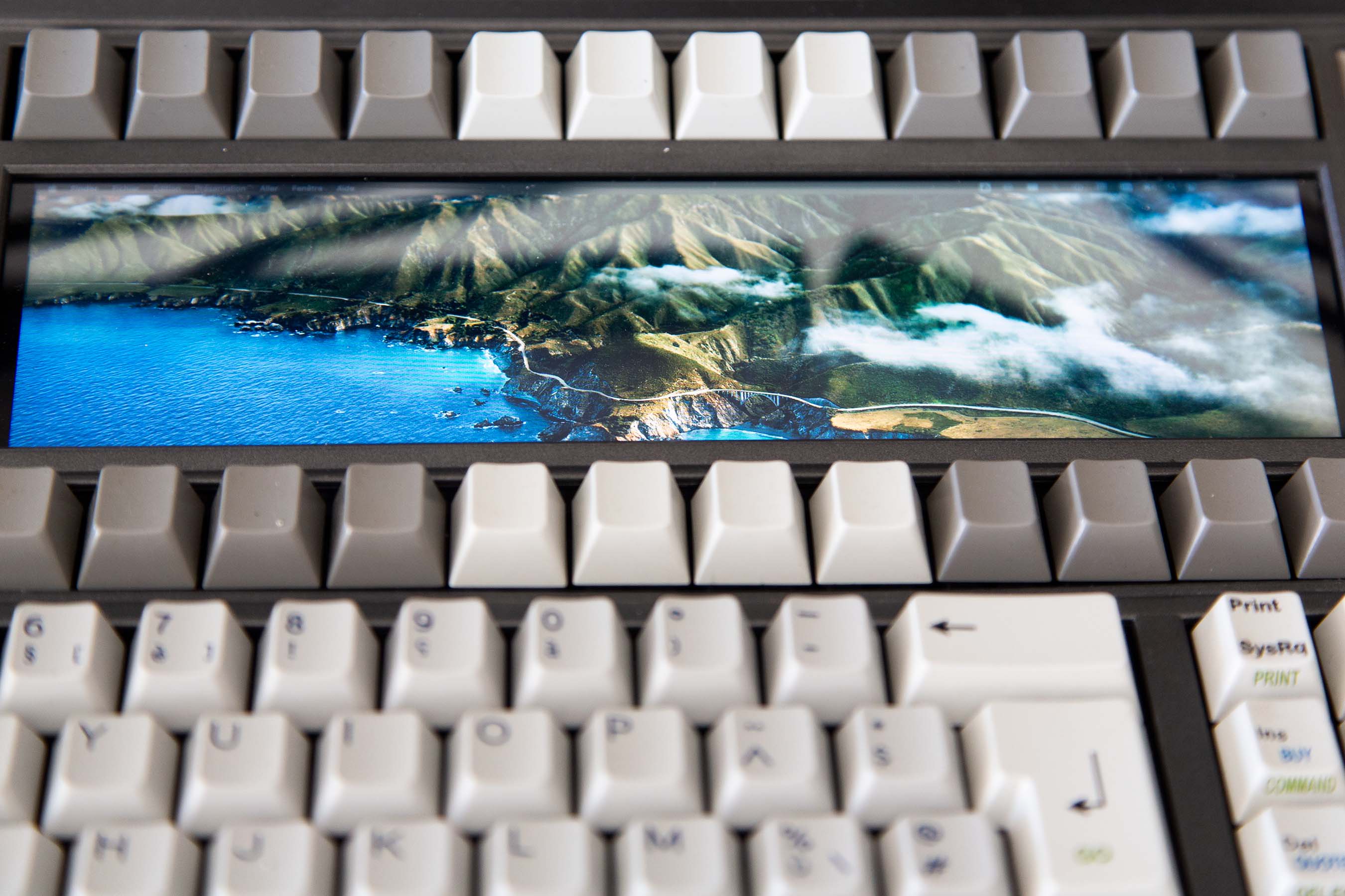

To celebrate, I changed the weak LCDs with a big IPS HDMI panel. This way, the screen can just display whatever I want instead of the Weytec stuff. A few 3D printed parts hold all that in place, and a couple of cutouts in the back to add the new ports and we're good.

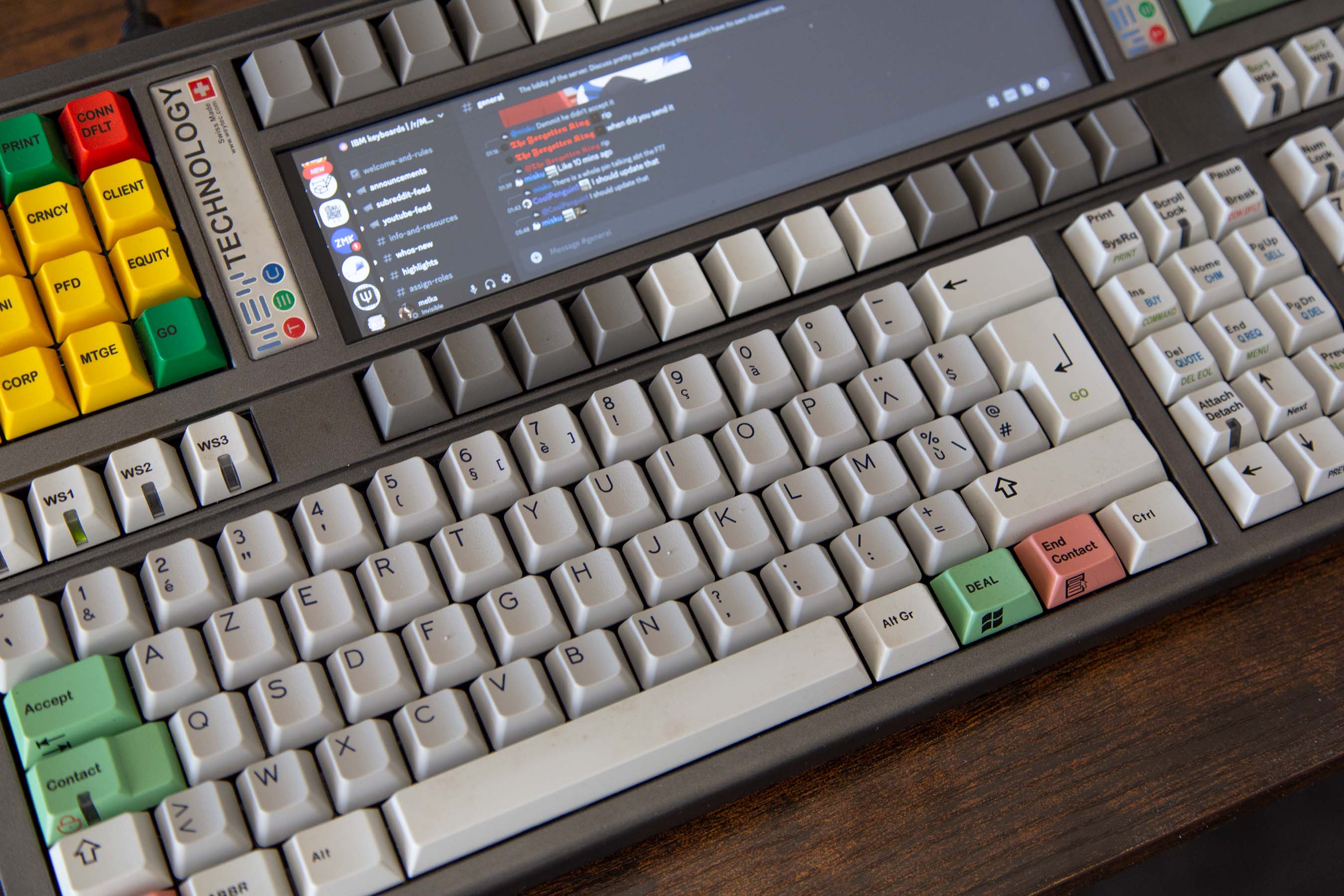

I swapped the alphas with Wyse DCS caps for AZERTY layout.

And here's the github link for my atmega32u4 & vial port of the awesome work done by MMcM, hope it can help someone in building a converter.

I’d try to use the 24 (currently) blank keys around the display to drive its interface, as their presence there is crying out for just that use. Quite a software design job to implement, though, so you’re forgiven the placeholder keys.

the blanks keys are the original ones, what you're describing is what wey originally did on the puny original LCDs :) I've been thinking about what kind of "software" I want permanently on that screen, no idea for now, but it shouldn't be too hard to write a simple "app launcher" or something.
btw the screen is touch enabled, so I can either just tap the screen or use the buttons :)

I had a couple people ask for commission or selling, and my answer is "I don't mind, but it's gonna cost around 400€ on top of materials and donor keyboard, because this is kind of a hack job and making sure it's solid and well built for a customer would take many hours"
However I posted more infos on how to make one on github.
https://github.com/melka/mk06_lcd_mod
This repo is for the "mechanical" stuff, not a lot of photos but it's not that hard.
There's the repo in my last post for the pro micro converter too.
As for the keycaps, I changed the alpha blocks from the original Weytec / GMK qwerty caps for Wyse azerties.
