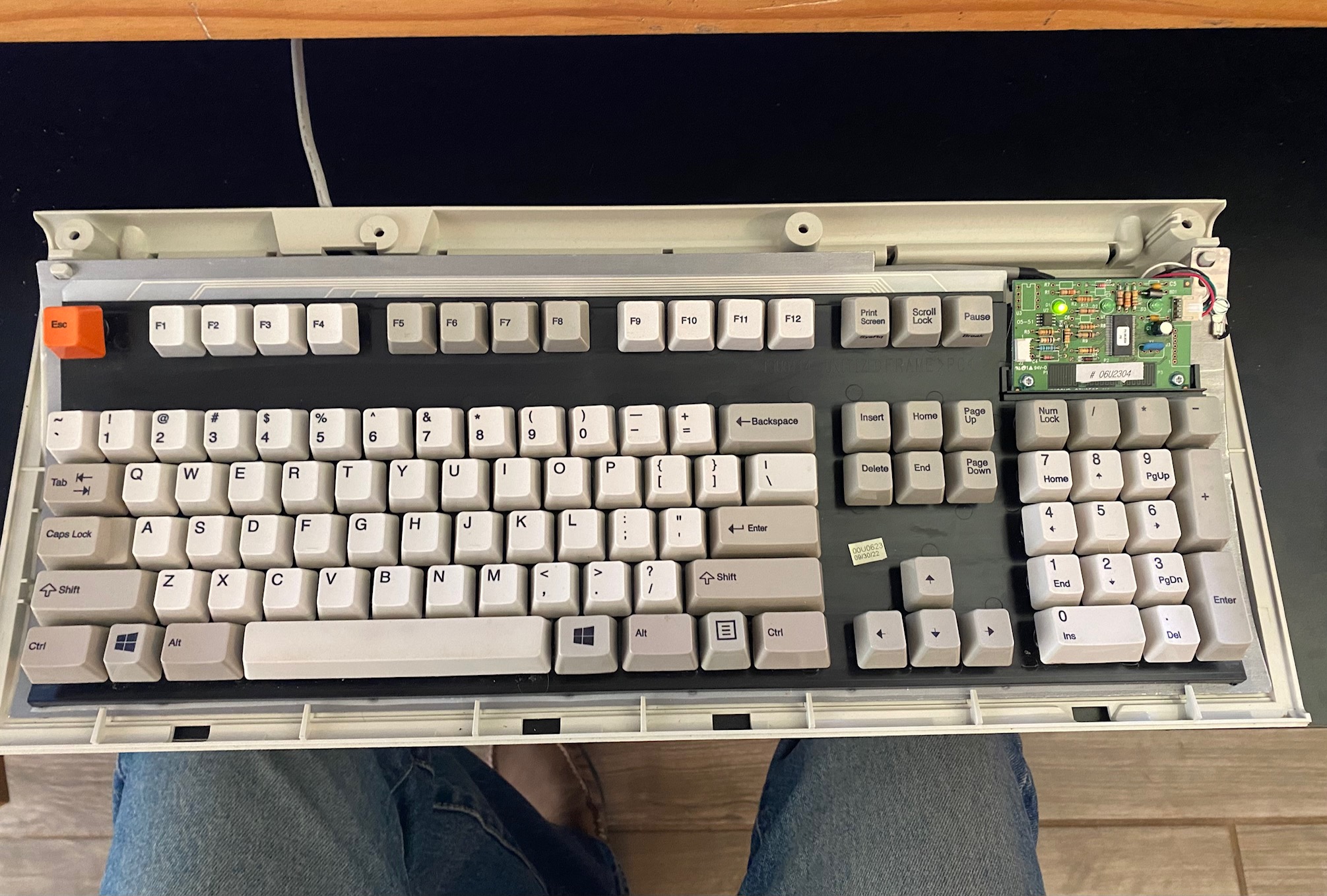

Follow up on this strange speaker hole in my Unicomp keyboard. Finally opened it up. Defiantly appears to be a new old stock part (1399053). Apparently the bottom of a Model M Terminal Keyboard.
Labeled IBM inside and feels like PVC. Has a different feel than the top of the keyboard.
Here are some photos.
