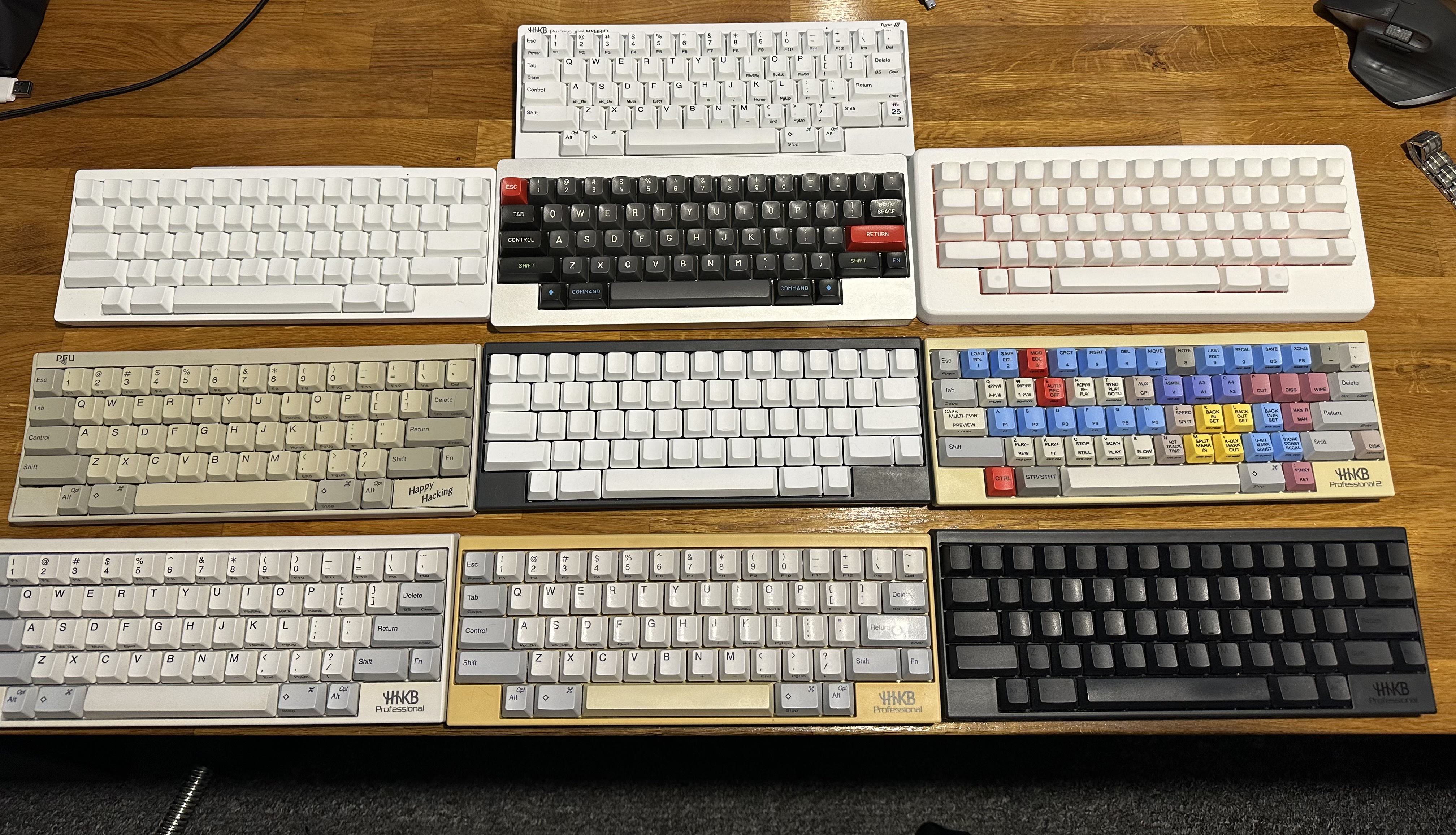

Surely it’s only hoarding when they no longer fit on your desk? As it happens, I am safe at the moment.

That collection is BAD ASS!!!
