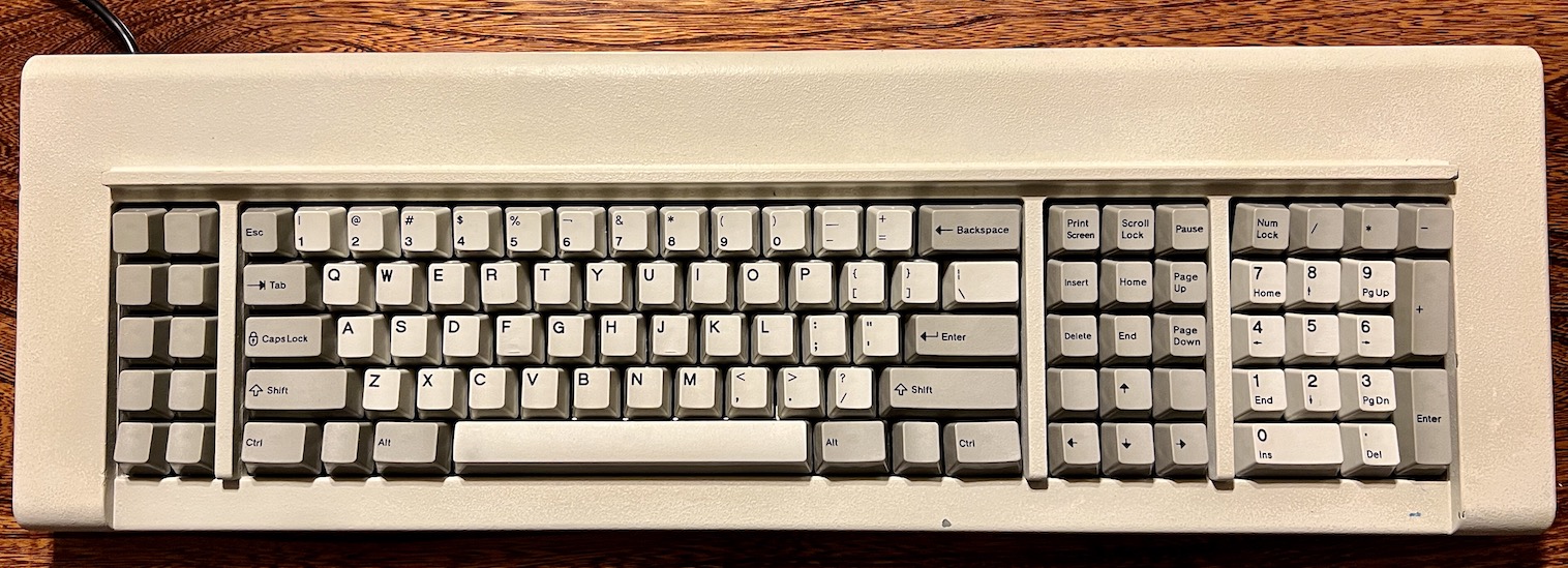

This is description of my process restoring a 1985 IBM F107. For reference this keyboard is from the IBM 4704 terminal computers used at banks in the 1980s. You can find more info on the 4704 keyboards here: http://kishy.ca/?p=648
I have reproduction F77 and love it but also need a full size keyboard with a numpad. This was on my “white whale” wish list and I was fortunately able to get one. This isn’t a guide but I hope you find it useful. I relied on others experience for help and you might also find them useful:

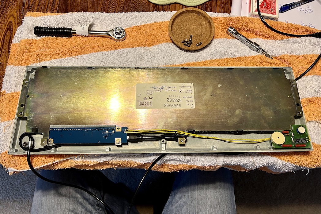

Once the screws are off the back case can be removed:
There’s another hex screw holding the cable coming from the controller and after that’s removed the inner assembly can be removed.

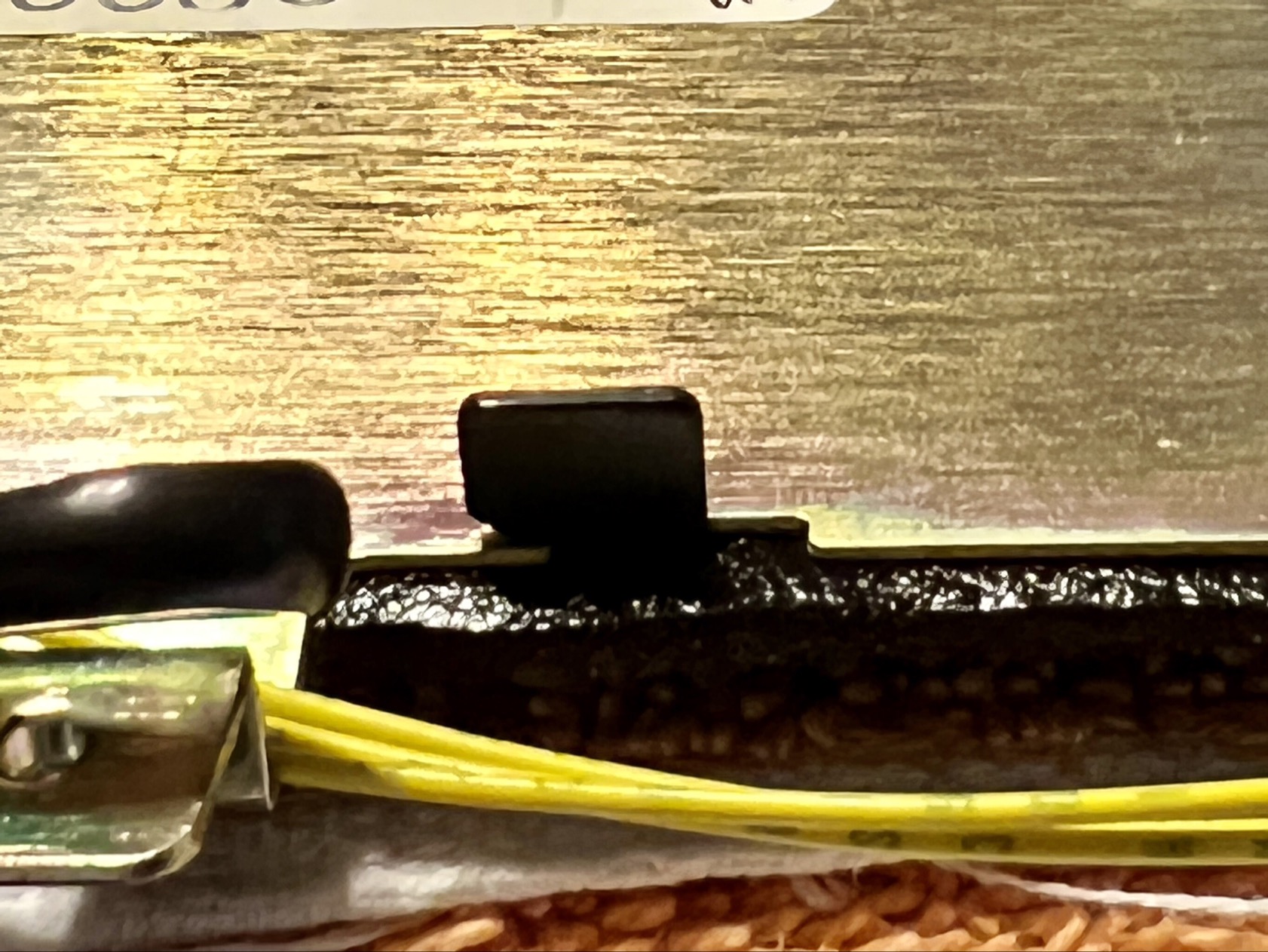

The barrel plate was pretty dirty. I suspected the foam was in bad shape, so the barrel plate would need to be removed.

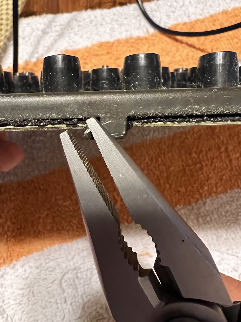

The barrel plate is secured to the back plate with locking tabs that slide together and one that’s bent down onto the back plate.
Sliding locking tabs:
Bent locking tab:
I used a pair of needle nose pliers to bend the locking tab back:
After the locking tab was bent back the barrel plate needed to be pushed away from the sliding tabs. I put a large flathead screwdriver in between the barrel plate and backing plate that rises to secure to the case and twisted to easily push the barrel plate away and slide it from the locking tabs:

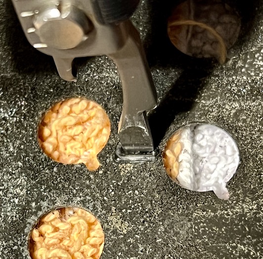

I opened the assembly and could see the original foam was in pretty bad shape:
The foam is interesting in how shiny it appears. Closeup of the original foam:

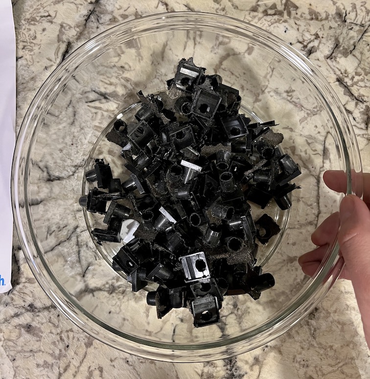

Next I removed all of the flippers and barrels:
I decided to clean the barrels the same way I cleaned the keys using denture cleaning tablets:
I added the tablets first, then the barrels:
Then water to created a nice, bubbly barrel soup:

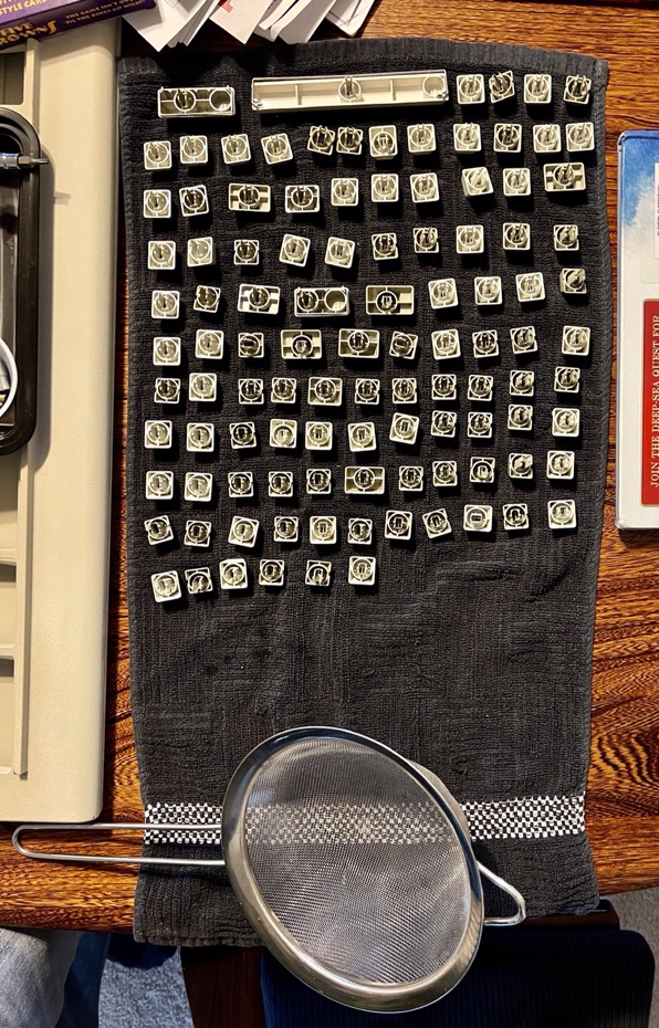

I let the barrels soak for an hour or so and noticed the foam didn’t completely come off, so I used an old electric toothbrush to remove the remaining foam. I used an old baking tray to keep track of the barrels:
It was tedious and took a long time to clean them all, but the barrels were just like new after:
Then I let them dry near an open window:

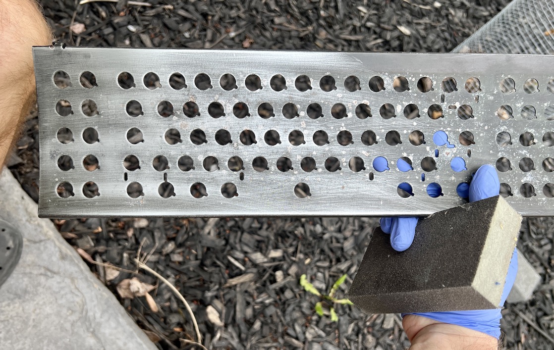

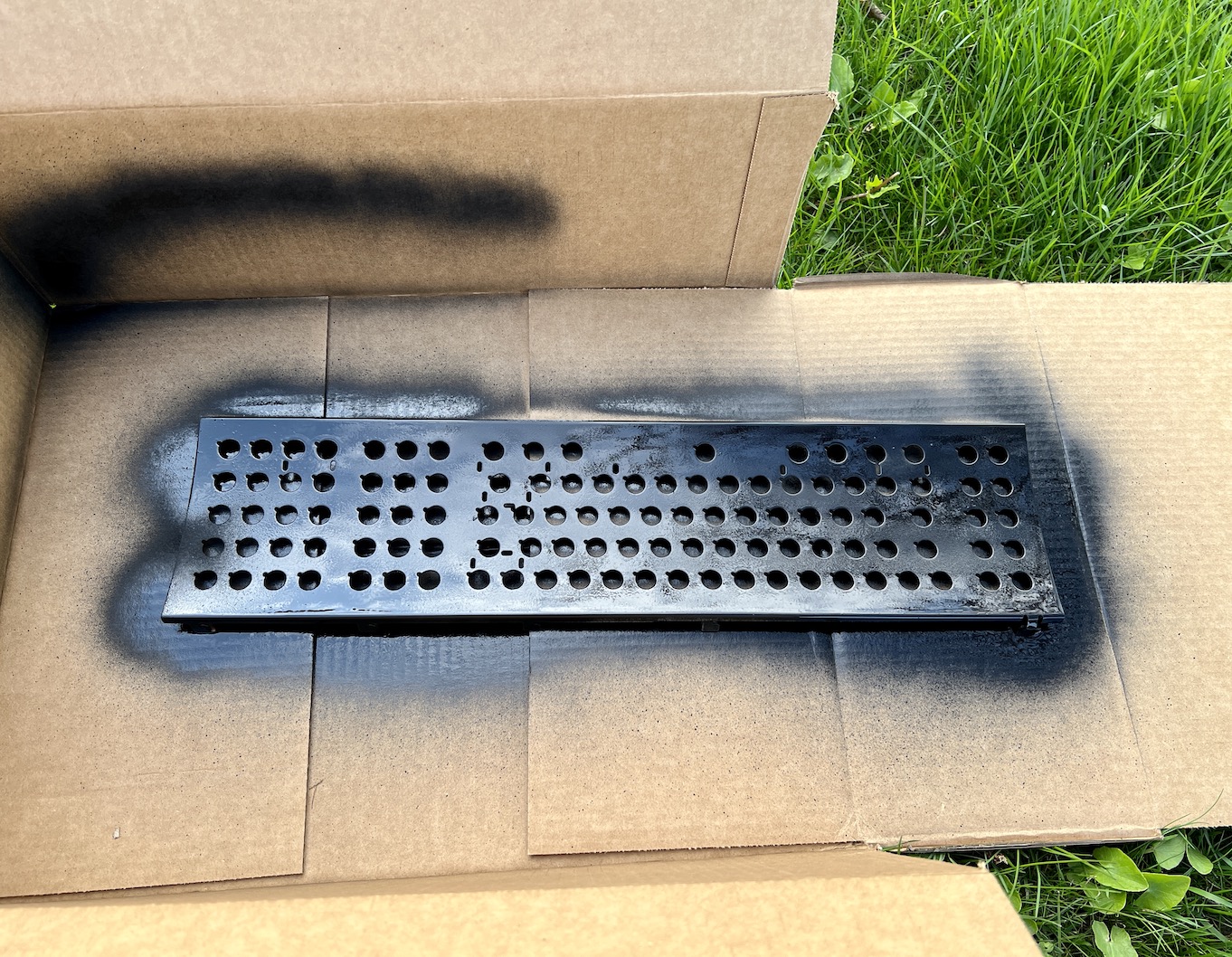

Next I cleaned the barrel plate, running it under water and using a scrubbing pad to remove the remaining foam and debris:
The barrel plate was clean, but showing signs of corrosion and pitting. It needed to be painted so next was sanding to prep for paint.
I used a rough (100-120 grit) sanding block to get the original paint off and any rust.
I kept sanding until you could see mostly metal.
The corrosion was more apparent after the sanding.
I chose Rust-oleom Rust Reformer because I had it laying around in the garage and it seemed like it would work.
I sprayed several coats, waiting a day after each coat based on the experience of another person’s restoration, to ensure a good seal.
After a few coats it looked brand new!

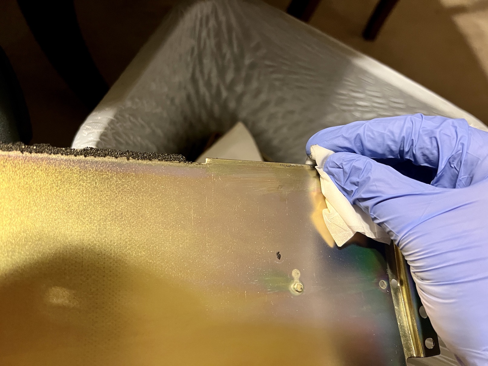

I then cleaned the foam on the back plate with an alcohol pad.
Along with the PCB. Note: I learned on a Focus keyboard using less than 90% alcohol results in an opaque film on the PCB. I don’t think the film damages the PCB, but I recommend using a higher concentration to be safe.

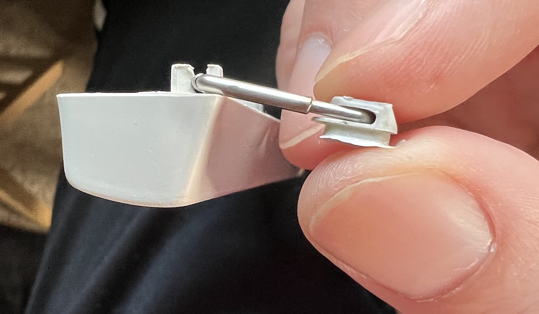

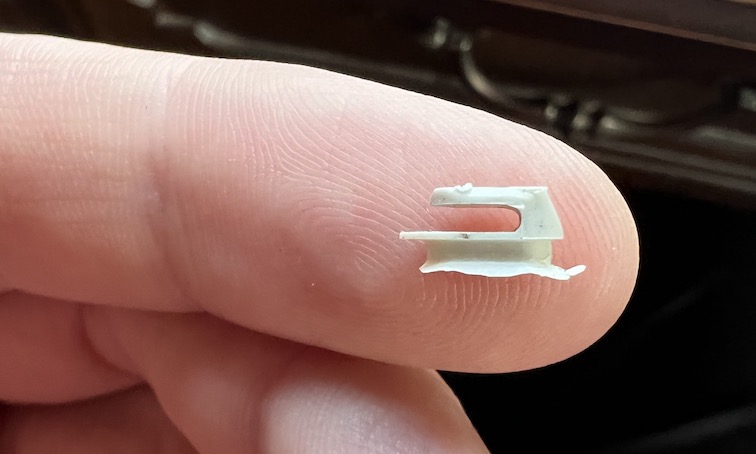

Next I reinstalled the spacebar stabilizers. These are plastic, old and might not survive the reinstallation, so I recommend having a backup plan. My backup was to use steel spacebar tabs from the New Model F project. These would need to be glued to the barrel plate but would be a good replacement. You could also make your own by bending a small steel tab and gluing it to the barrel plate, or 3-D print a “U”.
https://www.modelfkeyboards.com/product ... tabs-pair/
The F107 spacebar stabilizer wire has a shorter height than the Model M, so I recommend keeping it unless you can install new stabilizer inserts.
The Model M stabilizer wire is thicker, and can’t be used with the original stabilizer inserts:
The original F107 stabilizer is made of several parts, with thicker pieces attached to the end to fit the spacebar.
The thicker piece allows the wire to fit in the original F107 and new Model M spacebars.
I installed the inserts without breaking them by fitting a small flathead screwdriver into the insert and pressing down into the barrel plate.
Bent locking tab:

I was using a key set from the New Model F project and it came with its own stabilizers which ensures compatibility, but I wound up having one issue with the + key. My fix was to use rubber bands to offset the barrel a bit which gave it the right orientation and allows the key to work perfectly.
Finally it gets all buttoned up and is ready to go! I’m using the xwhatsit software to define keys and have had no issues.

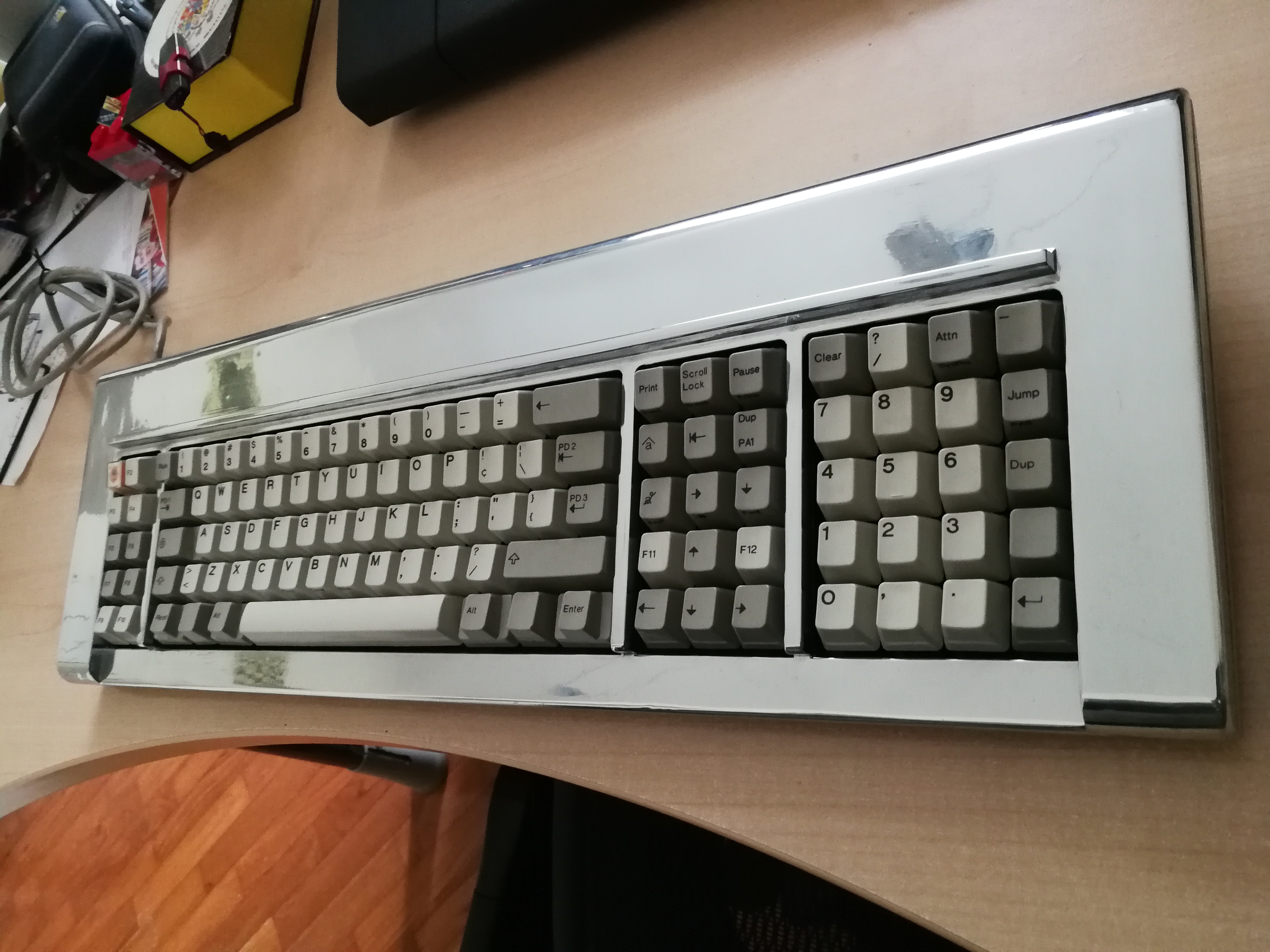

I gave a quick glance to your post, promising to myself to deep in later and i liked your job. Well done and welcome to the F107 club, my most satisfying model F.
Mine went to the chrome-plating shop.

Nice job, and curious to see that fix with the rubber bands. I would suggest using polyurethane plastibands instead, as the rubber ones will wear off and release the pressure pretty quickly.

I've worked with plasti dip before. It is really forgiving stuff. That's some really old paint that looks like it is already chipped in at least one place though. I know I wouldn't risk making it worse myself.thefarside wrote: 14 Jan 2023, 15:04 I’ve considered painting mine and ordered a set of dark grey caps from ellipse thinking I’d go for an industrial look, but don’t want to alter the original paint because it’s in good shape. I wonder if I could use something like plasti dip to have a new color but preserve the original paint?
Just because I installed the dark grey keys and the contrast was a little too much for me![]()
If you wait a few decades, yours might be the only beige one left. lol
inmbolmie is right about the rubber bands. They're going to turn into goo eventually.
- thefarside
Thanks I'll switch to polyurethane bands. I don't want any surprises if/when the rubber bands go. I'm definitely going to preserve the paint, but I might look into plasti dip if it's safe. If not it'll stay original.

Love the fresh look of a painted barrel plate. An often overlooked detail that you don't really see once everything is put back together. Also it looks like I am going to need to find more clamps...
- thefarside
You never know. The 4704 keyboards were exclusively used by banks which makes finding them very difficult. Although one user found an F77 in a pile of garbage outside a bank. If I see treasure hunting opportunity I’ll usually check it out.Sheepless wrote: 17 Jan 2023, 11:52 I sometimes daydream about finding various keyboard unobtainium for cheap at a yard sale. Though I'm not sure I could ethically give a grieving widow pennies for her late husband's "garage full of junk" when it's actually worth a fortune.
