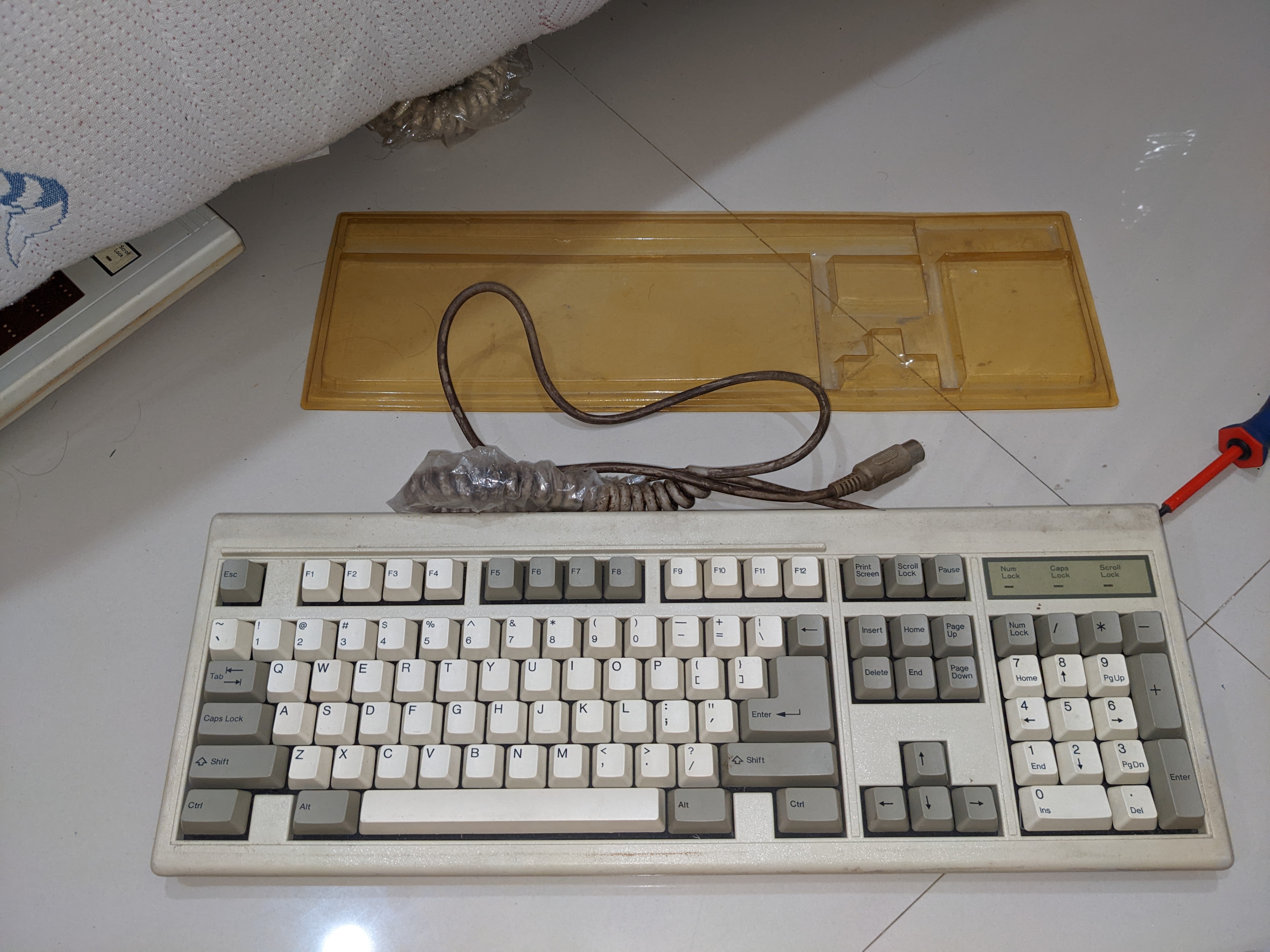

So i found this keyboard on a local online marketplace. From the few pictures the seller gave me, at first i thought it was an unbranded keyboard with omron whites, so i bought them since they looked to be in nice condition and even has the dust cover. A nice addition to the collection.
Keyboard
Keyboard

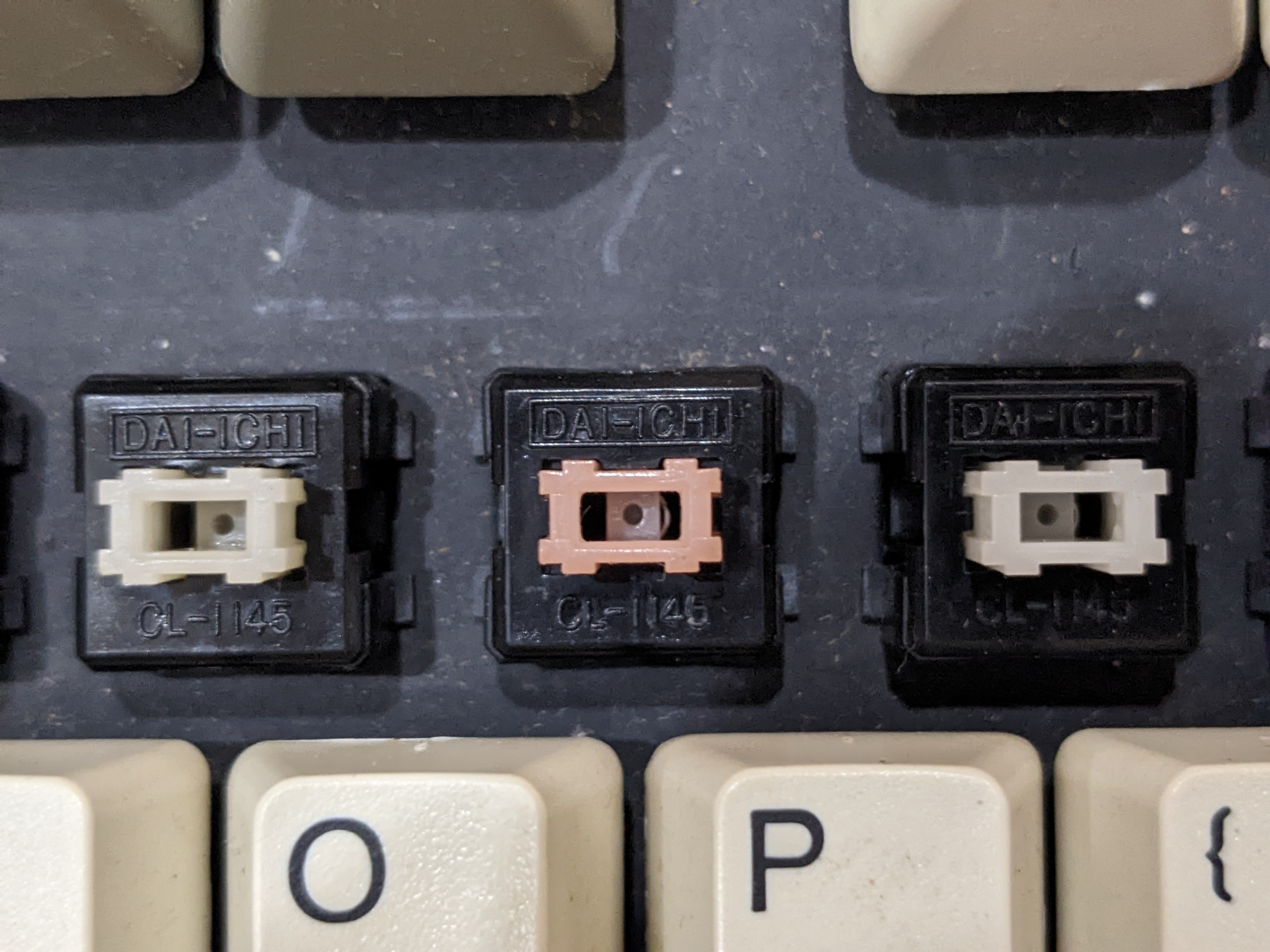

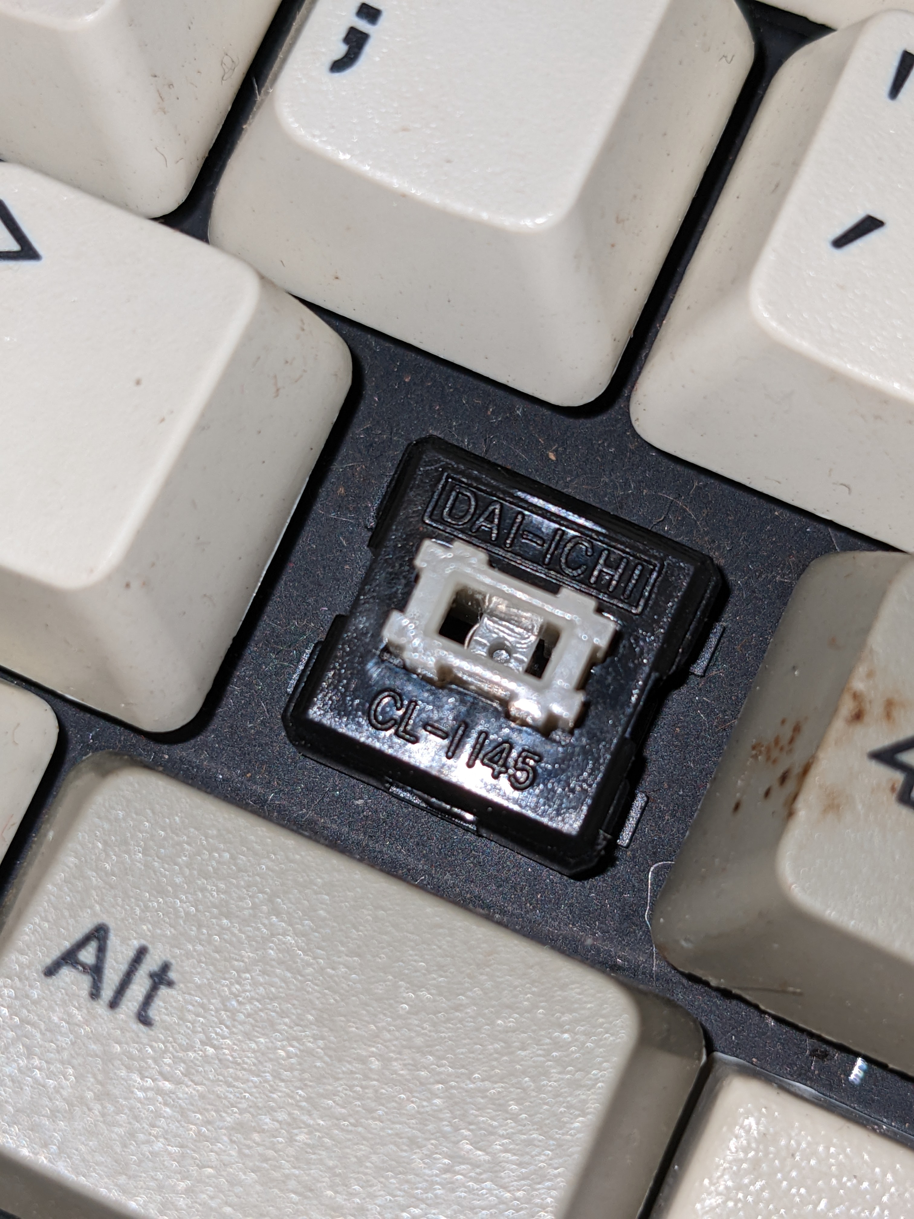

But when i open it up it was mostly some white dai-ichi cl-1145 switch!
I looked it up on the wiki and there isn't a full keyboard found with this switch yet, and I seemed to found a new variant so i decided to post it here.
The keyboard itself is a standard (slightly)cheap keyboard with so-so thickness on the case and a thick metal plate. The keycaps uses double shot abs and uses standard alps stabs (except for the spacebar which uses costar stabs)
Now for the switches, some of them are the white variant, but some of them are of a salmon colour. But when i open it up they were a gradient of white to salmon. I didn't notice a whole lot different from the whites, but I did notice a slightly deeper click and they are a very so slightly more tactile i think, but that might be placebo. The board has a random mix of them.

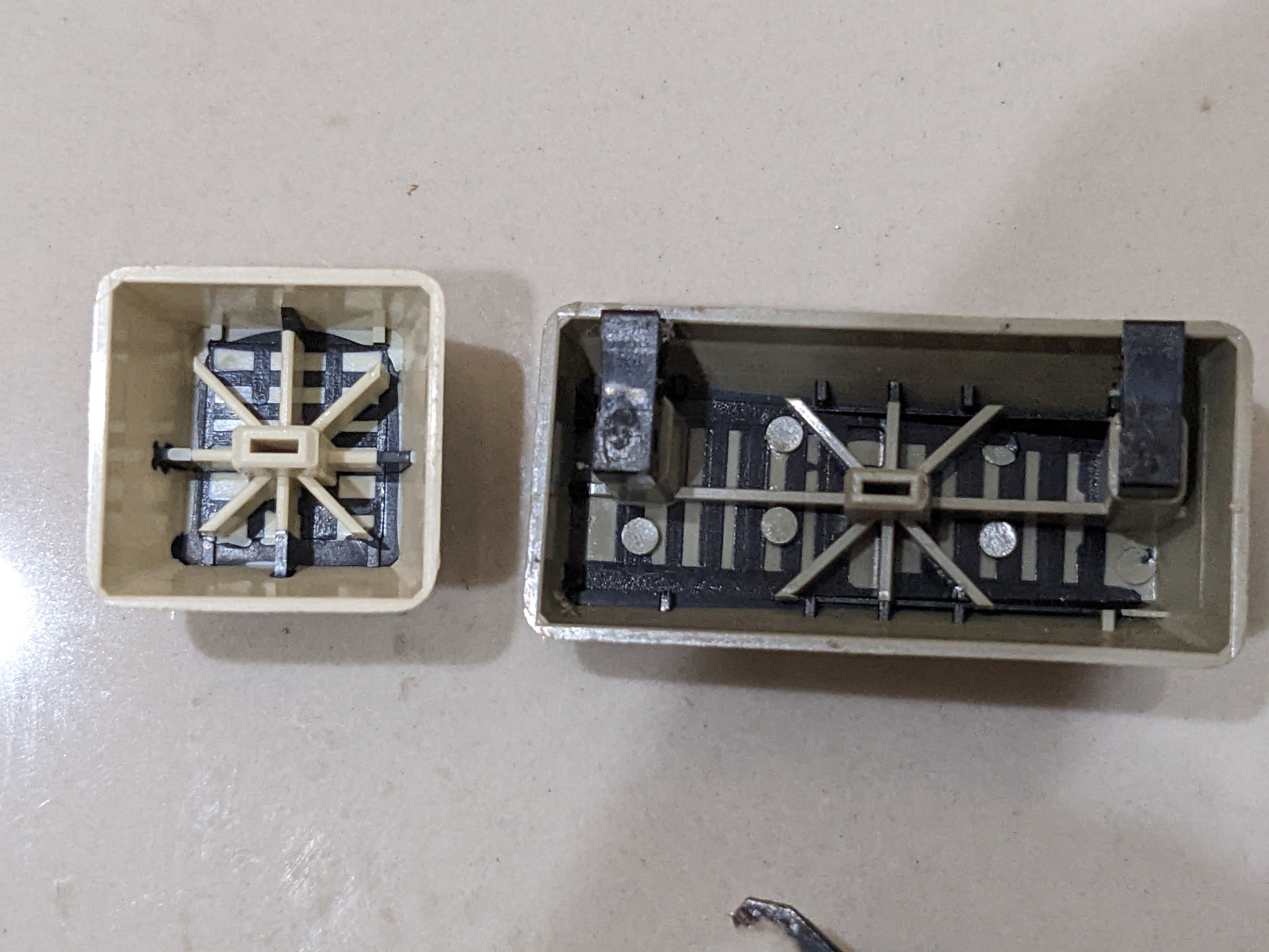

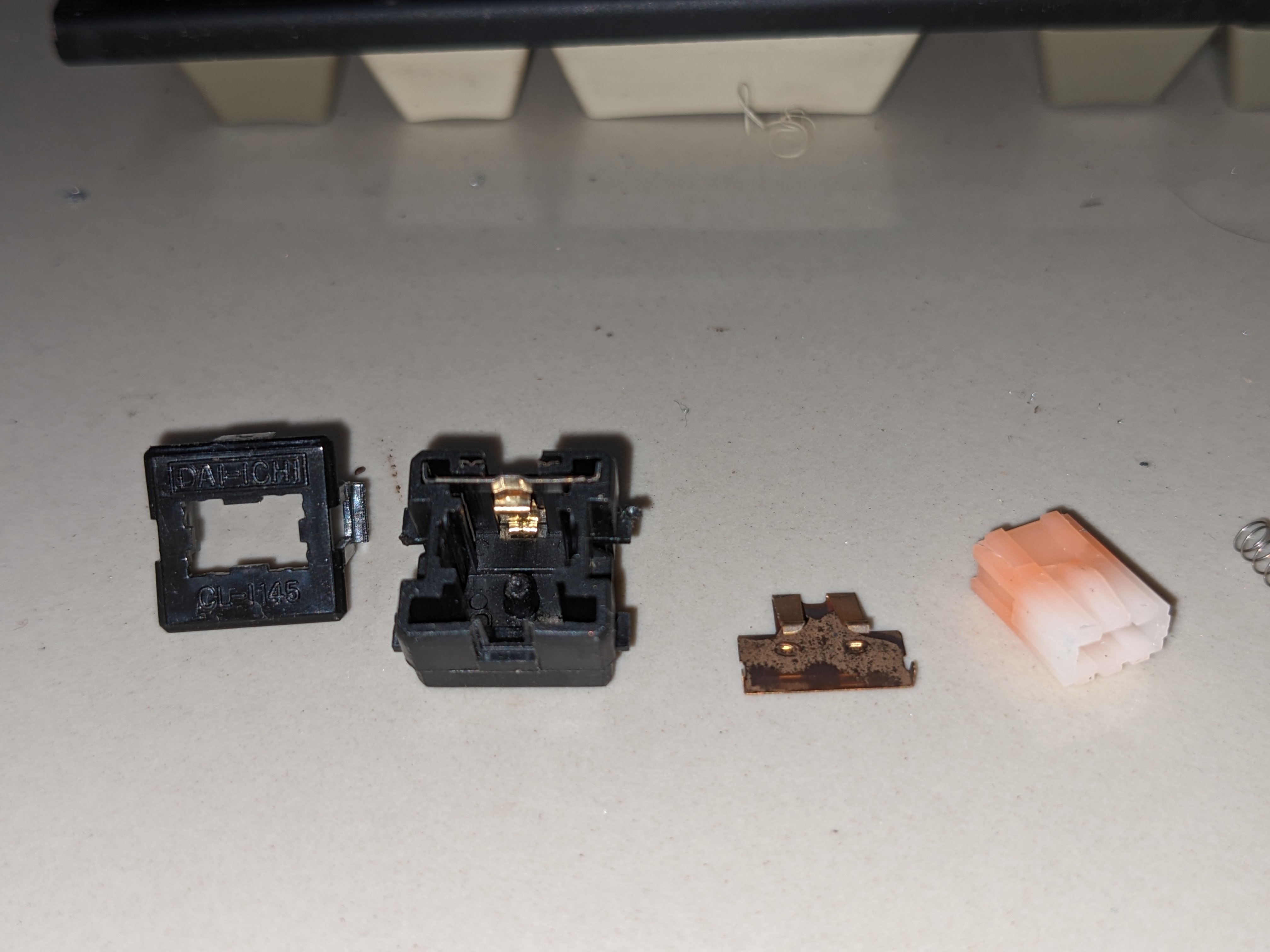

Here are the insides of the switches

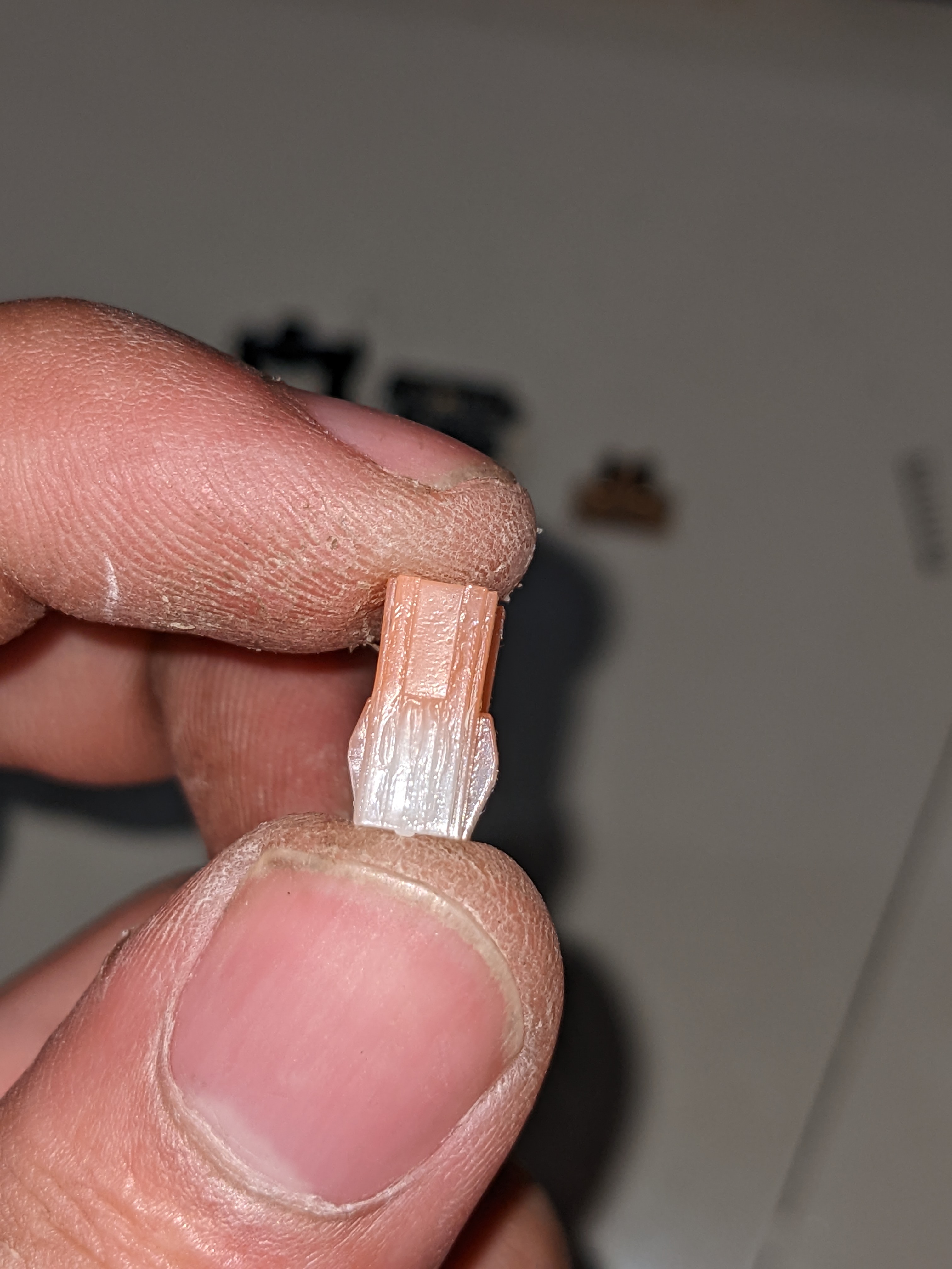

The stem
Has a gradient slider with white and salmon colour
The internals

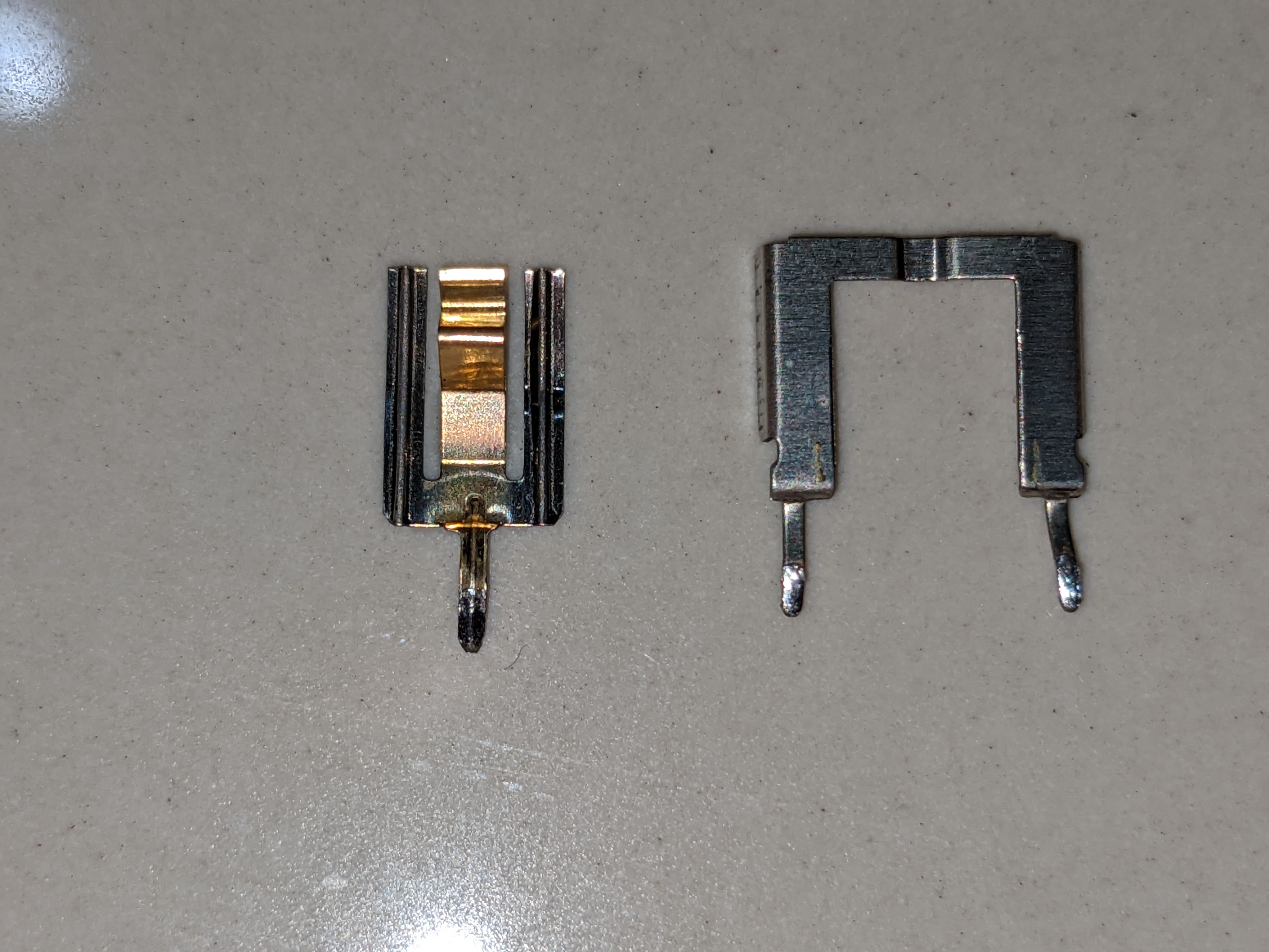

The contacts
The switches them selfs are quite smooth and has a slightly softer click, i like them.

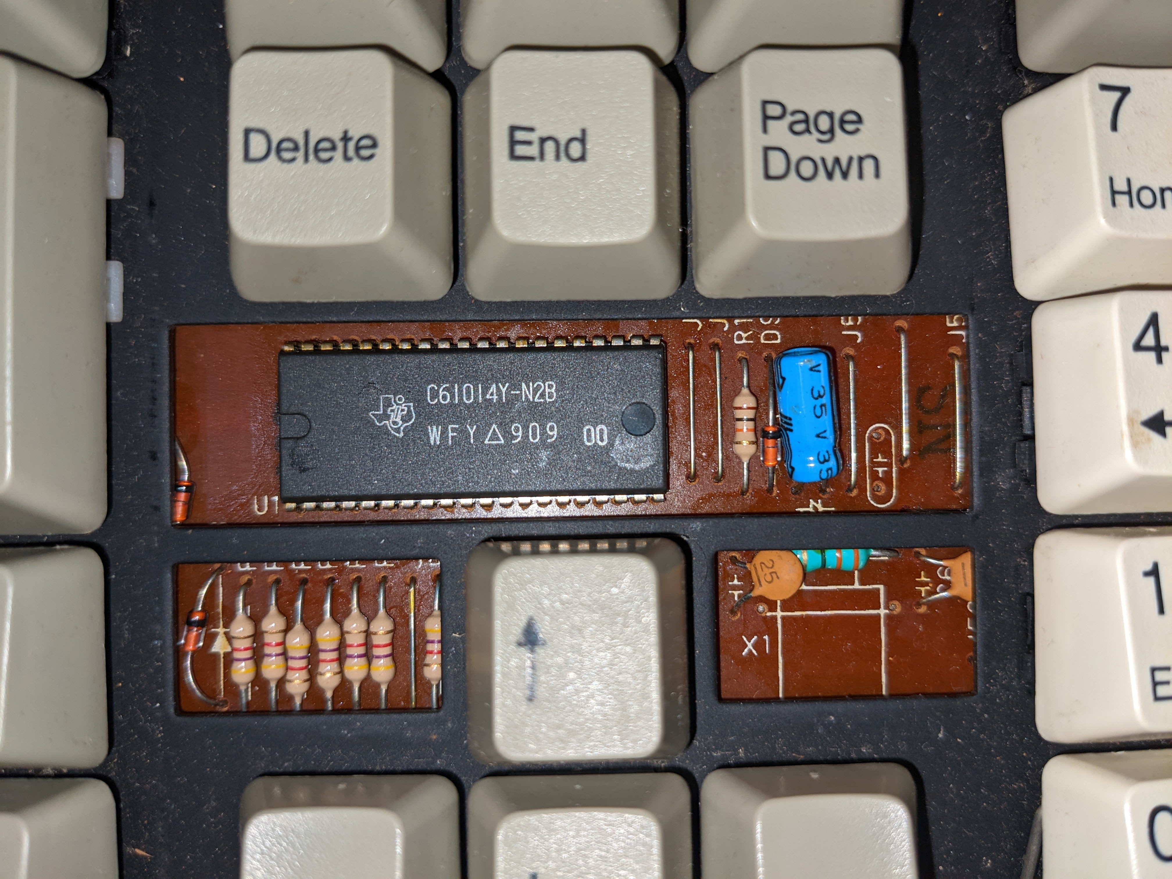

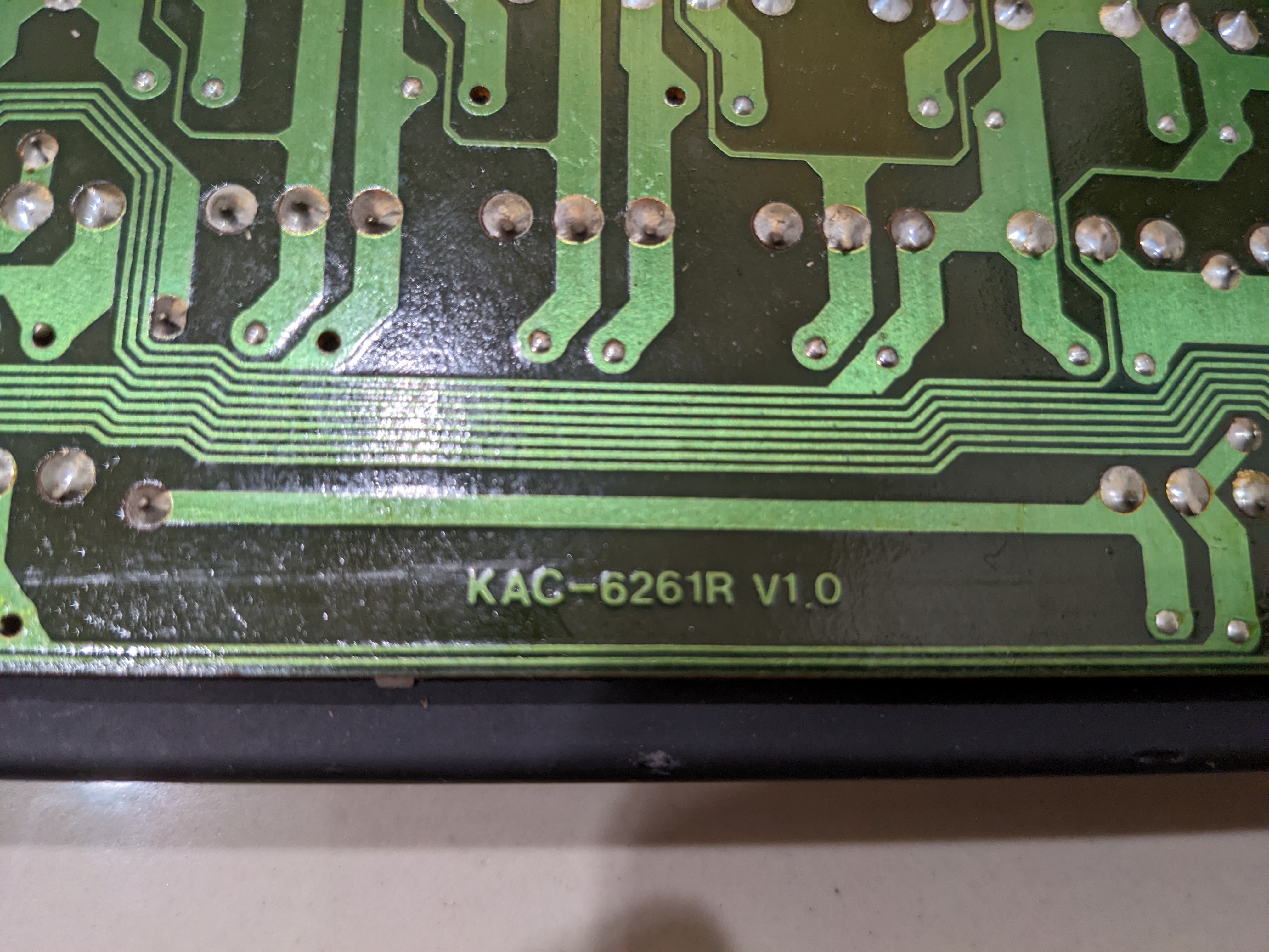

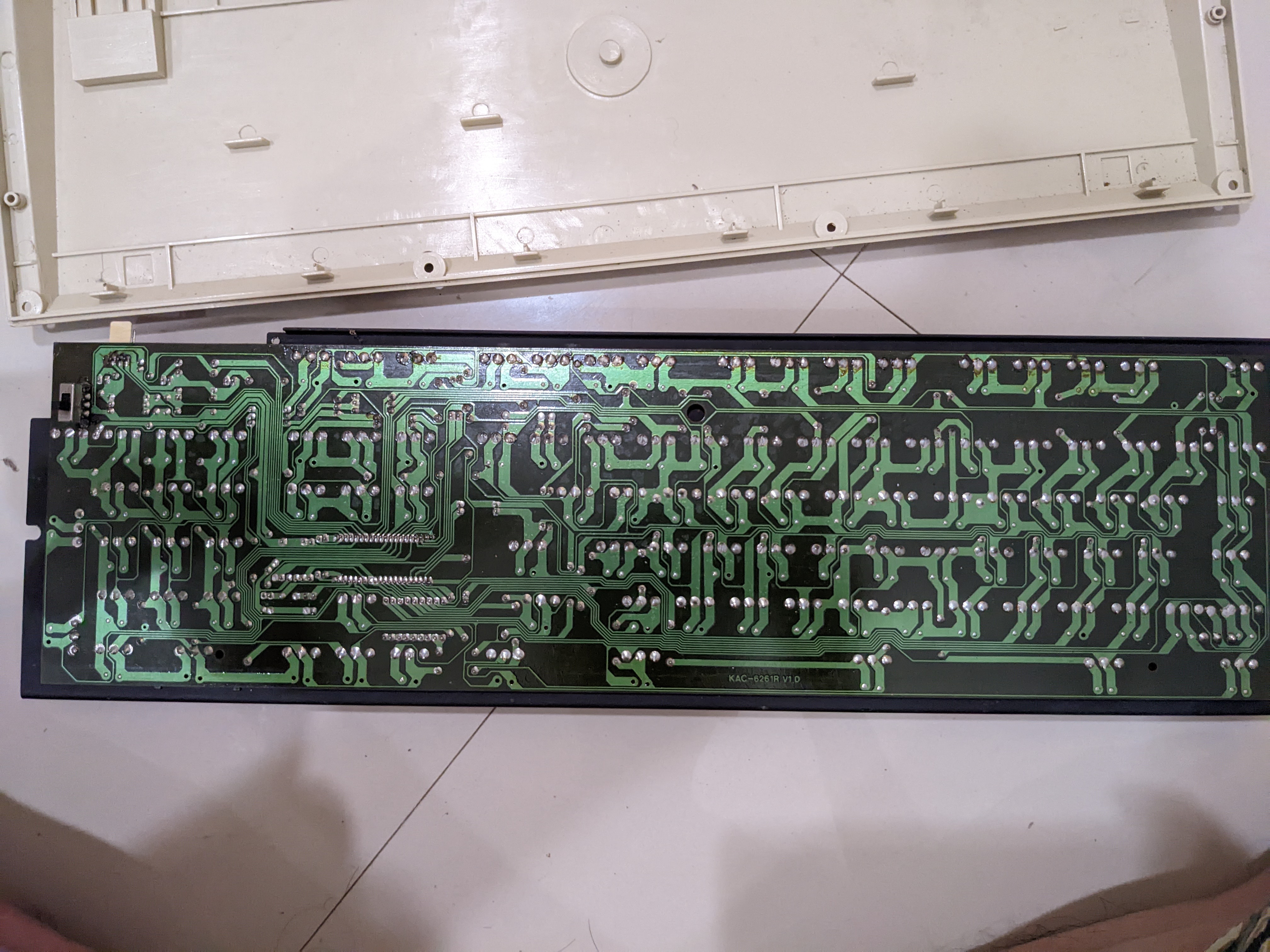

Some more photos of the pcb etc

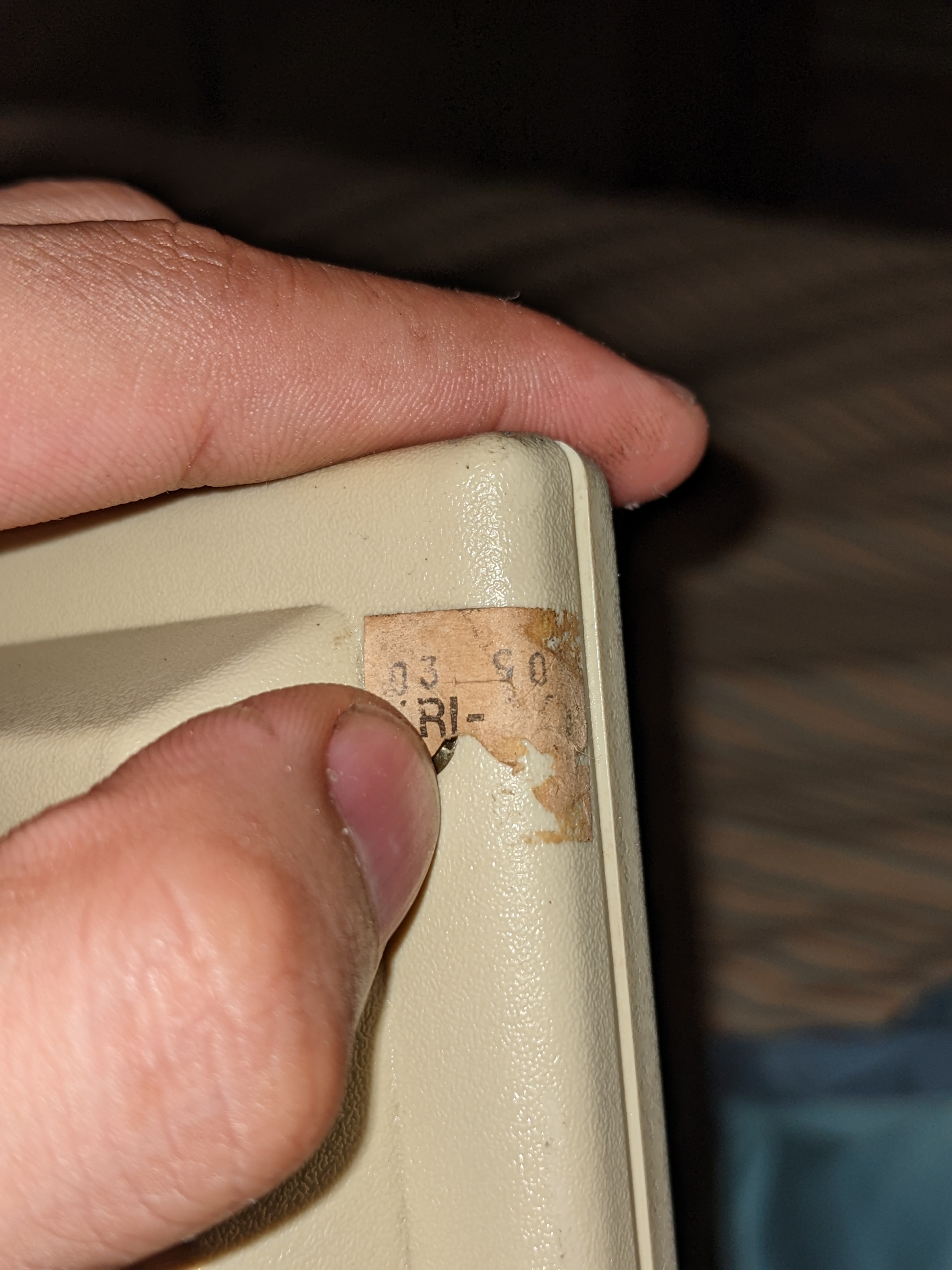

The board itself seems to be from 03-1990 from what i can tell from then warranty sticker on it
