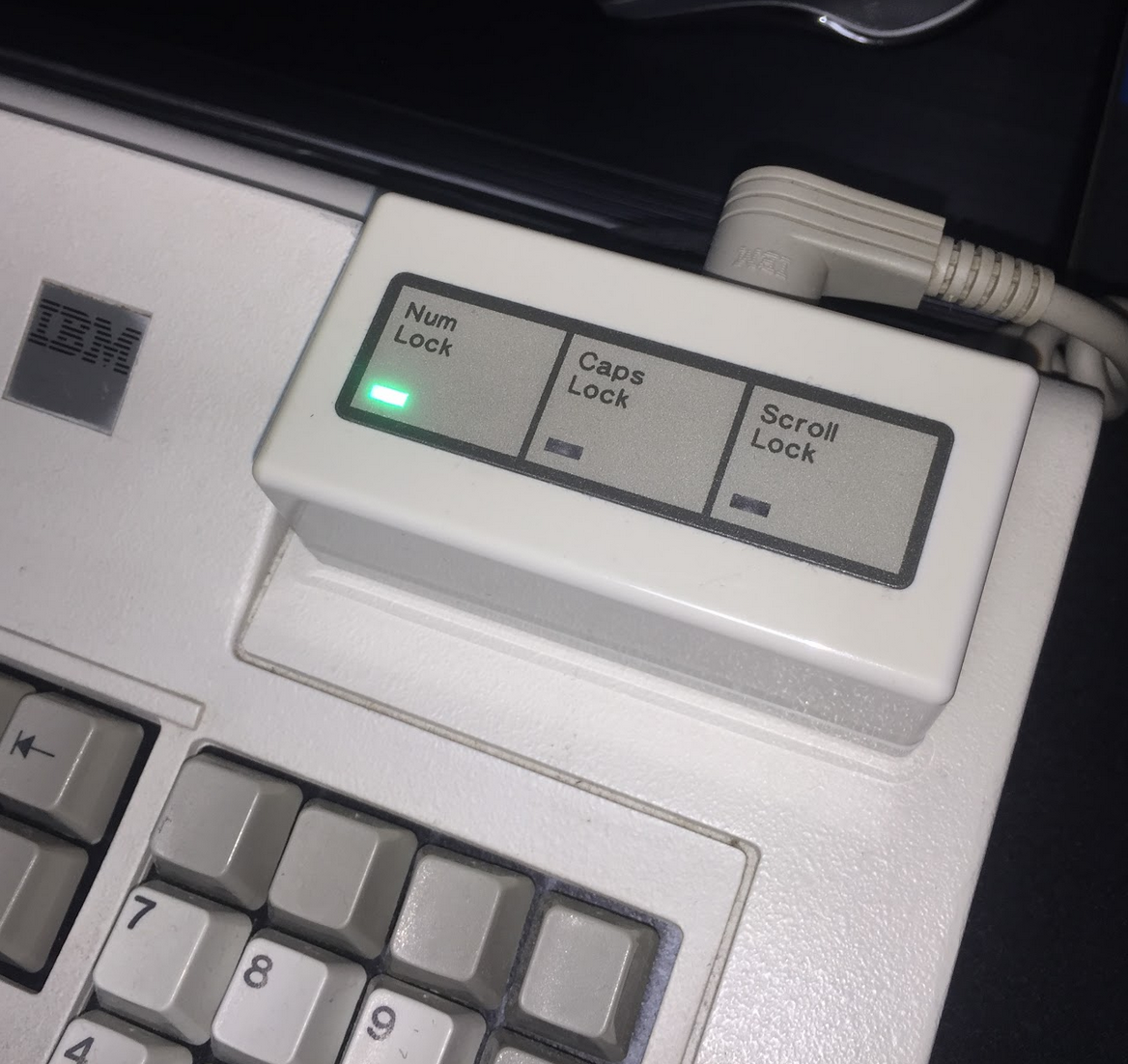

My solution:
That's just a project box with the soarer converter inside, attached to the keyboard case with magnets so can be removed/shared easily. The keyboard is stock, the only modification needed is to attach the magnets inside the case with blu-tac, double-sided tape or similar.
The keyboard is plugged to the box and the USB cable comes also from the box.
The locklights sticker was purchased from unicomp. That way the locklights are in the proper place but without a need to drill the case.
