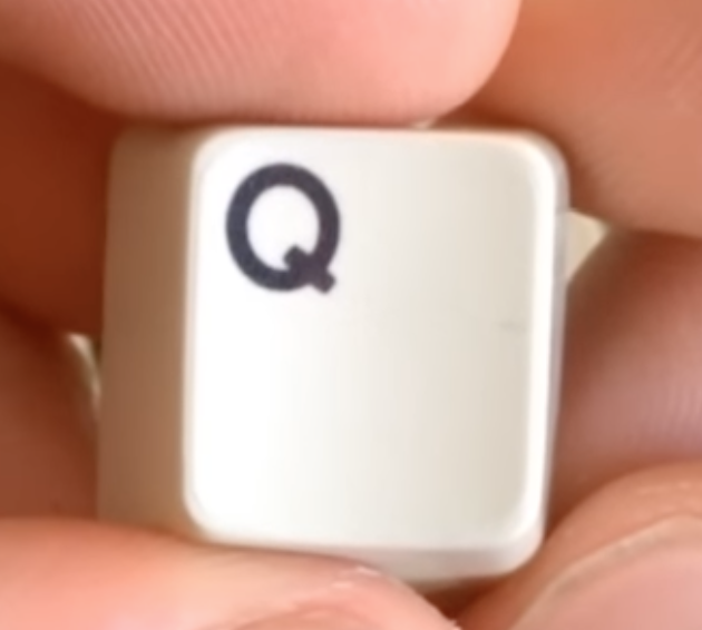

Thank you all for your responses. I also just clicked on Chyrosran's review of the Model F XT from 2016, and despite the video being in 720p resolution it sure looks like there is a sticker on his as well.
Screenshot 2022-10-26 at 08.57.27.png (337.55 KiB) Viewed 4205 times

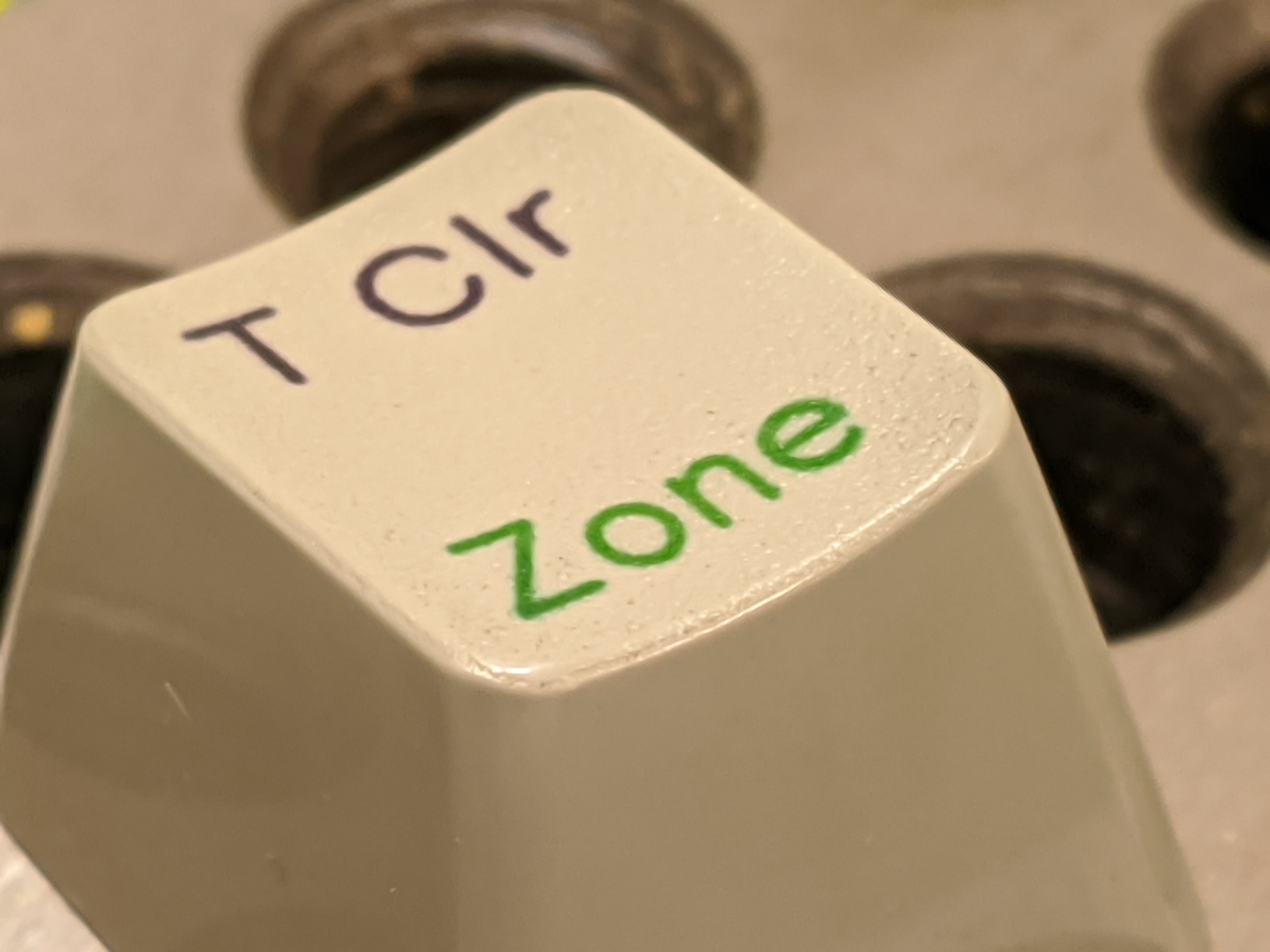

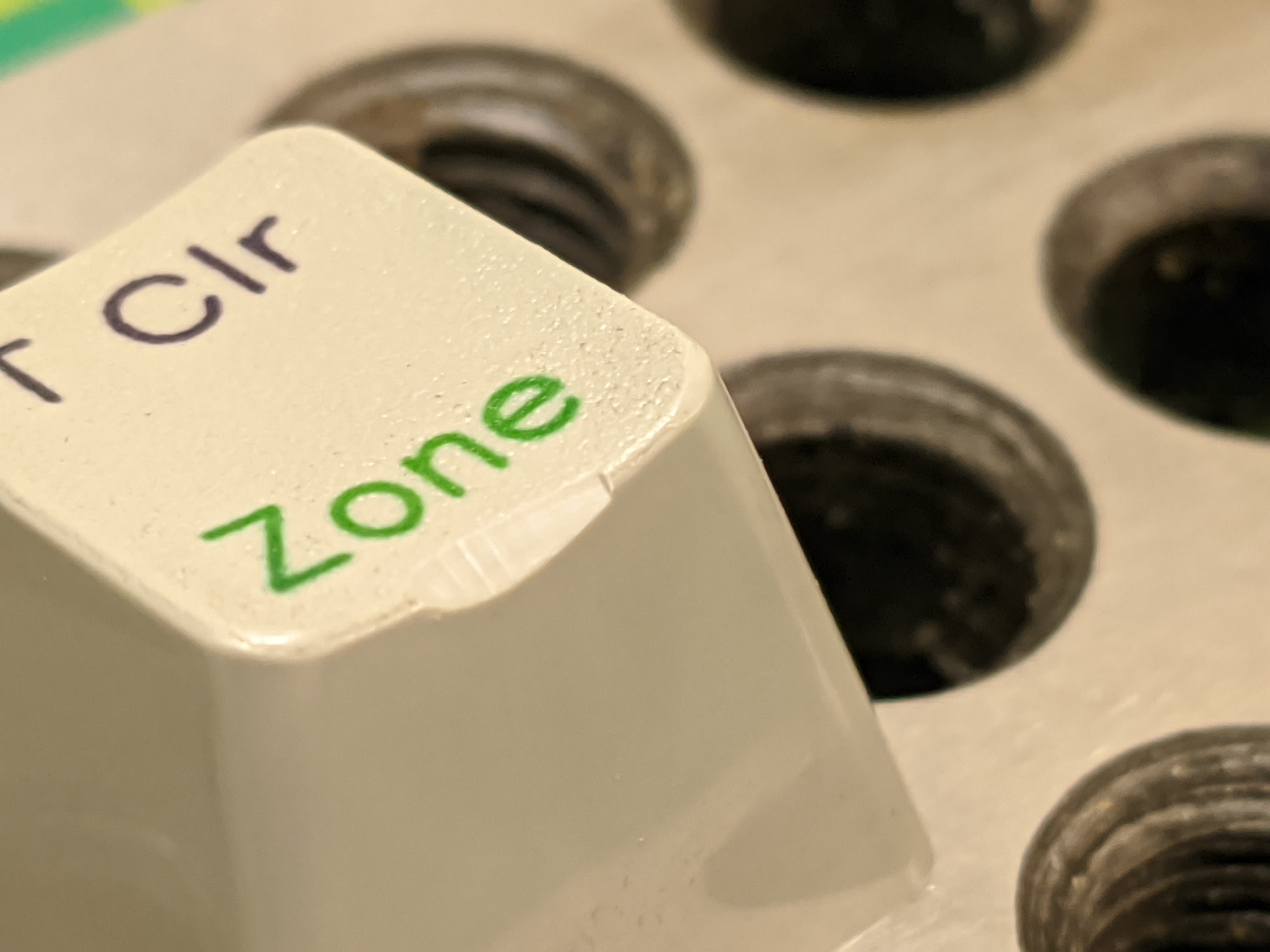

I'm almost certain that those are not stickers. It would make sense from a tooling standpoint if the molds are multi-piece with the top part being separate to allow for media blasting (texture), different maintenance intervals, homing bumps, etc. I'd bet that the tooling fitment just had some variation over the years which causes a parting line on some caps but not others.
Here's a cap off a Wheelwriter with a similar line. I took a sliver out of it with a knife and it's indeed uniform plastic all the way through, no sticker.

jsheradin wrote: 26 Oct 2022, 15:34 I'm almost certain that those are not stickers. It would make sense from a tooling standpoint if the molds are multi-piece with the top part being separate to allow for media blasting (texture), different maintenance intervals, homing bumps, etc. I'd bet that the tooling fitment just had some variation over the years which causes a parting line on some caps but not others.
This is exactly what I'd first suspected! Given how much more OP's look like stickers, I say that there's still a chance of that being the case and the only way we'll know for sure is if they try to peel it off.
They don't need to cut a slab out of it like you did to the wheel writer though. That would be a crying shame if it really were a mint condition IBM F XT.
