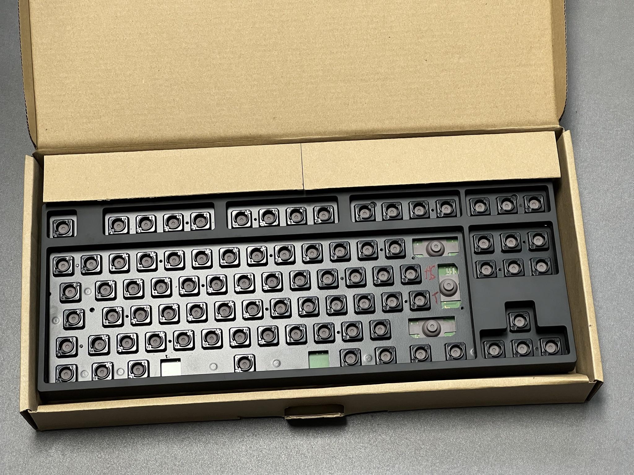

Hello Keyboard Wizards,
please help me out on this. A fellow forum member is willing to sell me one of his (cannibalized) Cooler Master Novatouchs.
Can i buy all the Parts online to rescue it and if so , what store do you recommend ?
Sliders and Stab housings are missing...
Thought about those deskeys sliders , but the missing stab housings worry me.
Happy Typing ,
Nick

Nuum wrote: 21 Oct 2022, 17:03 Deskeys also sells stab housings: https://deskeys.io/collections/home-all ... 0414297123
Ahh very good, thanks !
So iam probably looking at like 120€ in sliders & housings just to get it running & then i have to get keycaps for it.
Seems not really worth it.
Have you tried out a Novatouch ? How are they ?

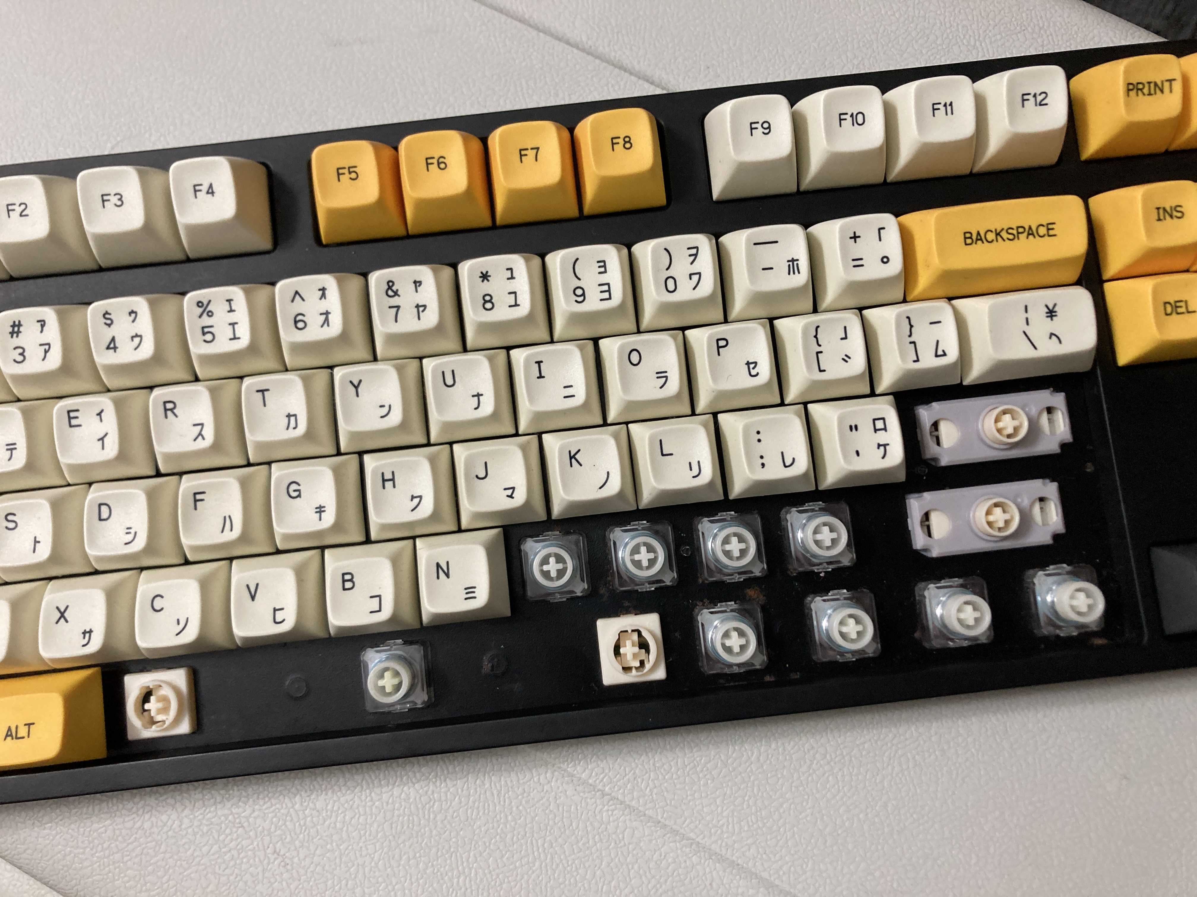

Did the same except I already had Niz parts and the board. And yeah you’ll end up spending quite a bit; up to you if it’s worth it or not. Deskeys are expensive/overpriced but they’re quite good and nothing else comes close. I actually like their sliders better than Novas and see them on par with topres.
Also aside from sliders (x5), stab housing and 2u slider+spacebar set you might need the 6.25 wire if yours doesn’t come with it. And your estimate might be off should be around $158 for all those.

kokokoy wrote: 24 Oct 2022, 07:09 Also aside from sliders (x5), stab housing and 2u slider+spacebar set you might need the 6.25 wire if yours doesn’t come with it. And your estimate might be off should be around $158 for all those.
Yeah it was just a rough estimate when i was looking at their prices :D
Thanks for the parts list, what do you mean i need the 6.25 Wire ? Can i use a MX Stab wire ?
"Worst" Part is, ill need even more deskeys sliders as iam going to convert an HHKB too.... oh man , thats a project for next year. :D

No worries and no you can't. The wire's are different.
As for HHKB, might be good to wait. They have 2 kinds of 2u slider where the latest one was reported to be a bit bigger than the housing. They're revising it.

kokokoy wrote: 24 Oct 2022, 09:21 No worries and no you can't. The wire's are different.
Oh snap, is there any site i can purchase wires for that keeb ? otherwise iam pretty screwed since i already purchased the board.

guidemetothelight wrote: 24 Oct 2022, 11:45 Oh snap, is there any site i can purchase wires for that keeb ? otherwise iam pretty screwed since i already purchased the board.
Deskeys. Got the wire from them for the one I posted.
