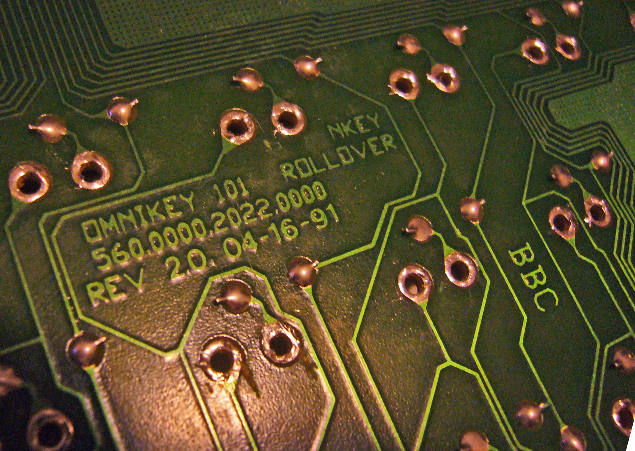

I have only ever kept 101s because my old hands have muscle memory and need a true-ANSI layout.
But for what it's worth :
- Omnikey-PCB-rollover.jpg (341.51 KiB) Viewed 5415 times

I might get it for that! I've been running into rollover issues on my FK-2001, the board also looks to be in really good condition baring some yellowing on a few key caps. Not to mention the layout seems like a plus, I kinda wanna try ctrl where caps usually is and the like without completely losing caps lock, on top of that every sound test I've heard, they sound nicer in the metal chassis

I still need to do more research on the Northgates. The Plus was Gen2 only. And came in at least three different versions, defined by Vendor number (222, 333, or 777). Ultra was made during Gen2, Gen3, and Gen4, with the Gen2 Ultras all (?) being Vendor 777. 101 was Gen2 (101I, 101N), Gen3 (the ANSI 101 most of us are familiar with) or Gen4 (101P). The 102 was the only Northgate model to be available in all four generations. All of the Gen3 and Gen4 Northgates were Vendor 20017. Gen4 models were programmable, with a "P" in the model number and no dipswitches or jumpers. To make matters worse there were different revision numbers for the Gen2 models, which probably had to do with firmware. I have a bunch of Northgates, but not nearly enough to have an example of every version that was made.LambdaCore wrote: 09 Apr 2022, 20:48 Huh, I thought the 2nd gens had NKRO but lacked blue alps, guess my research was wrong on the Plus specifically thinking it was closer to the Ultra than the first gen 102
The Gen3 and Gen4 models explicitly stated "NKRO" on the PC boards. The Gen1 and Gen2 models did not, which why I pointed out that they may not have this feature. The fact that they made a note of it on the Gen3 PC boards suggests it was something new. I don't type fast enough to tell the difference. Is the presence or absence of diodes a definitive way to tell? That's something I can easily check.
edit: I just opened up a Gen2 Vendor 333 Plus. No diodes and no "NKRO" on the PC board.

Ah that's a real shame, went ahead and bought it under the assumption it did. Still a very nice keyboard, got it at a cheaper price than it usually goes to as well so I'm not too bummed. According to Deskthority the one I'm getting is a Gen2a as it's dates back to 89 on the back of the chassisPolecat wrote: 10 Apr 2022, 01:14I still need to do more research on the Northgates. The Plus was Gen2 only. And came in at least three different versions, defined by Vendor number (222, 333, or 777). Ultra was made during Gen2, Gen3, and Gen4, with the Gen2 Ultras all (?) being Vendor 777. 101 was Gen2 (101I, 101N), Gen3 (the ANSI 101 most of us are familiar with) or Gen4 (101P). The 102 was the only Northgate model to be available in all four generations. All of the Gen3 and Gen4 Northgates were Vendor 20017. Gen4 models were programmable, with a "P" in the model number and no dipswitches or jumpers. To make matters worse there were different revision numbers for the Gen2 models, which probably had to do with firmware. I have a bunch of Northgates, but not nearly enough to have an example of every version that was made.LambdaCore wrote: 09 Apr 2022, 20:48 Huh, I thought the 2nd gens had NKRO but lacked blue alps, guess my research was wrong on the Plus specifically thinking it was closer to the Ultra than the first gen 102
