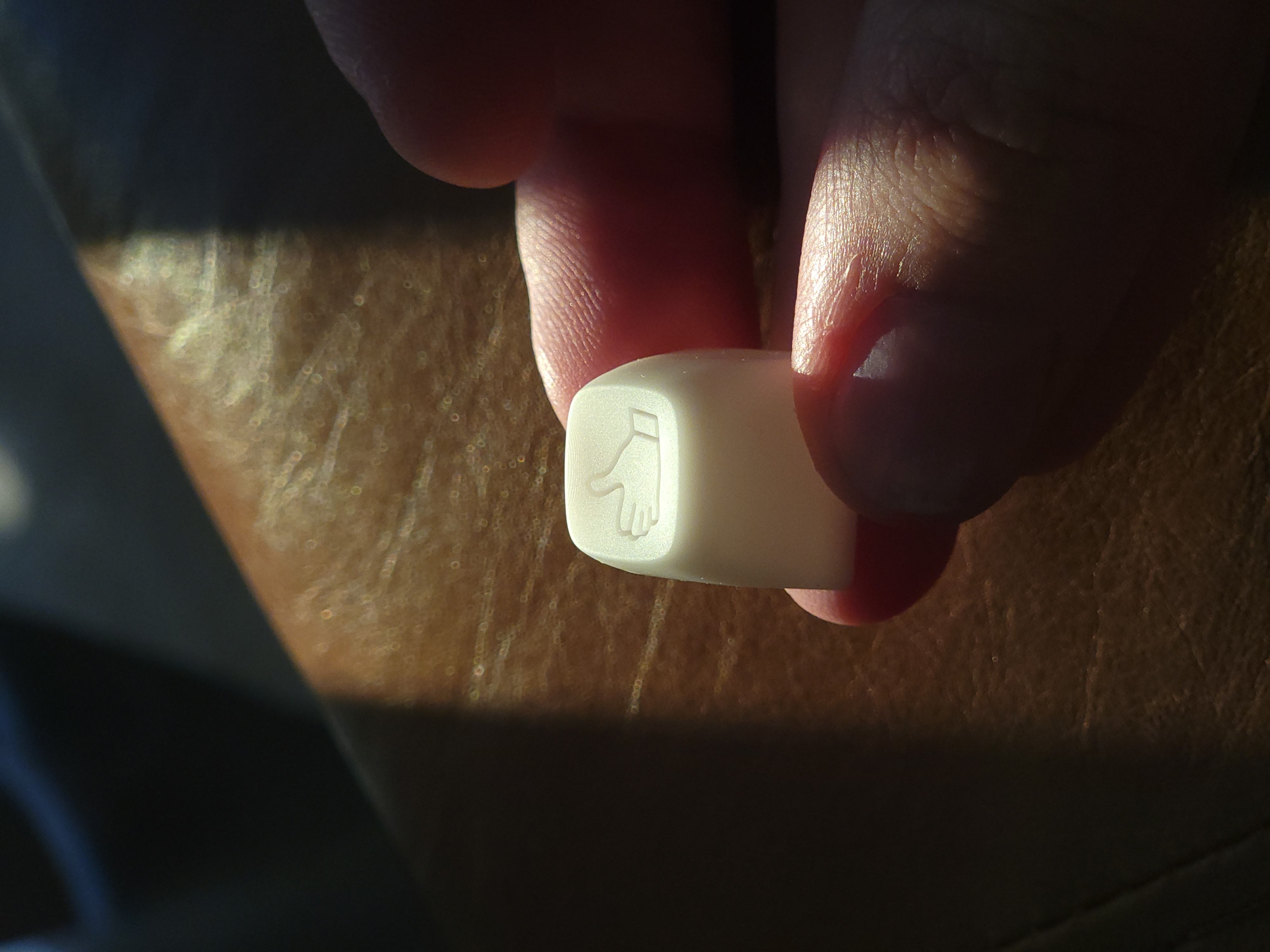

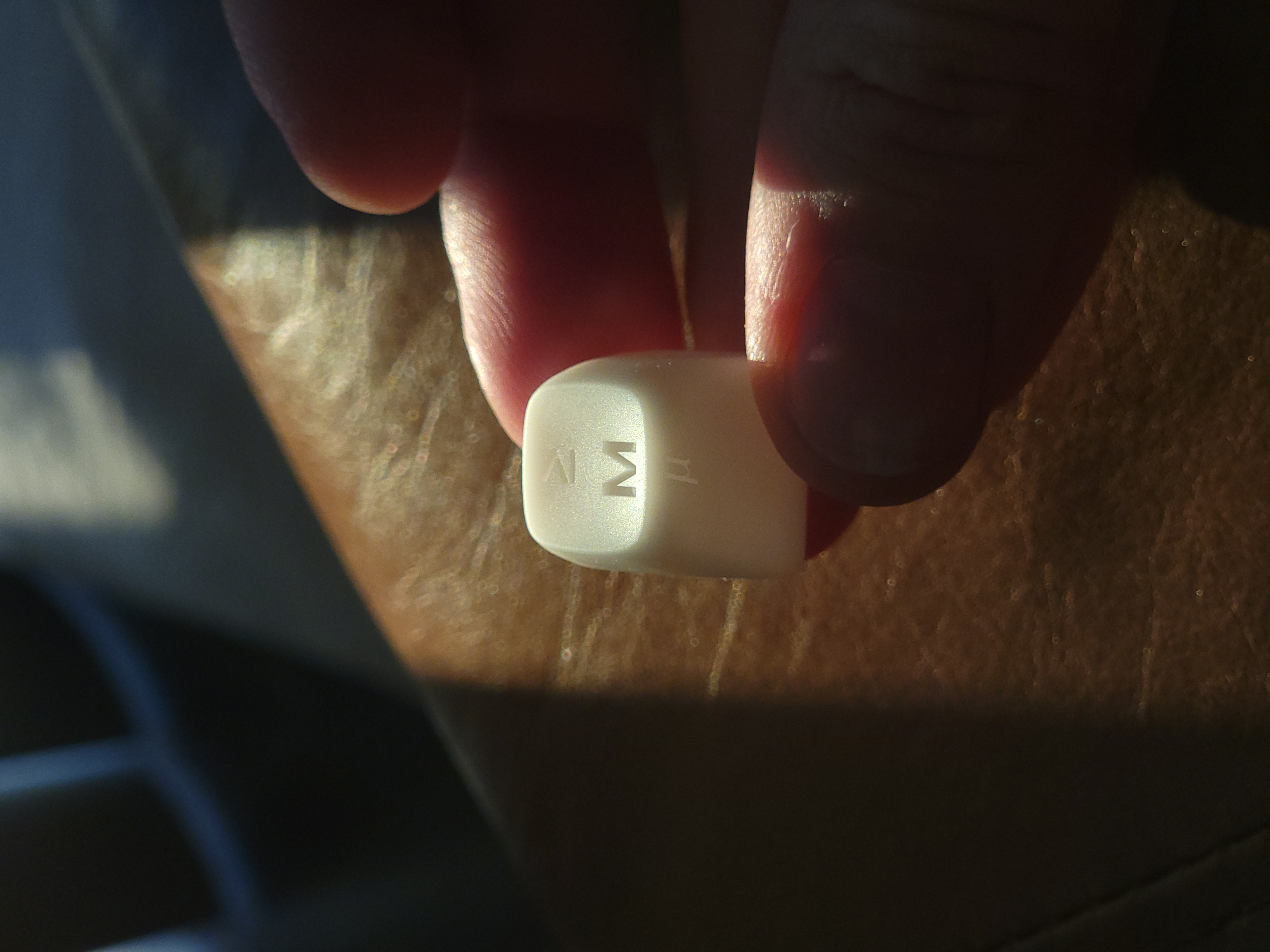

My name is Matt. In August 2021, I started 3D printing spherical keycaps for my Model F.
Here's how it started:
blob
blob
Here's how it's going:

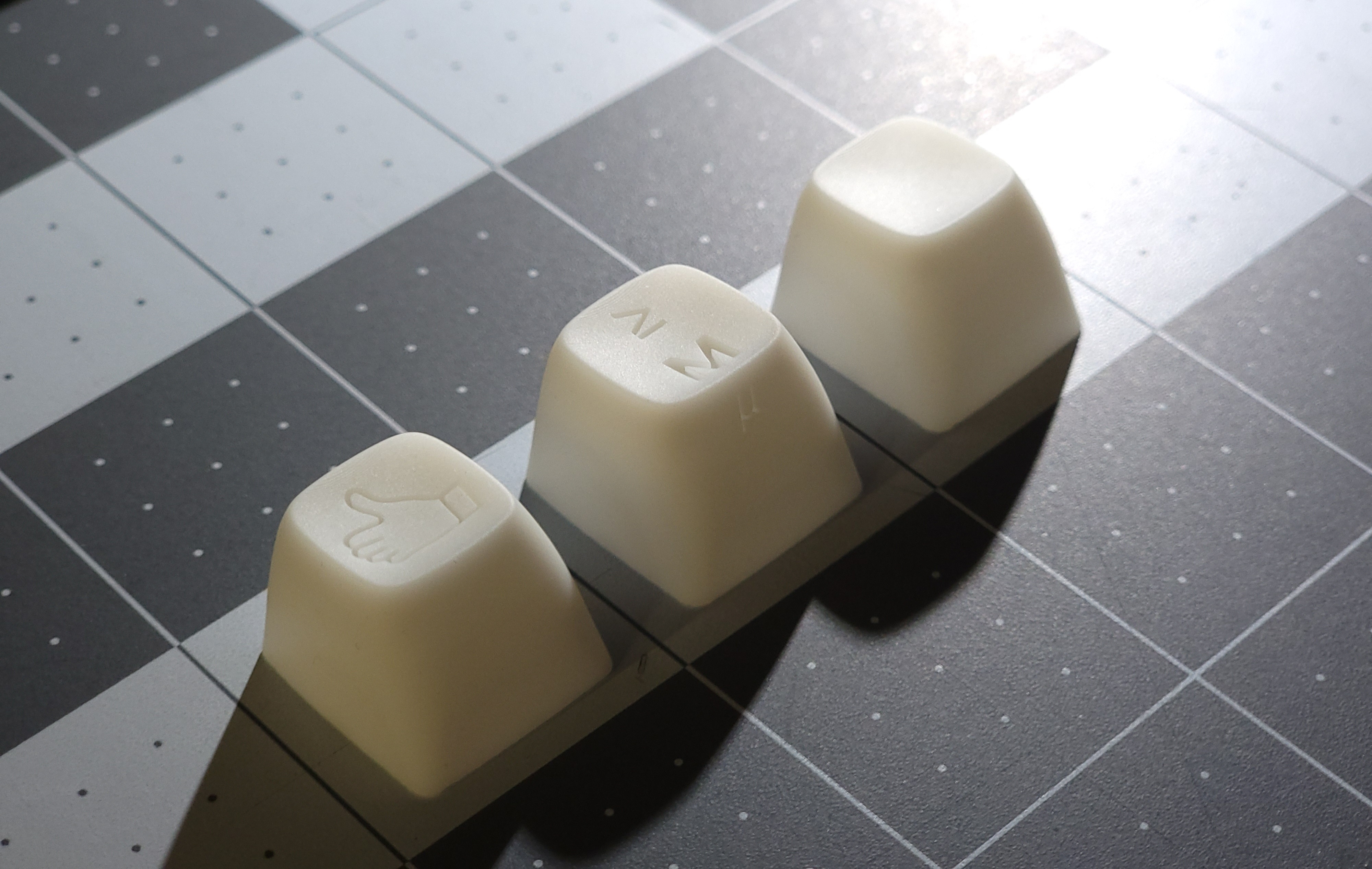

TNT wrote: 26 Jun 2022, 01:14 I was wondering, how do you create those razor sharp cutouts for the legends?
Thanks for asking :D The cutouts are done in Fusion 360. The depth is ~0.8 mm. The most recent pics are of caps fresh off the printer (and washed and cured). I'm using a Mars 2 Pro with a layer height of 0.02 mm. I really want to get a 8k printer though.
Exposure calibration is a must!!! Dennys Wang has a great video on the subject: https://youtu.be/vf_2OZgDCMM I had a lot of exposure issues before I started calibrating.
