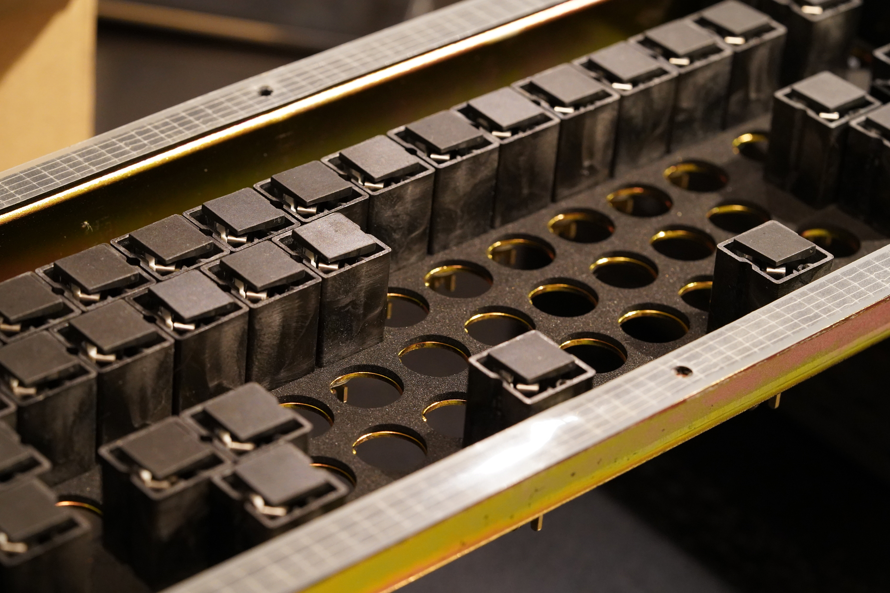

Re: Beamspring ... foam?
Posted: 28 Feb 2022, 21:07
by Dionea
That's how the replacement foam looks with the beamsprings.
