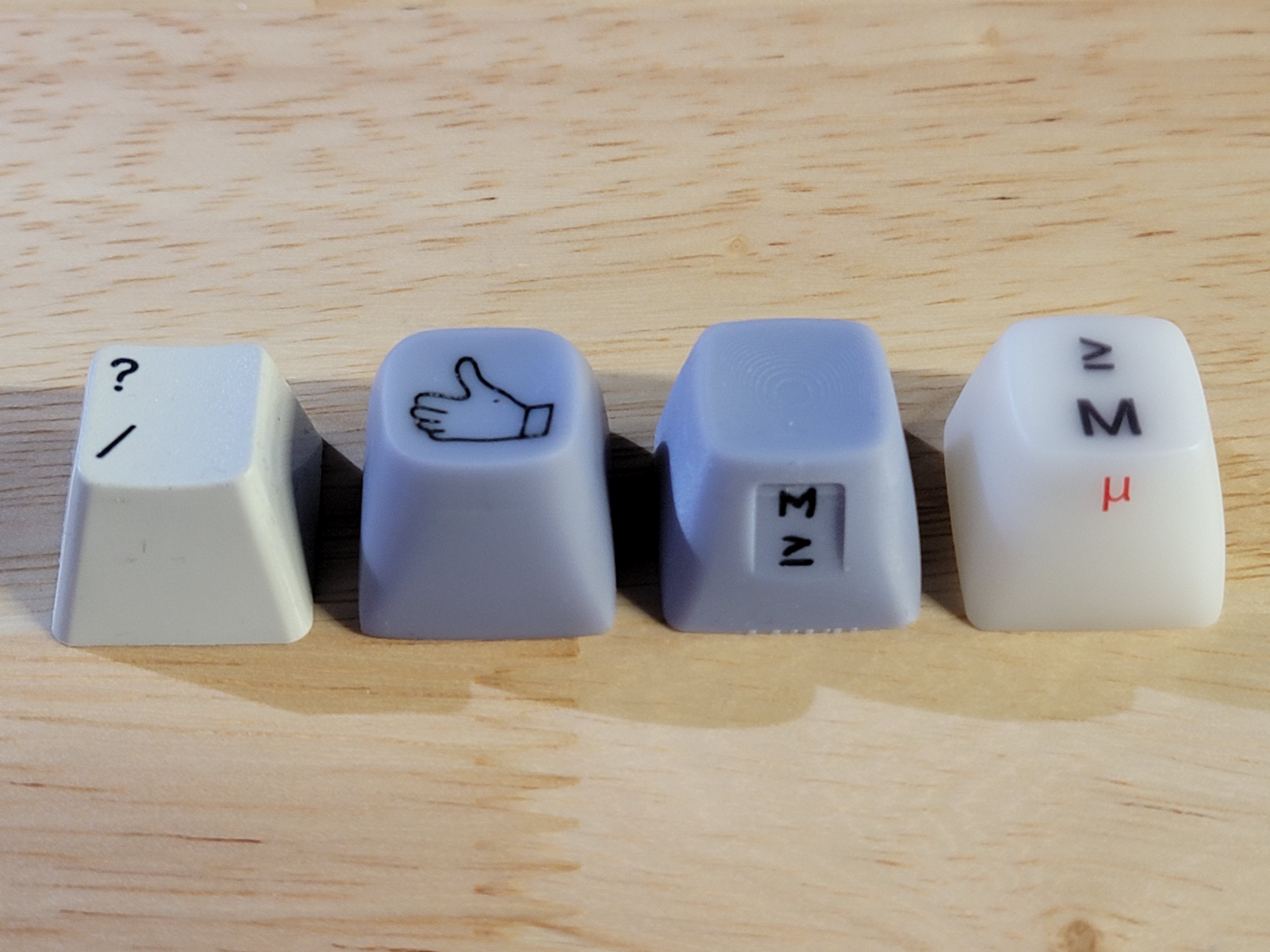

So i got to type on a selectric for the first time and i really loved the keycaps, but with buckling springs theres really only 1 profile so i had to get working in blender (With some people that can do CAD to fix bad stuff in the model). While it may look a bit crude, my attemps at making it look good have failed spectacularly. The base of the model comes from jaseg's buckling spring stl and it was some 20s typewriter buckling spring keycap i used for the thing that the spring sits in (These were designed with the Model F XT in mind so it is unknown if some of these keycaps will fit onto a model m) As of right now, these are untested. EDIT: Someone has offered to redesign the top part of the 2 piece keycap

These will 100% feel scratchy and awful at the resolution you've printed them at. Filament printing, even at its best, really can't do the "grain" you would need to get a smooth switch, even with monstrous amounts of lube applied. Hell, I doubt resin printing could get a high enough resolution to make these feel anything close to the original. The key tops are also very sloppy, you need to adjust the angle of the bottom piece to be flush with the dish at the top. But without injection molding (which would cost thousands) these aren't really that useful.

Seems thats the only option as the prototype (even without the thing where the spring sits) is way too hard to push up and down and is not smooth at all (Even without the spring in the barrel!) as someone else in this thread said

UPDATE: Turns out ThermometerSandwich actually did their own take on it, albeit still prototyping

by ThermometerSandwich
Thanks for the shout-out vyquad! :D
Great work on your caps btw! I'm still amazed at how well those stems came out.
I plan on making a larger build log post in the Workshop about this topic in the next couple weeks. So, I suppose this is kind of a teaser trailer ;)
From left to right:
  • OG Model M/F keycap
  • My first infill test on a resin print with black CA glue (lesson learned: don't use CA glue for infill...)
  • Profile test with Sharpie legend. I quickly printed a set of alphas like this just to try out for a while to make sure I was happy with the dish shape. Okay, so I may have printed several sets until I was happy with the shape... This was printed at a bit too high of a layer height (0.05 mm I think).
  • Proof of concept of a "Triple Shot" keycap using the same type of UV resin as the print itself.
Muirium wrote: 26 Jan 2022, 10:28 Wonder if the πŸ‘ is ⚑️ engraved?
For the πŸ‘ and β‰₯M, the caps were printed with little voids for the legends. The πŸ‘ legend was filled with black CA glue, then sanded a bit. This didn't turn out super well. For the β‰₯M, I used the same UV resin as the print itself with pigment added. I poured a little resin into the voids, then put clear tape over the uncured resin to shape it. I cured it by shining a UV laser through the tape. After removing the tape, a little sanding cleaned it up pretty quickly. I meant for the main legend to be black, but I definitely didn't add enough pigment to the resin, so grey it is. Other than the color issue, I'm pretty happy with the results.
I thought about CNC milling the legends, but I think the prints came out well enough when printed at 0.02 mm or so. Also, I'm way too lazy to do the tool-pathing for β‰₯107 different legends.
