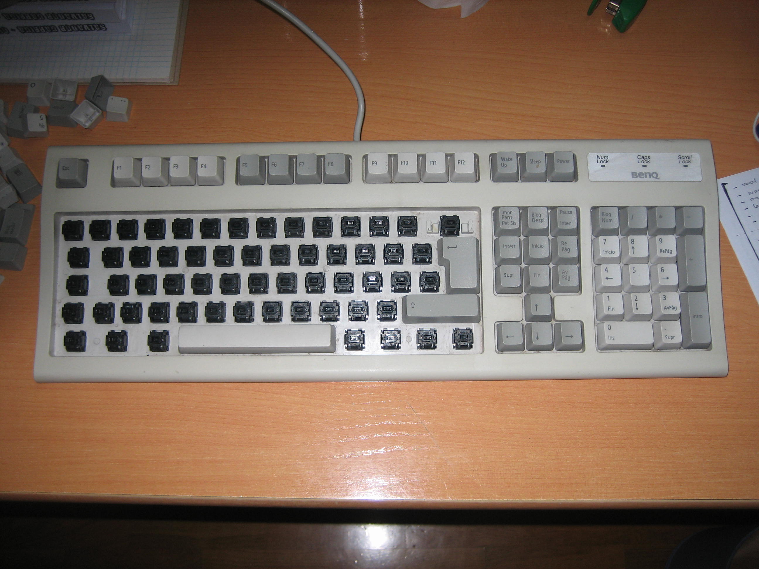

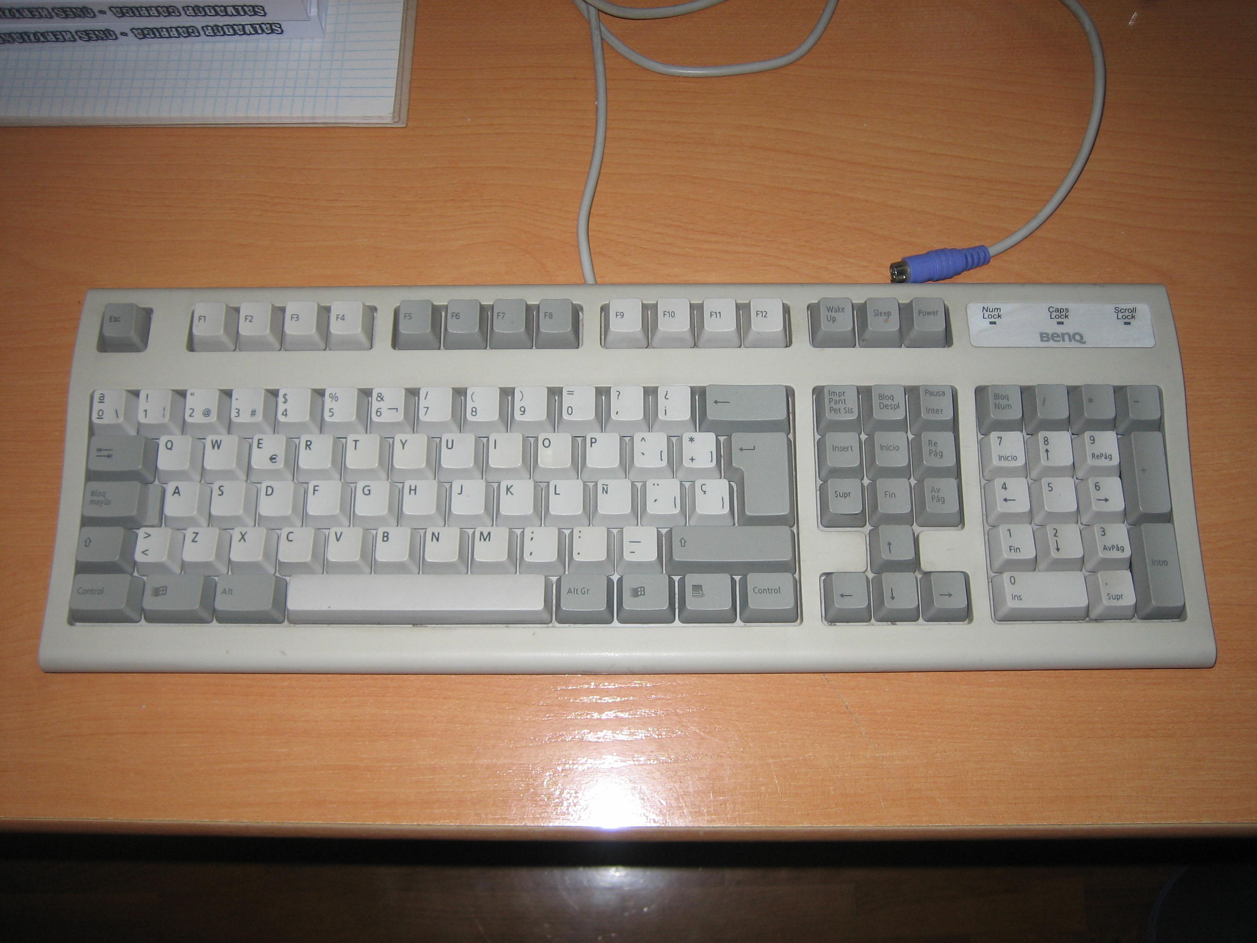

I found this treasure in the garbage...

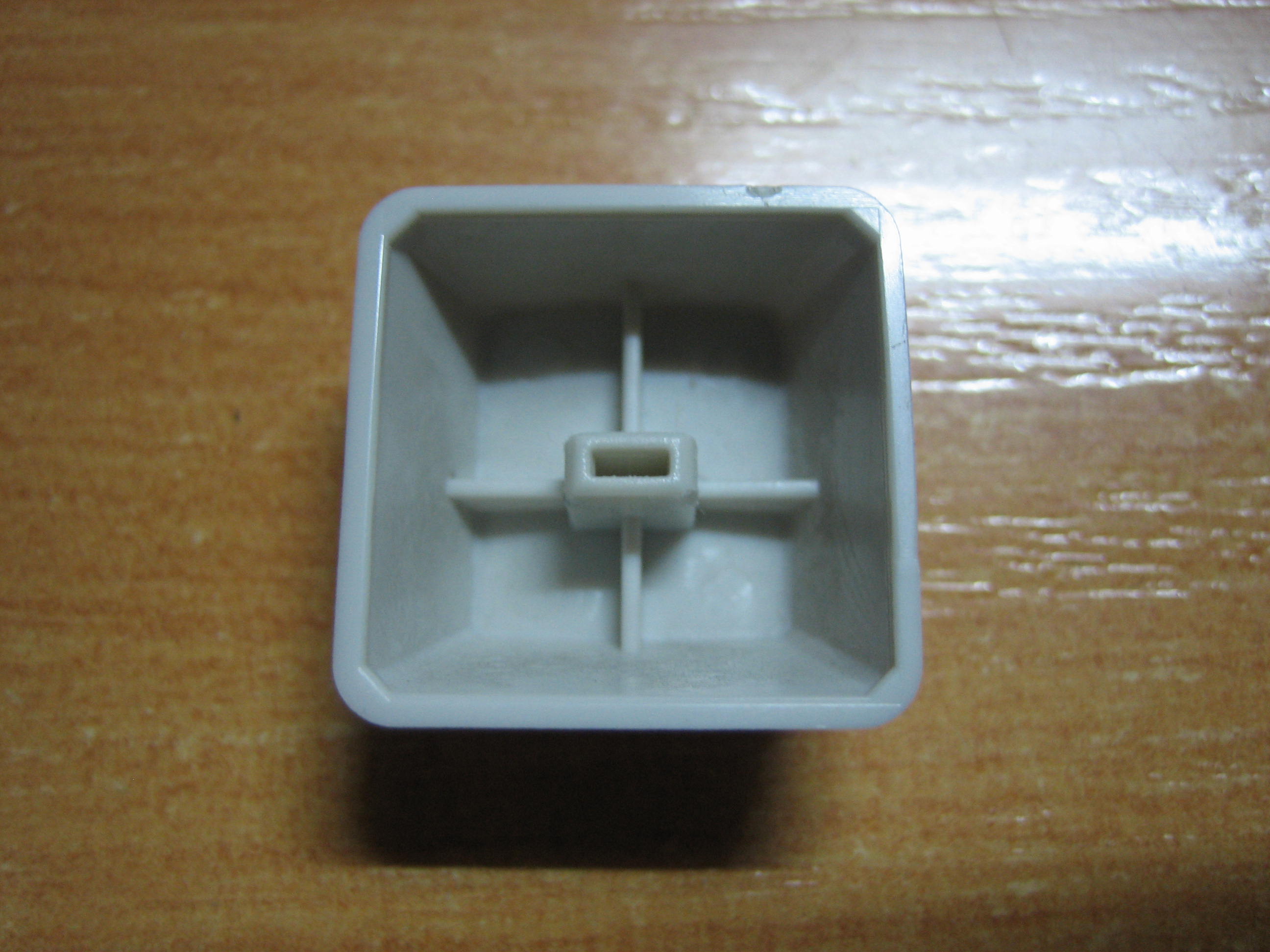

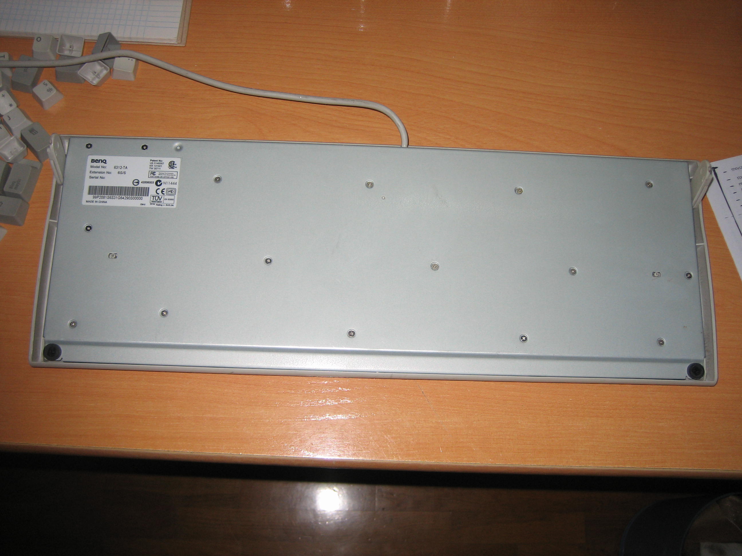

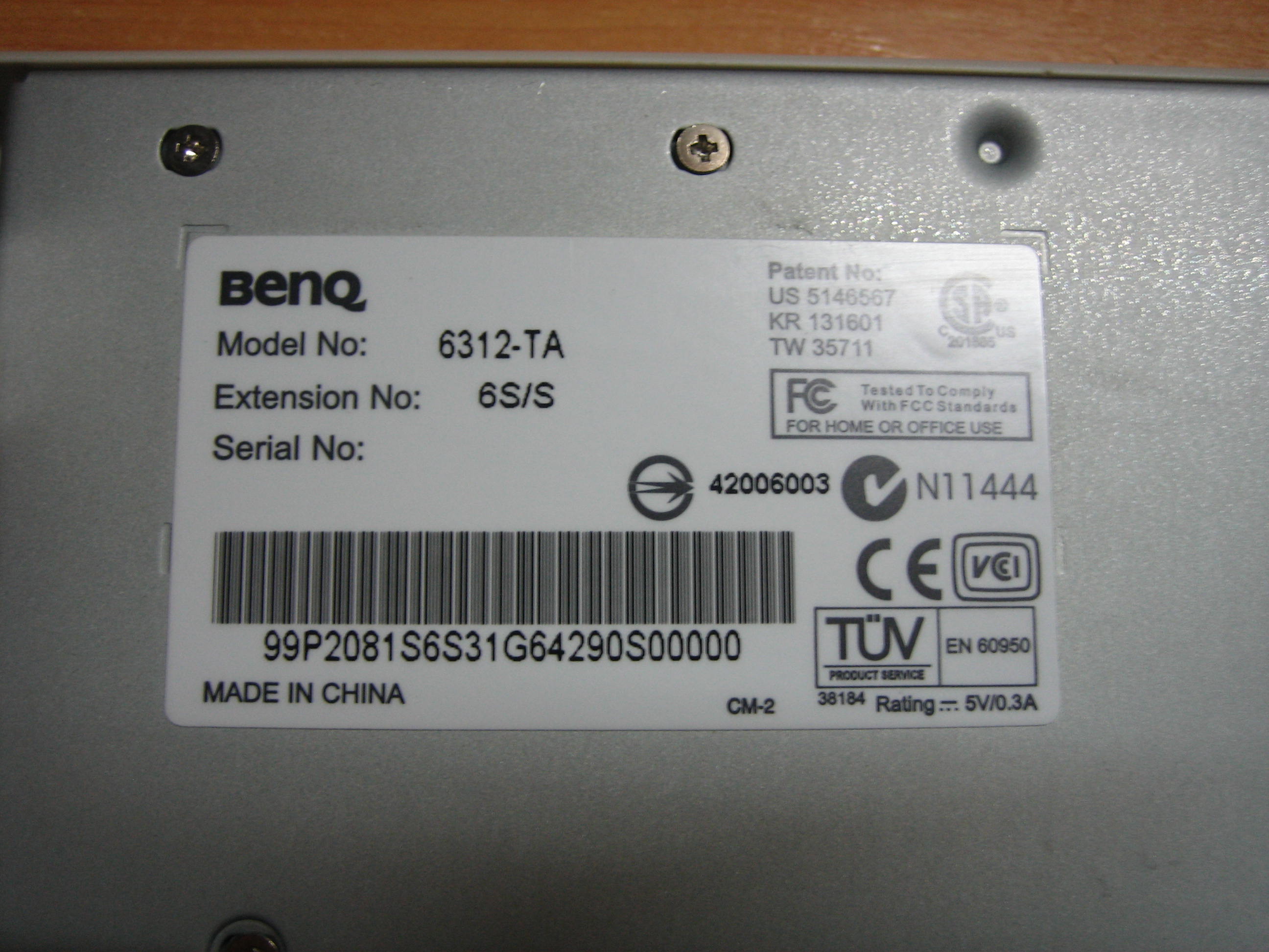

It's a BenQ 6312-TA spanish prfile with Acer keyswitches

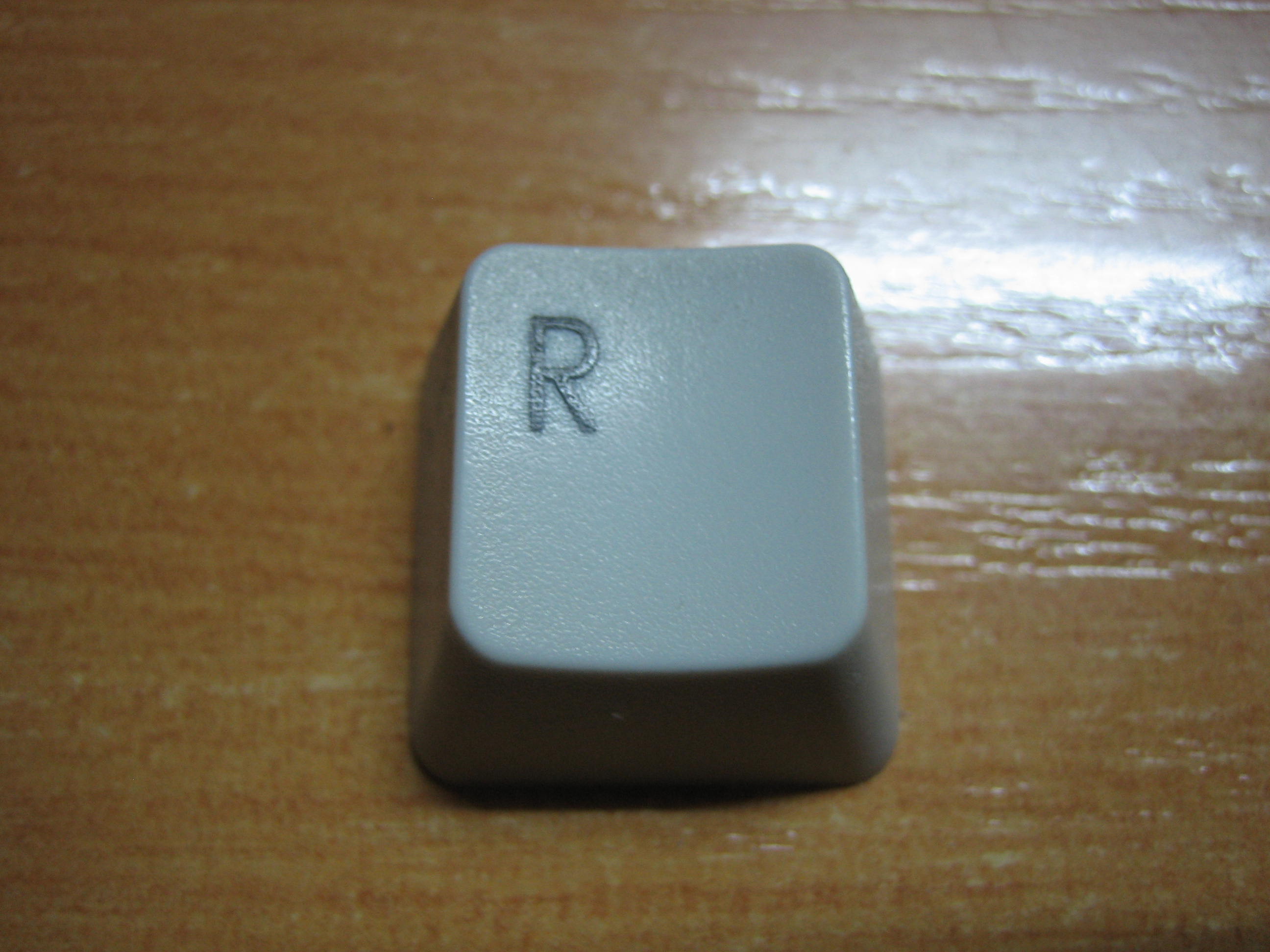

The keycaps are lasered

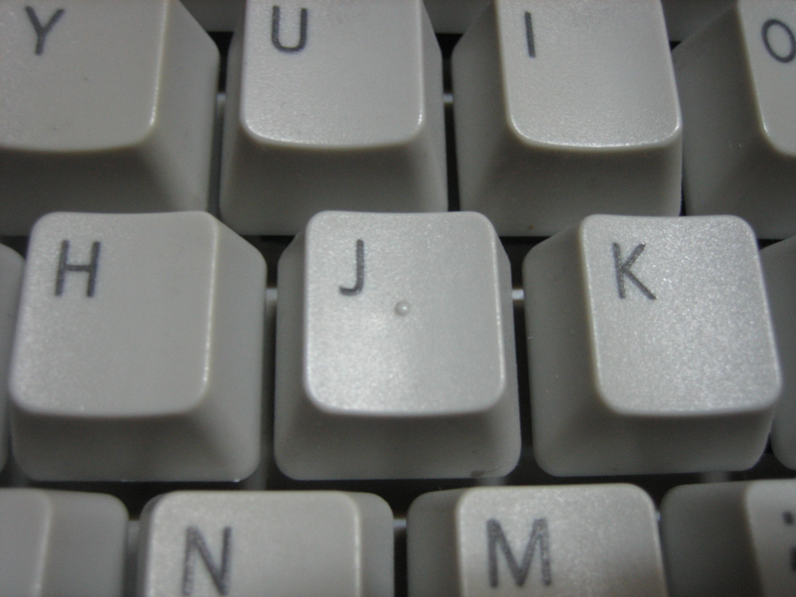

And the home keys look like this
The keyboard is compact and well build, the keys are clicky and tactile, so I'm starting to love this little one, but it doesn't work. I tested the connectivities with a multimeter, but I can't fins any error. One possibility is that this keyboard can't work on a Win7, and the other is that this one simply died.

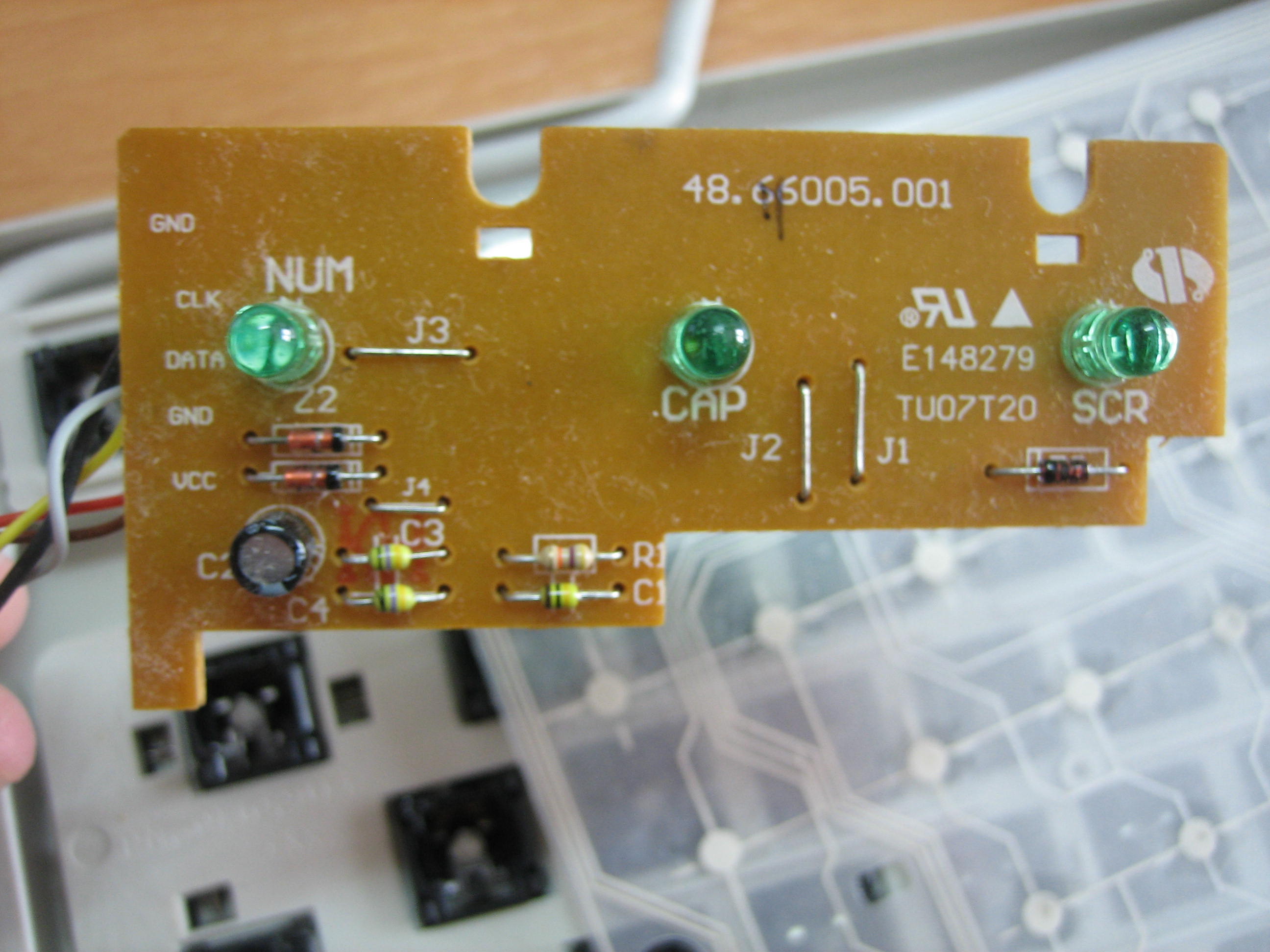

Might just be a dead controller, do you have a pic of the controller?
domin8r
19 May 2012, 14:25
Do the leds light up during booting at all?

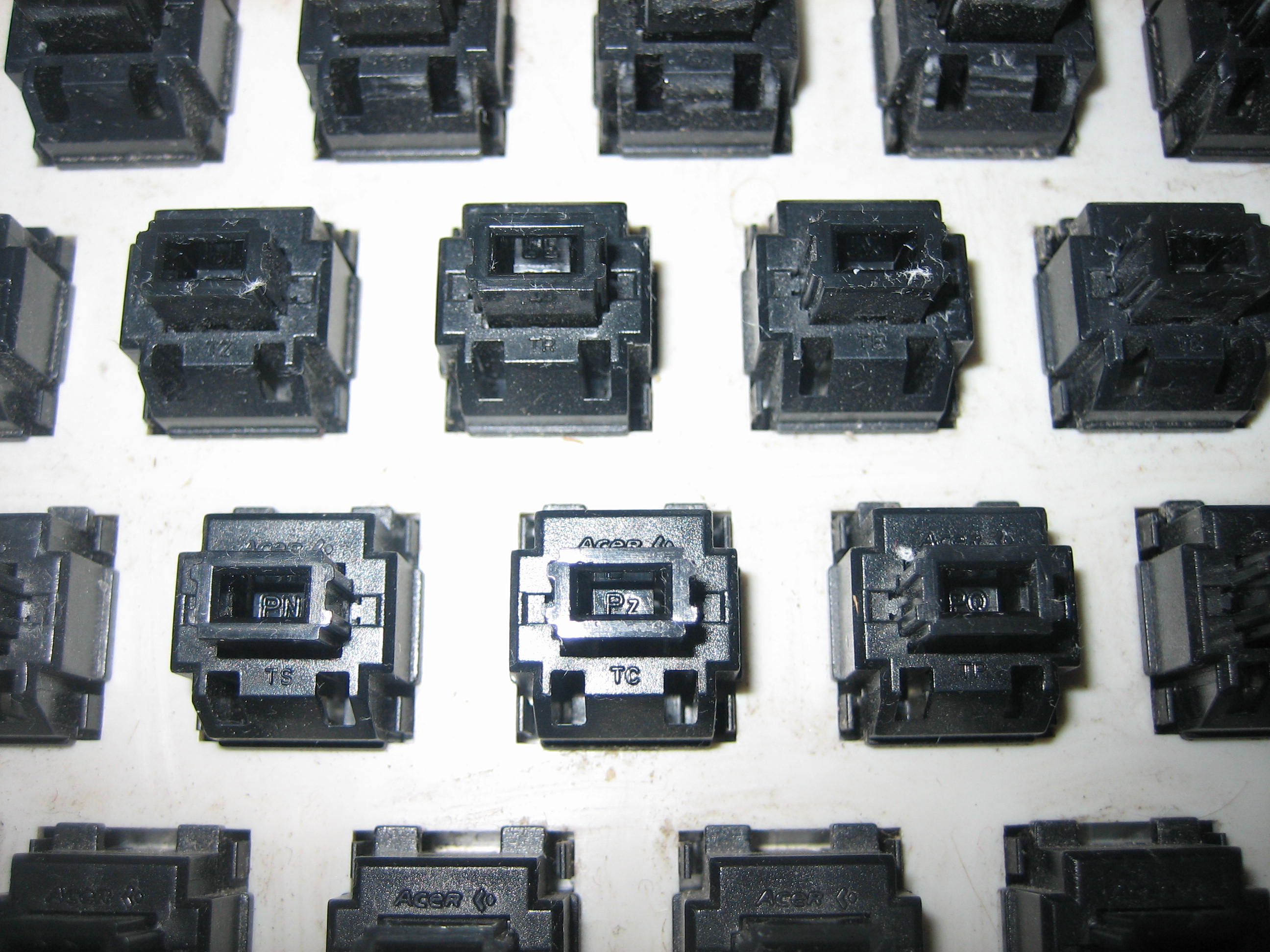

Those switches look like ALPS knock-offs. Are they compatible? The stems certainly lead me to believe they would be.
rodtang
21 May 2012, 10:48
koralatov wrote:Those switches look like ALPS knock-offs. Are they compatible? The stems certainly lead me to believe they would be.
Acer switches, they're compatible.

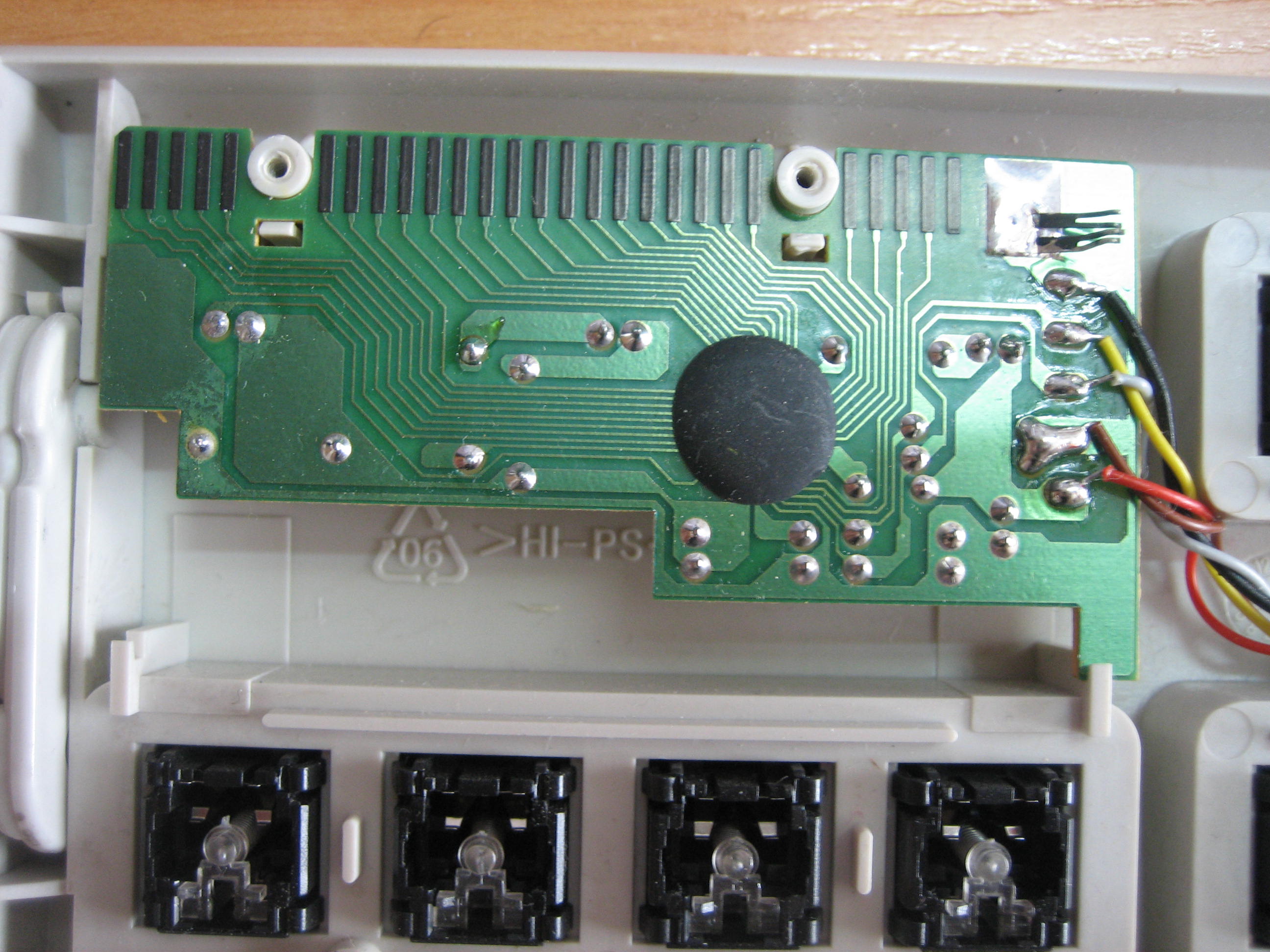

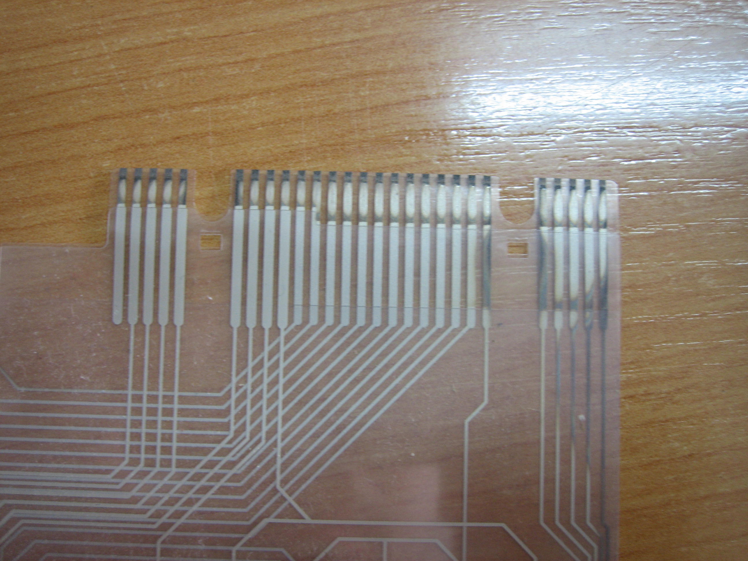

After cleaning up the inside of the board it worked angain, just to find out that some of the keys doens't work at all; the circuit board seems to be fine, but the circuit sheets are burned:
It's a shame, because it's very pleasant to type on it...

I am sending MrInterface two acer boards, which he will be taking apart for the switches. Perhaps you can talk him into sending you one of the controller boards.

In the past I had some success lightly sanding the lead surface on rubberdome sheets. However those were not that burned and mostyl intersections were troubled. Maybe worth a try. :?:
