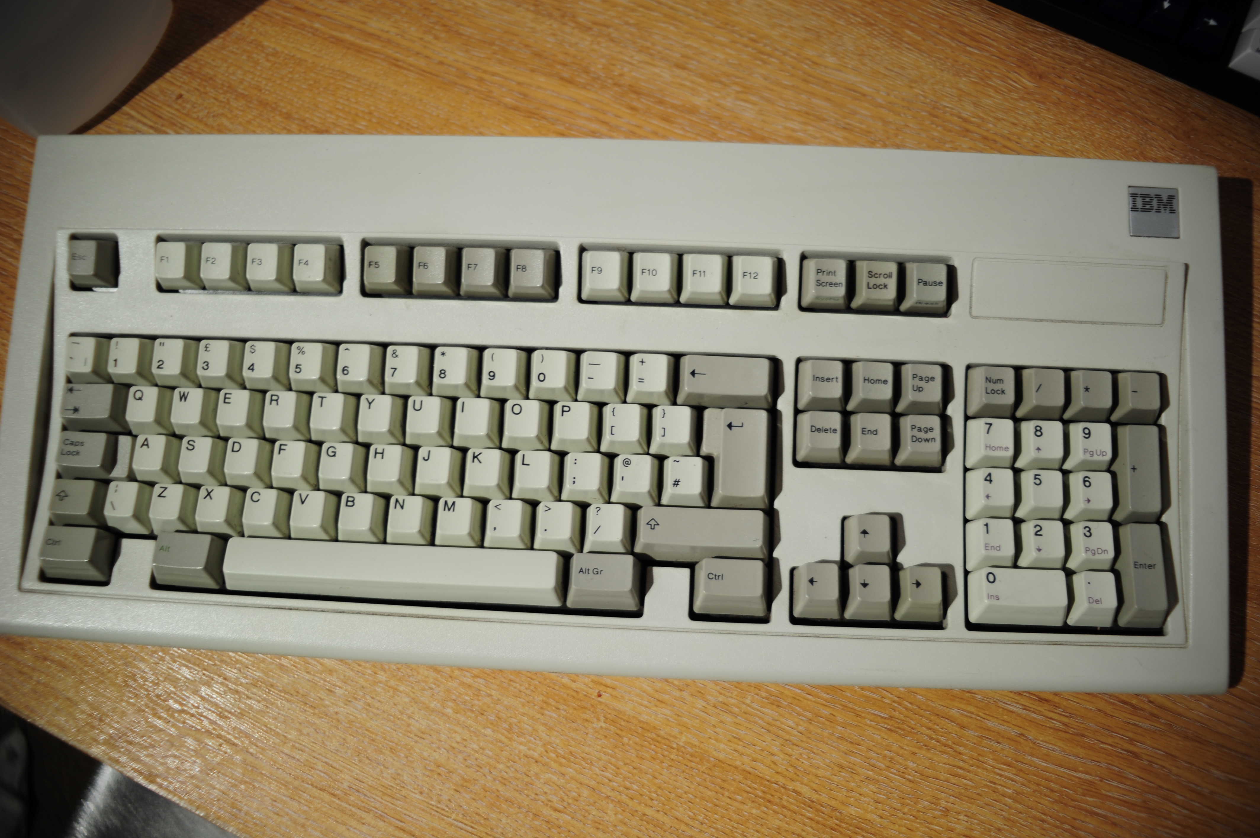

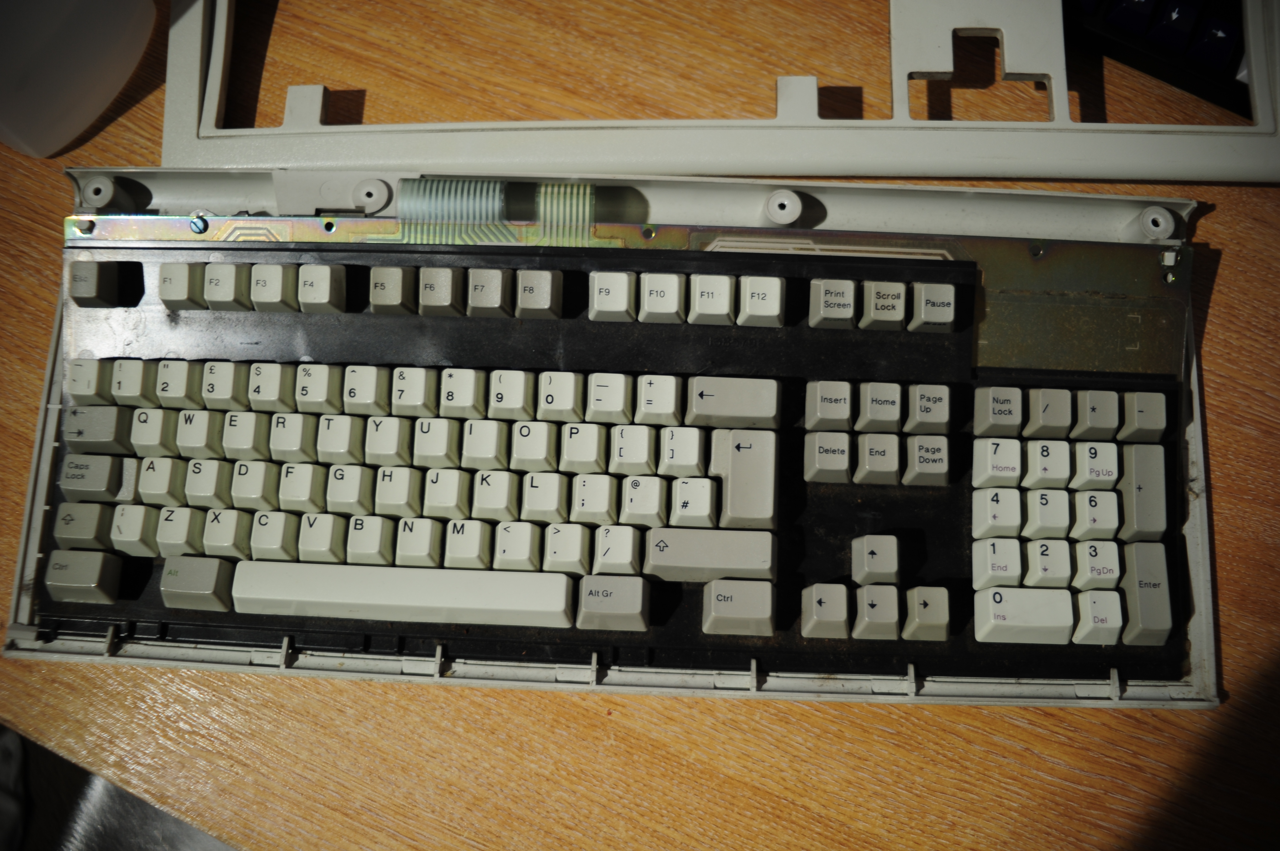

Hoping for some advice, I managed to get a decent looking 1986 Model M (manufactured pretty much on the day I was born too which made me want it even more!) - it's basically parts as it has no cable, but it looks to be a decent UK layout.
Cost me £80 which I am hoping wasn't too much, this is my first attempt at vintage IBM and I have read the square logo is the best quality, plus it's UK which I really wanted.

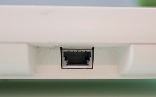

This is my first post here, but I know this is the forum where I am best asking about vintage models of this age, I can see the port connector but at this age it won't be PS/2 ?
It is a 1389969 and that apparrently was not for PCs, so I will need some kind of conversion, and also the original cable, this could be tricky!
Can anyone advise me what cable(s) I would need to get this up and running? Looking at the condition I assume it isn't broken as I bought it from a company that sells off business assets and they have no methods to test.
Any advice would be appreciated on this, and thanks!

This seems to be a PC keyboard, not a terminal keyboard (the non-split numpad+ and the printed legends on the modifiers and the numpad indicate so). Therefore, this unit should have an SDL port:
and take a (get ready for this) SDL cable. Unicomp still sells SDL-to-PS/2 cables: https://www.pckeyboard.com/page/product/1397449 and so does Clicky Keyboards: https://www.clickykeyboards.com/product ... rd-cables/ . You'll find them on eBay as well.
Another option would be to get an SDL-to-USB Soarer's Converter cable, like the ones Orihalcon makes and sells (see https://www.ebay.com/itm/282933562080/ for an example — do NOT get this one, though, as it's for a different kind of connector). Orihalcon is a DT member, so you can contact him directly.
HTH!

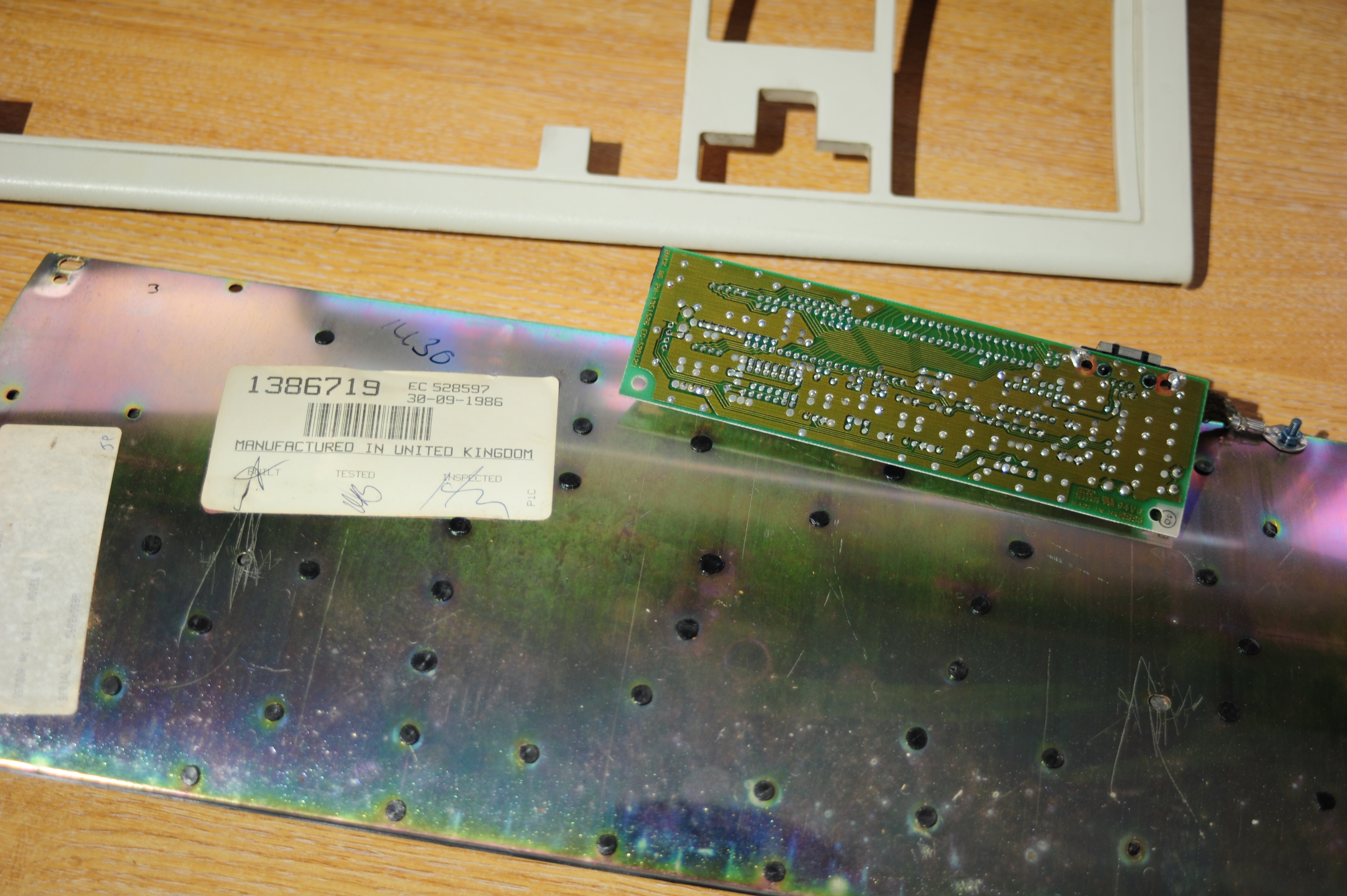

The P/N 1389969 indicates that, indeed, this is a PC Model M keyboard, with the English (UK) national layout. It indeed, looks like all its keycaps are original. The keyboard lacks lock lights because it was sold as a keyboard replacement for PC XT keyboards, but it should nevertheless work "out-of-the-box" with another computer.
The part number also indicates this is an early unit, too. At £80, it's a good price it the keyboard is in full working order, which should be the case (and if not, repairs should be easy). You'll surely get questions of the "Where did you get it? Are there any more of those?" kind; if we may ask, what is the mfg. date on the back label?

Thanks very much for the advice. It does in fact have the port as you indicated. I am very happy to hear it was in fact for the PC, from my reading on here I got concerned it wasn't. I think I will likely get both cable options, I will get the Unicomp one first just to make sure it works, thanks for this advice, I am really glad it wasn't a massive conversion needed on my first vintage IBM, save that for when I have a bit more IBM knowledge!

Again, thanks! Dated 30-09-1986, but this was the only one I saw and even with my limited knowledge I know the square logo was the best build quality - rather than a brand new one this sounds way better. Now to get the cable ordered!depletedvespene wrote: 15 Nov 2021, 10:49 The P/N 1389969 indicates that, indeed, this is a PC Model M keyboard, with the English (UK) national layout. It indeed, looks like all its keycaps are original. The keyboard lacks lock lights because it was sold as a keyboard replacement for PC XT keyboards, but it should nevertheless work "out-of-the-box" with another computer.

Nice. Looks like it still has most of the rivets too. I have the same model from the same year, and it's one of the best feeling Model Ms I've ever typed on. Enjoy!

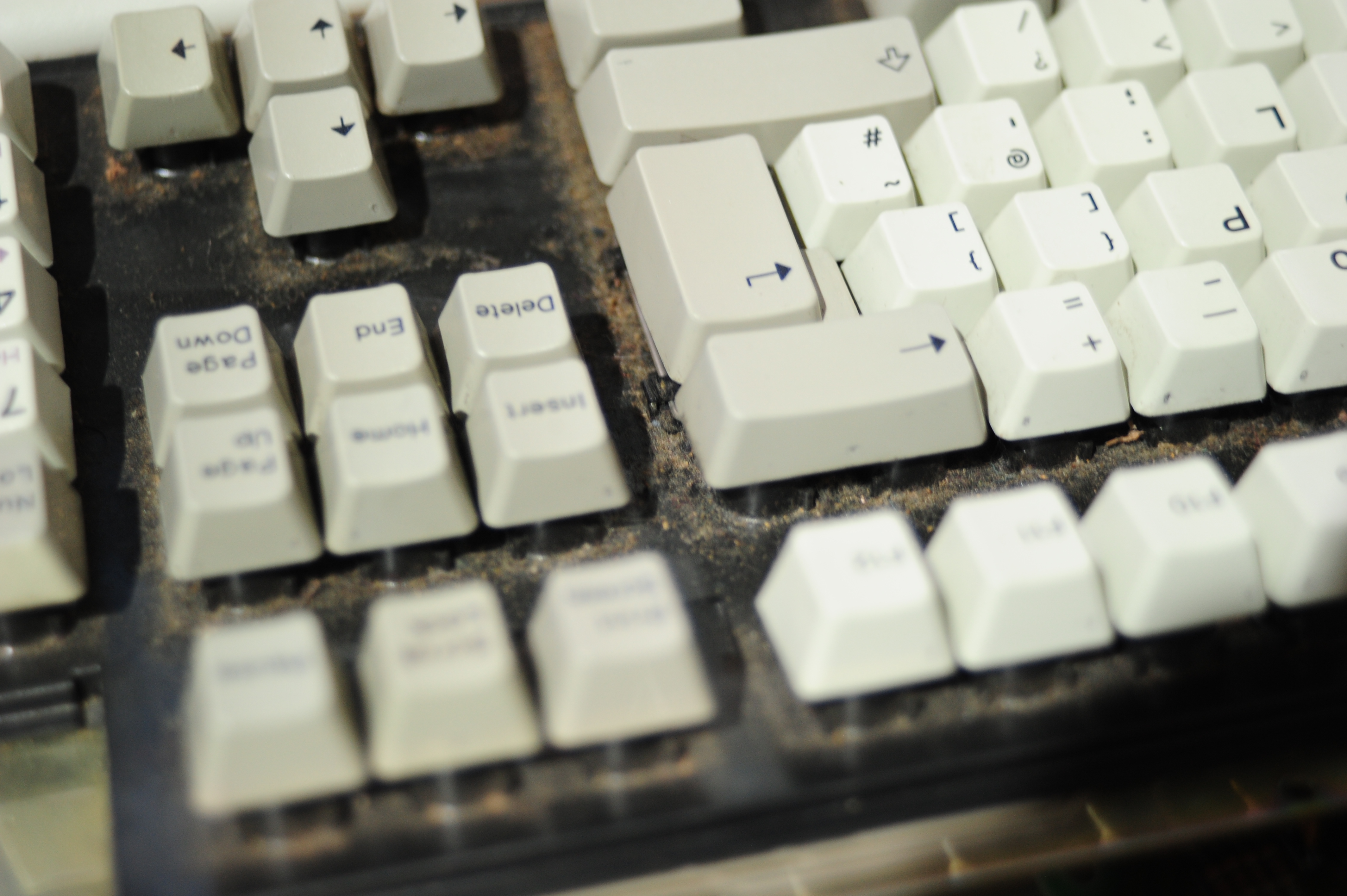

Yes I got quite lucky I think, when I opened it just a couple of rivets fell out and one plastic tab which I will fix back on. And thanks! It's my first Model M so I started with one of the best!digital_matthew wrote: 18 Nov 2021, 18:09 Nice. Looks like it still has most of the rivets too. I have the same model from the same year, and it's one of the best feeling Model Ms I've ever typed on. Enjoy!
