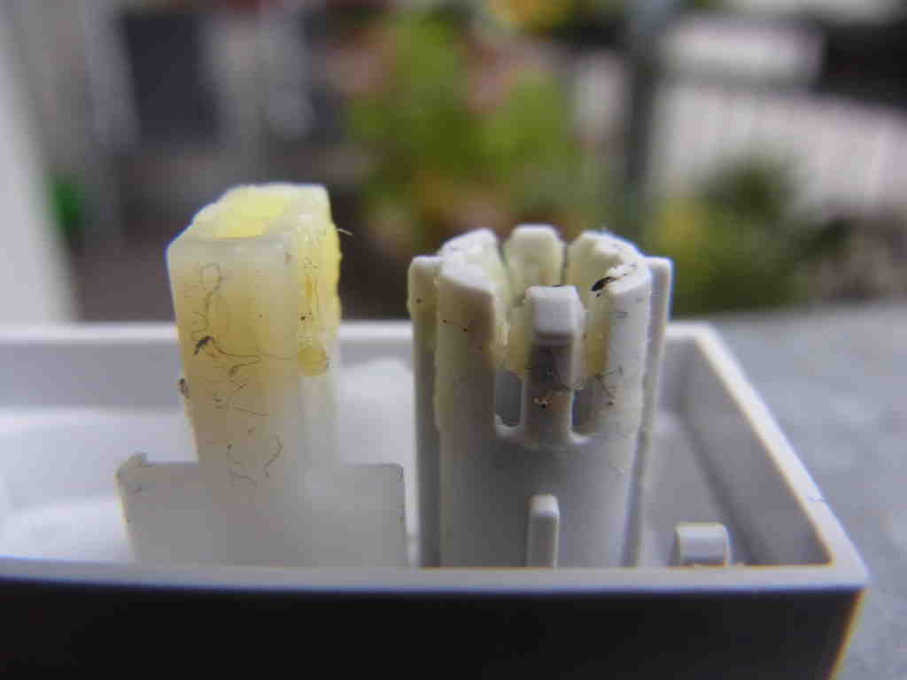

Ergonomic keyboard Fujitsu/Siemens KBPC E with rubberdomes needs deep cleaning.
My standard cleaning procedure for MX keycaps is to put them into the washing mashine together with some towels and use bleach-containing laundry detergents at >= 60°C. But the rubberdome steams are lubed with some unknown yellowish (yellowed?) lubricant:
My experience with my general purpose PTFE oil I normally use for MX switches (Chess Tools CT-421 Oil Pen PTFE 25) and other keyboards was not so good, since it messes the plastic foils and keys become stuck if they are pressed in the corners. Dry lube (Caramba PTFE spray, similar to WD40 and other products) makes the whole keyboard uncomfortable loud and rattly, even those not pressed. So I think it must be something with a higher viscosity than Krytox GPL 205, maybe GPL 206?
Are there any recommendations for relubing rubberdomes?

WD-40 Specialist with PTFE works well. Wax might work too on these but I haven't yet found a method to finely apply it yet (coming soon)

I always use GT85 thin PTFE spray lube for topre and rubber domes. I imagine wd40 with PTFE is pretty much the same thing. I really think most of the krytox and mechlubes to be overpriced for what they are

Krytox is indeed pretty expensive. Aliexpress lube works fine from my experience if you don't want to spend too much on lubricant.

NOTHING worked for my Microsoft Natural Keyboard Pro :x
Some keys (especially those larger ones in the bottom row but also some letters) were getting stuck when not pressed in their centres. Tried various lubricants and cleaning many times.

That could be an issue with the domes wearing out as well.
