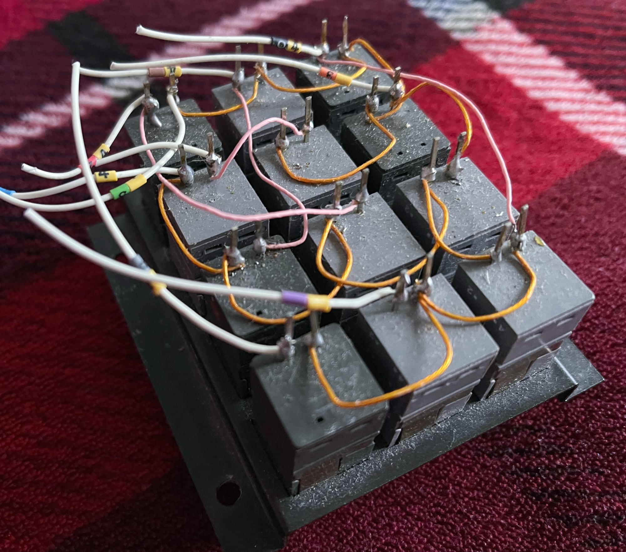

Here's a numpad my old man gave me. He doesn't know its story, just saw that it is old. Seems to be a hand wired job, with very large Clare Pendar SF2101 switches.
Numpad face.jpg (335.77 KiB) Viewed 1376 times
Numpad matrix.jpg (423.67 KiB) Viewed 1376 times

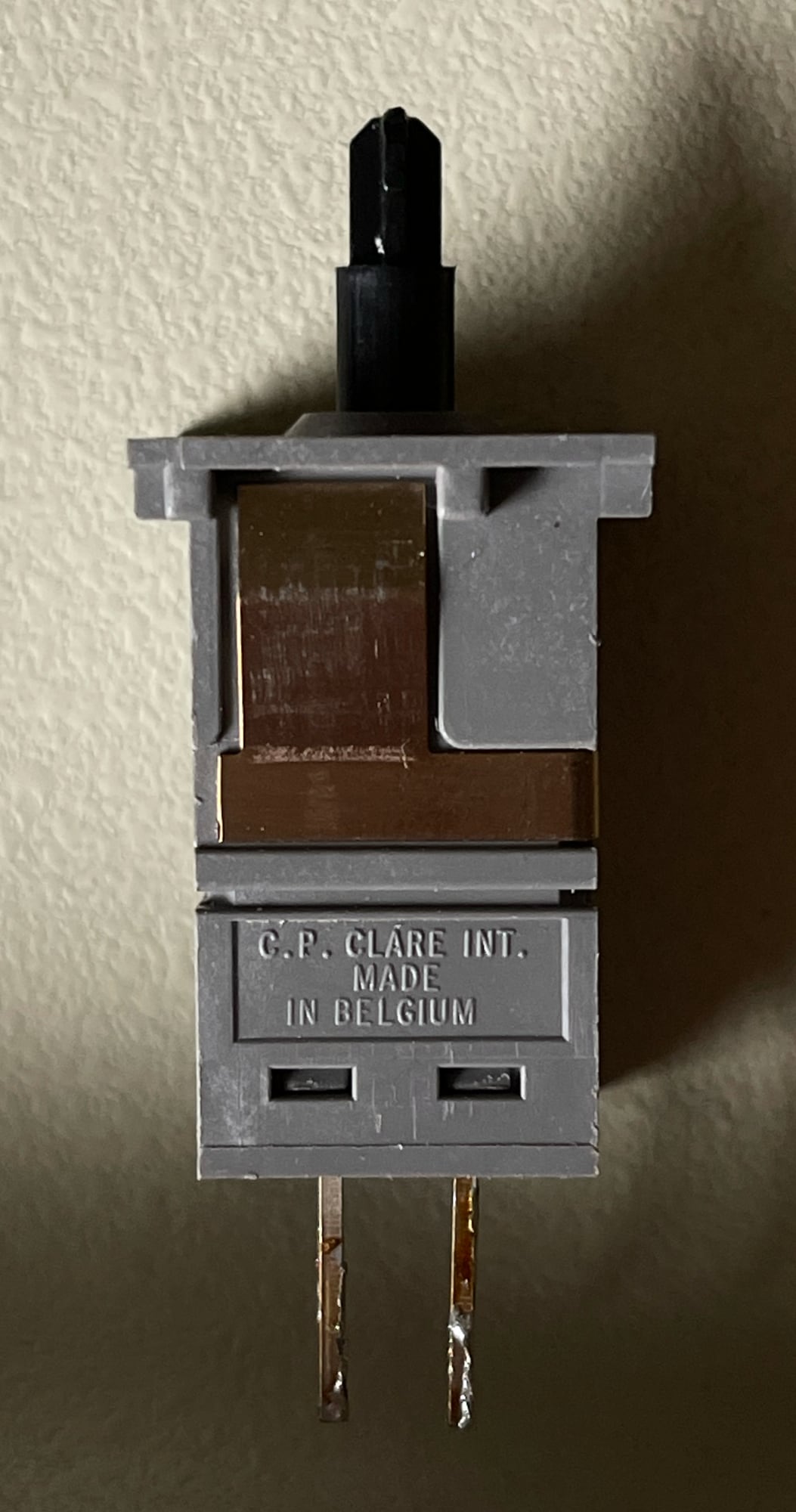

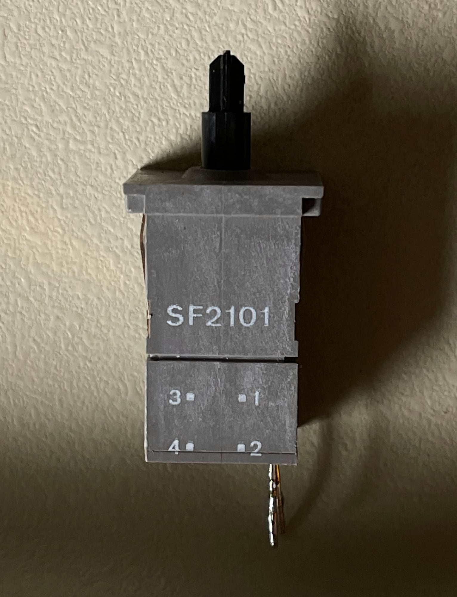

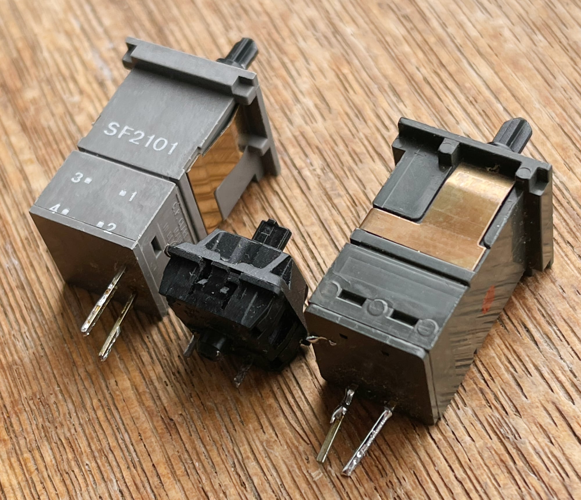

Here's one pulled out:
Switch SF2101.jpg (237.31 KiB) Viewed 1376 times
Switch made in Belgium.jpg (161.22 KiB) Viewed 1376 times
When I saw "Clare" I thought Clare Pendar. I don't see SF2101 switches on the wiki yet. Are these still to be documented?

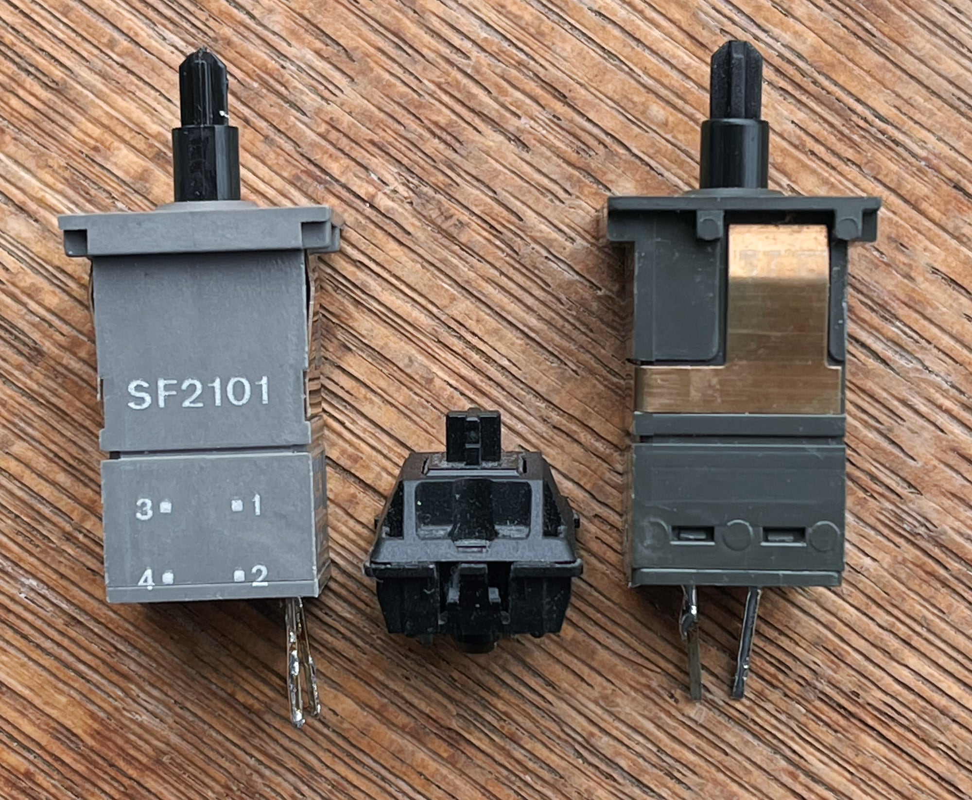

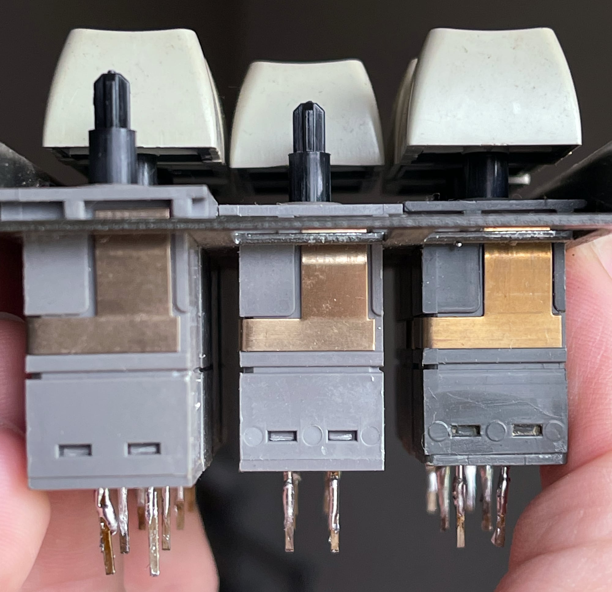

Switch family shot.jpg (501.38 KiB) Viewed 1376 times

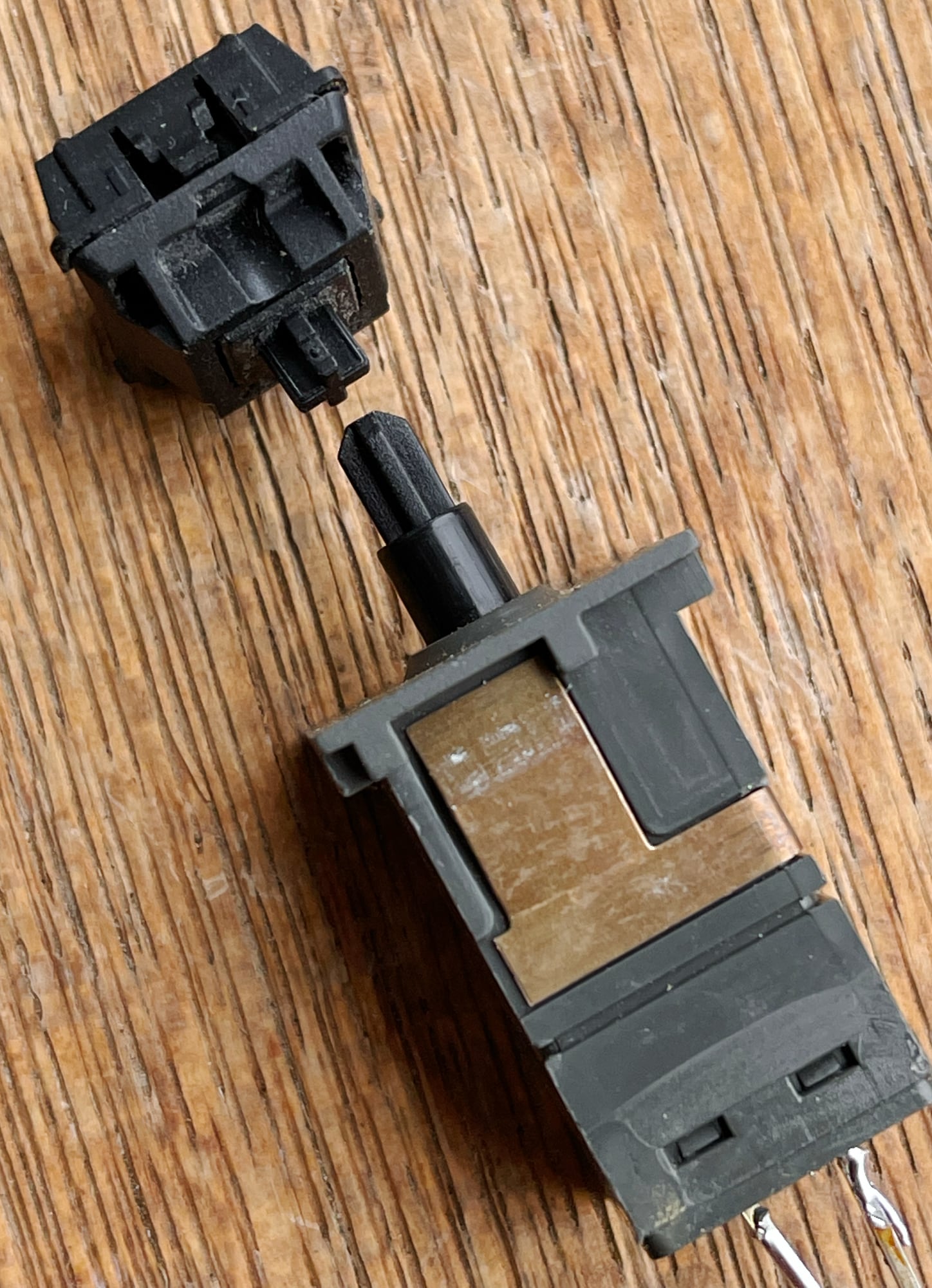

They are conspicuously deep! About the same size as beamspring switch modules.
Switches thicc.jpg (307.34 KiB) Viewed 1376 times

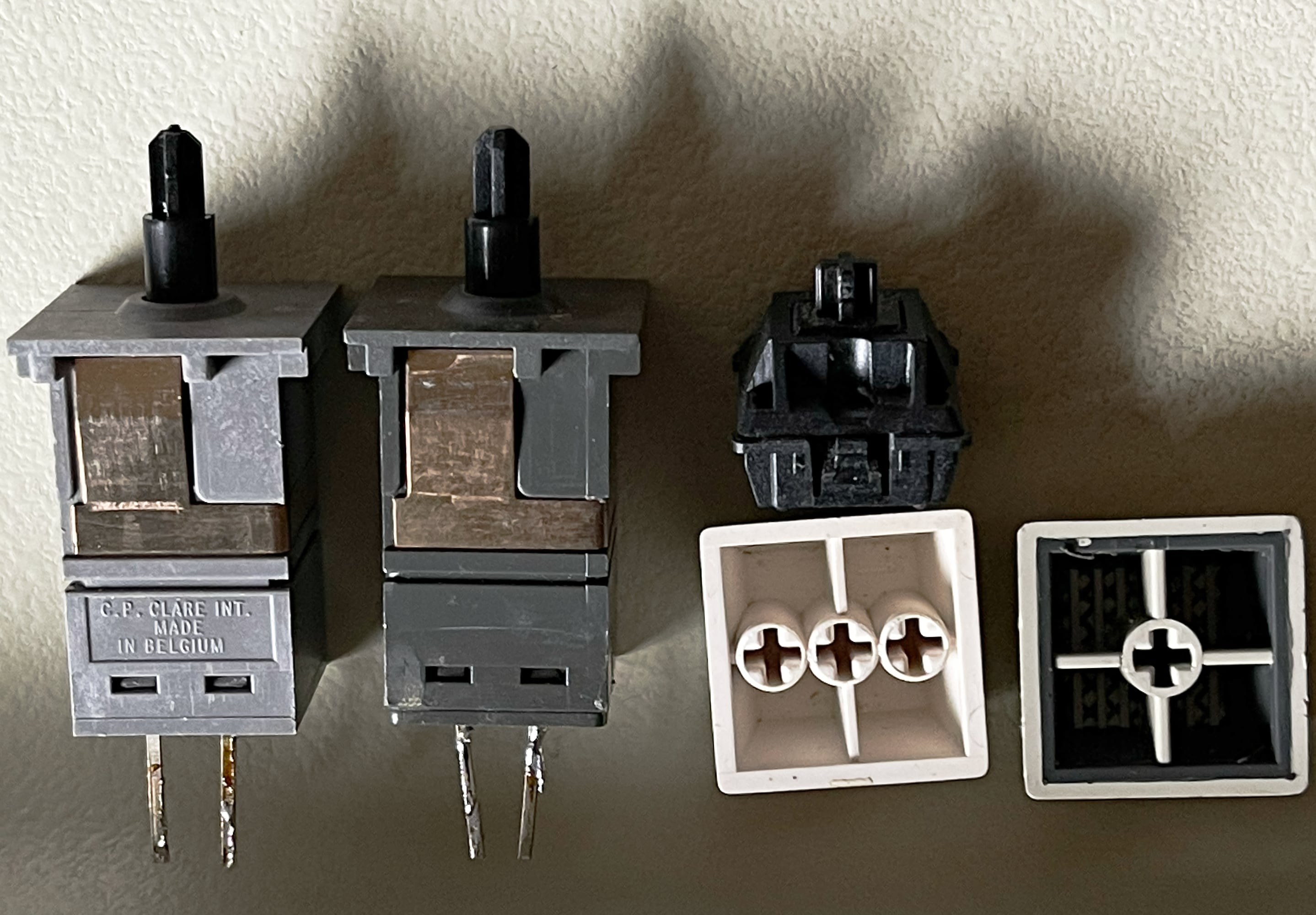

Here's an MX black size comparison:
Switch oblique.jpg (422.38 KiB) Viewed 1376 times
There's two different shades of switches in this pad. They're definitely the same feel and family, but may be different revisions. The outer shells are subtly different. The pale ones have the made in Belgium mark while the darker ones have the model number.
Switches plan.jpg (509.3 KiB) Viewed 1376 times
The travel is a good bit deeper than MX, and the weight is definitely lighter, in that sweet spot between MX black and red. They're pretty smooth linears. Very little scratchiness compared to my vintage MX black, and about the same wobble. You can feel the switch contacts so they're not as smooth as Topre but fairly nice.

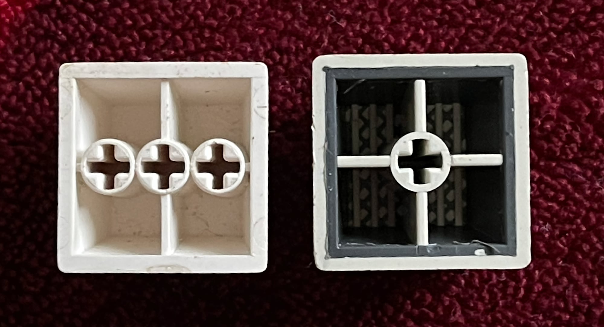

Switch crossmount.jpg (402.02 KiB) Viewed 1376 times
The mount is cruciform but a bit smaller than MX, so no caps compatibility.

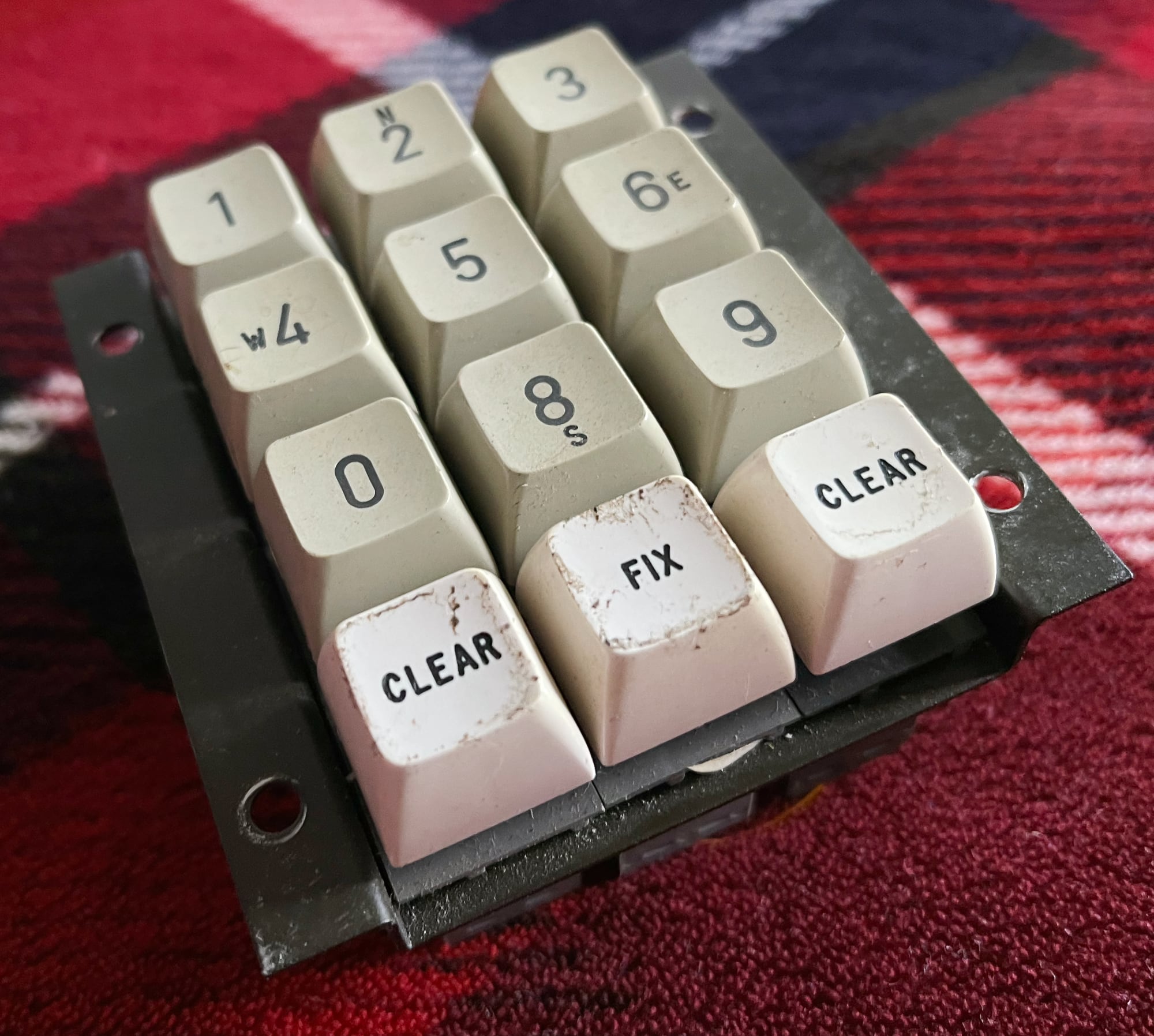

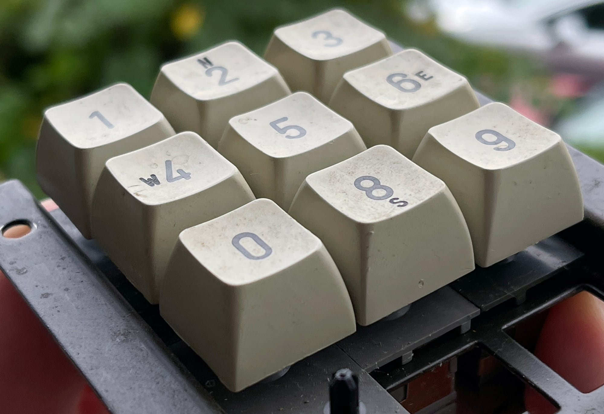

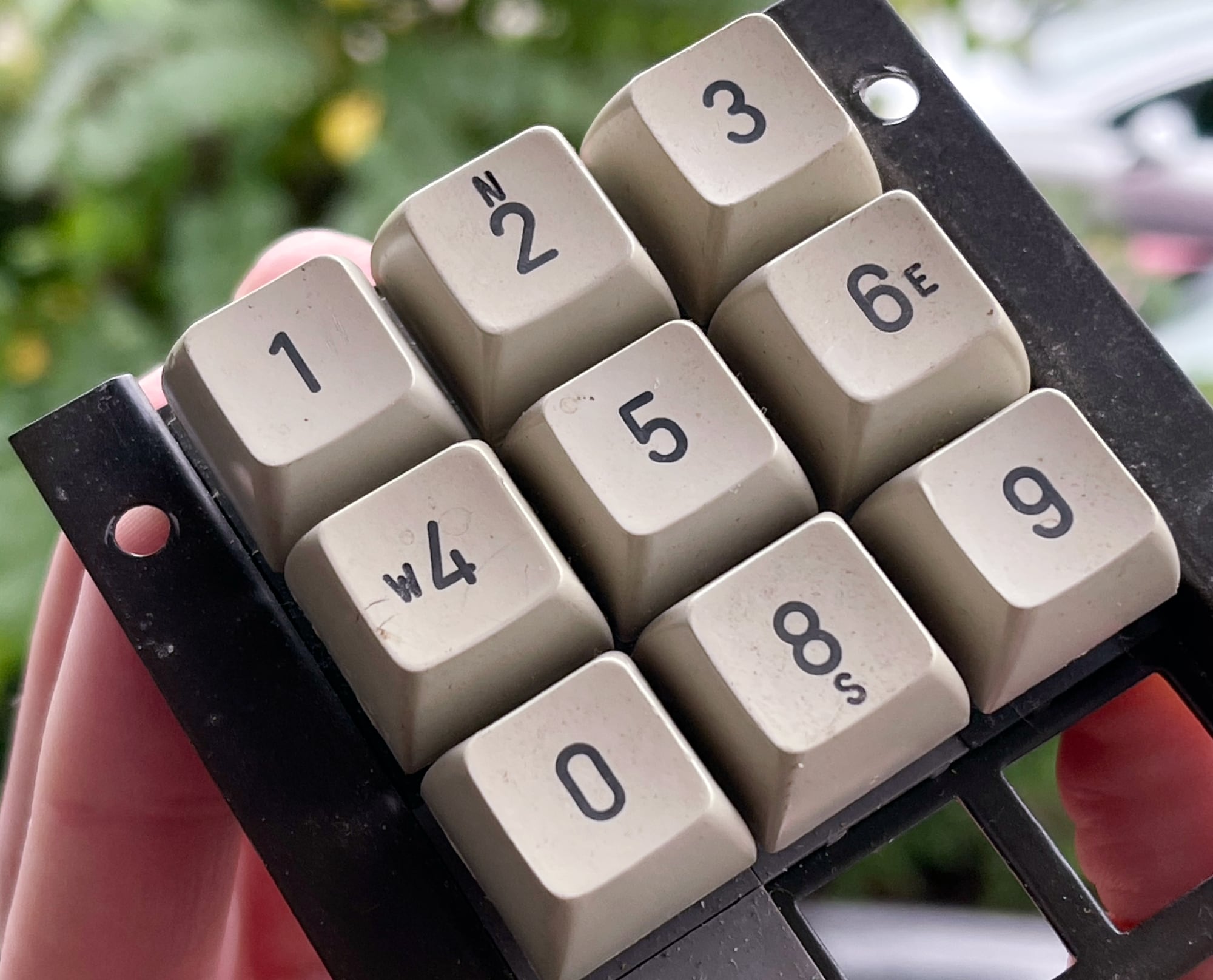

As for the caps: they're a mix of doubleshots (with a single + mount) and whiter blanks (with +++) with what may just be stickers on them. The "compass" keys have a doubleshot numeric legend and an engraved bearing. They're kinda neat.
Numpad engraved high.jpg (262.36 KiB) Viewed 1376 times
Numpad engraved.jpg (196.17 KiB) Viewed 1376 times

19 Oct 2021, 17:02
Ah, here we go: I reckon they're these. (Though without a picture to check, I'm not sure.)
wiki/Clare/Pendar_high_profile_reed
Notably, this page is not in the DT Wiki Clare Pendar switch list I found earlier. Had to poke round a bit. Which also dug up this:
viewtopic.php?f=62&t=9926&start=
Knew I'd seen something similar before! :lol:
