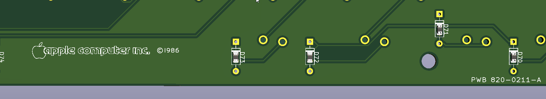

Please ignore 3d models of pin headers, KiCad spams those out and I can't be bothered to remove them

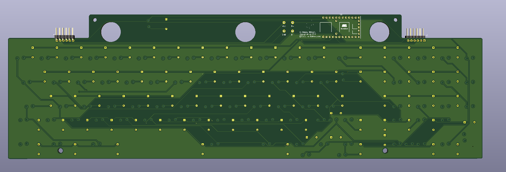

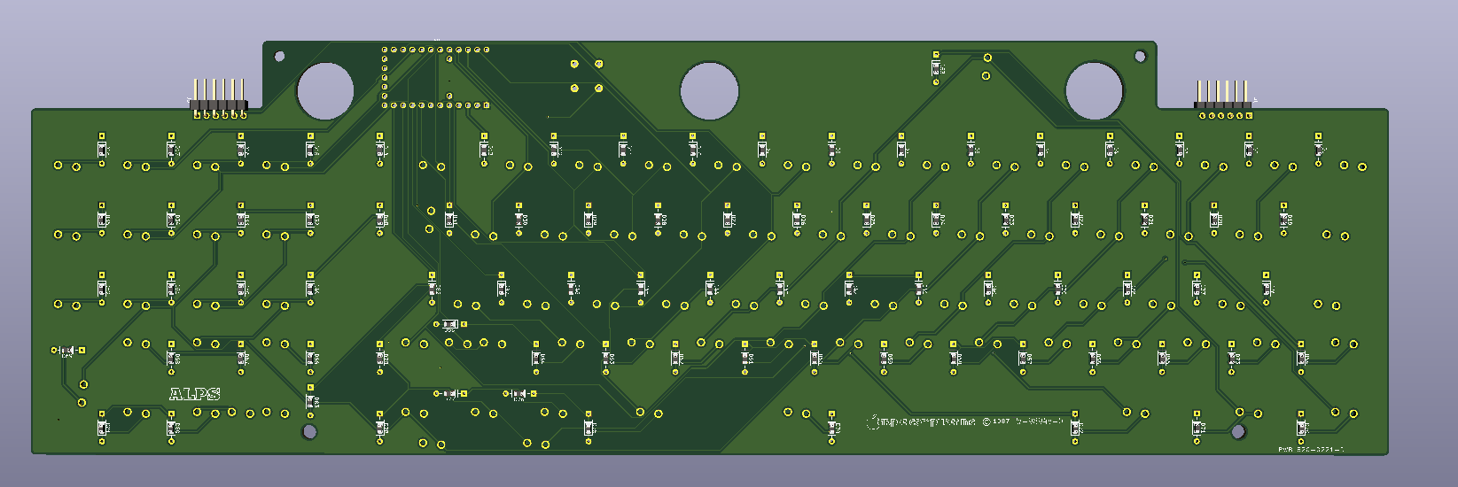

M0116 front
M0116 front
M0116 back
M0116 back

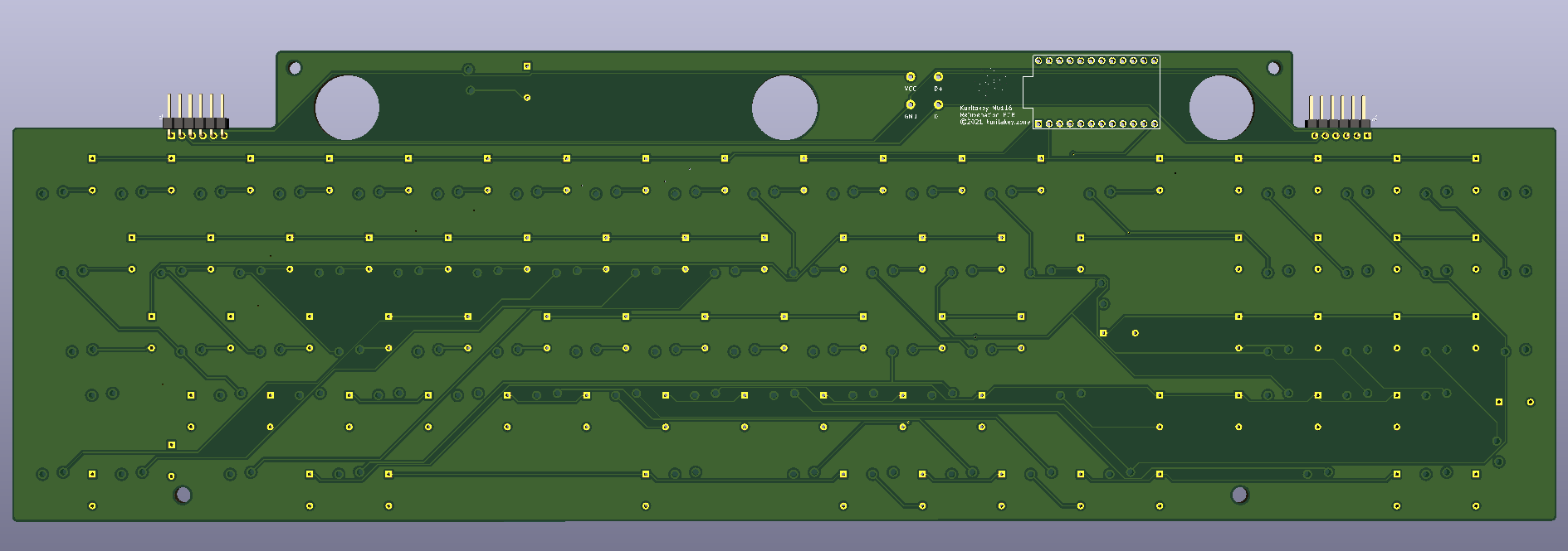

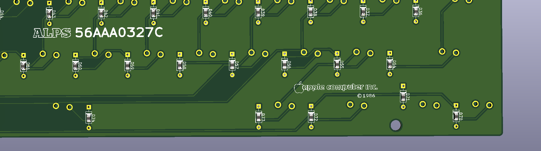

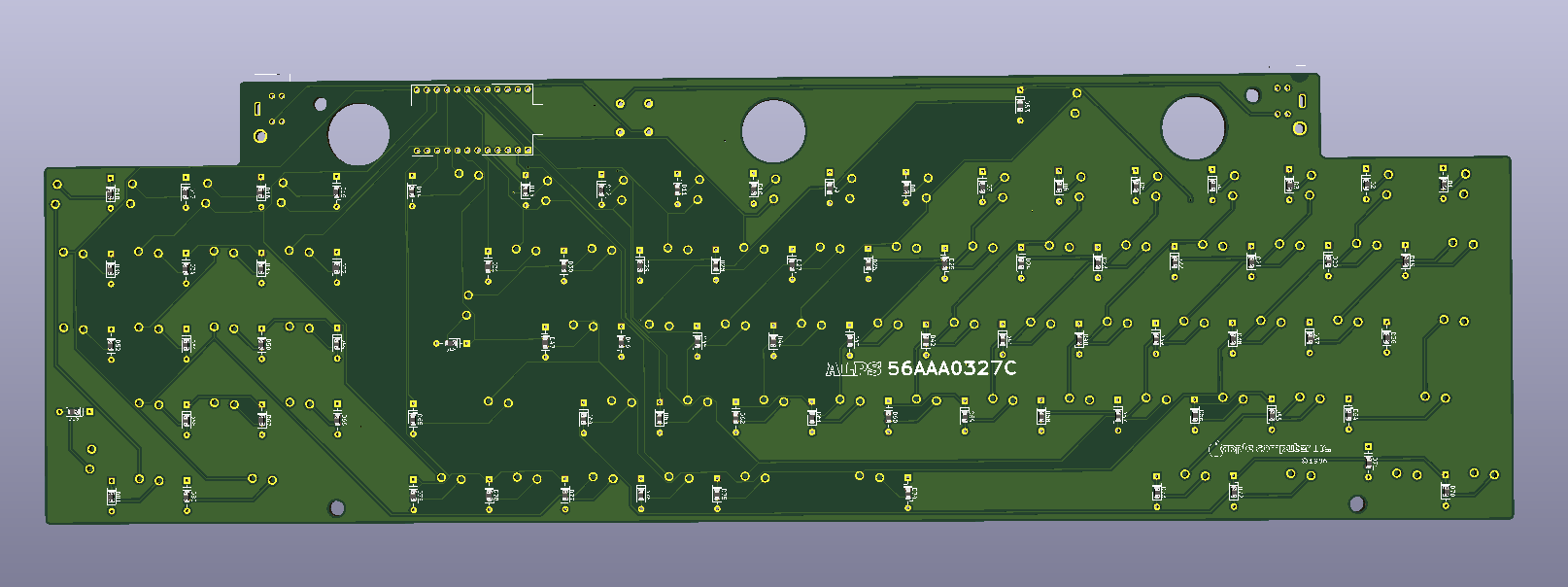

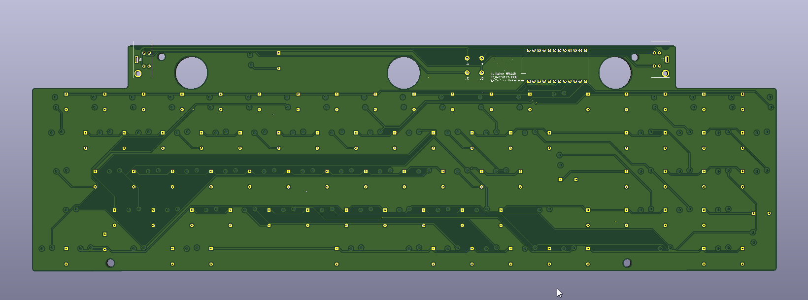

M0118 front
M0118 front
M0118 back
M0118 back

These PCBs are designed to be unobtrusive as possible! It will ship in classic green and carries faithful rear markings copied from the original PCB. Modern markings kept to a tasteful minimum.
