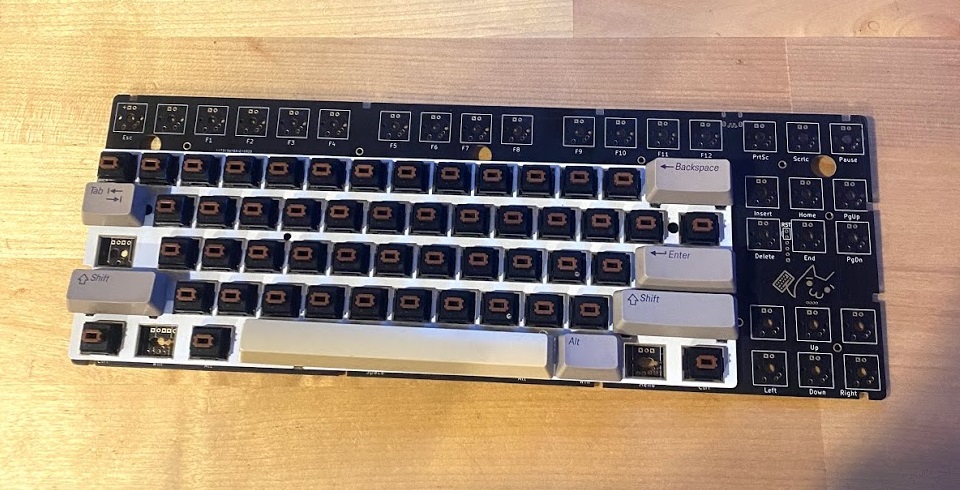

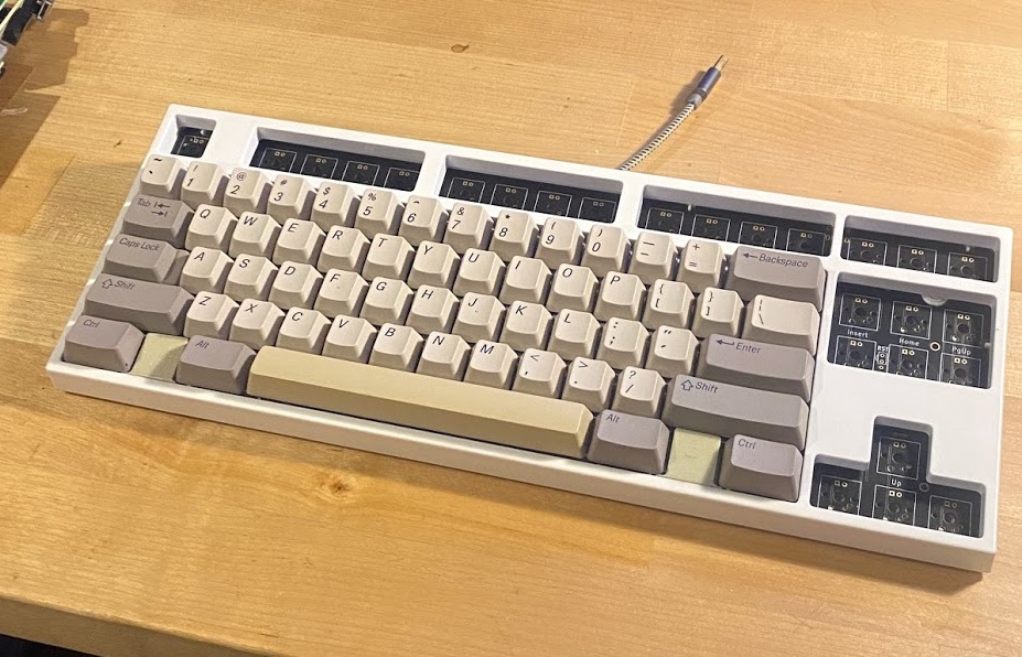

First I fitted the 60% Plate, soldered the SKCM Brown switches and made sure the stabilizers were working well
step 1.jpg (211.39 KiB) Viewed 6729 times

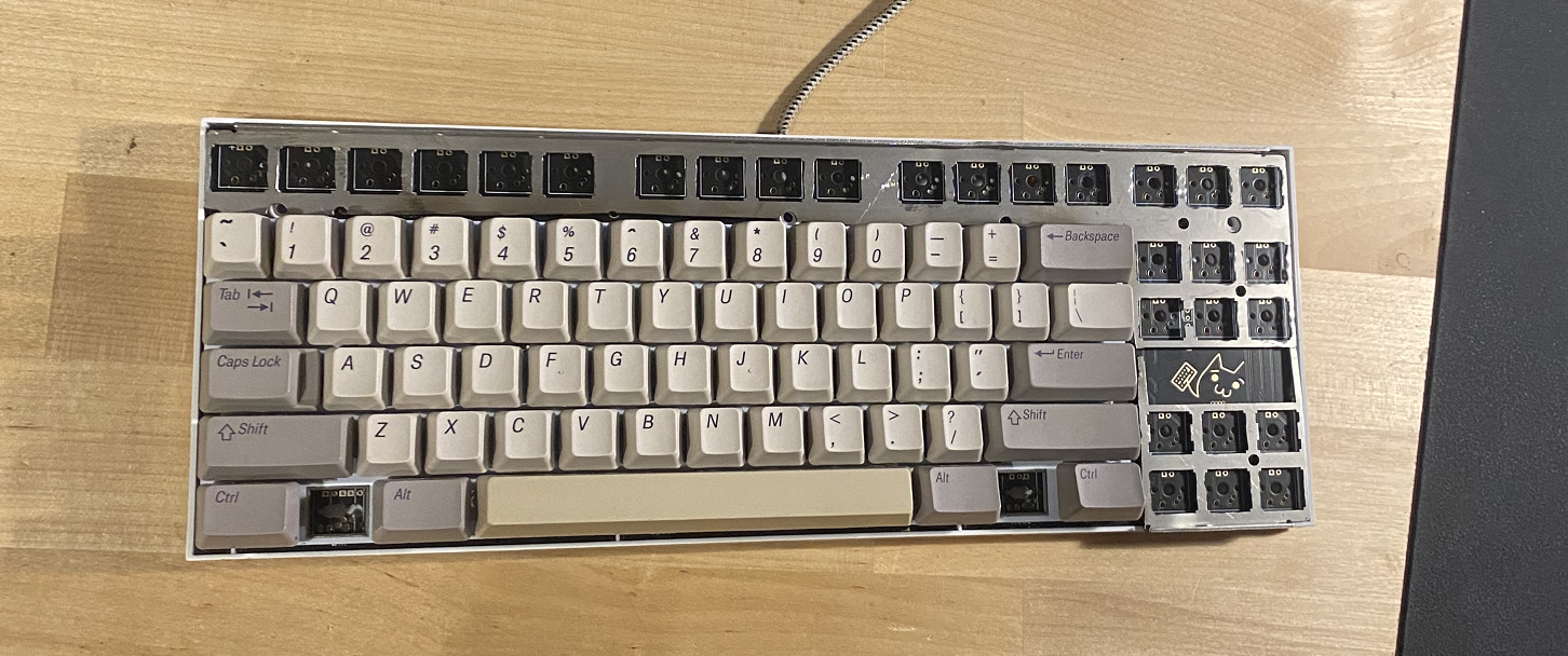

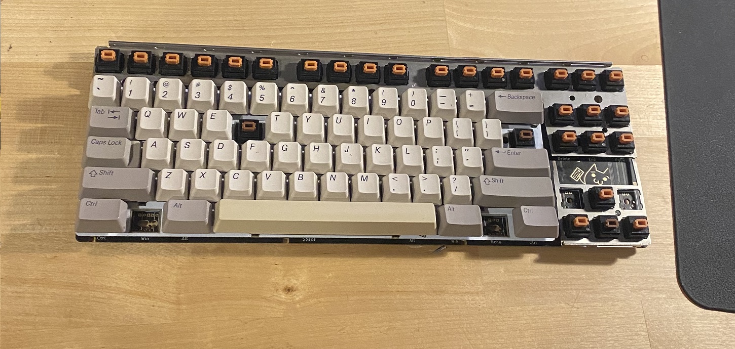

Second I cut out the 60% portion of the XD87 TKL Plate and hand filed Cherry MX openings to be just the right size for Alps switches
test fit.png (1.35 MiB) Viewed 6733 times
second plate.jpg (391.8 KiB) Viewed 6733 times

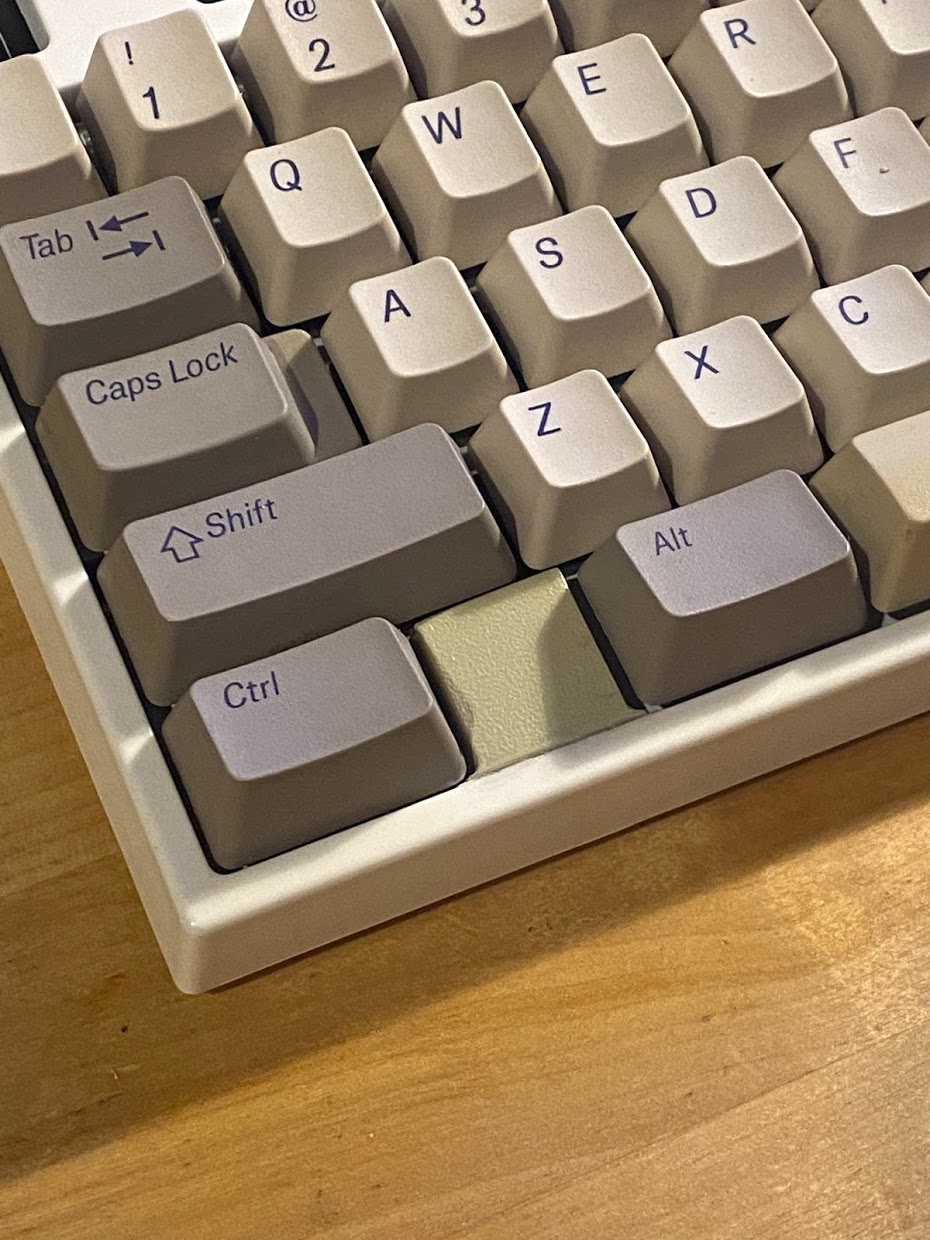

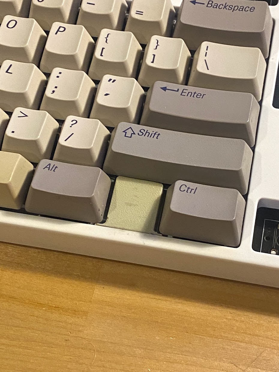

I really wanted to make this Winkeyless so I decided to add some home made blockers to the XD87 case
winkey 1.jpg (213.88 KiB) Viewed 6733 times
winkey 2.jpg (195.55 KiB) Viewed 6733 times
after winkey.jpg (214.17 KiB) Viewed 6729 times

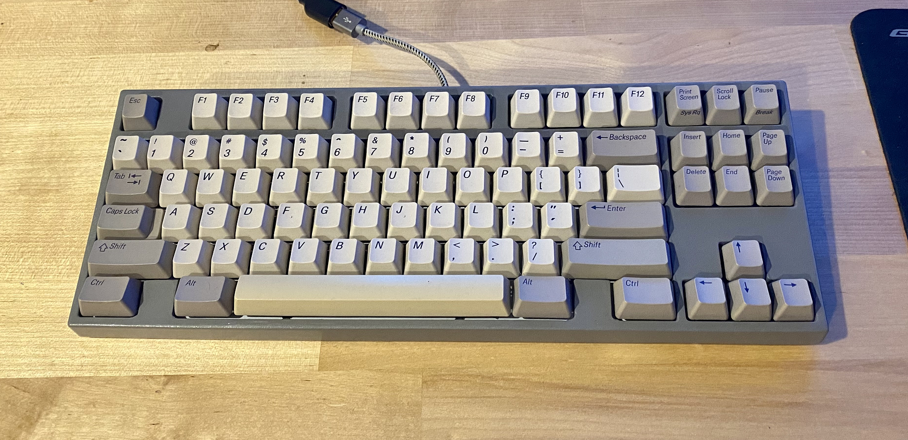

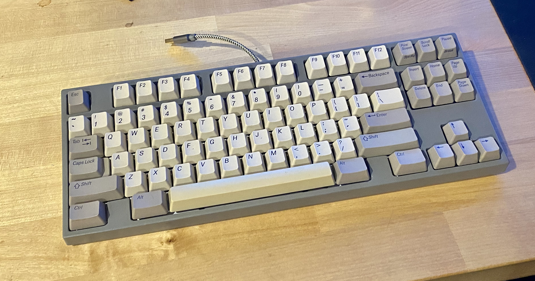

When at the store deciding what to paint the case, I saw a can of 'Granite' spray paint. So in order to compliment the SGI Granite keycaps I chose this color. Here is the finished project.
final 1.png (3.99 MiB) Viewed 6733 times
final 2.png (3.61 MiB) Viewed 6733 times
