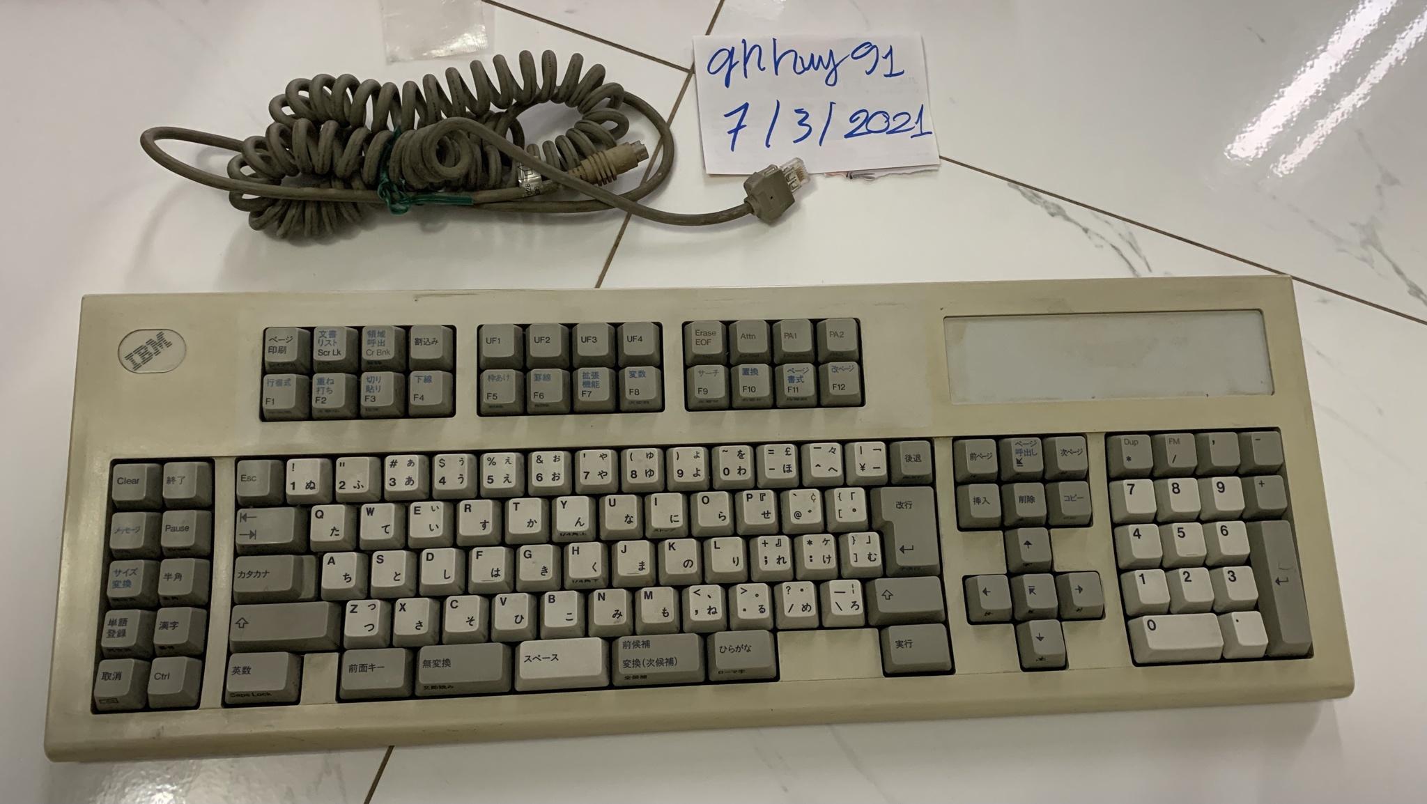

I recently acquired an IBM 5576-001. It sorta has 5 split space bars. One's really a caps lock key. Two are read as space bars in Windows 10 non-Japanese. I don't remember if the other two do anything, as the keyboard is currently on my bench and taken apart, I can't check. I'm really hoping I can re-map stuff with just SharpKeys and/or SharpKeys + AutoHotKey.

hellothere wrote: 18 Jul 2021, 19:58 I recently acquired an IBM 5576-001. It sorta has 5 split space bars. One's really a caps lock key. Two are read as space bars in Windows 10 non-Japanese. I don't remember if the other two do anything, as the keyboard is currently on my bench and taken apart, I can't check. I'm really hoping I can re-map stuff with just SharpKeys and/or SharpKeys + AutoHotKey.
1. I'm jealous
2. If you mean the keys I think you mean then they're basically for cycling through the "autocorrect" suggestions that IME brings up in Japanese input mode, but Idk if they will do anything in another logical layout in the OS. On my JIS boards, there is only ever one bar that produces the Space scancode, IIRC; the rest do other things all related to JIS/IME input and nothing on UK layout. I just flip back and forth between UK and Japanese with Alt + LShift as needed.
1. I'm jealous
1. Good :D. I need to do some cleaning -- maybe including retr0bright -- and replace at least two switches. Two key caps are also missing. One's the > key, so I'm going to have to replace both <> to make it look even.
2. Yup. I've seen the "autocorrect suggestions" in operation on Japanese keyboards before. I don't read or speak Japanese, so that functionality is somewhat useless. However, the actual space bar, as detected by Windows is exactly in the spot I hit when I'm using a "normal" keyboard, so no adjustment needed on my part. It's kinda-sorta between C and V.
One thing I'd really like is to have a translation of all the legends on all the keys. Just because.
The odd thing to me is the, oh, 6" x 4" plastic cover over the lock lights. Why do that? I can see at least num lock through the cover, anyhow.

hellothere wrote: 20 Jul 2021, 02:35 One thing I'd really like is to have a translation of all the legends on all the keys. Just because.
I can do that if you like. Chuck me a clear photo or two of your particular board just in case there's any individual variation and I'll see what I can do.
