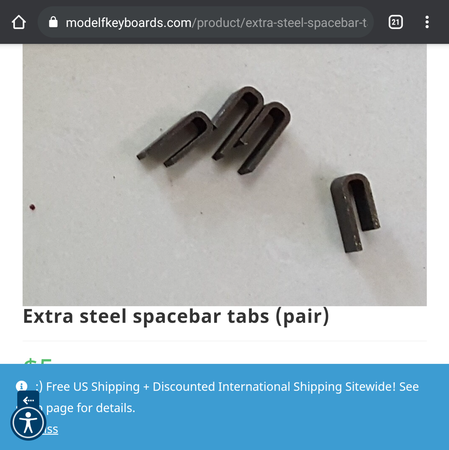

Ended up epoxying down two of the wire catches from another spot on the board. If you don't have the spares you could make something similar I would guess. https://geekhack.org/index.php?topic=52379

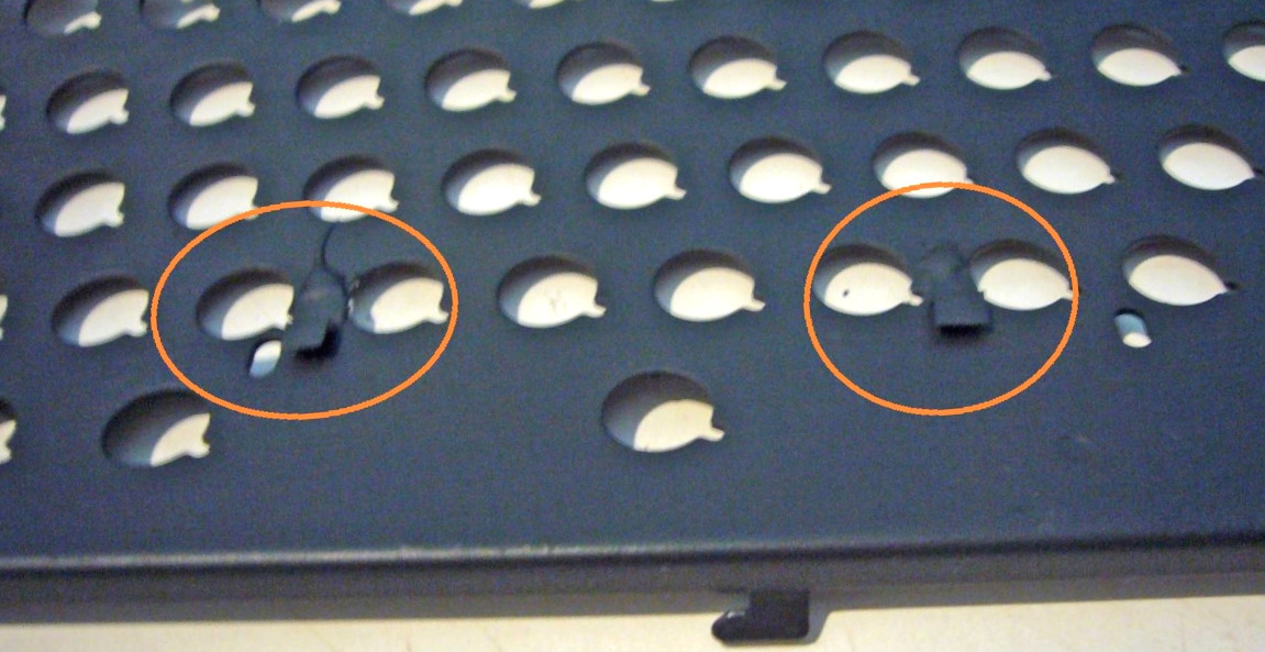

I have done this several times. Epoxy the tabs to bare metal, otherwise the paint layer might separate.
The tabs were bent strips of sheet metal. Cuts from food tins are a bit flexible but work well enough.
- IBM-F-spacebar-tabs.jpg (191.4 KiB) Viewed 2005 times

I used 0.2mm steel tinplate, bent into a U shape and epoxied down. No problems since, though it'll be a pain to remove if that's ever needed.fohat wrote: 01 Jul 2021, 15:36 I have done this several times. Epoxy the tabs to bare metal, otherwise the paint layer might separate.
