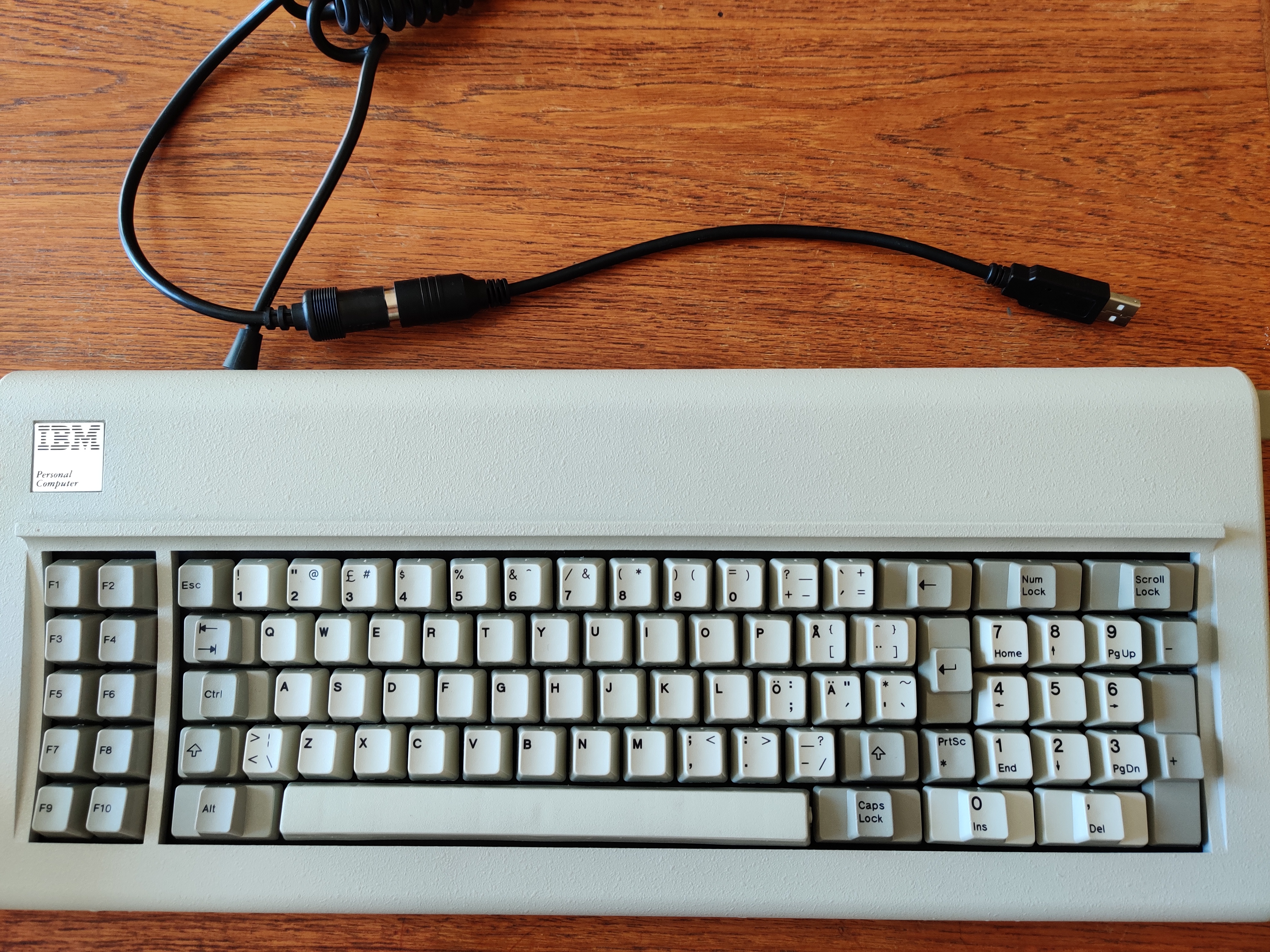

Hi,
Original poster here, sorry for being away, and thanks for all your kind help.
It cleaned up nicely
2021-06-04 12.05.24.jpg (4.27 MiB) Viewed 5308 times
This board is the XT variety, and the Soarer's is of the commercial kind. Just an extension plug, no circuit board board. The layout is Swedish.
Ctrl + Alt doesn't make Alt Gr in this case. I'll be able to remap it later, but I haven't figured out how to work the converter on Linux yet. Maybe I'll need to make the hex-files from scratch.
After some testing, I've found that the third (and fourth) letters are reached by changing language settings on the computer side. That's not bad, but it's a bit of a hassle to change language just to write an @-sign.
That's where I'm at right now. Any thoughts?

Posted: 04 Jun 2021, 12:37
by Bjerrk
wim_board wrote: 04 Jun 2021, 12:18 Hi,
2021-06-04 12.05.24.jpgThis board is the XT variety, and the Soarer's is of the commercial kind. Just an extension plug, no circuit board board. The layout is Swedish.
Hi wim, did you read the posts above? You can absolutely map another key of your choice to AltGr.
If you need help with Soarer's on Linux, just say the word. There's lots of us using a proper operating system here :-)

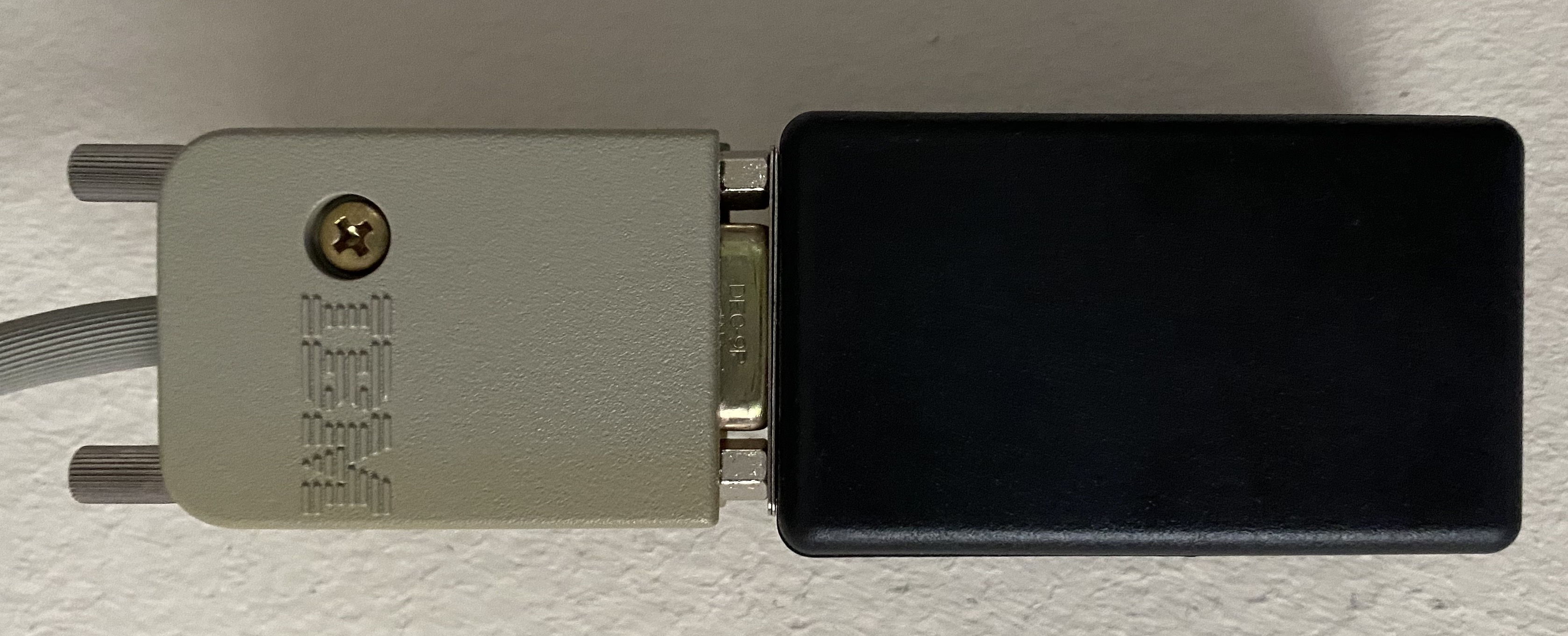

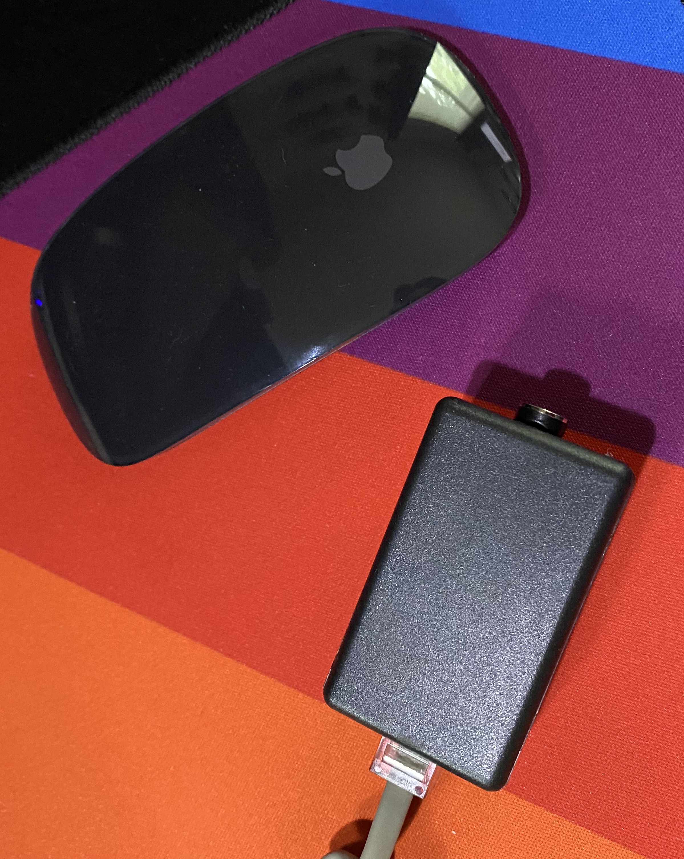

BOM:
Project Box
Optional magnetic cable to protect the Pro Micro's delicate socket - extra tips available separately
Pro Micro
Some flavor of breakout-style connector for what I need:
https://www.amazon.com/gp/product/B0814LTB6L/
https://www.amazon.com/gp/product/B08HGS5G8N/
https://www.amazon.com/gp/product/B083925STQ/
https://www.amazon.com/gp/product/B01HM6UBN0/
Here are some finished products:
IMG_0638 copy.jpg (915.74 KiB) Viewed 5163 times
IMG_0636 copy.jpg (1.74 MiB) Viewed 5163 times
Re: IBM Model F third layer
