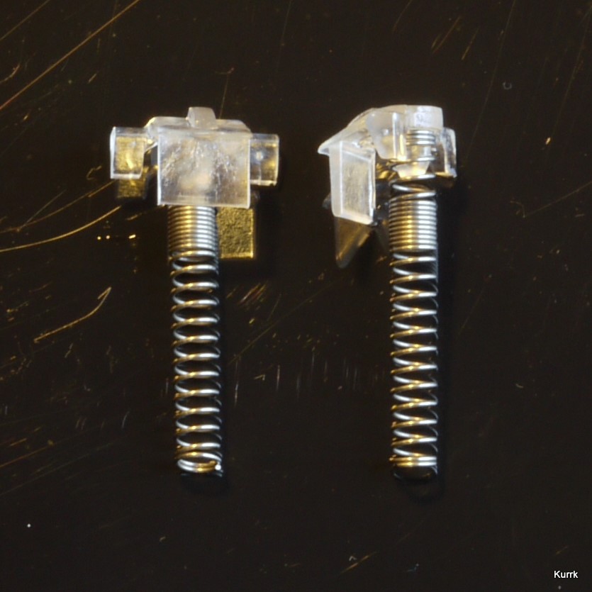

Another interesting thing are the springs themselves. All Cantech/Syncan springs have a tight winding section at the bottom near where they connect to the hammer. I think the spring design was actually the main patented feature of the technology. I think the tight winding at the bottom of the spring reduces the buckle force, but maybe someone can add in the appropriate spring science to make sense of it. Model M springs are consistent all the way up.
First generation hammers were very loud as you can tell from the Chyrosran video. Second generation hammers are MUCH quieter, quieter than the sound of a Model M. I think that lip and winding position on the first generation really increased the sound of the spring snap, the spring would buckle right into it, and I suspect they realized it was way to loud so they removed it on the second generation.
Travel is about 4mm with actuation around the middle at 2mm. Actuation force on these is much less than an Model M about 55g. This is likely due to the spring design. This was the major positive Chyrosran noted that if the keyboard was a little better executed the key weight is more daily usable than a Model M.

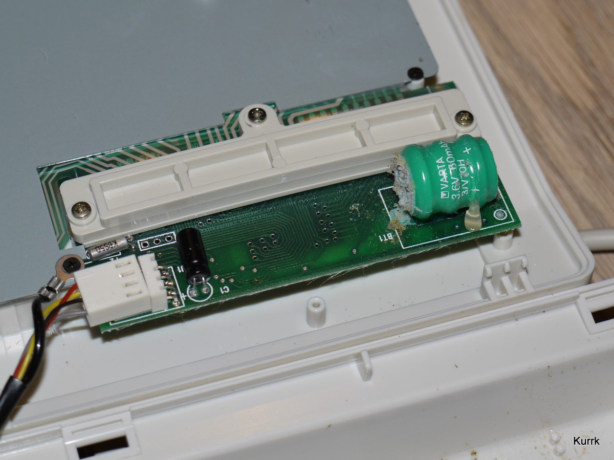

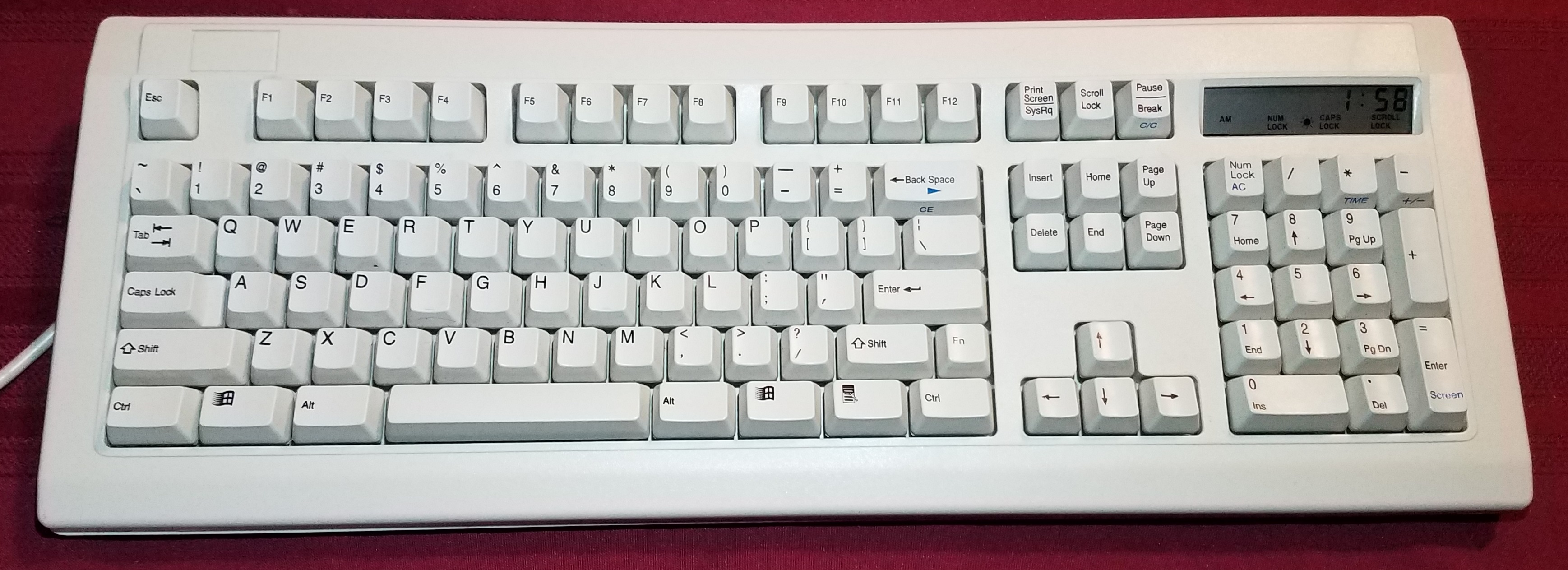

Finally what about this specific keyboard? For starters my keyboard is actually fairly rare example for a couple reasons. I think this keyboard was one of the last models before Cantech dropped this technology around 1996. It has 2 distinct features. First notice the ANSI layout and that Enter key. I might have seen one other example that has it but almost all the Cantech keyboards I see out there have a big-ass Enter or Iso Enter. The other thing is you will notice is it is a calculator model, which is much less common. But even more interesting, it is a WORKING calculator model, and may be the only working one in the wild. I say this because I know for a fact that after 25 years none of these calculator models will be working properly unless someone has modified them, and I doubt anyone but me would have taken the time. There is a NiCD battery soldered on the circuit board and these will degrade, outgas and become fuzzy. I cant imagine that there are any that are in wild that are still working without fixing that. Additionally the outgassing will eat the circuit board, LCD and membrane over time. So I suspect most of these calculator versions where destroyed electronically after a decade or two. I had to clean up the traces on the membrane near the battery with conductive tape and replace the NiCD with a Lithium 2025 button cell holder and battery, and even had to remove about 1/5 of the button holder to get it to fit. I was lucky that the circuit only had surface corrosion and one bad trace to bodge. Although the calculator might seem useless if you have the Calc app icon handy or macro'd, I work in a field where a simple addition or multiplication every once in a while is actually a timesaver as you can use the "Screen" function and it actually copies the output from the keyboard by emitting the answer as keystrokes and basically works like a paste from the keyboard. A very little thing that probably most people would not care about, but is helpful in what I do. I actually use it alot.

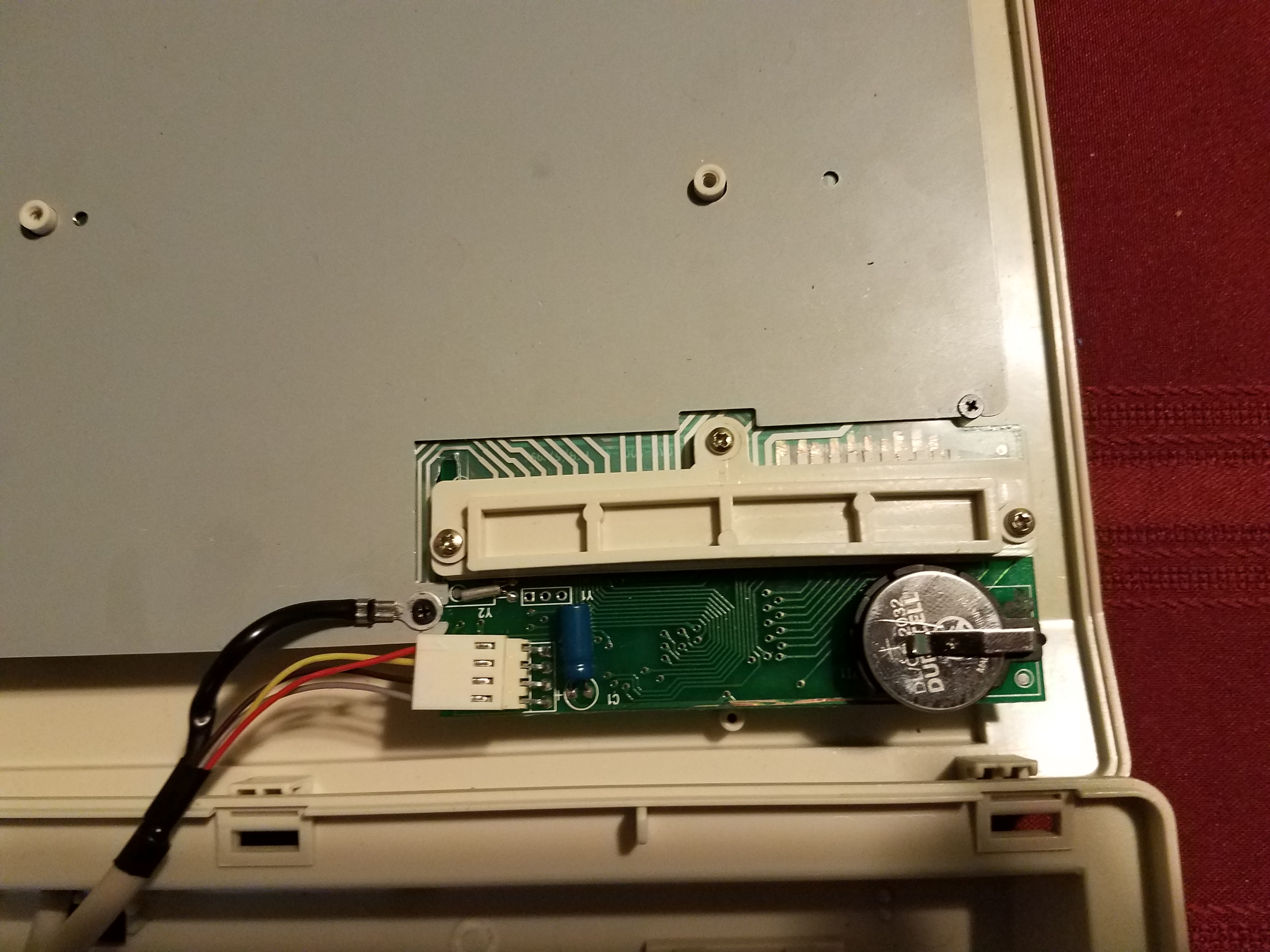

Furry Battery
Button Cell Mod
Whew, probably got the TLDR by now from most folks but if you made it this far here is the heresy! Actually with a little work this specific keyboard is really fairly nice, for a daily driver. I PREFER it to the Model M for daily typing, for tactility, and sound and actuation force. Sure, the build feels a little cheap and flimsy, but with the second generation hammers, and fixing the lube, it really comes to its own. Certainly you have to do a little work. From the factory there is lube everywhere, not as bad as Chyrosran's video but still alot in "some" keys. I think it gets squirted in per key and there is more than some keys than others, which is what creates uneven key feel and sound from the factory. Some keys seem flooded with lube, others just fine, some with nothing. If you take it as is the keyfeel is uneven and off-putting. You have to clean all that up and then lube the slides. The slide/stem design tends to be scratchy but a proper lube cleans most of that up, you can feel it slightly but with lube even that right shift is perfectly fine.

Nice work on that battery mod! Those NiCd batteries are such a pain. Had one of my vintage computers wrecked by one.

Thanks for sharing this! I have one of the early examples, which I saved it because it was interesting, more of a novelty than anything else. I've never used it other than to see if it actually worked (it did). I like the Focus layout, so perhaps I'll dig it out and give it another try.
edit: how did you keep the 5 volts from trying to charge the lithium cell? I once had a (Mac) lithium memory battery erupt, for no apparent reason, what a mess that made!

Polecat, yes that is probably important. Schottky diode below in front of the positive end of cell holder, voltage drop looks to be ok to hold the clock. Current goes out but cant go in. If you dont care about holding the clock you can probably remove the battery completely. The batteries are only on the Calc models, so on something like the CAN-3001W without the calculator, you would not have to worry about it.

One last comment on where key feel winds up with second gen hammers after reworking the lube. Maybe to put it in terms of
MX, basically you get something that is more tactile than an MX brown (not saying much, anything would be better), and quieter but still clicky like a MX blue. I really like it. The feel is nowhere near a quality Model M that just gives that firm and powerful response for typing, but that is a little stiff and loud for my office usage. This gives a nice, but not over the top, gentle snap and click. It is really different from anything else I can think of. You can hear and feel the buckle but not be overwhelmed by it. And 55g of actuation is just right for me.

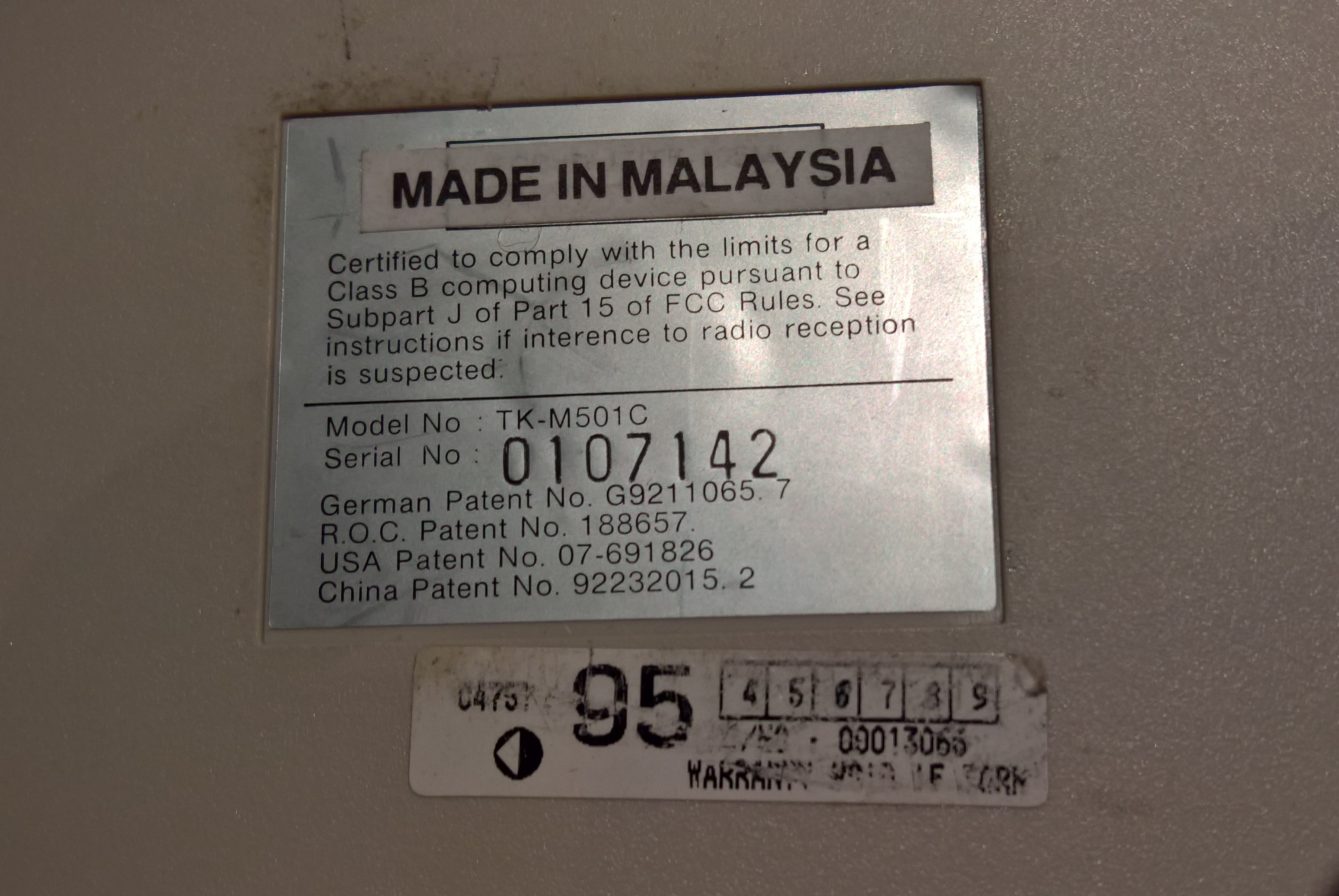

I forgot to share the label. Mine proudly states it's made in Malaysia. Not sure if that helps or complicates things.

I have poppped springs off before and fyi I believe there is a lip on the bottom to set it. So you can pop it off without pulling the spring using you fingernails to unseat it from this lip. Also if they aren't buckling push down with fingernails to reset on this lip. Dont know if it will help but that has worked for for me when I thought I broke a spring playing around.
Also I highly suspect the sticker will say "Made in Taiwan" under that Malaysia sticker as it looks just like mine. But maybe they licensed the tech as that barrel plate is different from any known example I have ever seen myself or online. Will take a pic of my sticker when I get a chance.
Yeah I worked out the thing about the lip on the bottom after a couple. Fortunately, I think you were right and it wasn't seated properly, as after pressing the key a bunch, it appears to be behaving correctly now.
It look like there is writing under the Malaysia sticker, but it appears to be just the FCC ID. I can't see it that well though.
