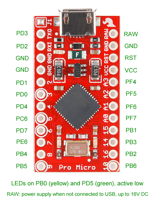

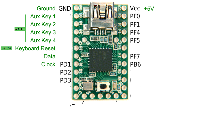

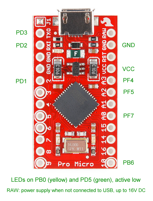

Hi guys, I am trying to make an external converter for my Bigfoot so that I can use the original cable. Where on Earth is PF0 and PF1 on the Pro Micro? Attached are edited pictures omitting what I think I don't need, leaving the corresponding pins on the Pro Micro. I used images of Teensy converters to determine this, although they use the two aforementioned pins which aren't present on the Pro Micro. Thanks in advance!

You can edit the QMK files to use different pins.
