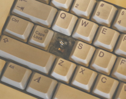

I have read, watch and finally used tool on letter A of my A2000 keyboard.
However - I removed the keycap with slider inside(so didn't watch in full legendary space invaders face
), good that at least the spring don't "go into space", and remained on position. There was a lot of dust there - removed them with finger, and small wooden stick (just the same You use in kitchen...). Sadly I don't lubricated that - don't have krytox. Is the Vaseline(from pharmacy) good enough for this slider type? Should I use some grease/WD40 on spring? I found that also isopropyl alco. may help, but the same source says that it can damage plastic?
Sadly I didn't checked if it is working correctly after removing dust, have some problems with Amiga, and it would take some time to install drivers and use Catweasel (which have the ability of handling Amiga keyboards) on other computer.

- slider2.jpg (8.41 KiB) Viewed 3273 times
- slider1.jpg (11.85 KiB) Viewed 3273 times
- noslider.jpg (38.07 KiB) Viewed 3273 times

Looks like the stem came off with the keycap. It'll be easier to reassemble if you remove the slider/stem from under the keycap and put that back on first, then reattach the keycap after.
Pretty sure those are linears though.

I want to say BIG Thank You for all replies and sharing knowledge on Internet(films helped also a lot). I checked the keyboard on computer with Catweasel controller and "A" is working correctly, like most of the keyboard. Maybe just carefully cleaning from dust helped a lot.
Sadly some other keys are not working(no reaction) - about 5 as I remember, with some being letter, and digits not only from numeric.
I will try to also carefully clean them from dust. Just in case I remove keycap correctly - is removing a slider with other side of tool that I use(shown on photos) a good idea? As I watched videos there are just pliers, not the mechanical keyboard tool that I have?
