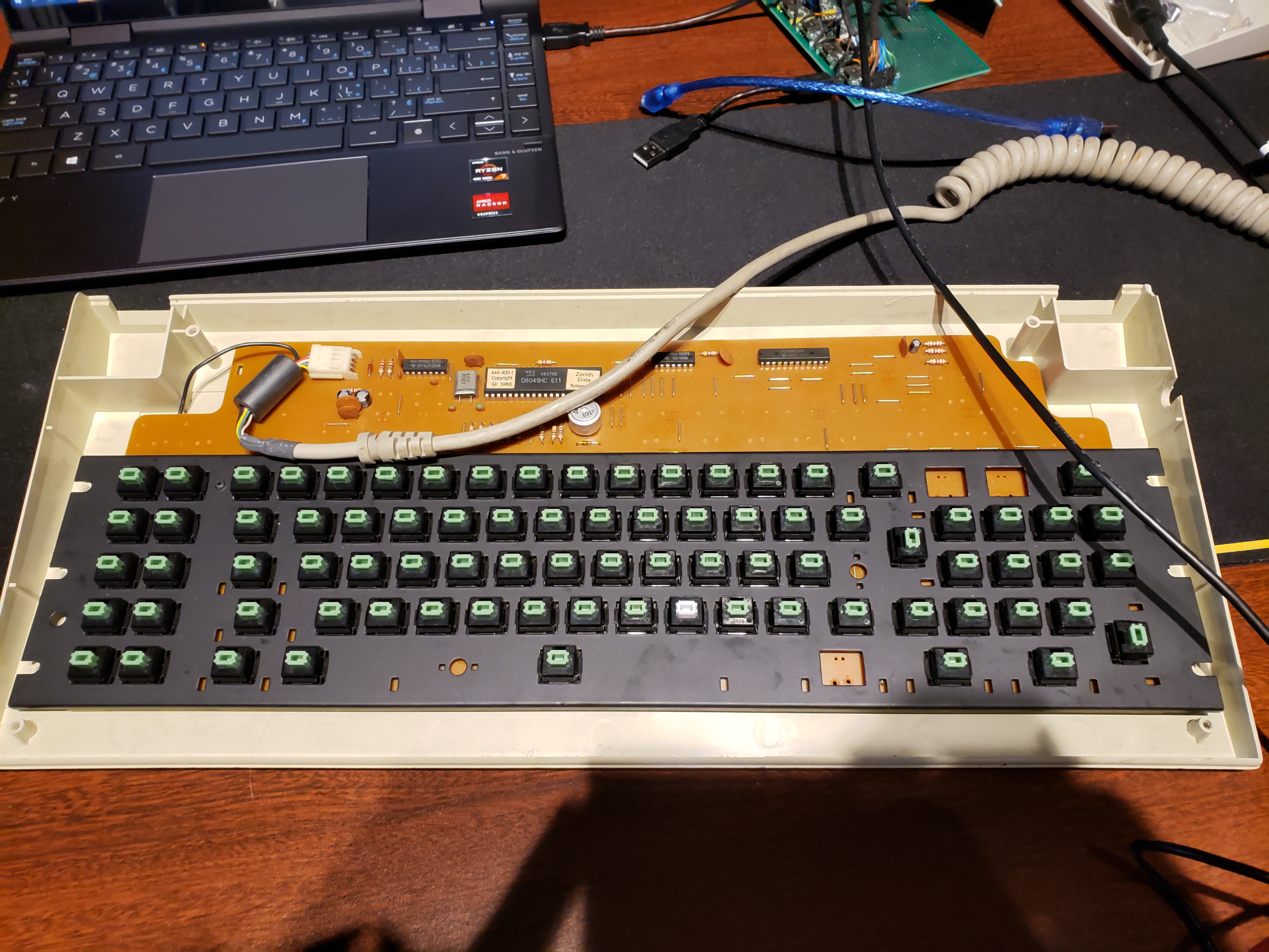

I'm currently restoring this keyboard and I just finished lubing all the switches and soldered them back in, when I tried to use it to test the switches out, it didn't work although the beeper sometimes worked and the keyboard would also sometimes spit out what would seem to be the date and time. I think it could be the capacitors, if so how would I go about identifying their values?
Re: Need help getting an AT Zenith Z150 working
Posted: 22 Jan 2021, 22:48
by TNT
Wow, that plate is clean!
If you don't have a multimeter and wanna go the safe road, just replace all the electrolytic capacitors. Very inexpensive. Their capacitances are written on their sides. Mind the correct direction when soldering them back in.
Also, what's that poor, lonely bamboo white doing there inbetween all of the greens? :mrgreen:

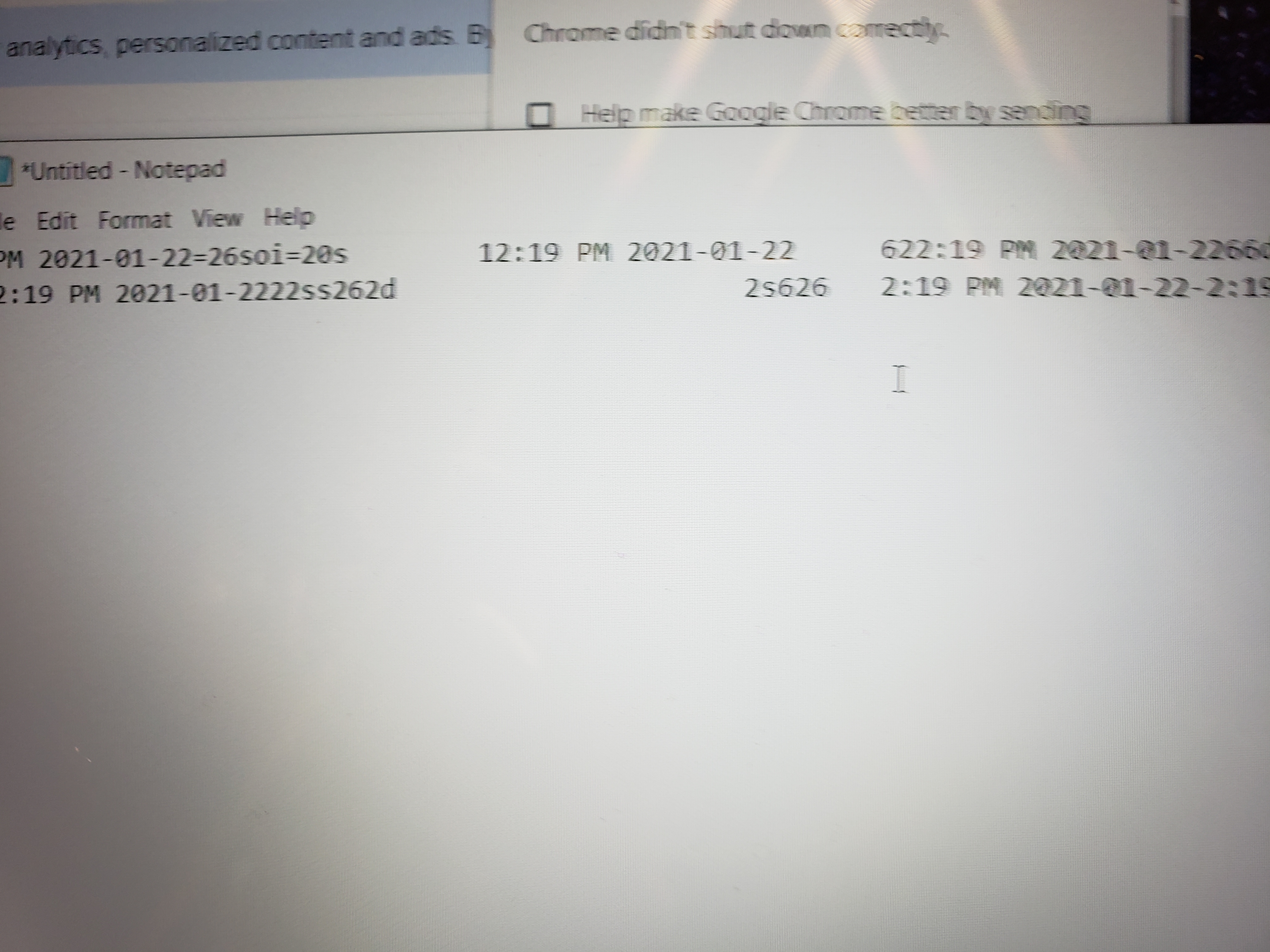

I didn't test it out beforehand and I've tried through a generic PS/2 to USB converter and through a soarer's. I'll order the Monoprice converter to see if it works, thanks for the help :)

You can try my firmware, it is compatibile to Soarer's converter.
https://geekhack.org/index.php?topic=103648.0
I have improved the firmware to add support for Z-150 AT, it should work except for CapsLock, NumLock and ScrollLock.
Posted: 23 Jan 2021, 19:08
by Lekrafter
Just did but it unfortunately doesn't seem to work, but at least now the beeper always works

Can you post a picture of the back side of the PCB as well?
