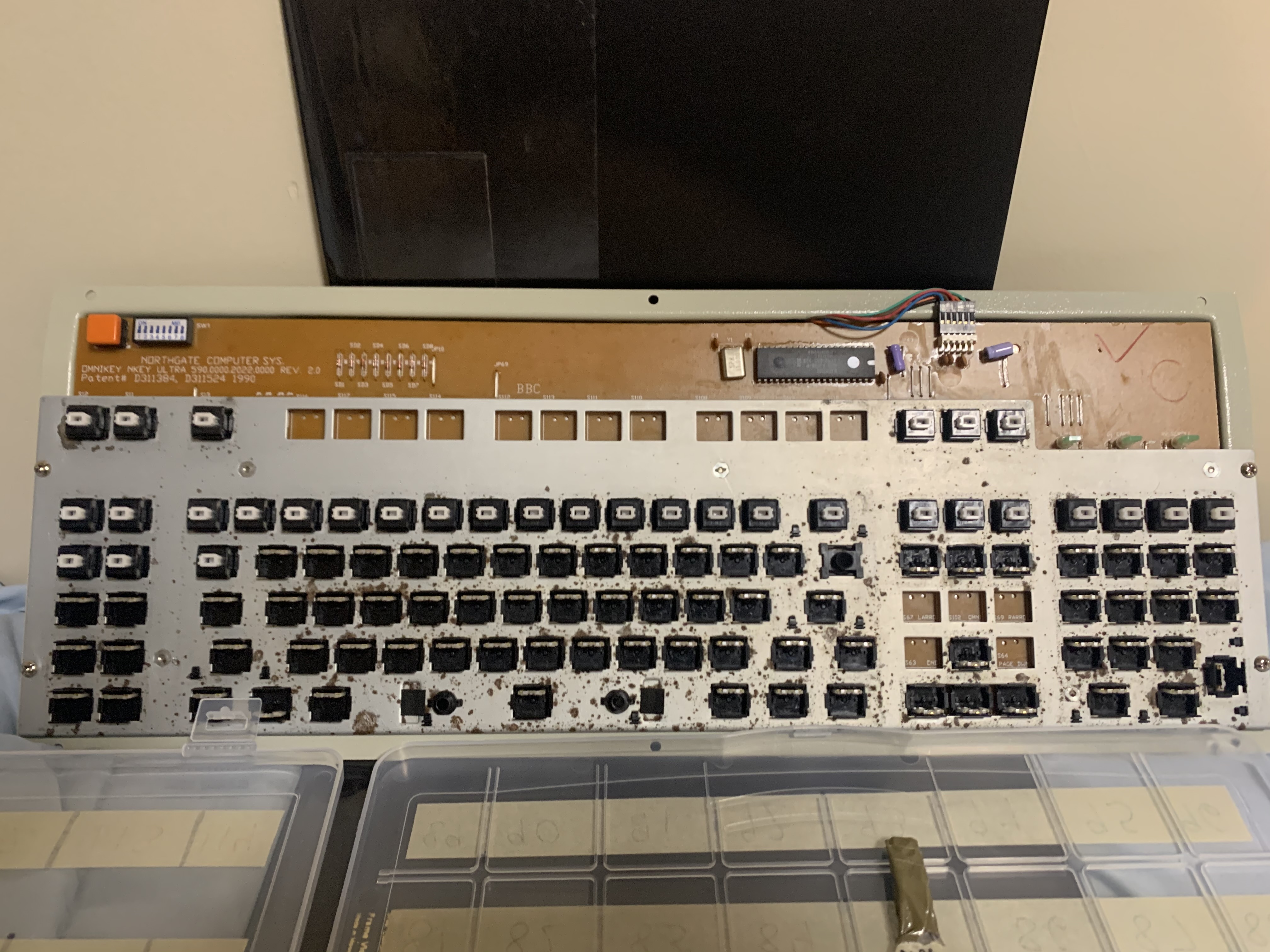

When the board arrived, I immediately took it apart and methodically cleaned everything. The mounting plate has a lot of rust spots on it, however they were merely cosmetic and had not compromised the the integrity of the plate or the the PCB underneath. I used a dental scraper, some WD-40 and q-tips to clean removed most of the rust. Then using Chyrosran22's video guides on how to restore and clean ALPs switches, I took apart every switch on the board, placed each ones components in their own compartment in my storage boxes. They're actually jewelry making storage boxes, but they worked perfectly keeping each switches components separate and organized by number. I then painstakingly cleaned each switch housing and components using rubbing alcohol, fine tipped paint brushes and my x-power computer duster. After uttering every curse word I could think of, springs flying off around my room and praying the board would work, I put the board back together and tested it. The board 100% worked, I felt like a kid on Christmas.
However this story has sort of a melancholy ending. After testing the board, I went to bed, it was 2 in the morning when I had finally finished. The next day I fired up my computer with the intention of typing some emails that I had been putting off, just as and excuse to use my new baby. Then tragedy struck, I was typing and email and was attempting to type "appointment" but for some reason the "M" key was not registering. I unplugged the board and took apart the switch, thinking that the contact leaf was not pressing against the switch plate enough. I bent the bottom of the contact leaf slight more forward and reassembled the switch. I then tested the key, still nothing. I took it back apart, keeping the board connected to my PC, and using a toothpick, I pressed the contact plate against the switch plate. The presses were registering, however they were doing so inconsistently. I took out my flash light and using the tooth pick I gently pried open the switch plate a little bit and my heart sank. The switch plate was covered in corrosion. Not to be easily defeated, I used to a dental pick, white wine vinegar and a toothpick to get as much of the crud off as I could. But to not avail, after reassembling the switch and testing it, the damn thing still did not work. Crap.
In conclusion, in order to get the "M" key fixed I have to now purchase a soldering kit and replace the switch. I know I can savage a switch from some other key that is not used on the board, however I plan on buying some white ALPs new old stock switches from ebay, if I can find them. However, if anyone on here has some, I will happily pay you for them. The up-side is that I already know how to solder, so it should be an easy fix once I get everything I need. And if you have stuck around to read my entire post, thanks for reading it!

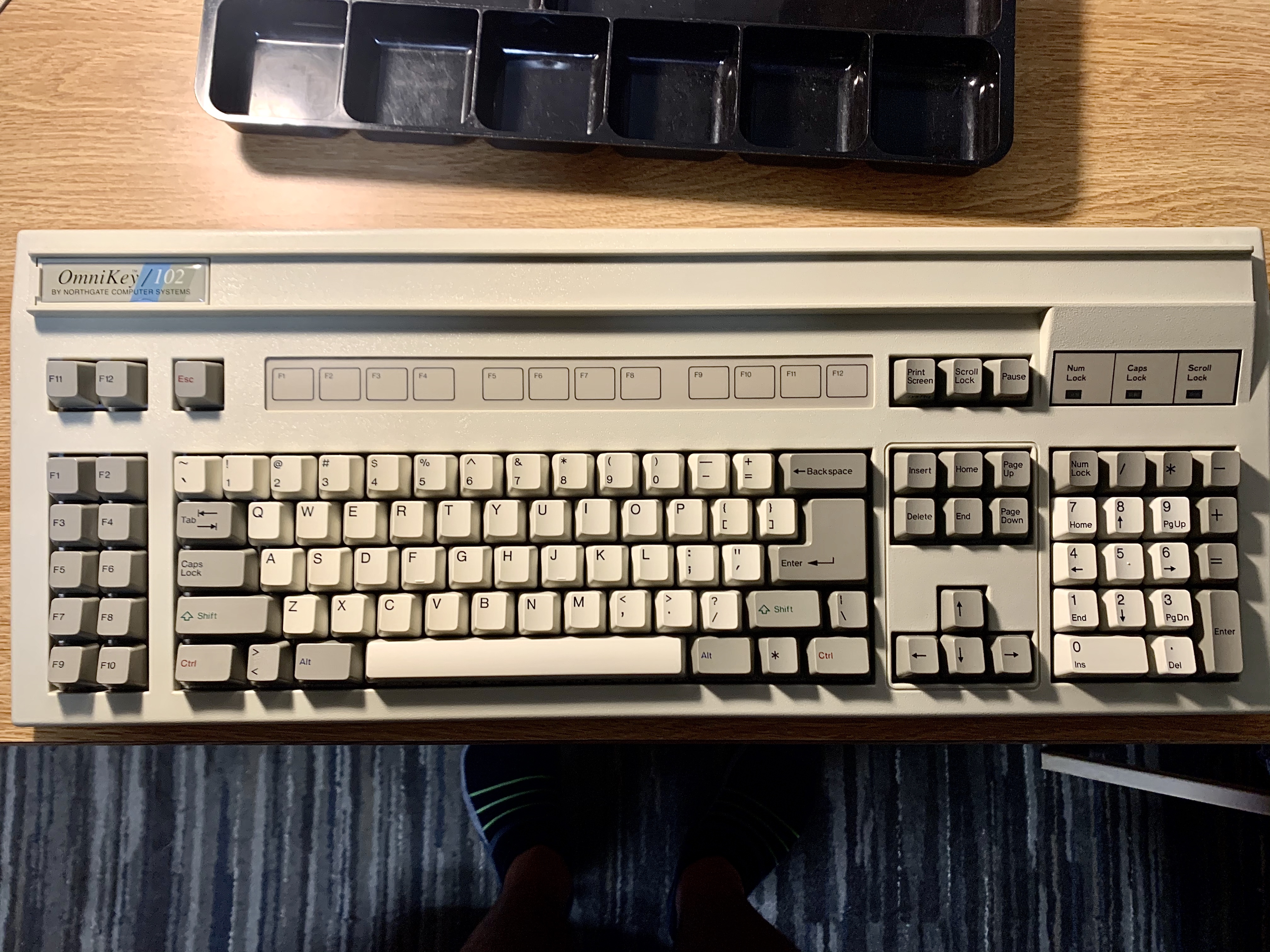

- Isn't she beautiful?
- The finished 102.jpg (3.67 MiB) Viewed 5780 times
- Post rust cleaning
- Partially disassembled.jpg (1.93 MiB) Viewed 5780 times

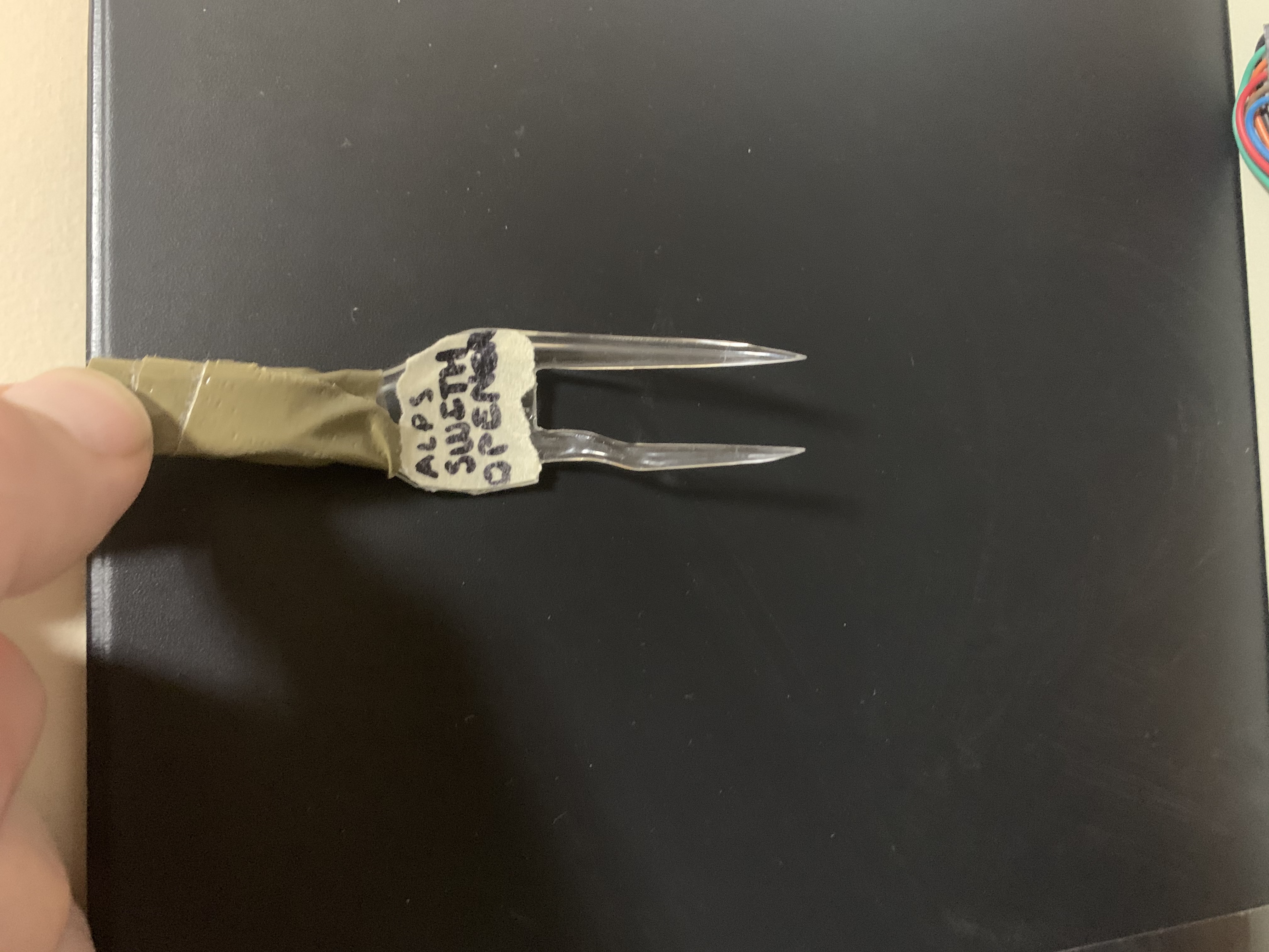

- Made this out of a cheap plastic fork
- My jerry rigged switch opener.jpg (2.42 MiB) Viewed 5780 times

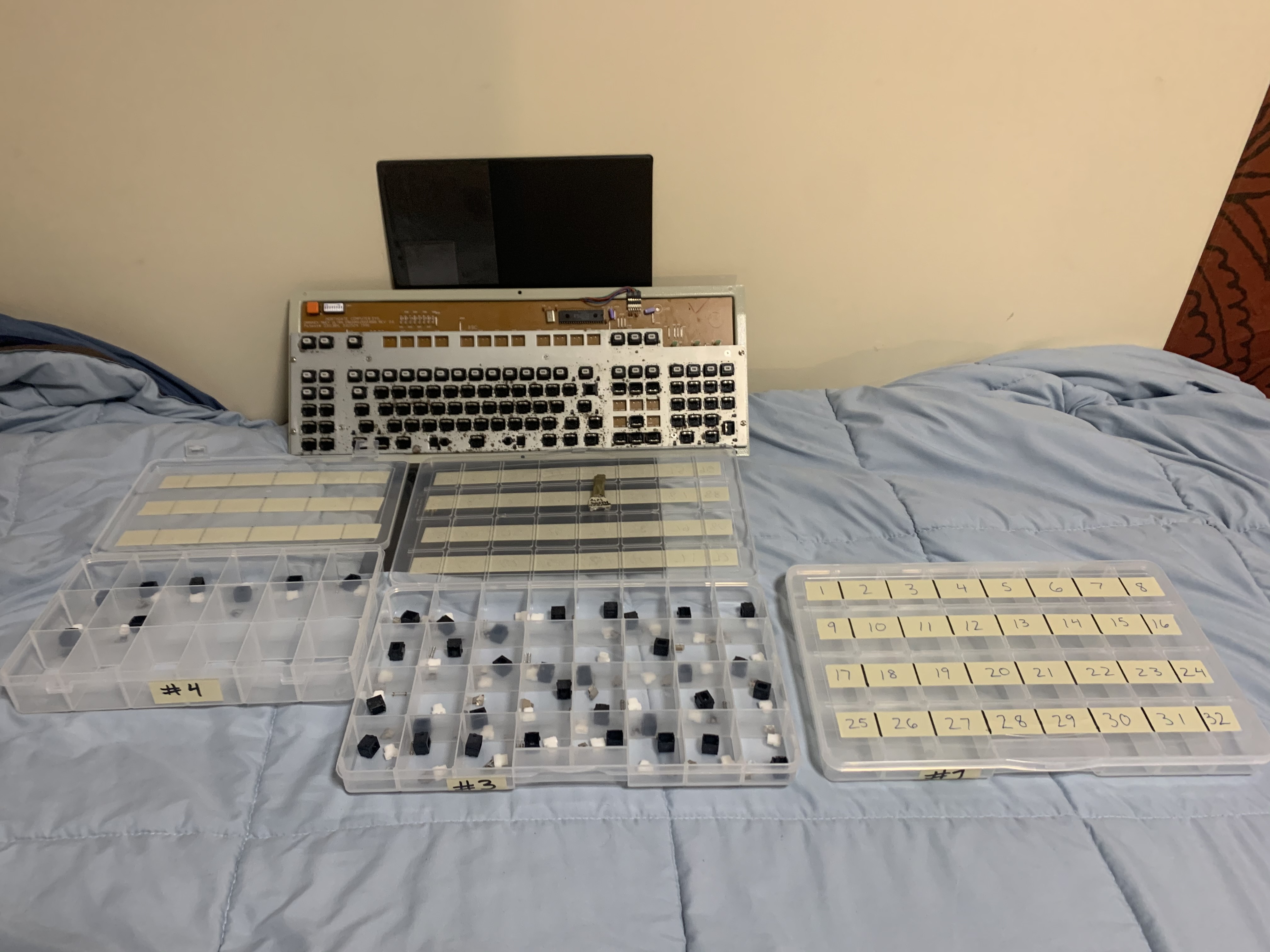

- The gangs all here
- Everything Together.jpg (1.33 MiB) Viewed 5780 times

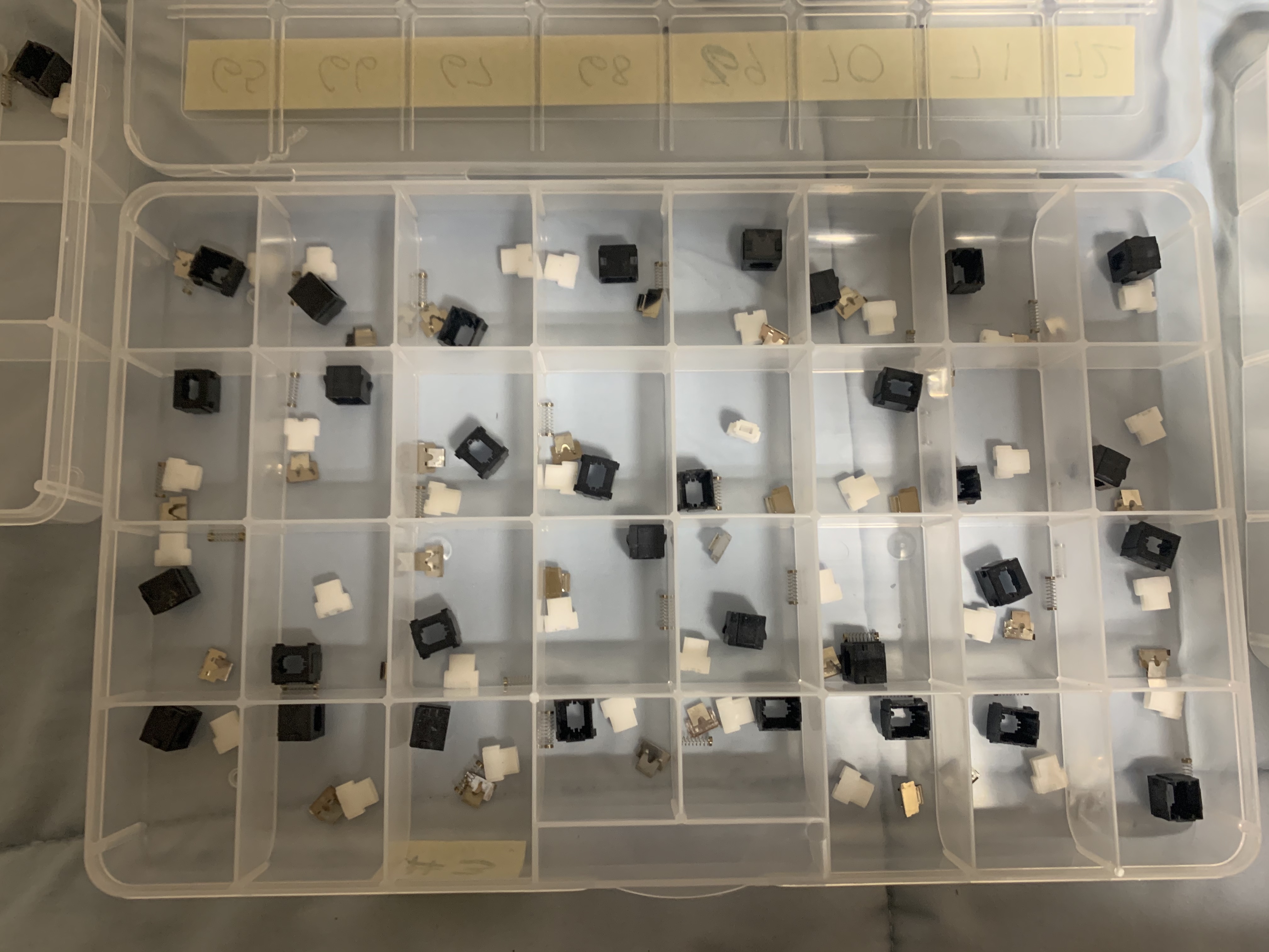

- Bought these at Wal-Mart
- Close up of storage box.jpg (1.9 MiB) Viewed 5780 times

I love your switch opener dude! Also sucks that the M key didn't work, but I do have a few contact leafs sitting around in one of my trays if you end up needing one.

Thank you! The issue with the switch is that the switch plate itself is corroded beyond repair, not the contact leaf, but thank you anyways! I ended up buying 7 new old stock switches from eBay. I got 7 just in case another switch dies and I can’t repair it. I plan on taking all of the switches out when I do the repair so I can sand and repaint the mounting plate. Do you know if there is a specific type of paint that I should use?

I seriously thought the tape on your fork said, "Alps meth opener." I had to re-read it a couple times
Anyhow, last week I got this thing. It worked perfectly for me. I disassembled about 200 clicky and linear Alps switches in about an hour and a half. Desoldering took a bit longer, but I do have a desoldering gun.
