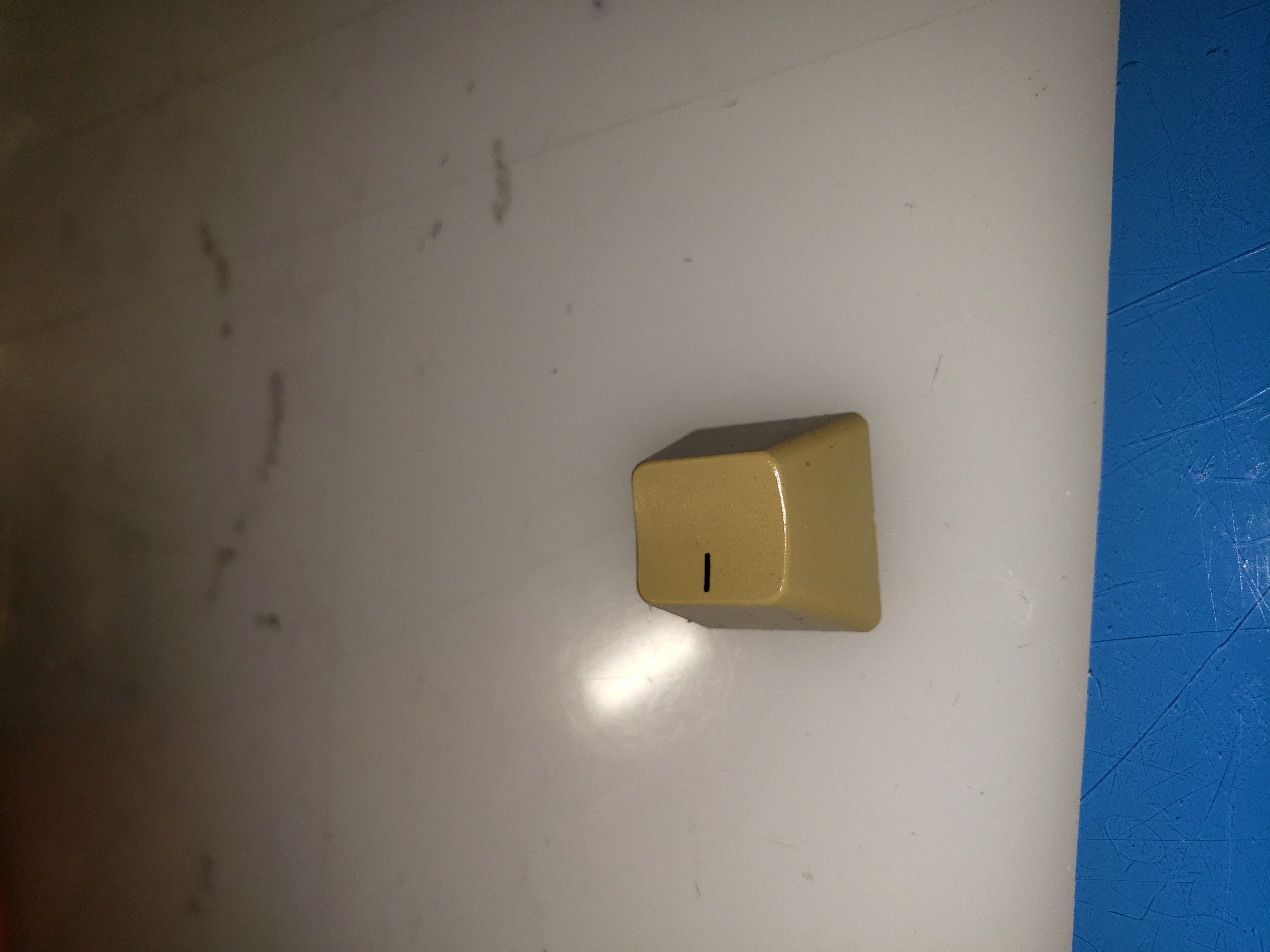

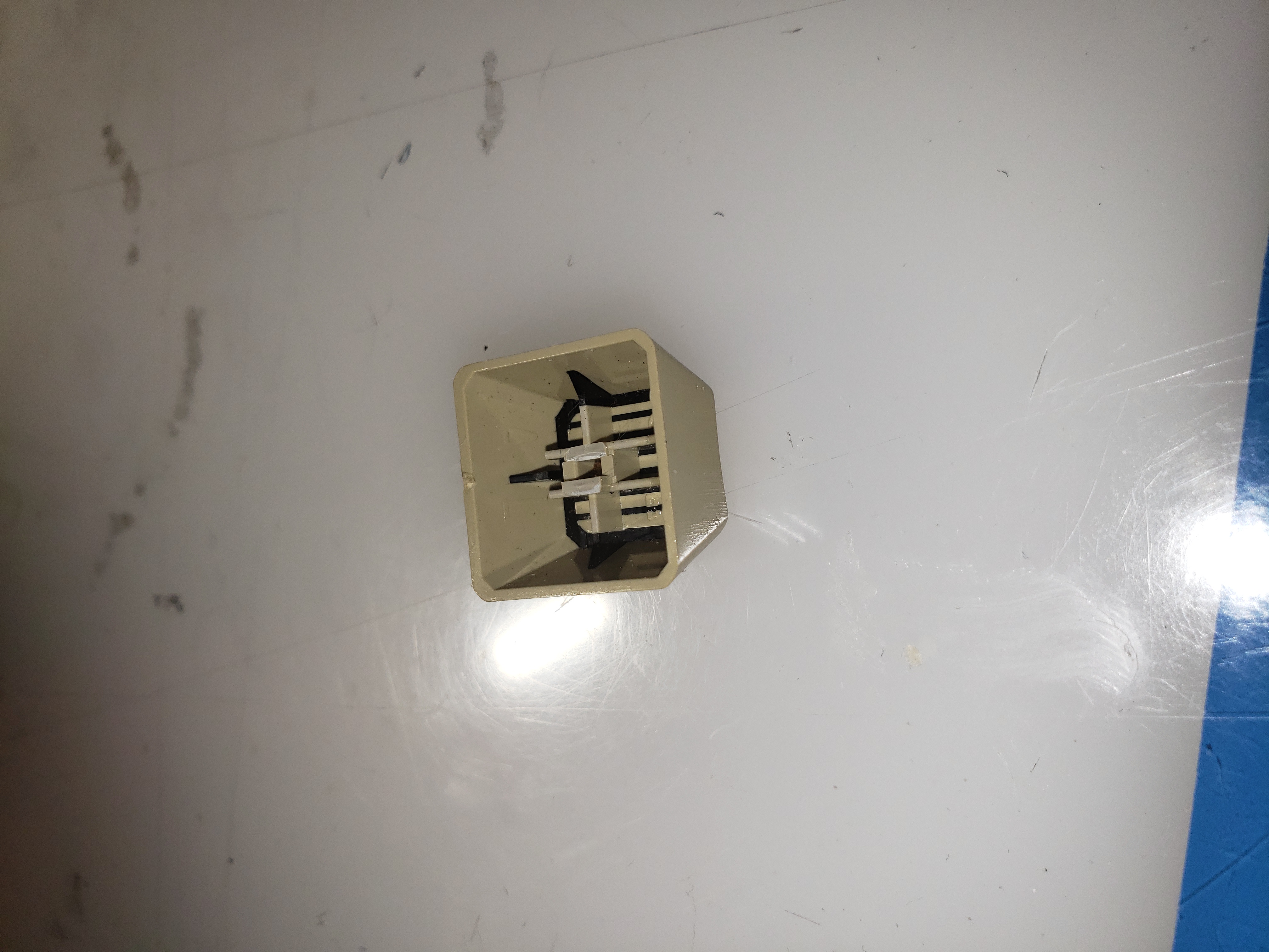

But... the keyboard in question (again, a Compaq Portable III keyboard) presently doesn't work -- its cable is in absolutely horrible shape, and I rather suspect that's the only real problem with it. Unfortunately, in the process of prying it open (no screws on the external housing, only clips -- color me pleasantly surprised, indeed!), I managed to knock the "-" keycap off the numpad... oh dear :oops: I do hate being so clumsy. Photos of the aftermath of my epic fail have been attached.
I have few resources right now to fix it... I don't have either of the prongs that constituted a mounting system; both of them are somewhere on my carpet... alas, the carpet is the same color, so I'm not going to even bother trying. I have various adhesives and hand tools (a healthy stash of Dollar Tree super glue gel comes to mind first, and my battery drill and a corded Dremel that was a gift from a relative... there are others. Ask me for a full list or about specific adhesives/tools/etc, although I'll mention, as I should -- the drill and Dremel are my *only* power tools, although I have a ton of bits/etc for both...).

https://youtu.be/n1meoZaHYZo
This trick has previously worked for me on fixing stabilizer hooks in model m keycaps, so hopefully it will work for you too.
You probably need some needle files to enlarge the hole after the glue is set.

Thx :) don't have needle files or (right now) the ability to buy 'em. Early October, probably... if I can get em at the local Walmart.
But I can be pretty clever with an Xacto knife. I can be, er, pretty clumsy (boy that's a story lol) but when I'm not being clumsy I'm not half bad.
FWIW, the switches are Keytronic foam&foil. I seem to recall that chyrosran22 (know him from eBay and then YT... sent him the IBM Model M13 he used in that video, still stinging a bit TBH because he left something out of that he'd promised... :-/ not a lot but a little bit) ripped em up for being bad when new and well worth one of the videos he has to put a warning on ;) when they're as old as this one is. I'll get a photo later of the keyboard without the key, and maybe get a few inside shots. I have to swap out the cable (going for a PS/2 cable instead, because reasons... at least it's beige!) anyways, so... probably later tonight? IDK. Energy is a fickle and questionable thing these days.

@zzxx53... a few immediate thoughts from watching the video... (apologies if typos make it through, typing on phone ATM.)
I have Super Glue, the gel kind that Dollar Tree sells. I actually recommend it because of what many others might see as a flaw... where Krazy Glue brand gel really means it when they say "you got 5 seconds buddy" -- not so much this stuff. You gotta give it a good 15-30sec, and if it moves, you get to dry scrape & reapply.
That said, if you're clumsy as [FCC Fine Me Words lol] but you can naturally grab, clamp, or latch onto something with the kind of grip an unshielded US mains cable would give you... ;) even for a half minute, you get to save a TON on that stuff. The trick with Dollar Tree is in sorting out what's good and what isn't. Like those tourist trap mining places that let you pan for precious metals and stones... you just have to be able to tell what's a gem and what's just prettied-up gravel.
*ahem*
Don't have baking soda on hand, but I got all-purpose flour... please don't ask... I might try that, since what the baking soda is doing is simply providing structure. I'm also toying with making a paste using the flour and some Loctite brand (I think? Might be JB Weld) two-part stuff, specifically for plastics. I got it to fix a big green-n-yellow plastic garden cart... then I found out the cart was made of one of those plastics you can't glue because literally nothing sticks :(
I've also got some fairly dense pink antistatic foam from a chip eBay sent. I'm thinking if I make like a long square block (i.e., square on the top and bottom, but rectangular from the side) I can pour it full of Super Glue and stick it in the cap... when the glue hardens it'll pretty well be a plastic peg. I've done that with 3M foam tape when it wants to be super rude and misbehave and just fall right off... works great, and the tape hardens like sidewalk concrete.
In fact, I'm gonna try the foam thing first. I'll let you folks know how it goes :)

These are specifically Keytronic *tactile* keyswitches, the ones with the little rubber boot around them for the pop-back springiness. I seem to have lost the boot, unfortunately, and the switch's foam-and-foil bits are starting to fall apart...
...and the switch seems to want to stay down and not get up :( I think it needs a bit more than super glue at this point... like those pills they have on late night TV for midlife crisis dudes who just bought a Miata but haven't quite left on the road trip yet :P

Anyone else can help? It needs a replacement boot and the foam + foil/plastic disc assembly stuck back together, at this point :-/
