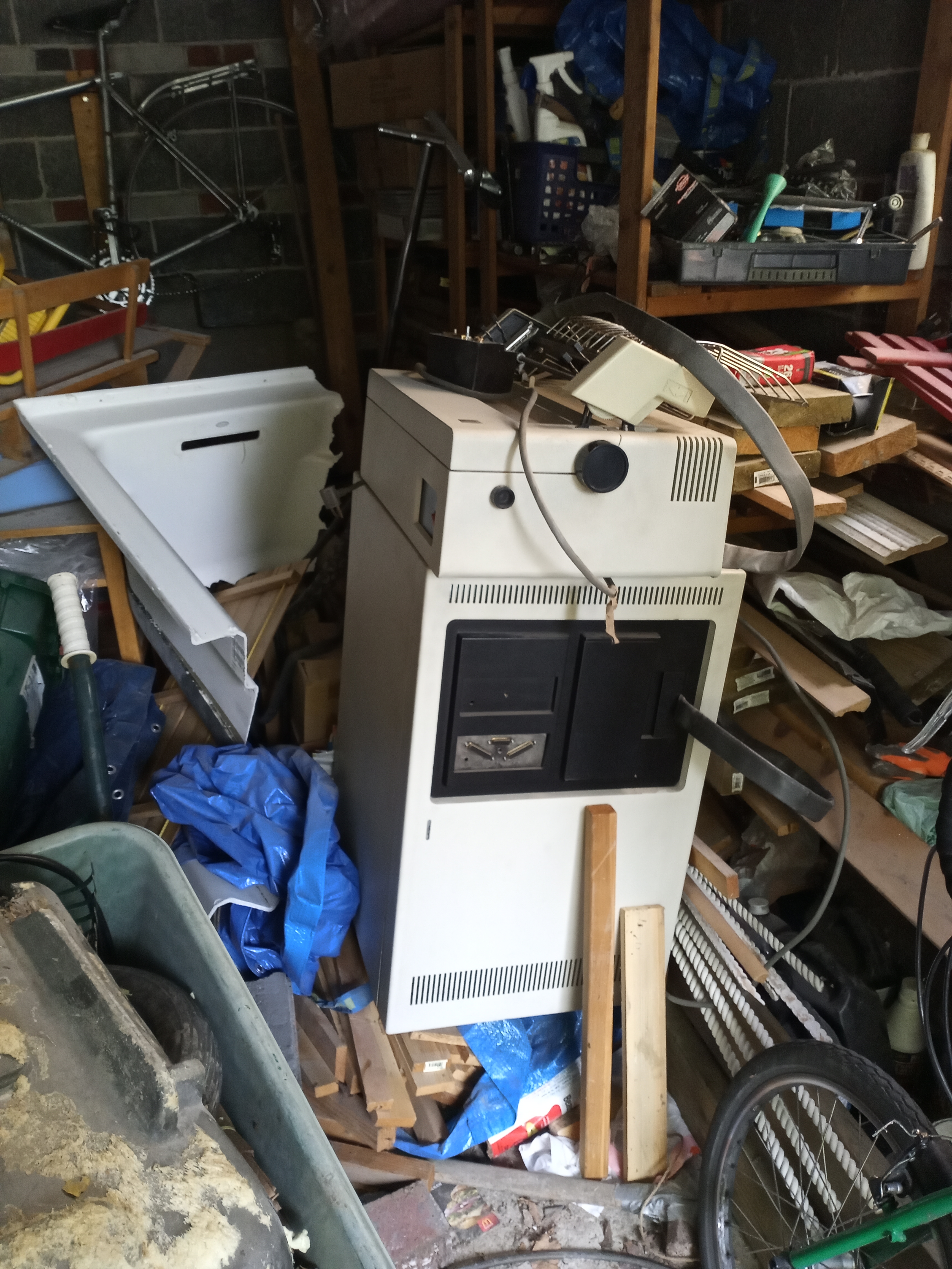

Yesterday I was able to get this IBM 5110 System. The system was owned by a single person who used it for accounting. It has not been powered on in 20 years he said.
It came with the original floppy drive unit which is store in my parents garage for now on some wood. The floppy drive was about 1.5 x 2.5 x 3 feet in size and was extremely heavy.
The printer also is there and itself was also surprisingly heavy.
in garage.jpg (4.15 MiB) Viewed 7215 times
The garage is dry so they are okay in there, its just a cluttered garage.

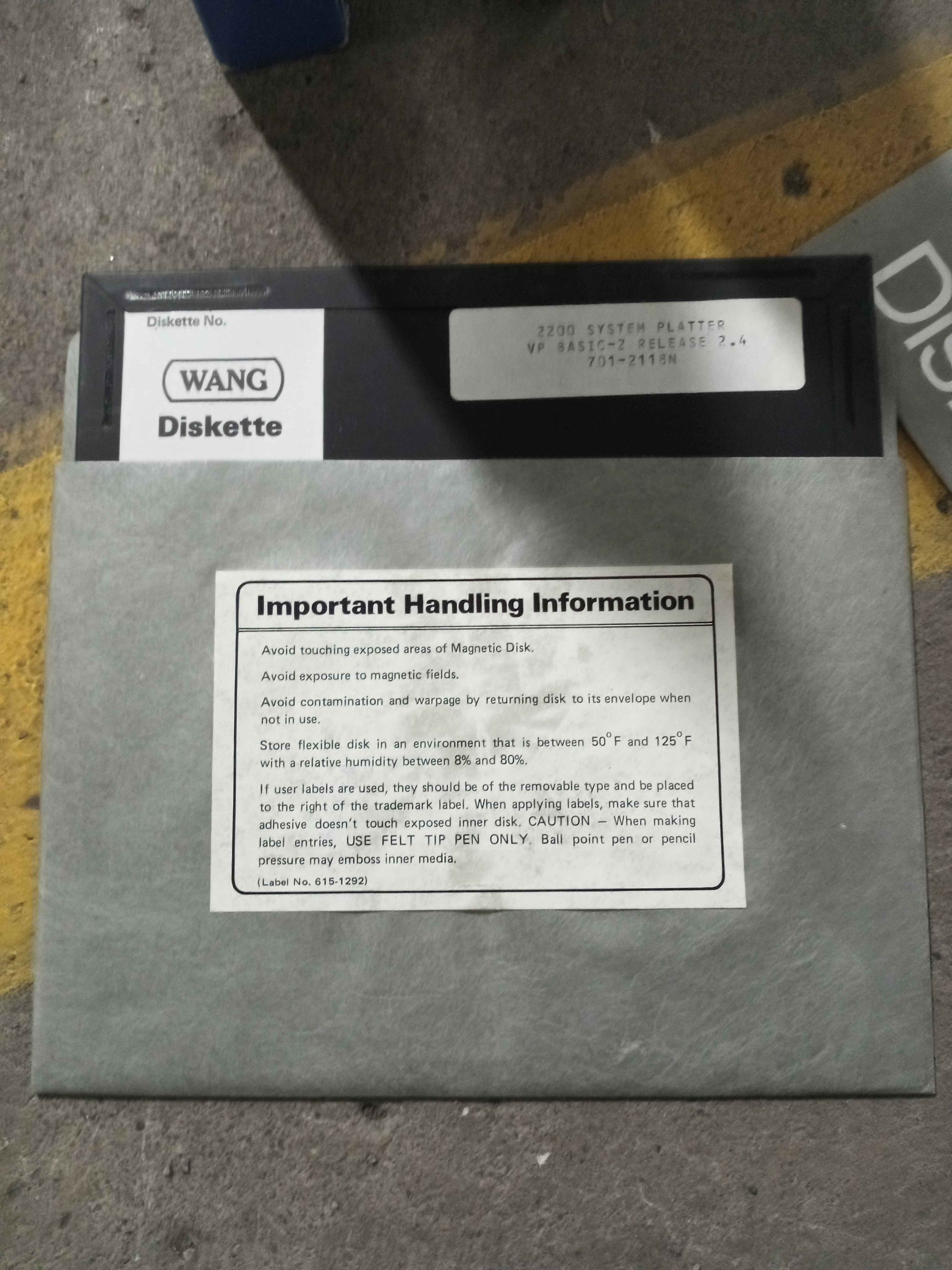

It came with a bunch of the 8 inch floppies.
One was for a wang system, but he had already sold this last week.
stealthy wang.jpg (3.86 MiB) Viewed 7215 times

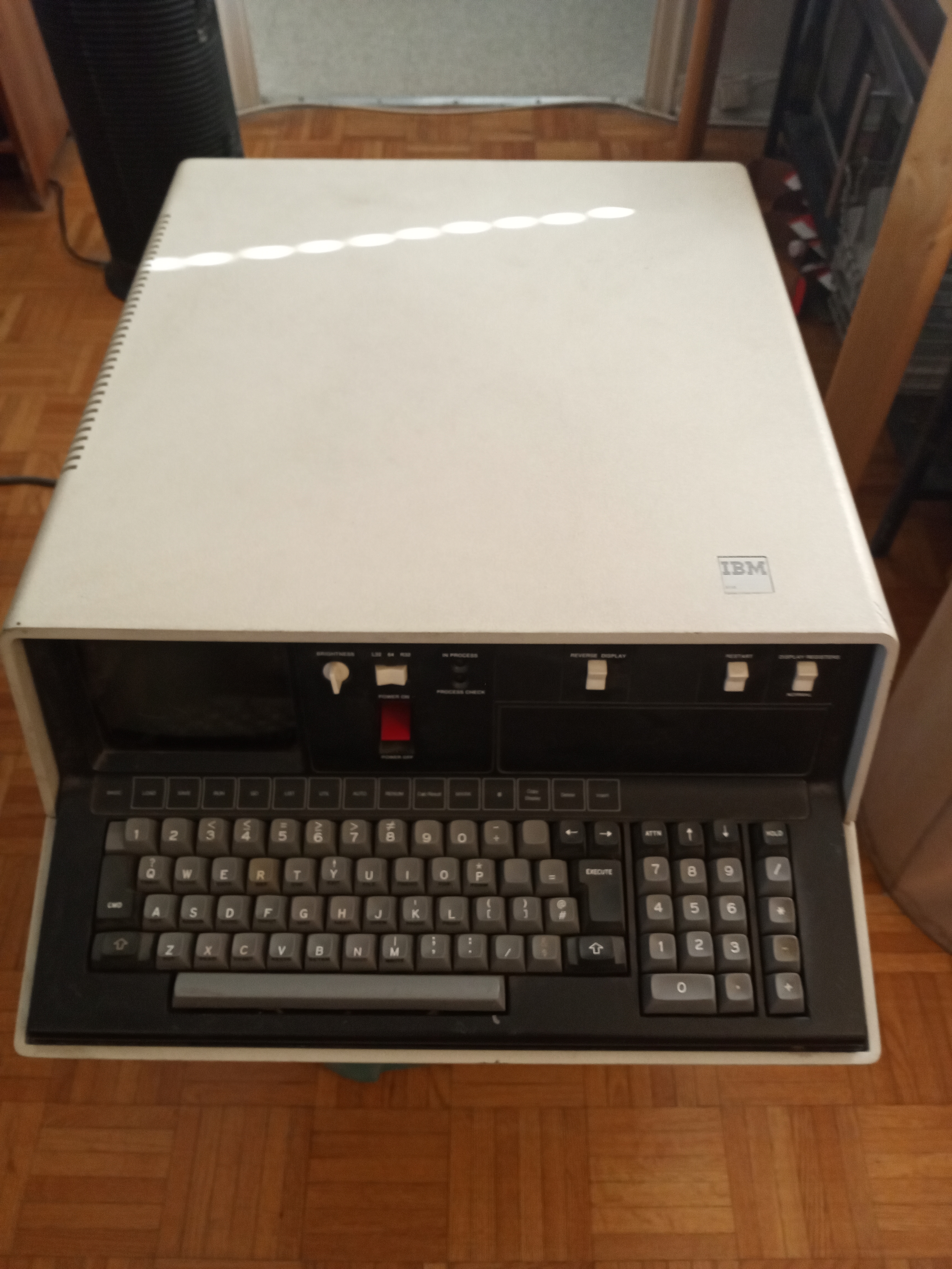

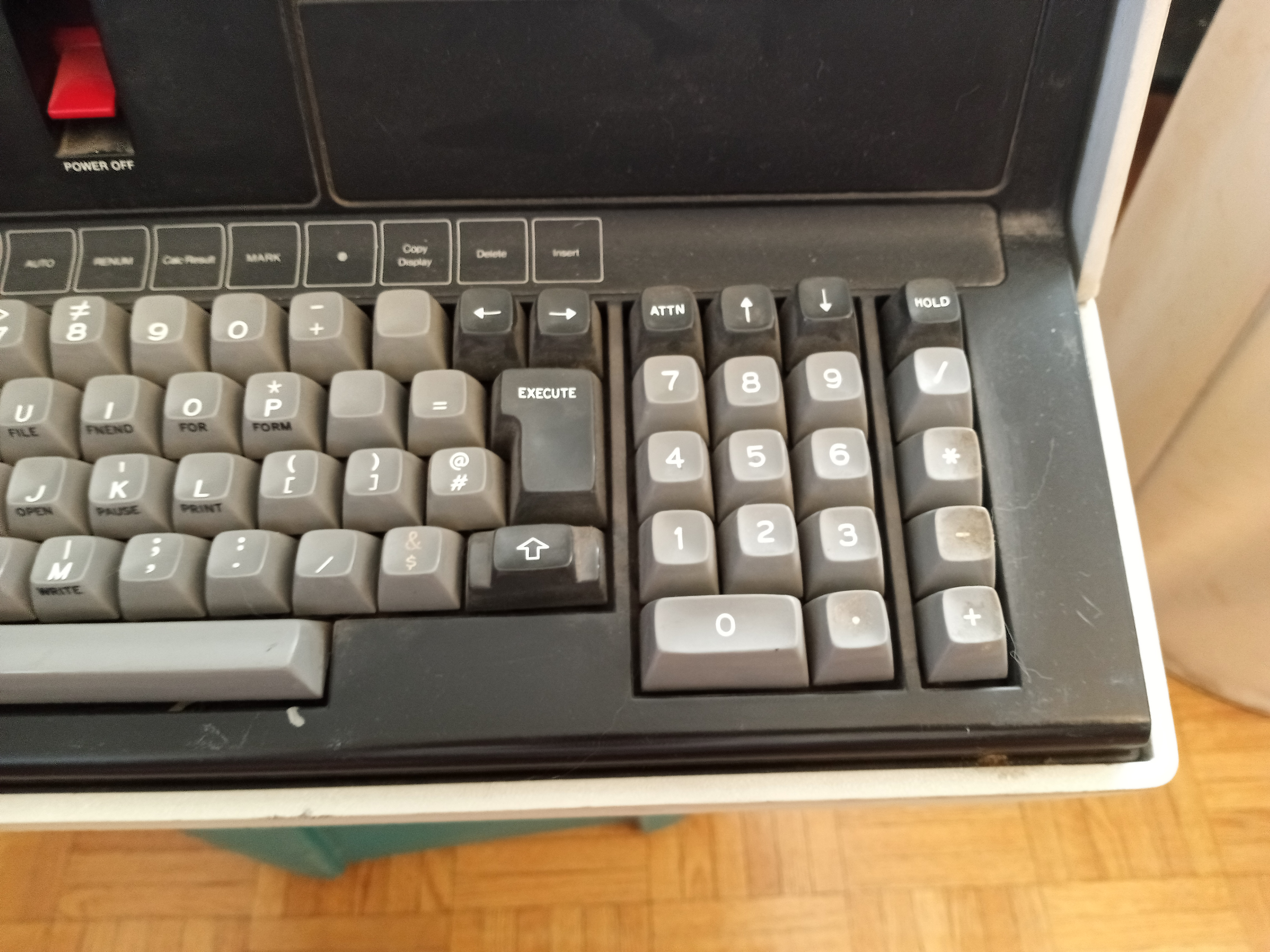

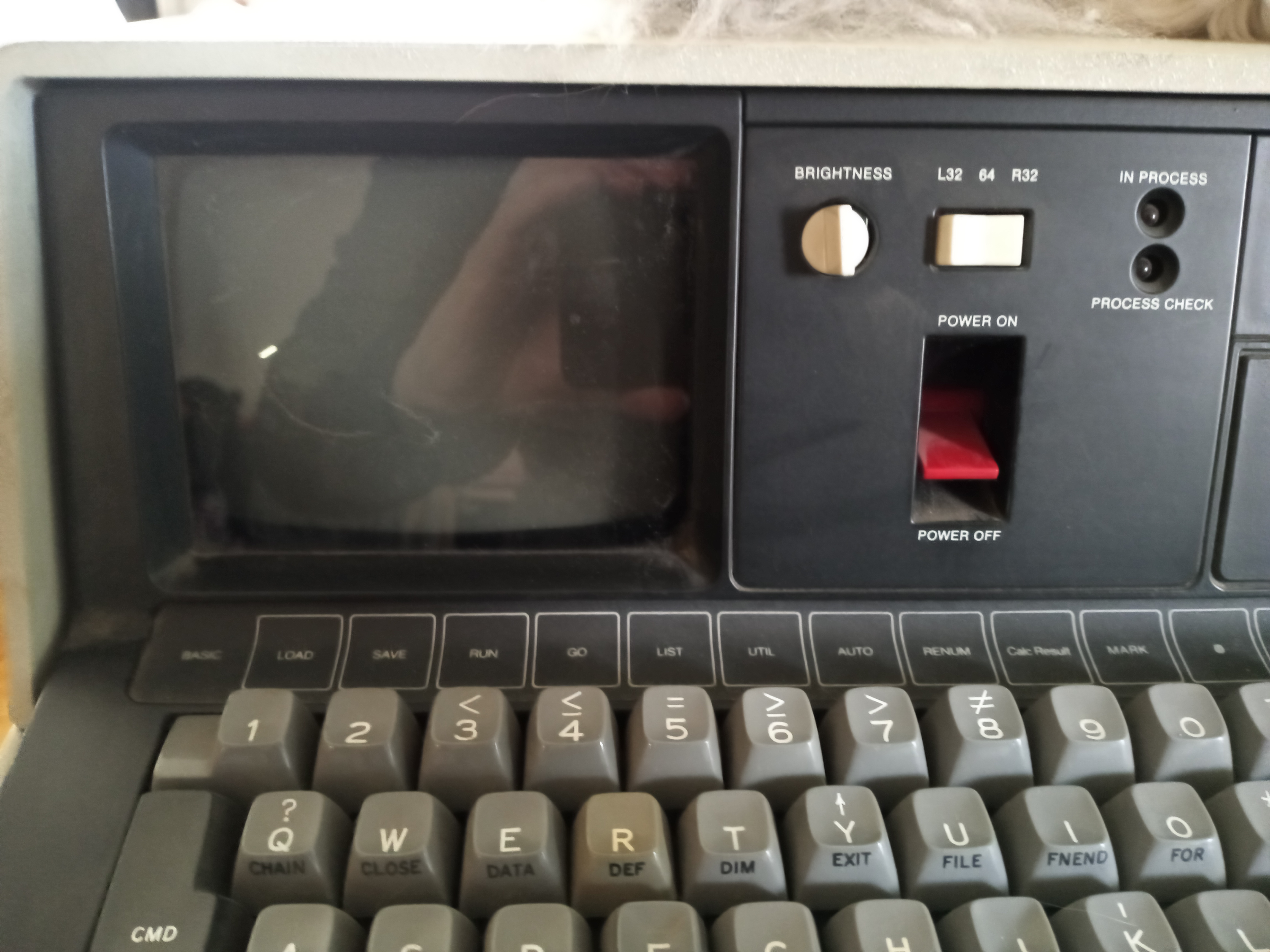

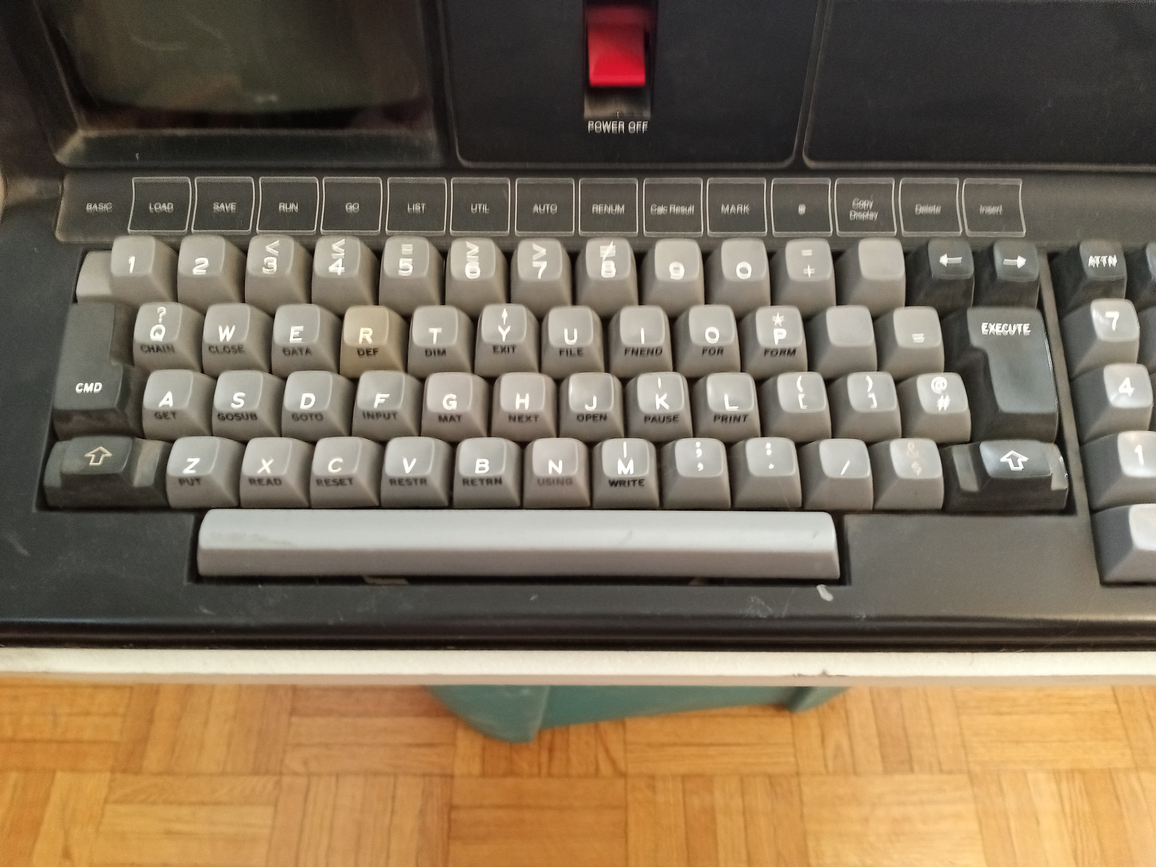

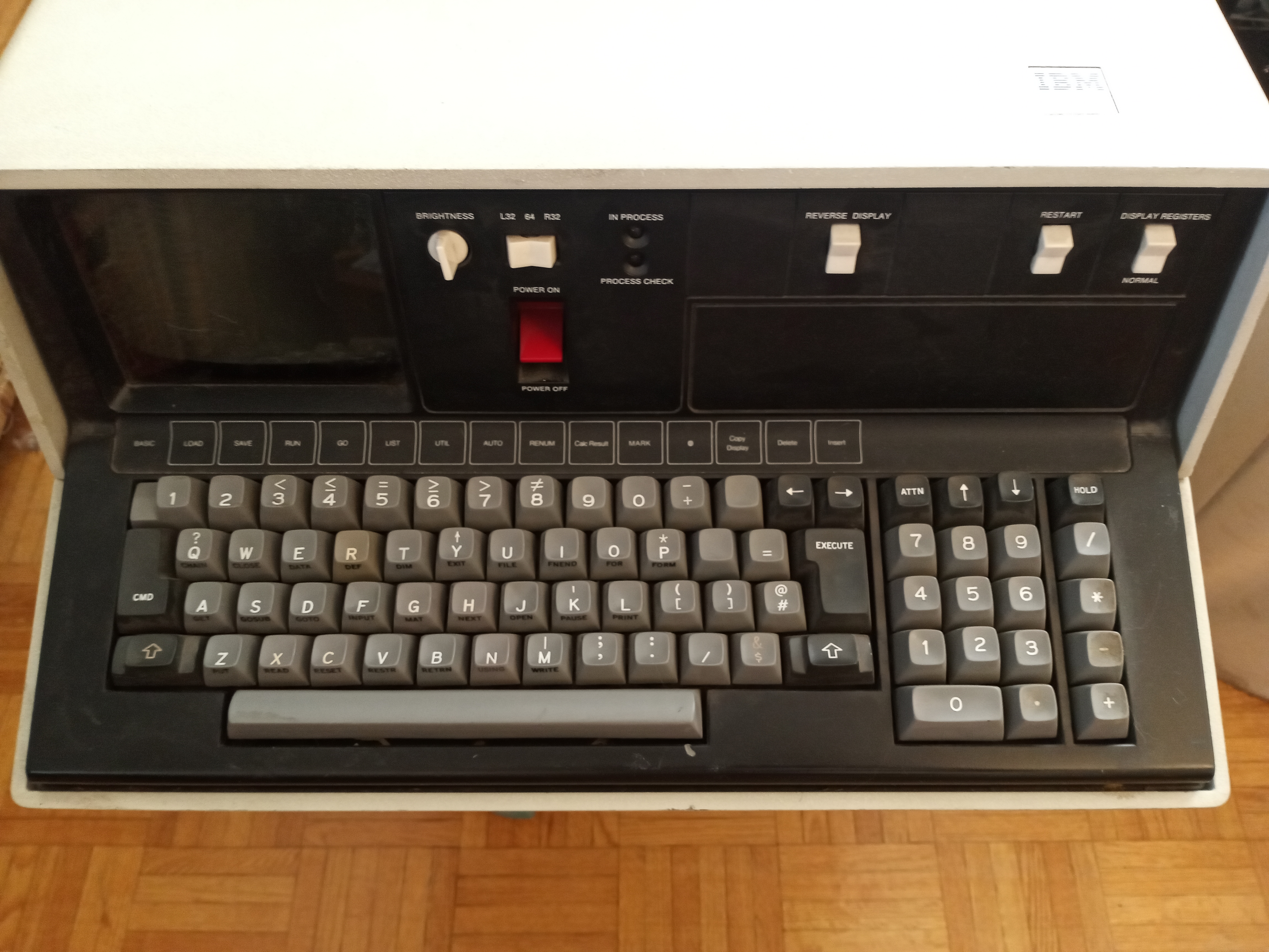

Here is a closeup of the keyboard part as well as the screen.
Not sure what I will do with it. I might attempt to restore the computer but I have no idea if I will be able to restore the drive unit.
Regardless super neat find and am very pleased. It also has one of the strangest arrow nav systems ever.

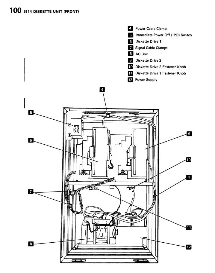

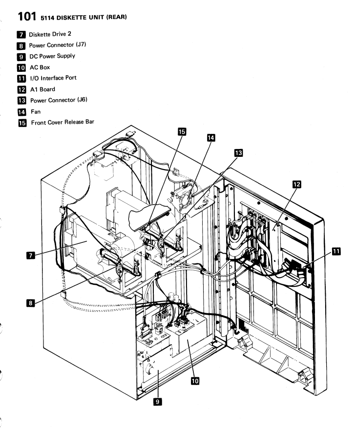

Looks like that drive is IBM 5114: http://www.bitsavers.org/pdf/ibm/5110/S ... an1979.pdf
I second inmbolmie's note on PSU check - for all PSUs in the system separately.
Another thing is checking the belts - but there's really nothing you can do about those, they either snap when you first turn the system on, or not. Even if they snap - they won't break much.

DMA wrote: 15 Sep 2020, 01:44 Looks like that drive is IBM 5114: http://www.bitsavers.org/pdf/ibm/5110/S ... an1979.pdf
Did this thing really have to be so massive? I feel like they could have shrunken it significantly without too much effort design wise. Unless I'm missing something:

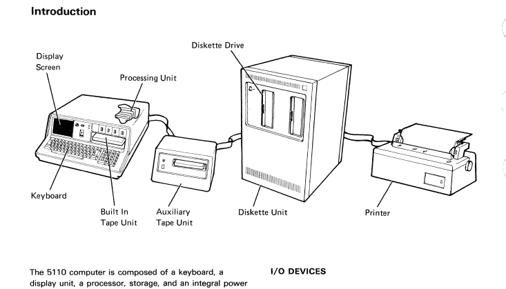

The Manual has this interesting picture:
This kind of explains bulky devices. Depending on your needs you'll have a semi-portable, two-suitcases semi-portable, and full capacity system with diskettes and printer, disk enclosure possibly serving as a printer stand.
Upd: Page 2-46 of the manual contains a table of voltages coming from power supply with load removed. This means the PSU _can_ run with load removed. SO. Pull out Y1 cable from the socket, power on, measure output voltages, run for 2-3 minutes (paying close attention to any smoke or heat coming from PSU while wearing protective glasses), power off, try to spot hot parts without touching them (filter caps will hold a lot of charge at this point - harmless to you but you don't want to accidentally short things together). If everything is OK - wait for 10 minutes, put Y1 back, power on.
PS: pay VERY close attention to not shorting anything while measuring voltages. Shorting, for example, -12 to +8.5 can kill _both_ outputs.
