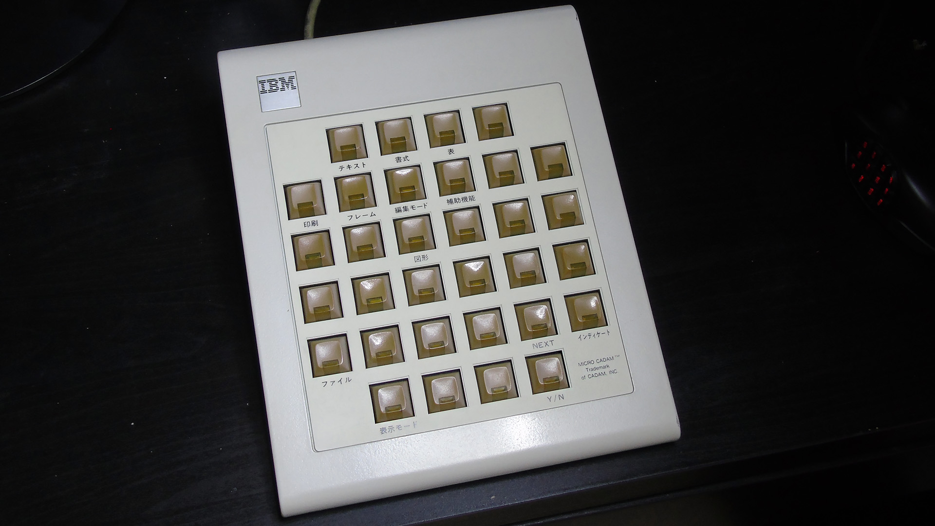

blackbit wrote: 06 Jul 2020, 21:20the logic inside the function keyboard.
Seems so. In fact, I have an IBM-branded version of one of these from 1991 that I bought from Japan a few months ago, and there's a lot of circuit in these for what they are, indeed.
2020-04-29 SNKB-0199132.jpg (311.27 KiB) Viewed 2580 times
I haven't gotten it to speak serial yet either.
