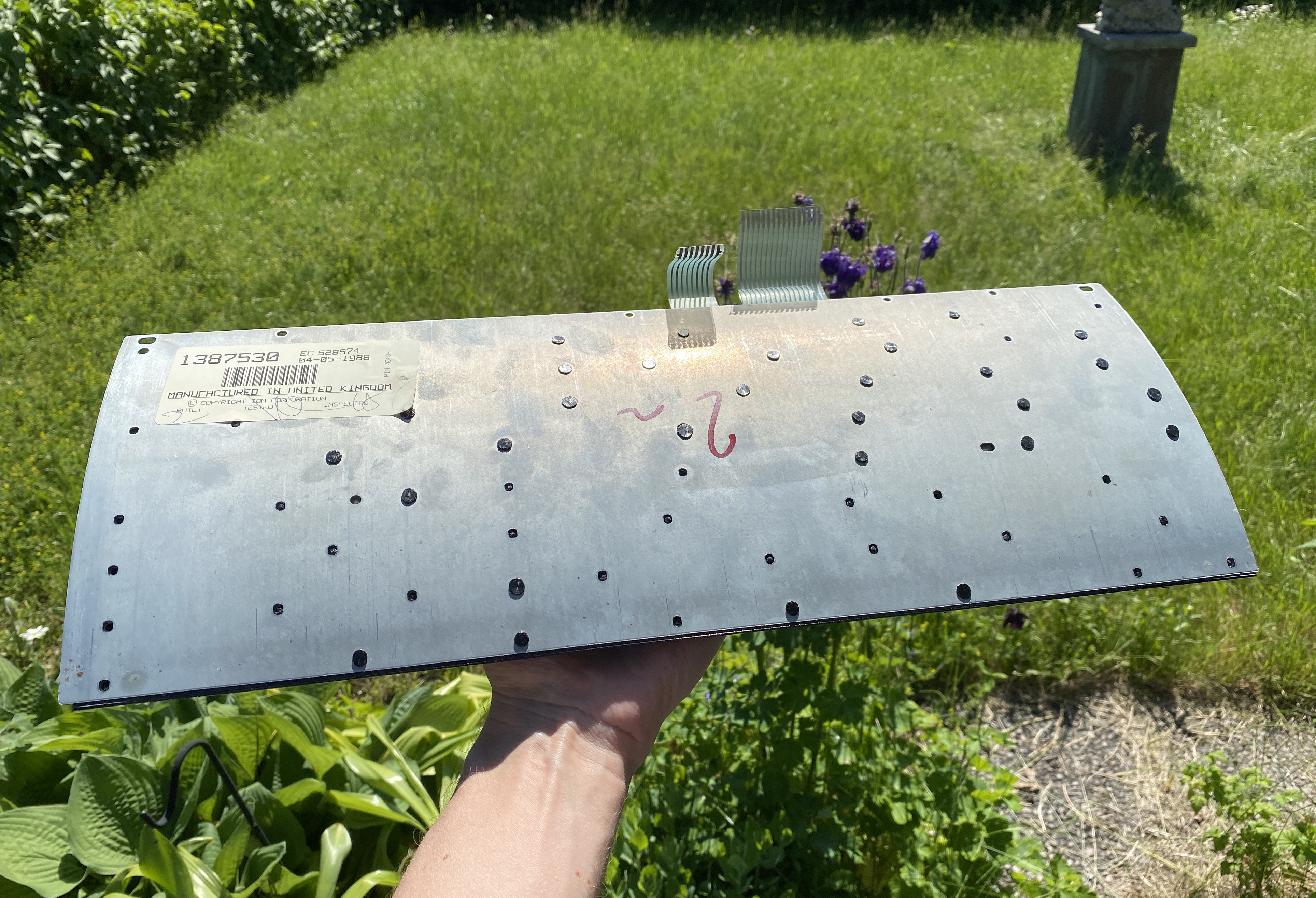

Guys - I've got a Model M (my first) which seams to be in great condition, but I just took it apart and a bunch of the plastic rivets have fallen off. After reading a long thread about screw/bolt modding here on DT I felt like it could be a long a tedious project (especially the drilling part and getting the holes straight). So if possible I would like to avoid that.
How do I know if my board is "good enough" or if it needs a screw mod? Just pushing on the plate don't show much, if any flex but maybe that's not what we're trying to fix?

"Good enough" is subjective. How do the keys feel when you type on them? Do any of the keys feel mushy? Do any catch on other keys? It's up to you whether it's time to add some screws or bolts based on how the keyboard feels to you. If every key feels good, then doing a bolt or screw mod may not be necessary.
If certain areas don't feel quite right, adding a couple of screws could take anywhere from 10-15 minutes if you just touch up those areas. If you'd like to invest a couple hours of time you could pop all the remaining rivets out and add a bolt or screw to every hole where a rivet goes. If you decide to add screws or bolts you will need to drill out a pilot hole for each one you decide to add. When I bolt modified my keyboard I didn't really have an issue getting the holes straight. As long as you eyeball it alright it's not a huge deal, but do be cognizant of screw or bolt head clearance since if you have giant screw or bolt heads sticking out of the bottom of the barrel plate, it won't sit properly in the case. Also while using screws is considerably more convenient, if you have to unscrew and rescrew the screws several times they will eventually wear out the plastic, which is why I personally prefer flathead bolts and low profile nuts over screws.

My policy:
All the keys sound and feel the same ---> OK
Not uniform keyfeel, too pingy or too mushy ---> Partial screw mod
The thing falls apart or comes from a swamp ---> Complete screw mod
In your case it seems that there are much less rivets in the bottom rows and in the numpad zone, so check that areas.

After further investigation it's only on the outer part of the numpad the plastic plate if flexing.
All guides I've seen have covered modding all rivets, could I do a partial screw mod?

For sure. If you don't want to or don't have the time then a partial screw mod could work just fine. It's all about whether the keyboard is enjoyable for you to use, so if it's working great for you then no need to go crazy on a project you're not quite ready to do. Just be gentle as you drill out the pilot holes and screw in the screws so more rivets don't pop off.
