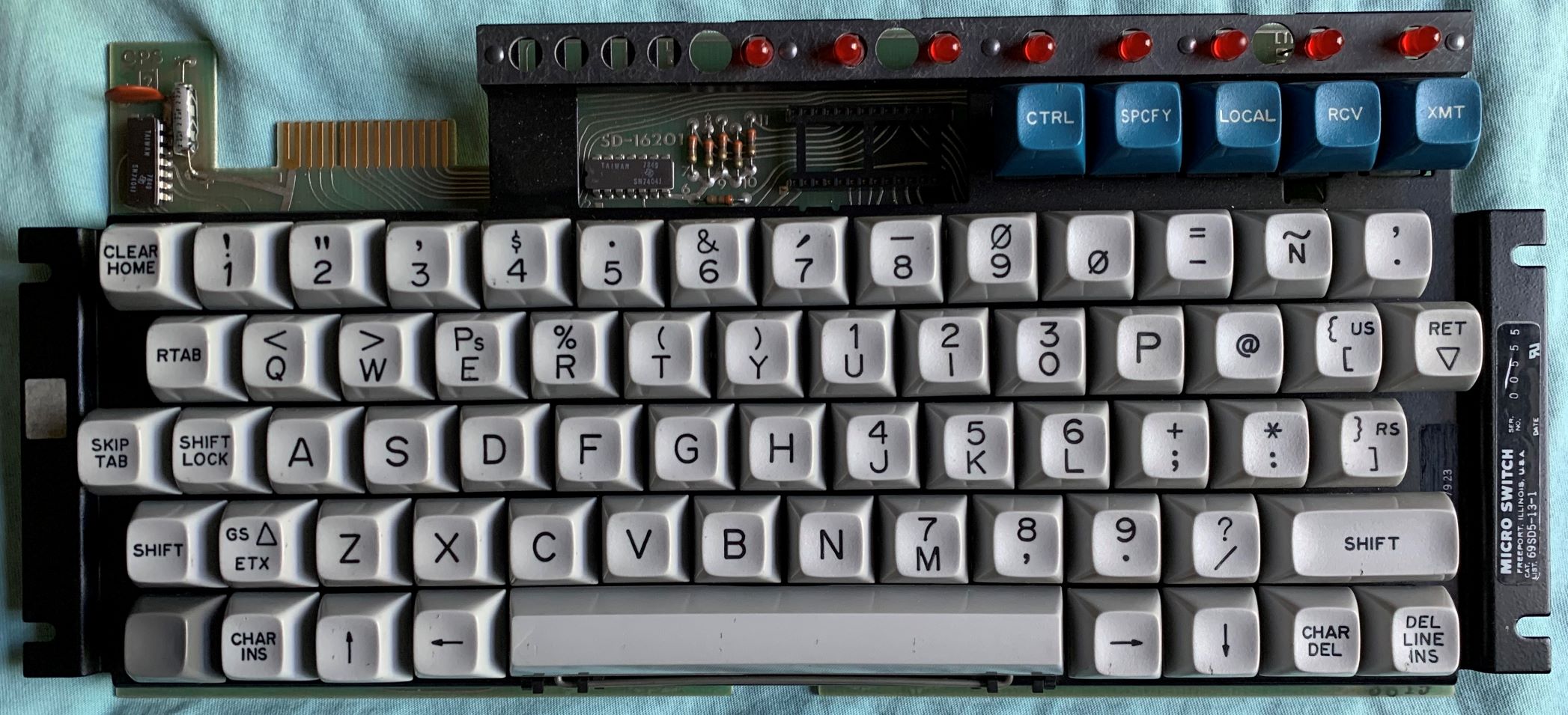

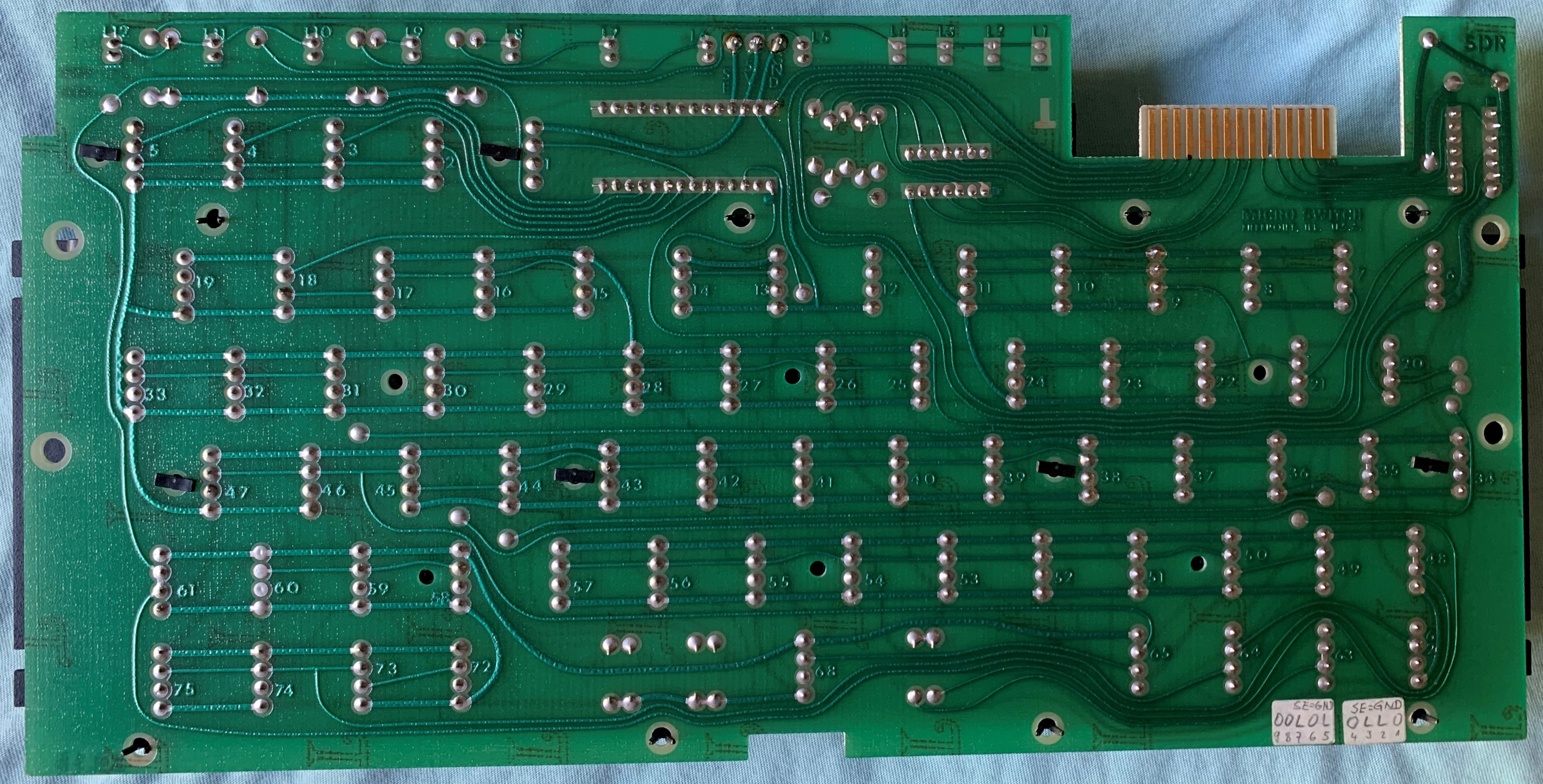

JP!'s recent finds had me taking another look at the SD boards that are sitting around here waiting to have something done with them.
This board, 69SD5, is the guts of a data entry terminal for a Burroughs TD-730/830.
That is, it is more or less the same board as pr0ximity's in Burroughs TD016 "Data Preparation". Or the smaller sibling of another one here that still has its case, as discussed in Burroughs TD 830 Series Keyboard.

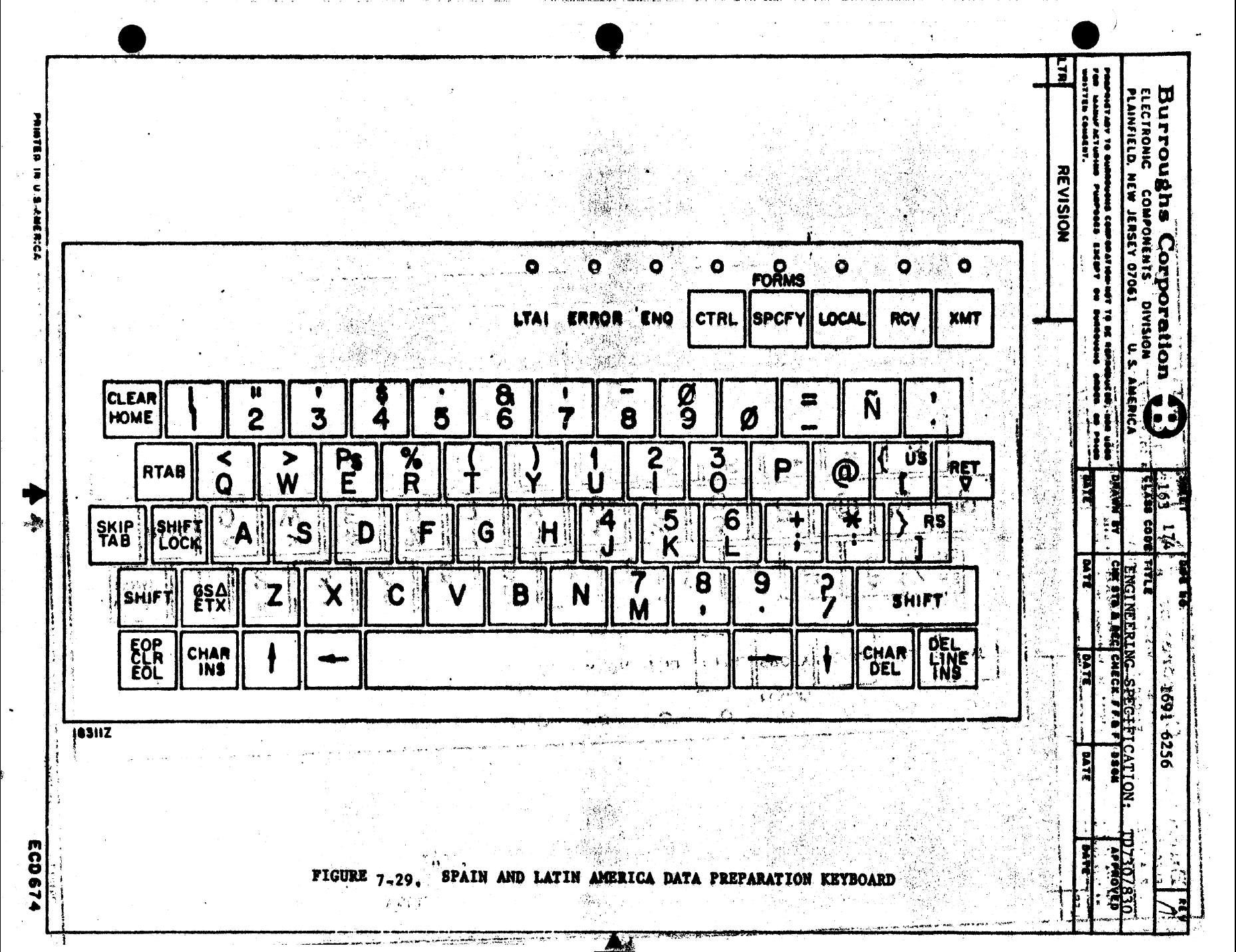

Specifically, it is the Latin American / Spanish variant.
Of course it's the same PCB, SD-16201. And while pr0ximity's is 69SD5-8-1, this is 69SD5-13-1. The date codes are 7811 and 7923, respectively. So I imagine the 13 is the key cap variation. And perhaps firmware, although the one here doesn't have its AMI LSI controller at all.
Some of the keys look like they got scratched by some through-hole pins or something and it has one replacement key cap. Though there is one just like it with the same date code but complete and undamaged on eBay right now for €200. So there's a cache of them out there.

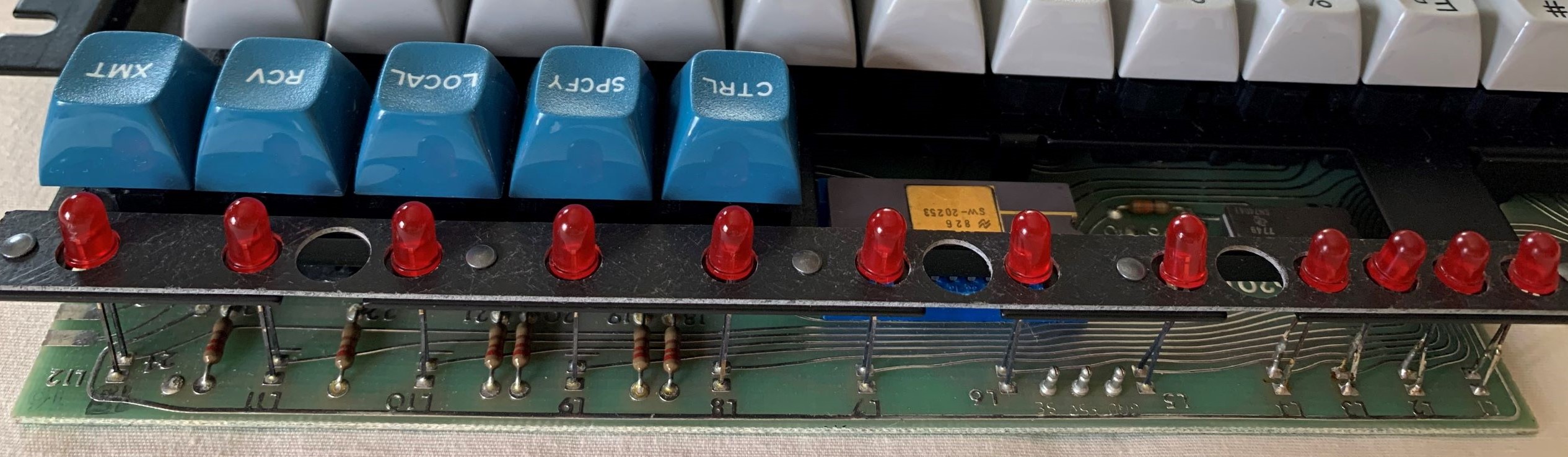

The keyboard interfaced to the cable through a 2x15 PCB edge connector. The top side has +5V on the left two pins and then connections for its 12(!) LEDs, of which 8 are populated here. And the final pin is the other side of the LEDs' several 220Ω resistors. The missing 4 LEDs are also missing their common resistor.

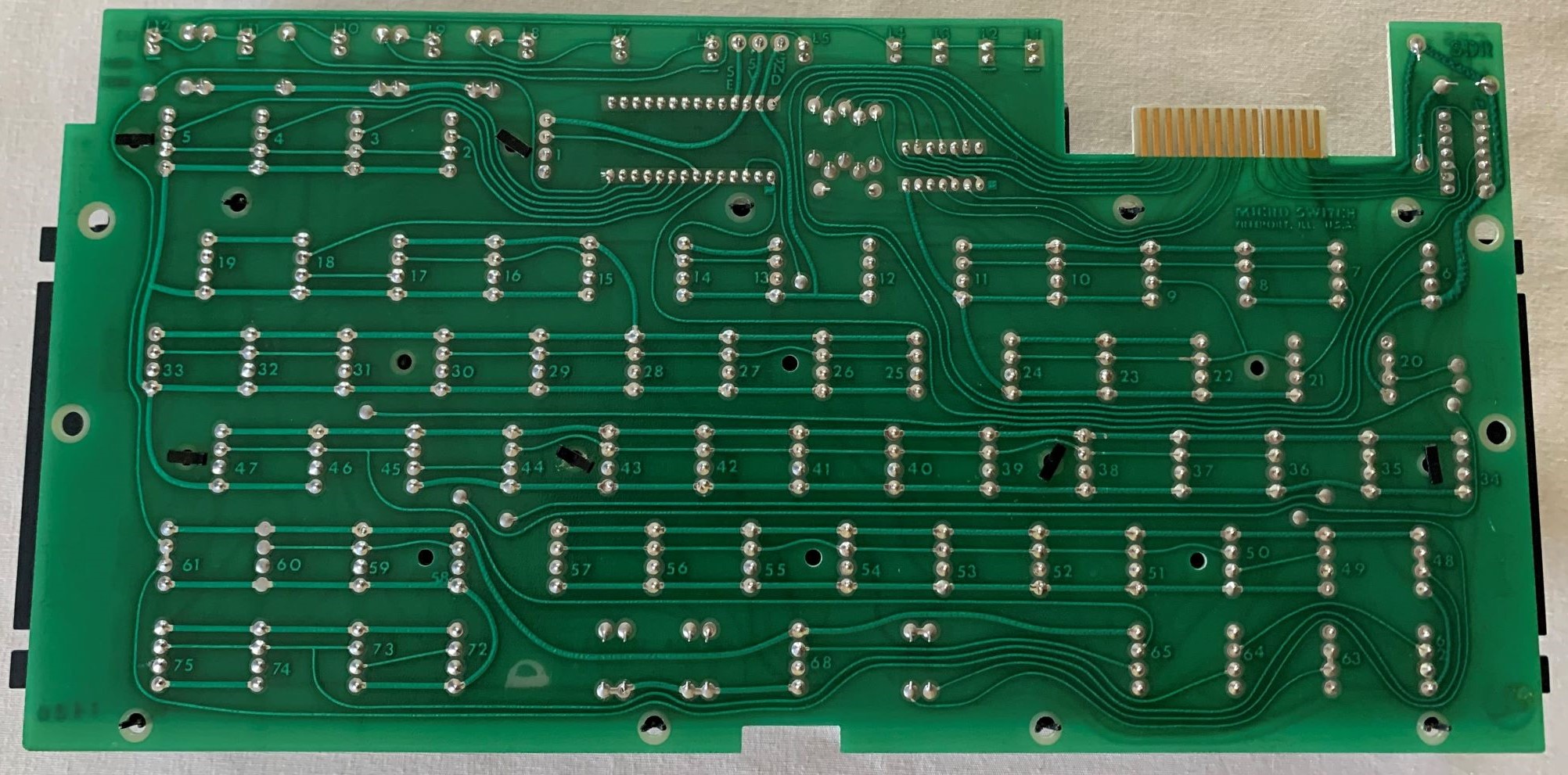

The interface to the keyboard proper is on the other side. Two pins of ground, the dozen outputs of two hex inverters, and a connection to the last pin (28) of the controller.
The switch traces still have a bit of Chutes and Ladders that suggests not a matrix proper but two-of-n, like with SW series. And, indeed, almost all the switches are 4A3A. The beautiful baby blue command switches are a bit heavier and pulse only 4A8B.
The SHIFT LOCK is exactly that: the two SHIFT switches (61 and 48) and it (35) are all the same signal to the controller. These all have the dual outputs shorted together with a brief PCB trace.
Which leaves the strangest thing about the switch wiring. The RTAB (20) switch also has its outputs shorted. And it's a source level 4A3C and connected directly to one of the output inverters, skipping the controller. I cannot think of any reason to engineer it this way. Why would this function need special treatment?

I am still debating what the best way to build a converter is, because of the need to access both the switch "matrix" from the MCU slot and the LEDs from the edge connector.
In a spot check, some of the keys didn't work. Every one of the scan lines got at least one hit, so it isn't a mistake there. May need to scope those switches and see whether they got damaged somewhere along the way.

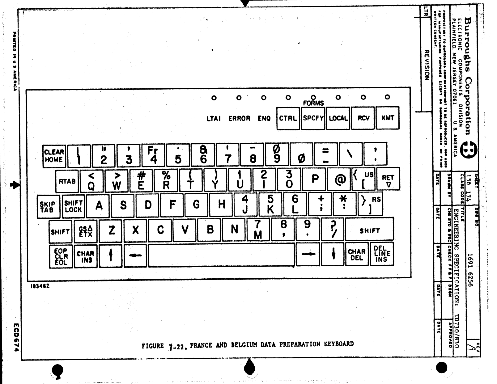

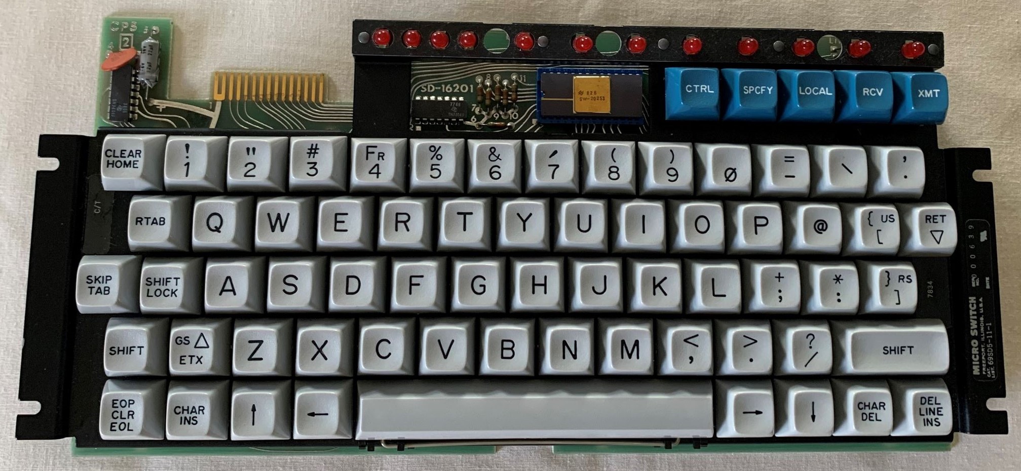

I managed to find another of these keyboards.
This is 69SD5-11-1, the French variant.
The SD-16201 PCB is the same, so the wiring is essentially identical.
This board has things that were missing from the Spanish variant above:
  • The CLR EOL / EOP keycap.
  • The AMI SW-20253 encoder.
  • All twelve LEDs.

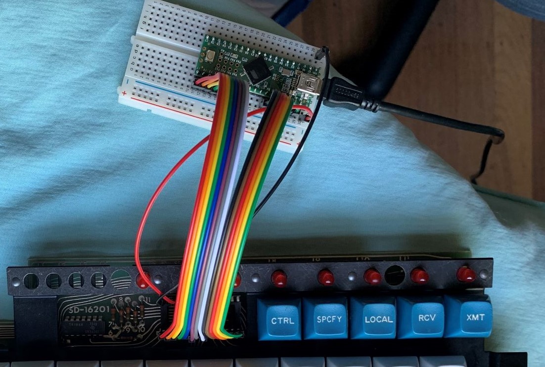

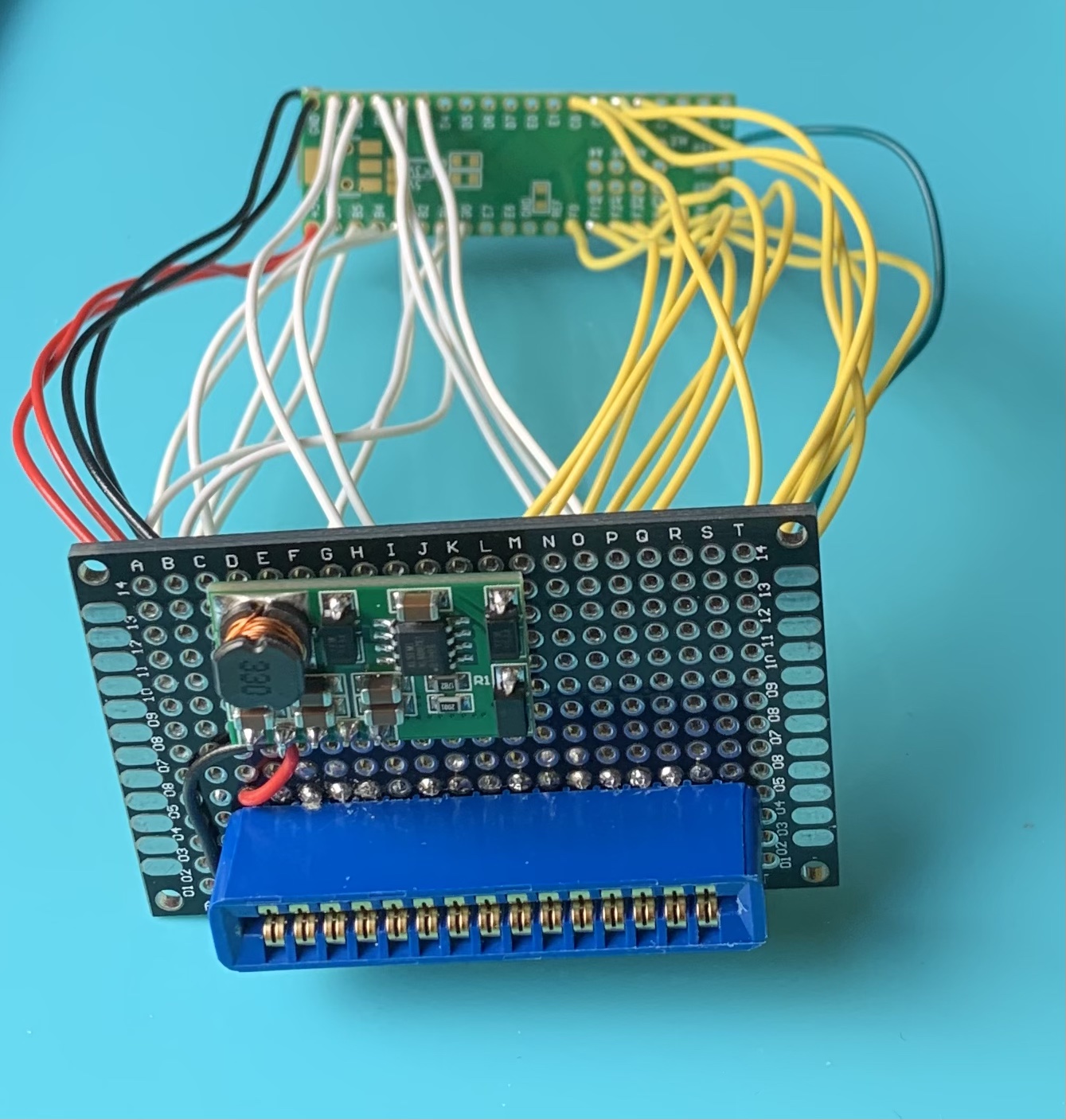

This gives a chance to confirm the details of the protocol. With all those LED signals on the input side of the edge connector, a Teensy 2.0++ is needed. And the CMOS needs -12V on S (it is actually probably fine with any low negative voltage).

The four new LEDs do not work yet. That is because there is a 220Ω resistor needed in position 24.
It can be seen as missing on the far left of the photo (top right of the keyboard). The solder isn't pristine, though, so I am not sure whether it was removed or never successfully added. I will probably add one, on the grounds that this is restoring functionality, not altering it per se.

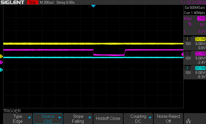

Most of the broken keys do not ground either of their outputs. A few are missing only one of the two.

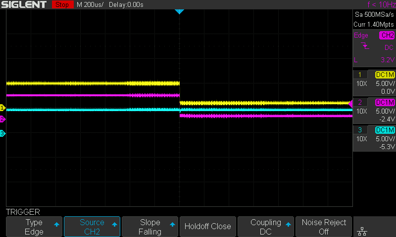

Hooking up to a scope does not reveal much, except that a couple of the bad keys do have a small ripple when pressed.

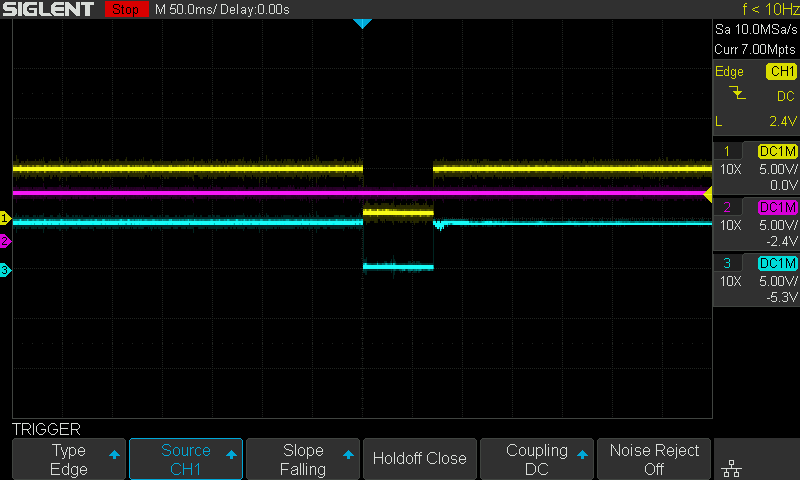

A working key will stay low as long as pressed -- it is the encoder the loses up transitions. Here are Q (2 + 4) and W (2 + 3 -- zoomed 4x).
Here is A (3 + 4), where something happens but not all the way to ground and only for a few hundred microseconds.
So it really does seem like the Hall Effect circuit is damaged. Could it be something about how these keyboards got from Burroughs terminals into the surplus market?
