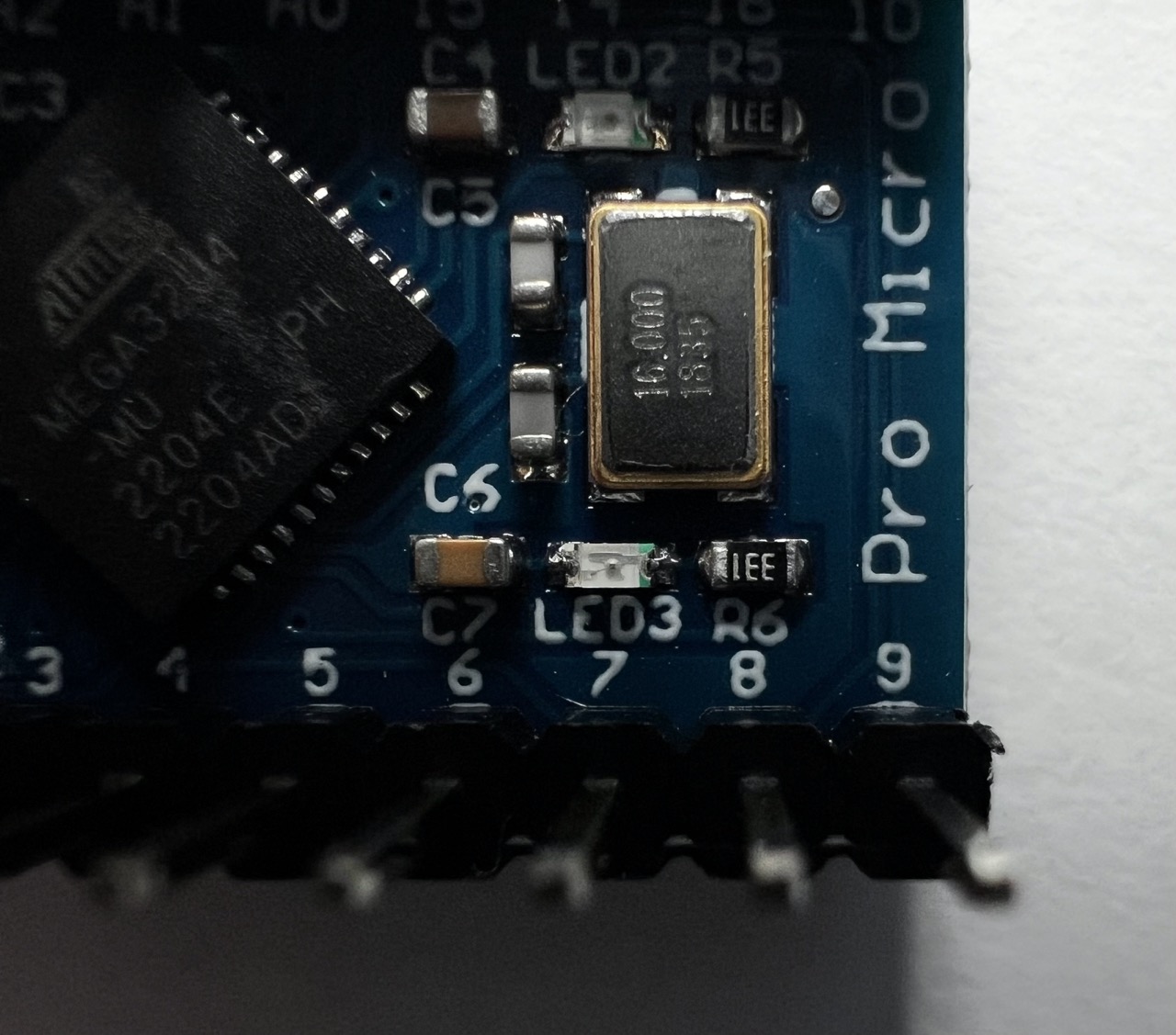

If you're using Soarer's Controller firmware, it can work but with one modification. The firmware's (at least by default) use of pins was designed with Teensy 2.0 in mind, and one such pin it uses (PB0) is exposed on the Teensy 2.0 but is used internally for an LED (RXLED) on Pro Micros. You should be able to remove the LED's resistor and solder a wire onto its pads to recover the line. See my website for the full pinout you need to use for Soarer's Controller on Pro Micro.

Oh wow, thanks for the fast answer. You mean the black little one on the right?
Groß (IMG_3367).jpeg (239.23 KiB) Viewed 22846 times
That is very tiny... I soldered the legs on the micro several times for other Ms or Fs, but that tiny thing looks difficult....

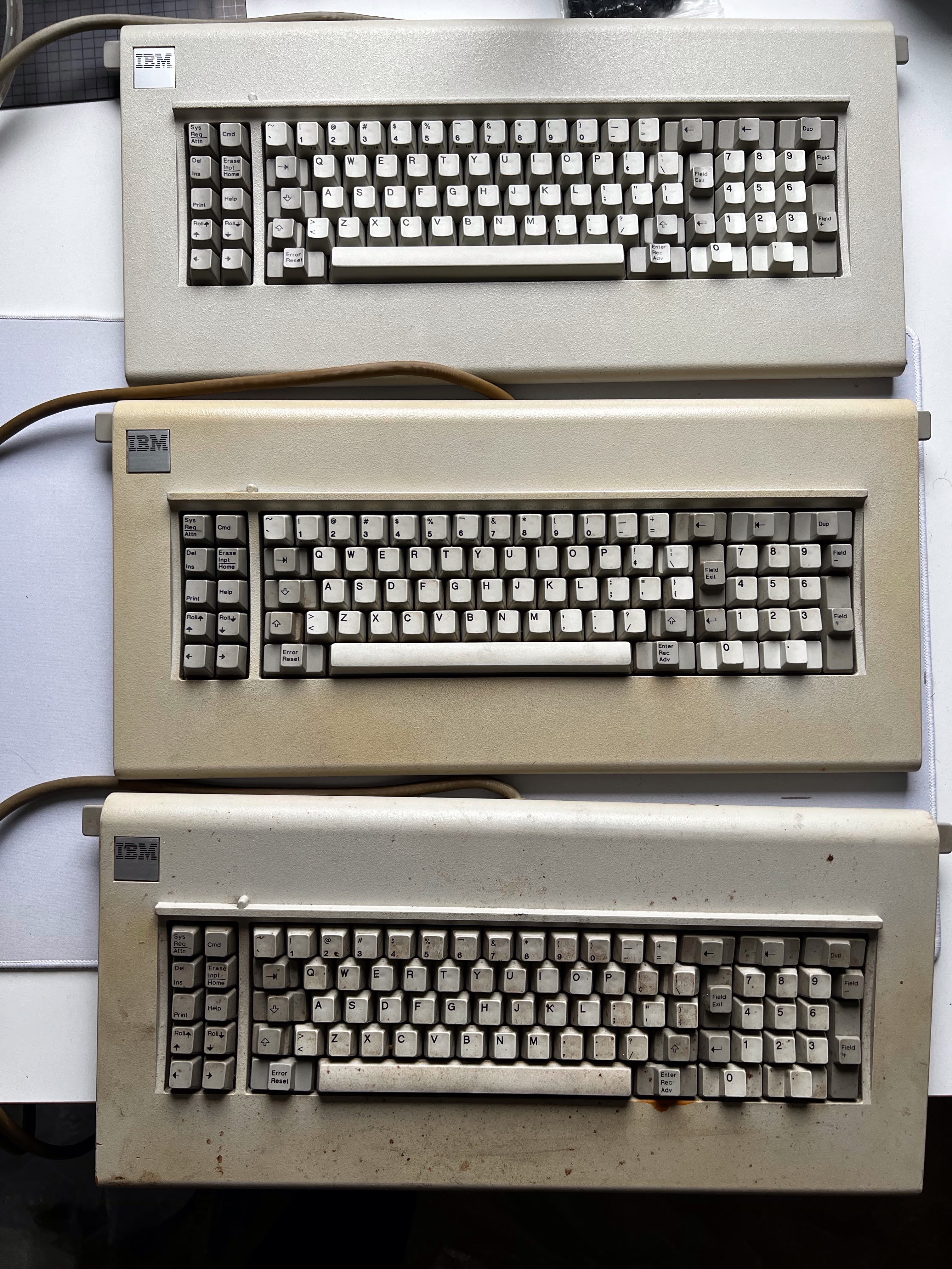

I just saw teensy for under 10€ so I think I wait a little until they arrive before I destroy the pro micro…
Here are the bigfoots. I will paste pictures after the restorations.

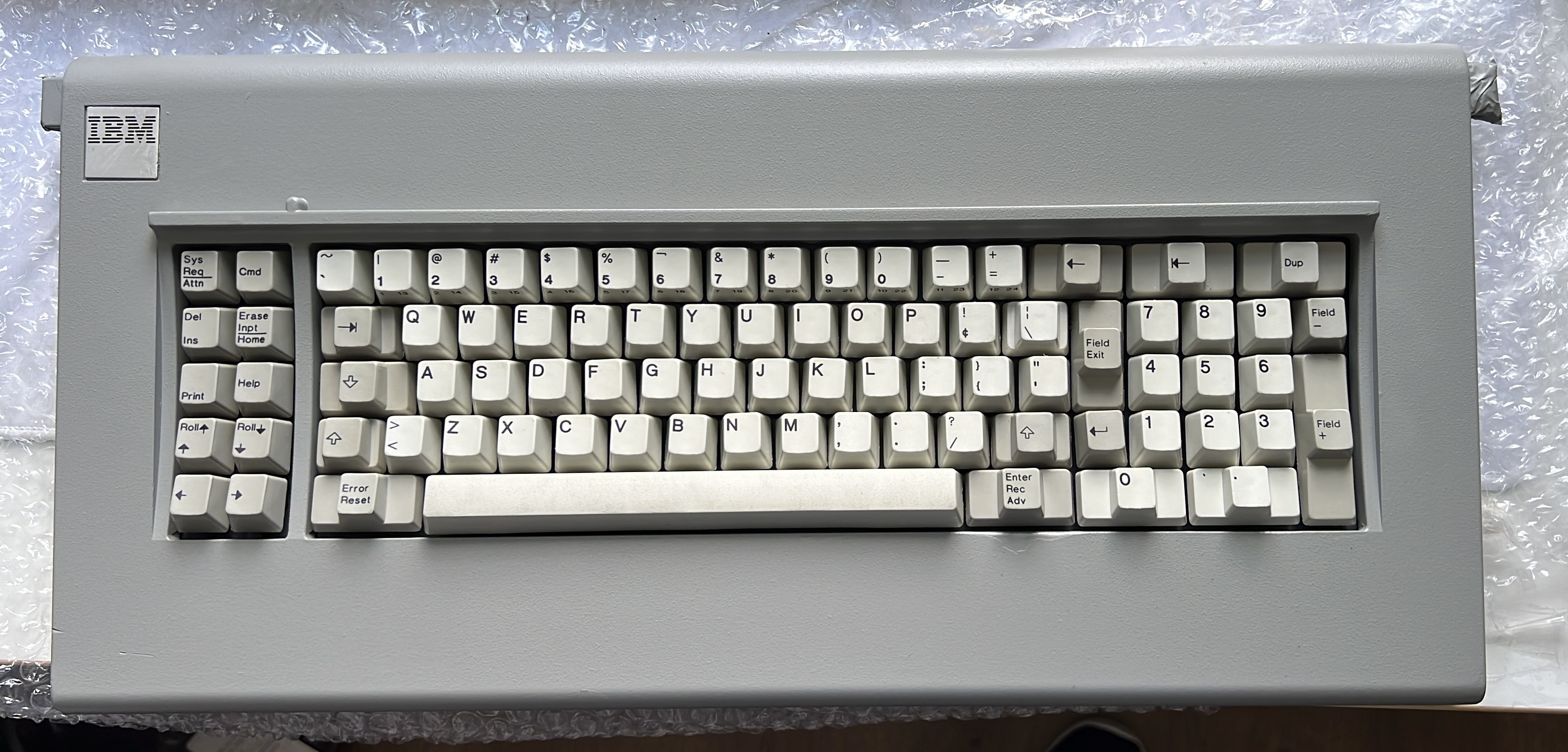

And I painted the last keyboard grey because the paint was damaged and I wanted the industrial look.

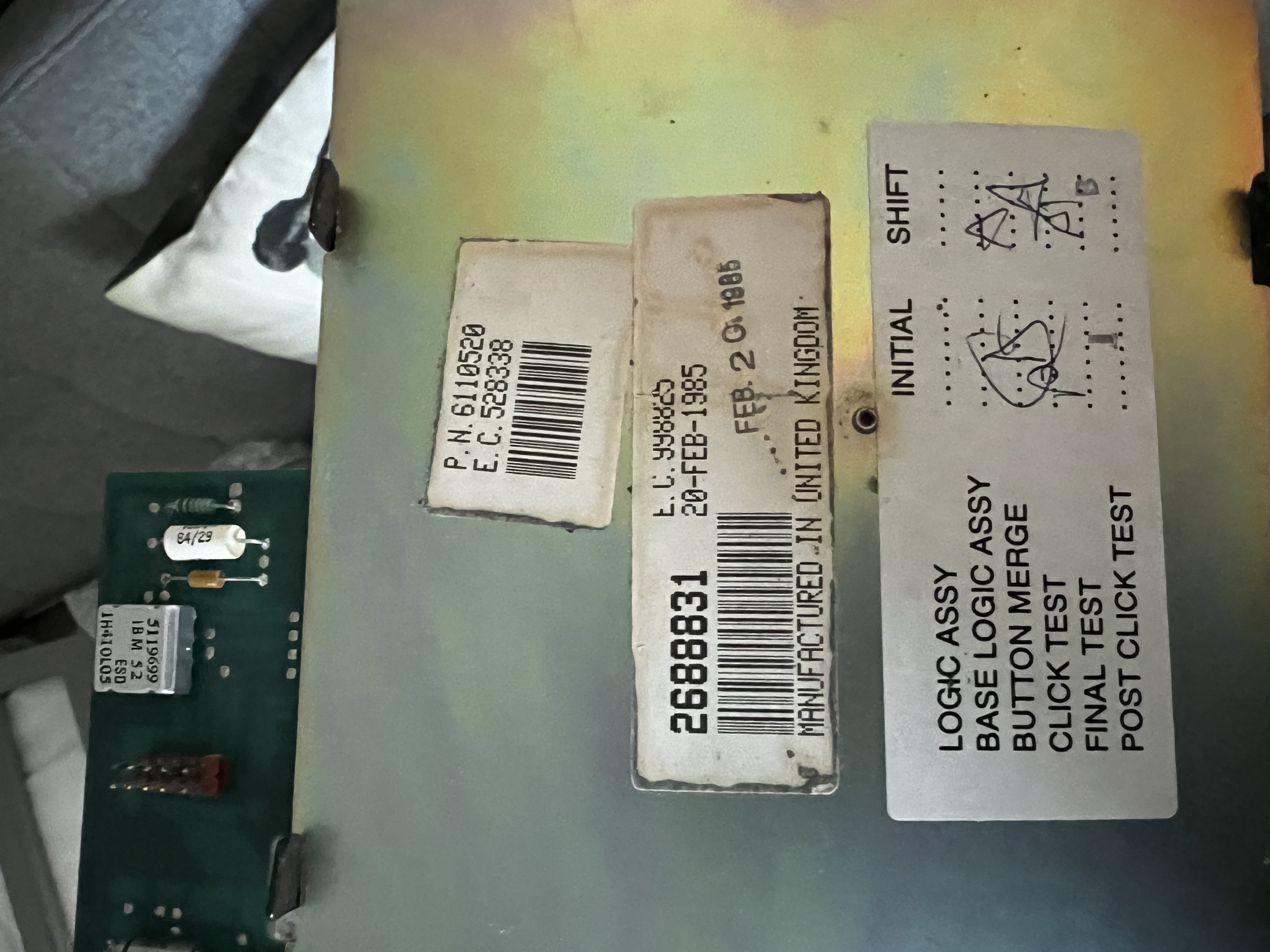

Do I have the 5291 or the 8521?
The product number suggests the 5291 right?

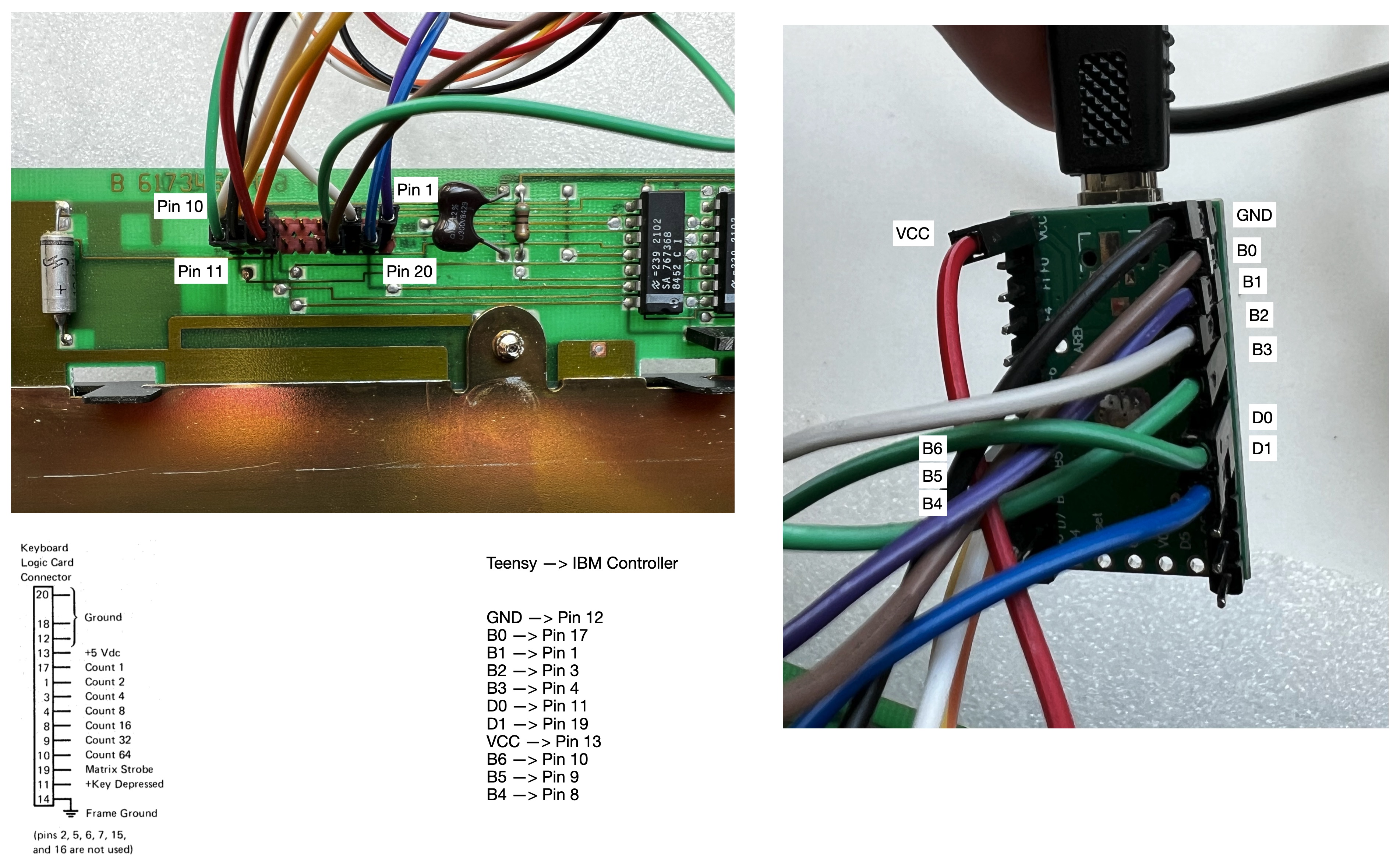

Ok, I found the issue:
The linked guide on geekhack is wrong: Wire 2 and Wire 3 need to be each one pin above!
Here is how you connect the keyboard to the Teensy:
Screenshot_2024-05-14 13.11.28_99s014.jpeg (1.37 MiB) Viewed 18153 times
