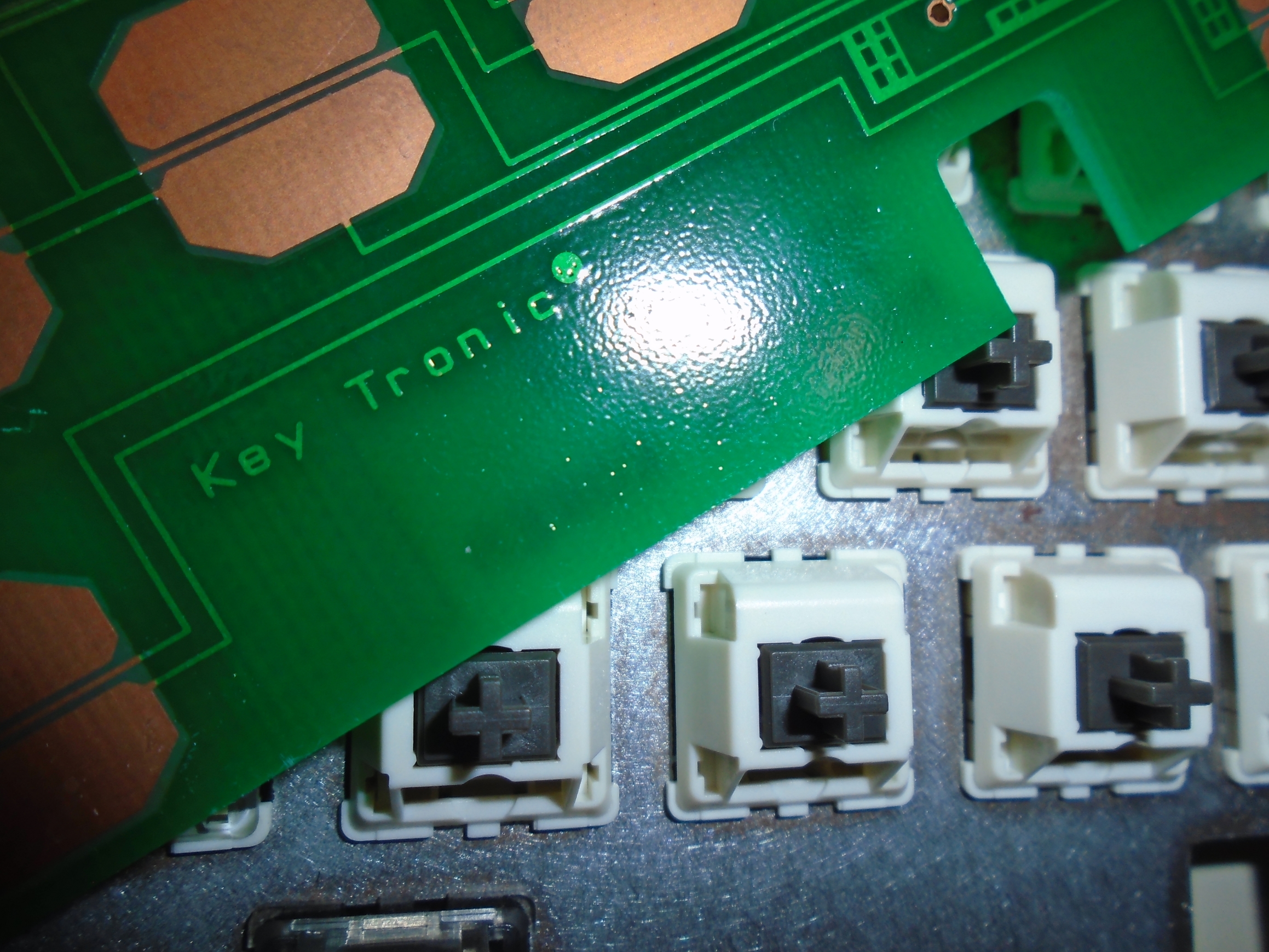

The Key Tronic's plate holes are a tiny bit bigger than Cherry MX, so that PCB is going to be needed.
I keep a Key Tronic plate as template for cutting foam dampener to put in-between PCB and plate. :)
abrahamstechnology
19 Oct 2019, 23:35
Findecanor wrote: 19 Oct 2019, 20:01 The Key Tronic's plate holes are a tiny bit bigger than Cherry MX, so that PCB is going to be needed.
Yes, it's going to be held in place with standoffs and I will drill the holes in the original plate. I'm also going to be using in-switch diodes like the old G80s did for more stability.

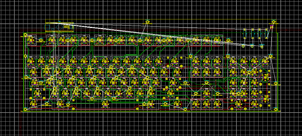

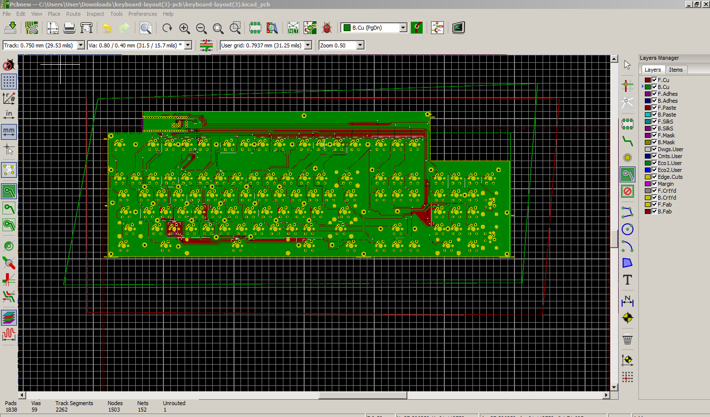

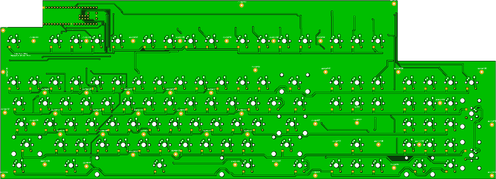

abrahamstechnology
24 Oct 2019, 20:29
Almost done with the PCB, going to do some final measurements on the old plate and case before sending it off.
(I decided to put the LEDs and beeper on separate modules)

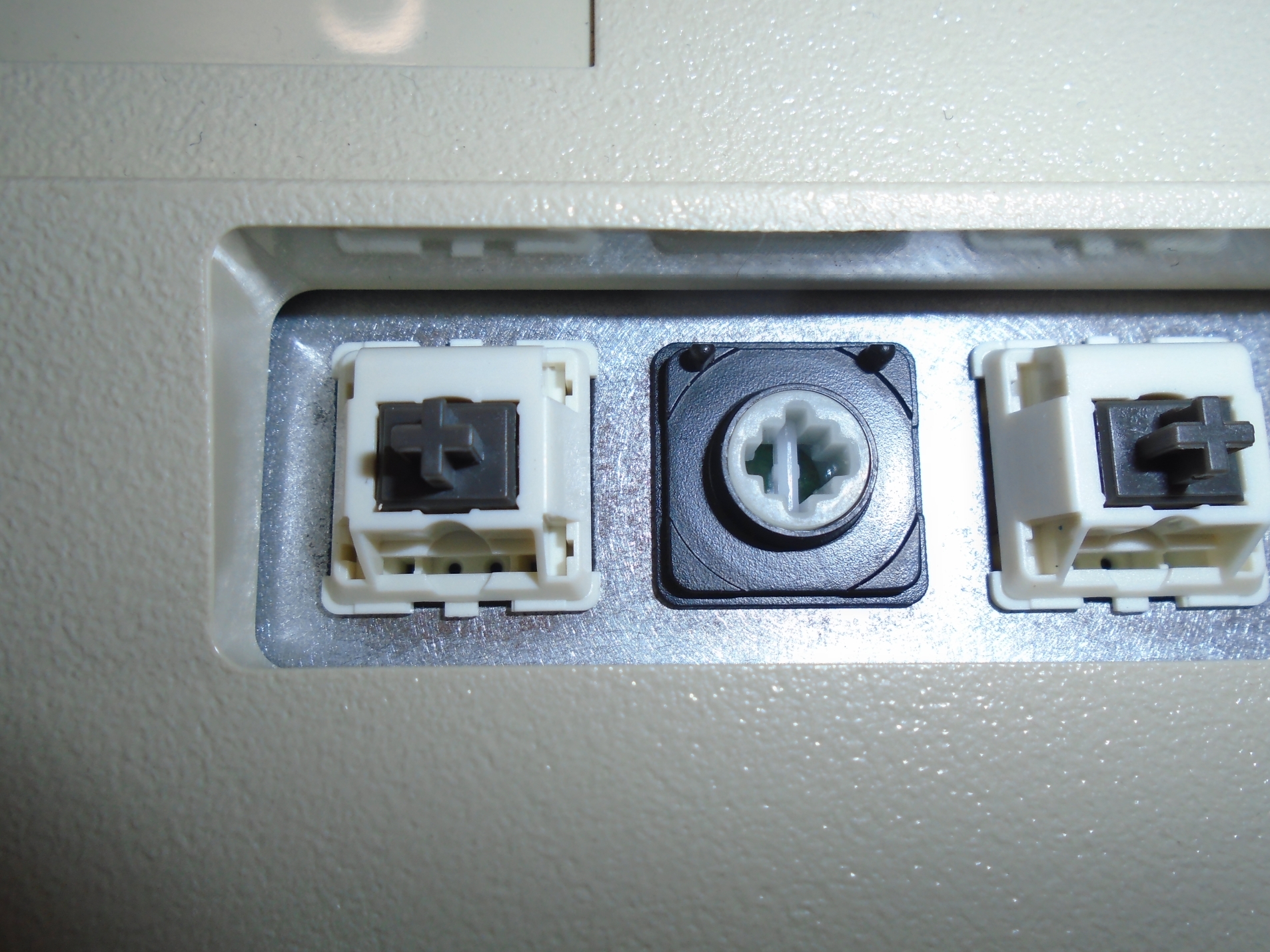

30 Oct 2019, 03:32
What is this blasphemy!? :o
abrahamstechnology
30 Oct 2019, 13:04
JP! wrote: 30 Oct 2019, 03:32 What is this blasphemy!? :o
I was going to try to revive the original sliders by deep cleaning and lubing them but they are too flimsy and several of them broke.
abrahamstechnology
09 Nov 2019, 02:44
Unfortunately, the idiots at KeyTronic decided not to use standard spacing between the numpad, navcluster, and alphablock so they are all slightly offset from each other.
What I'm going to do is cut the PCBs into 3 and wire them all together. It still should be pretty stable since I put standoffs in each part.
