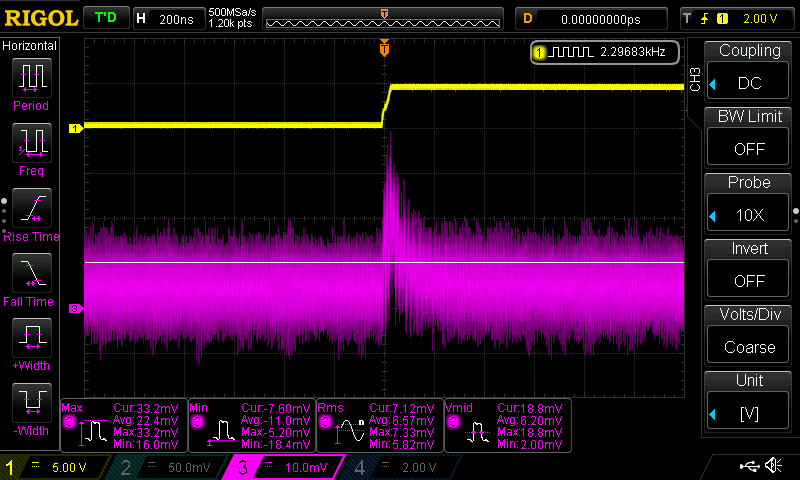

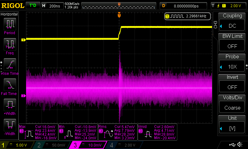

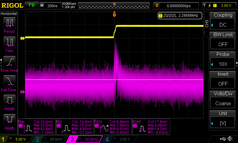

OK, I have good news and bad news. Good news is one can sense keypress depth: https://www.instagram.com/p/B0KiNFCFydI/ - kind of.
The bad news is you have 20 mV of noise and 15 (FIFTEEN) mV of signal, for what seems to be 100 nanoseconds.

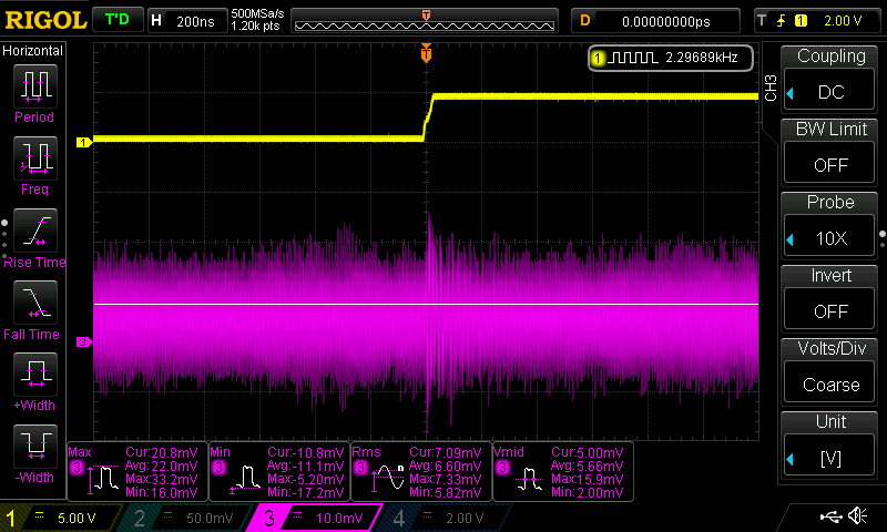

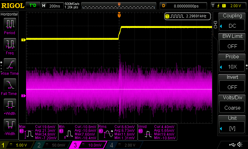

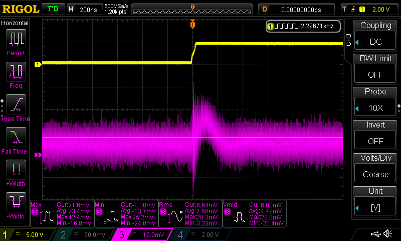

Here's non-pressed vs pressed oscillograms for 4-switches in series, loaded by:
Nothing (well, oscillograph probe is some load):
100K resistor:
Small ceramic capacitor:
Looks like capacitor is the best, but 50 nanoseconds is not really workable.

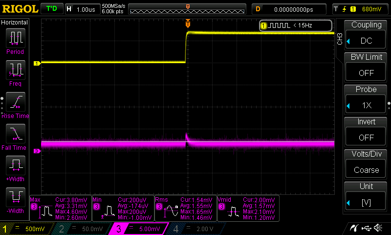

21 Jul 2019, 21:08

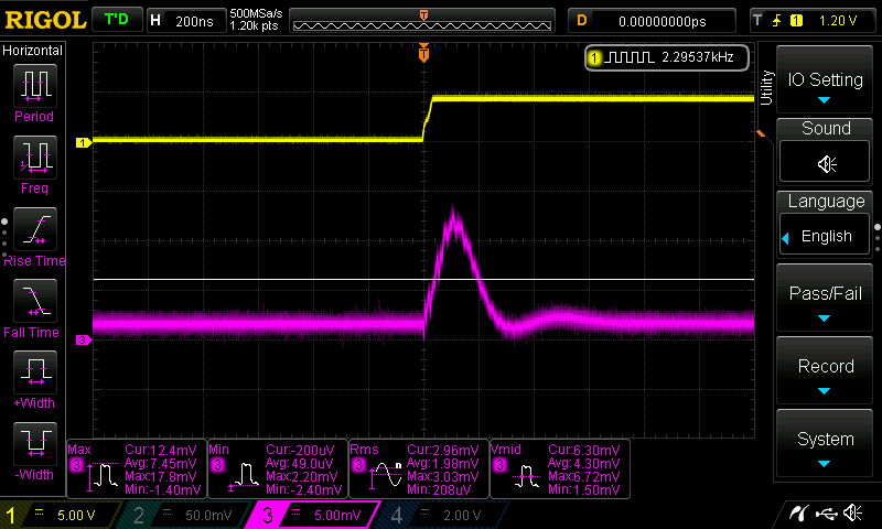

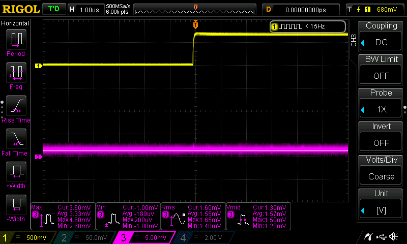

Turns out the noise was my scope. I remembered the probes have 1x position and remeasured.
It's not that bad, but 50ns measurement window smells like OpAmps - which we have, but they only can be used on specific pins and there are only 4 of them (so either external demux OR external OpAmps OR rewiring of ALL the switches OR using 2(3?) kits and an internal USB hub.)
100KΩ load:
No load:
Capacitor load
Also it seems like external current-limiting resistors (1kΩ) will be needed - current is just too low with internal pullups to produce any meaningful output voltage:
Rectifier would save the day - but rectifying 16mV.. haven't seen diodes having forward voltage of <150mV so direct rectification is out of question.

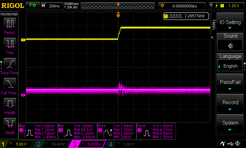

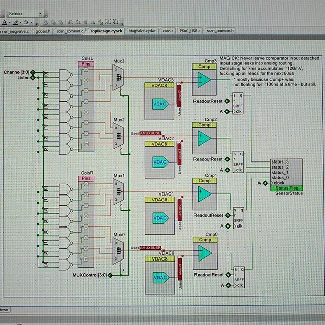

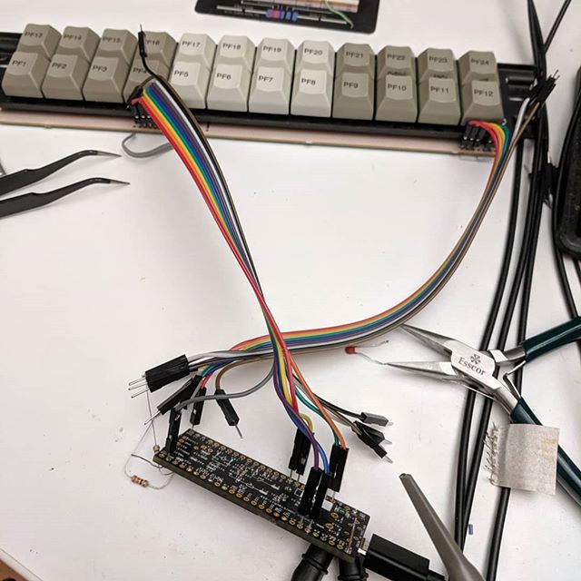

OK. I've got this 2x6 piece of matrix (in background) to work.
Scope is invaluable. I screwed up both in hardware (several things) and software (skipping half of the init, then shorting all rows in debouncing by passing zero instead of the row) - and the scope allowed me to figure out that OK, the scanner is now working, the problem is in firmware.
Couldn't do it on ADCs, had to resort to comparators. Trigger levels are FOUR MILLIVOLTS. Step is 4mV, and 8mV doesn't work already - signal is too weak.
Pin placement is trickier than in original CommonSense, because there are 4 MUXes, which strains analog routing a bit. But it's nice to have 4 parallel read channels - things are faster that way.

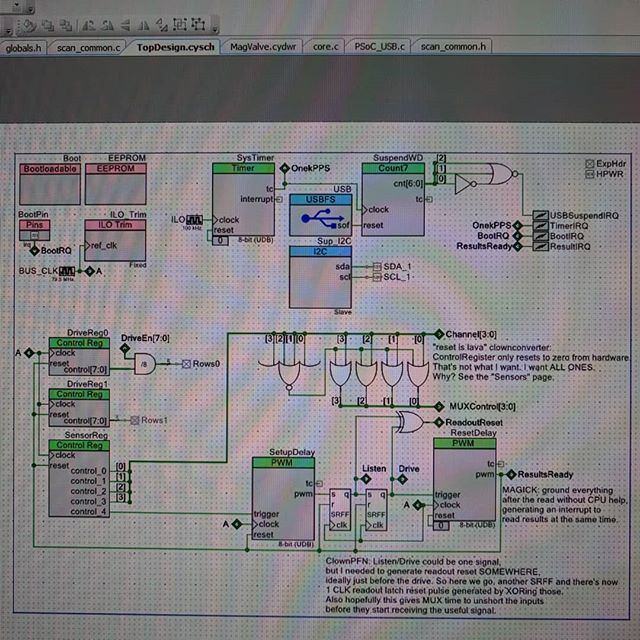

Here's the sensor:
And here's the driver/sequencer:
Will try to graft to this guy over the weekend, see what happens. Today is exactly 11 months since I've got it. Hopefully Sangdrax will be typing on it before it's a year ;D
