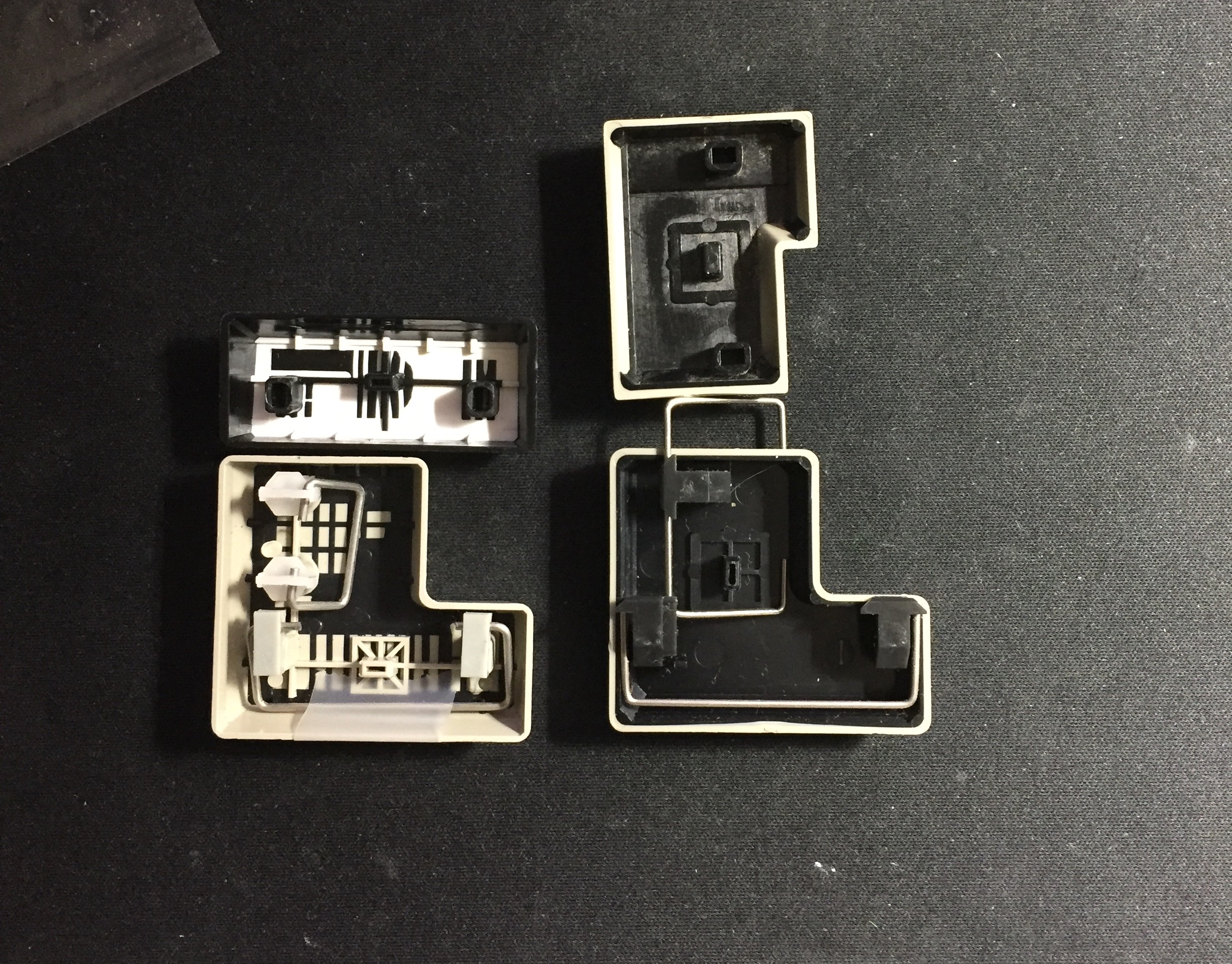

Switch breakdown:
These are the switches I personally own at one point or another.
- Tactile White: always has LED slot for top housing, commonly found in Sony Audio Units
- Linear White: commonly found in NCR board
- Linear Amber(heavy): commonly found in the same NCR board on the spacebar
- Linear Stripe Amber(light): commonly found in the same NCR board on the enter key
- Clicky Amber(heavy): commonly found in NTC boards, or sometimes Monterey KB101
- Clicky Cyan(light): commonly found in Focus FK-555 or Datavue Laptop
The Cons
- 3-pins over-engineering piece of shit switchplate:
Unless you have a professional desoldering gun, I do not suggest harvesting these switches. The pins are the smallest comparing to SKCL/M and MX. Not only that, a little bit overheating will immediately kill the switches. The fail rate for my harvested omrons are about 8%, which is absurdly high comparing to 2% for SKCL/M and 0.5% for MX. In one video Chyros mentioned that these switches are very finicky, I believe partly because the switchplate are made of very soft plastic, it is easy malleable thus permanently destroy the switchplates. I tried both high heat and low heat and the fail rate is still that high around 8-10% per batch. Coupled with the fact that they have 3 pins for no reason, you WILL fuck up.
- The absolute worst switch type for rework comparing to MX, SKCL/M, Model M, Model F, and Topre (please refer to the build section for this)
- The limitation of cap choices
B3G-S omrons are fatter, vertically, compare to SKCL/M. The thicker caps will not work properly with these switches. On the left are SKCL/M native caps and on the right are Omron native caps(all row 3)
1. AEK
2. Next Non-ADB (AE doubleshot)
3. Dell AT101 (AE dyesub)
4. IBM 5140 (IBM dyesub)
5. Sony BKE (Sony dyesub possbly)
6. NCR something something (Omron dyesub)
7. Datavue (Omron dyesub)
5,6,7 are fully depressed with no problem for Row-3 caps
2,3,4 are not fully depressed for Row-3 caps because of the extra nubs inside the caps
The pros:
- Consistency The number one thing that Alps will never get correctly
All housings are the same with branding on top housings
All stems of the same type are consistent in colors (I'm looking at you SKCM Blues)
All stems are perfectly symmetrical, no extra slit/cut like SKCM stems
All switchplates are blacks, despite how shitty these were designed, they are consistent
- Same springs as SKCL/M series: yes you can use aftermarket springs for these switches
- Softer plastic
The housing are made of softer plastic, most likely POM. Hence the bottoming sounds are not as harsh as the SKCL/M series. This in turn makes the linear whites an interesting breed.
- Longer travel distance than SKCM and NO BUMPS
This is a major win for linear B3G-S, absolutely no phantom bumps when you bottom out, couple with the softer plastic housing, this is the perfect stepchild between SKCL and MX if you're looking for shorter travel true linears with muted bottoming sounds.
- Tactile Whites makes sense
At first we were aiming for Linear and Clicky Omrons, but throughout the development phase we realize that Tactile Omrons are the true champion if you want to experience Omrons. The tactile leaves are clipped into the housings, so no matter how much abuses you put on Tactile Omrons, they will never start to click.

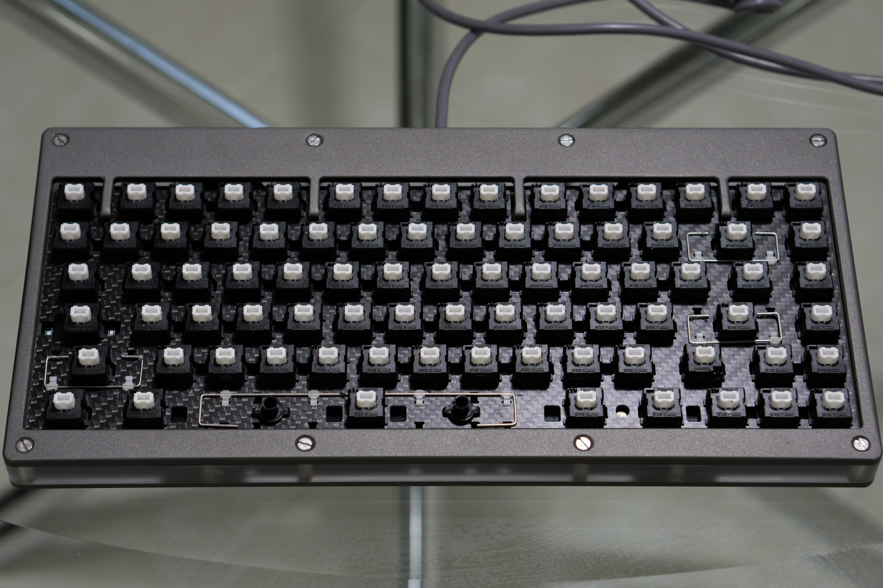

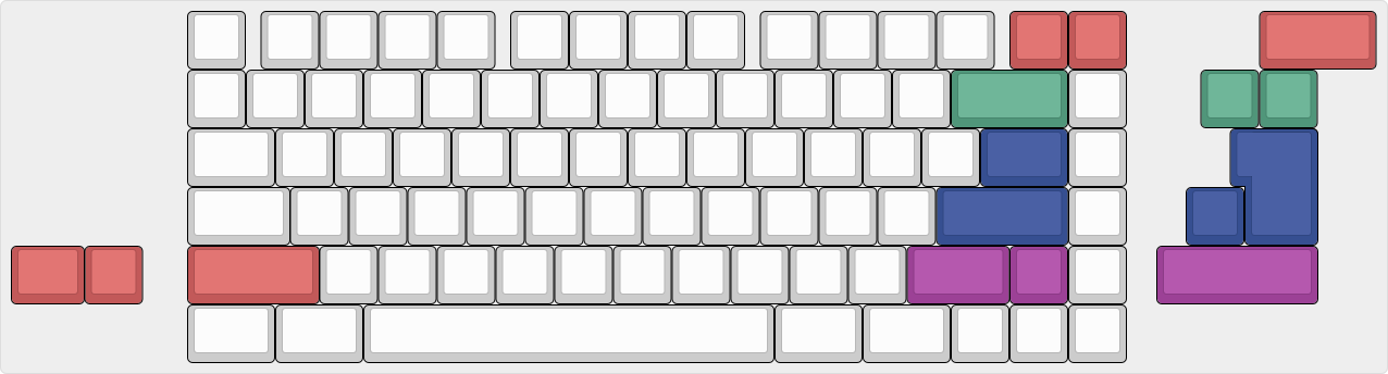

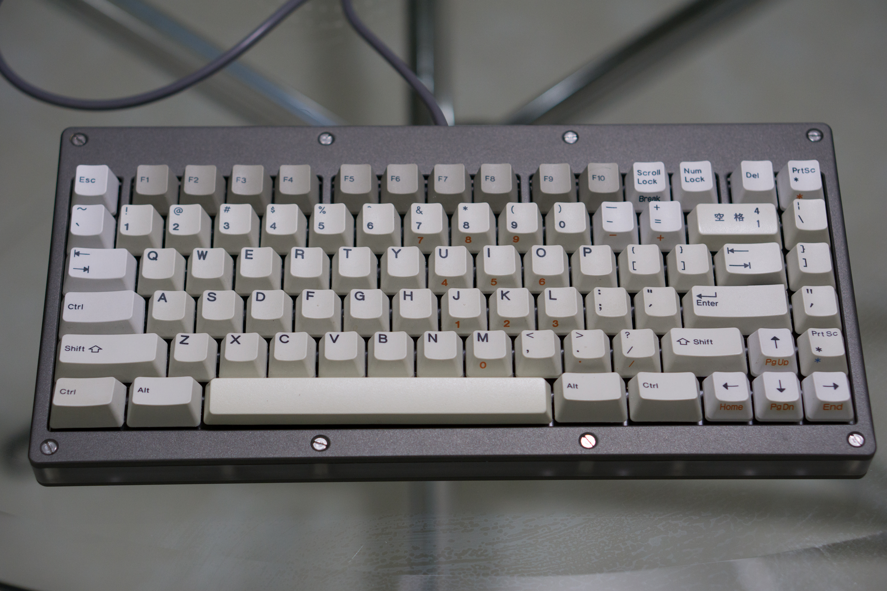

Layout
75% was the decision between Mike and I. At the time there was a void of custom 75%, and all of the 75% did not make sense to us. They all suffer from the boxy look because of the F-row. Then a few months later, I presented the fixed layout to Robotical, he liked it so much that he implemented in his Knight75 board. Ultimately, Omron75 is the fix for 75% whereas Knight75 is a TKL approach to 75%.

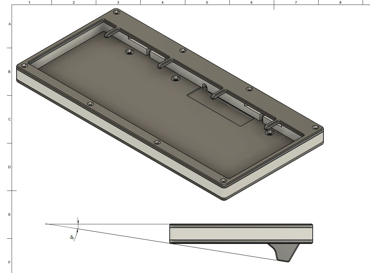

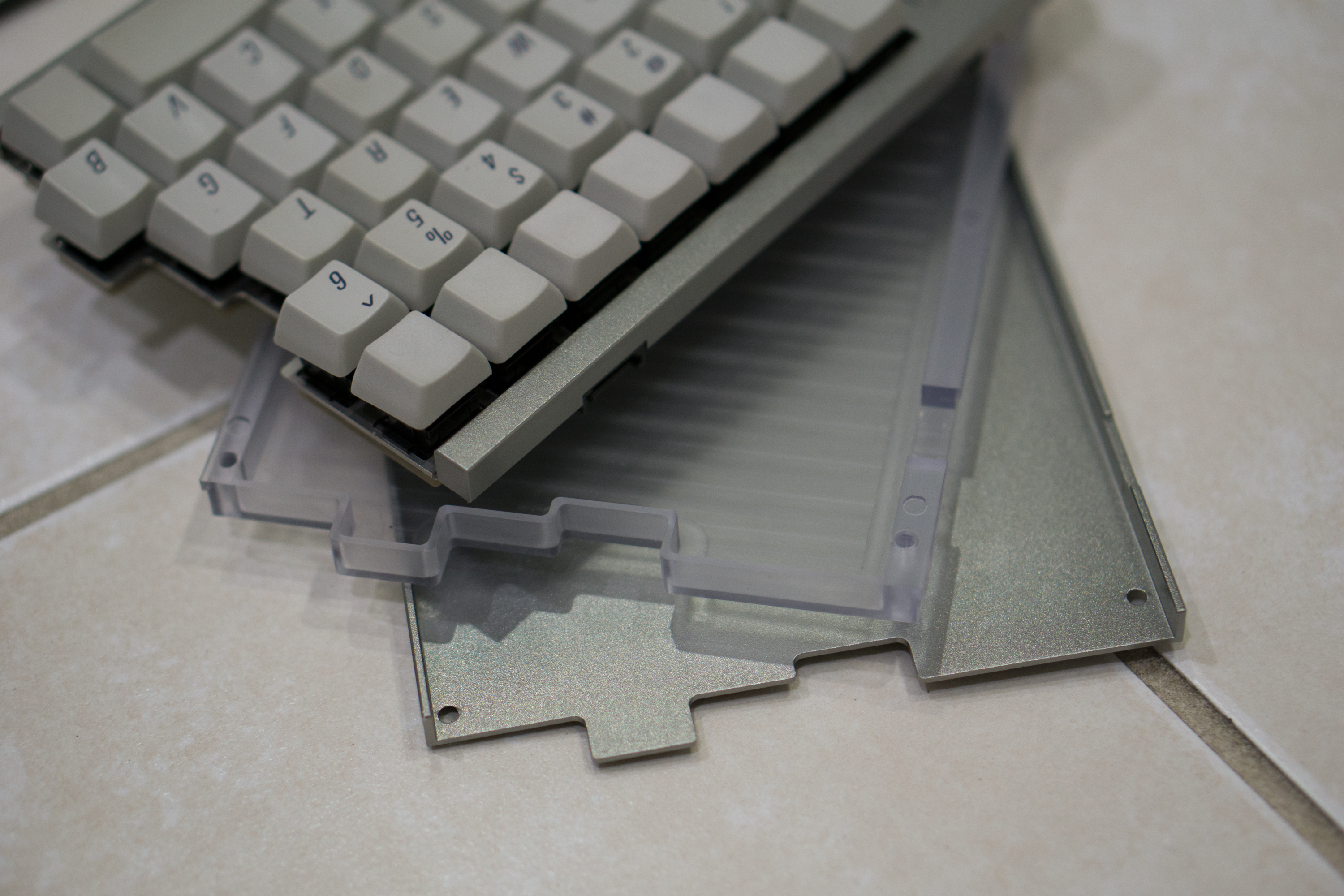

Case Design:

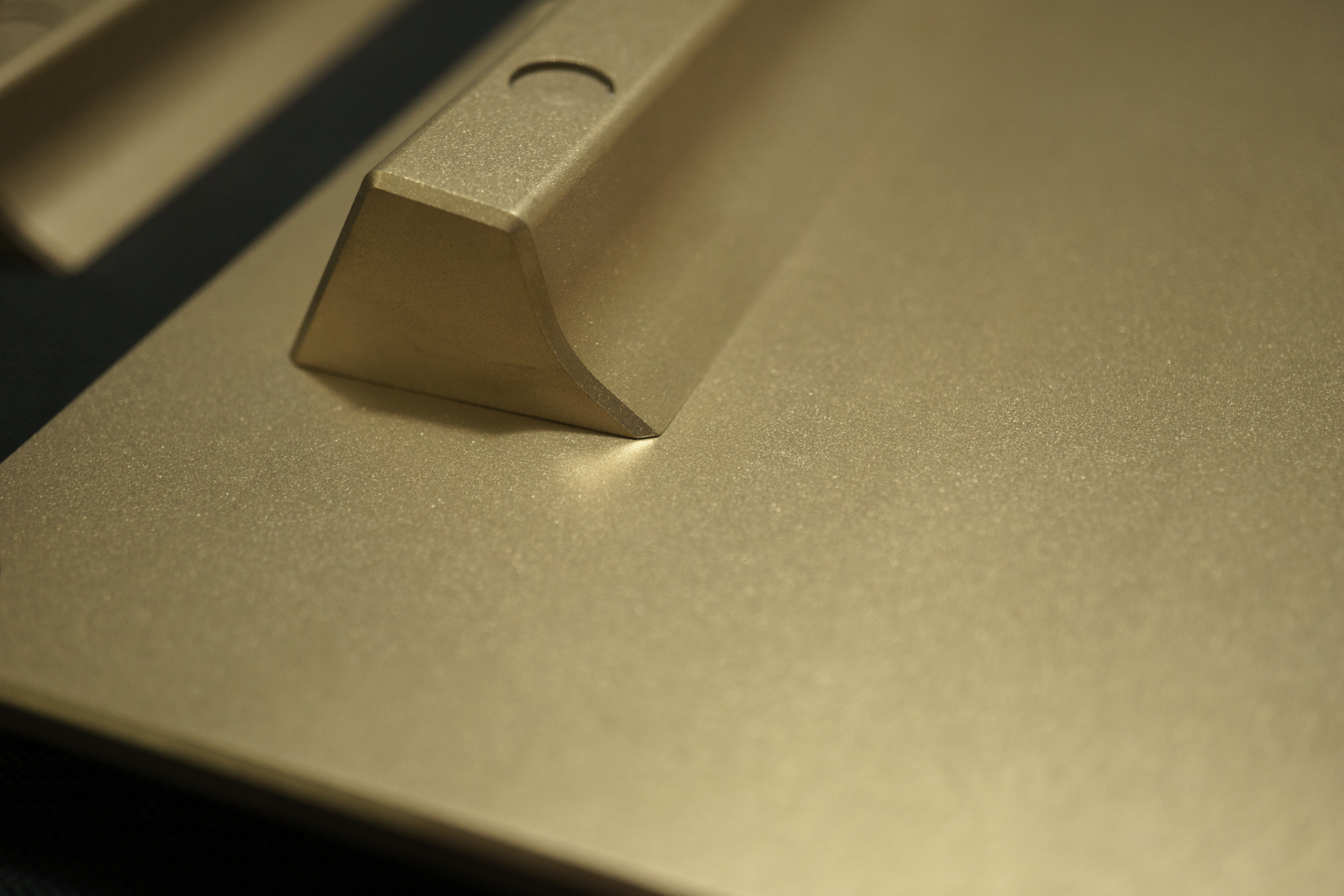

The principles: Omron75 represents my thoughts at the time: I am not an innovator, I am a student of the game. I build and use many keyboards and I know what works and what does not work. Hence I applied those ideas into the board. Here are the specs for the Omron75:
- High end sandwich case (requested from Mike for his love of The Cheat TKL)
- Plastic middle piece for sound dampening (Monarch and VE.A)
- Exposed screws (for industrial look, SKB solidified this idea, it is a great design)
- Fixed cable only (because thicc og coiled cable)
- Conefeet/Risers for airgap (Monarch and Kmac)
- OG thickness (Realforce)
- Deceptively heavy
I was able to convince E3E and Siaw that Monarch is one of the best case for clicky SKCM's, Mike also thinks that my VE.A is one of the best skcm orange boards out there. We figure it has to do with the plastic inlay that helps with both the sounds and typing feels.
Omron75 and its inspirations

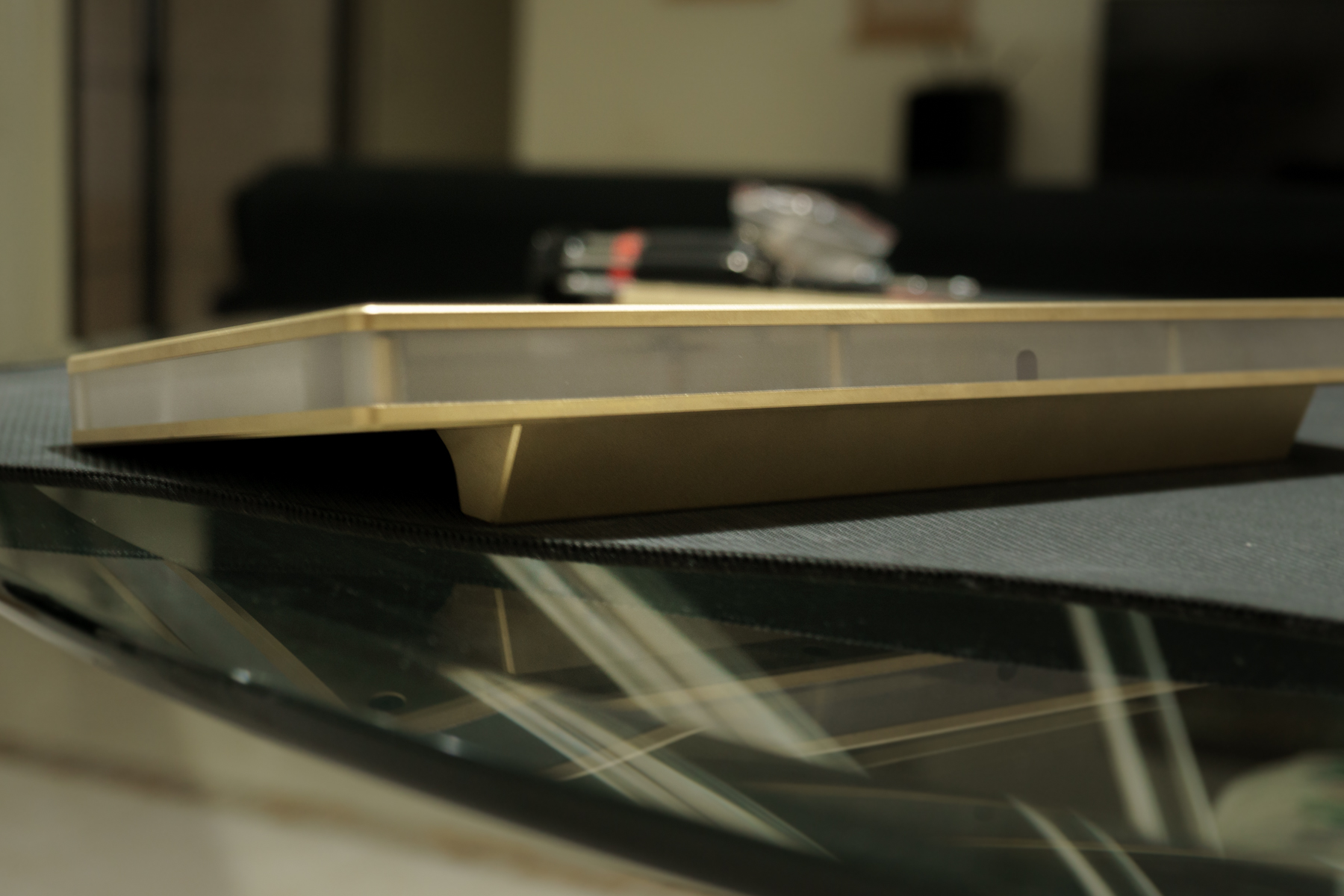

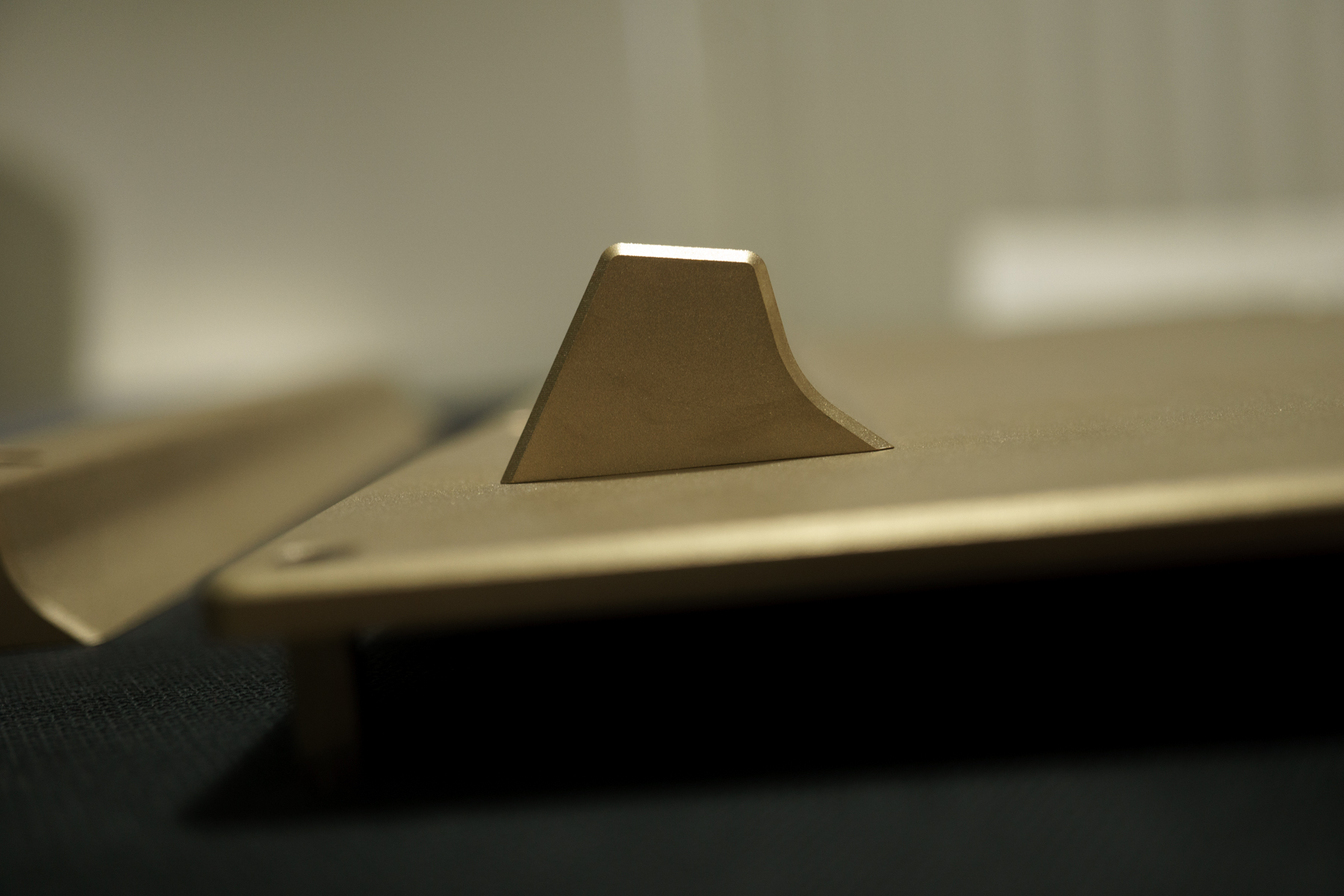

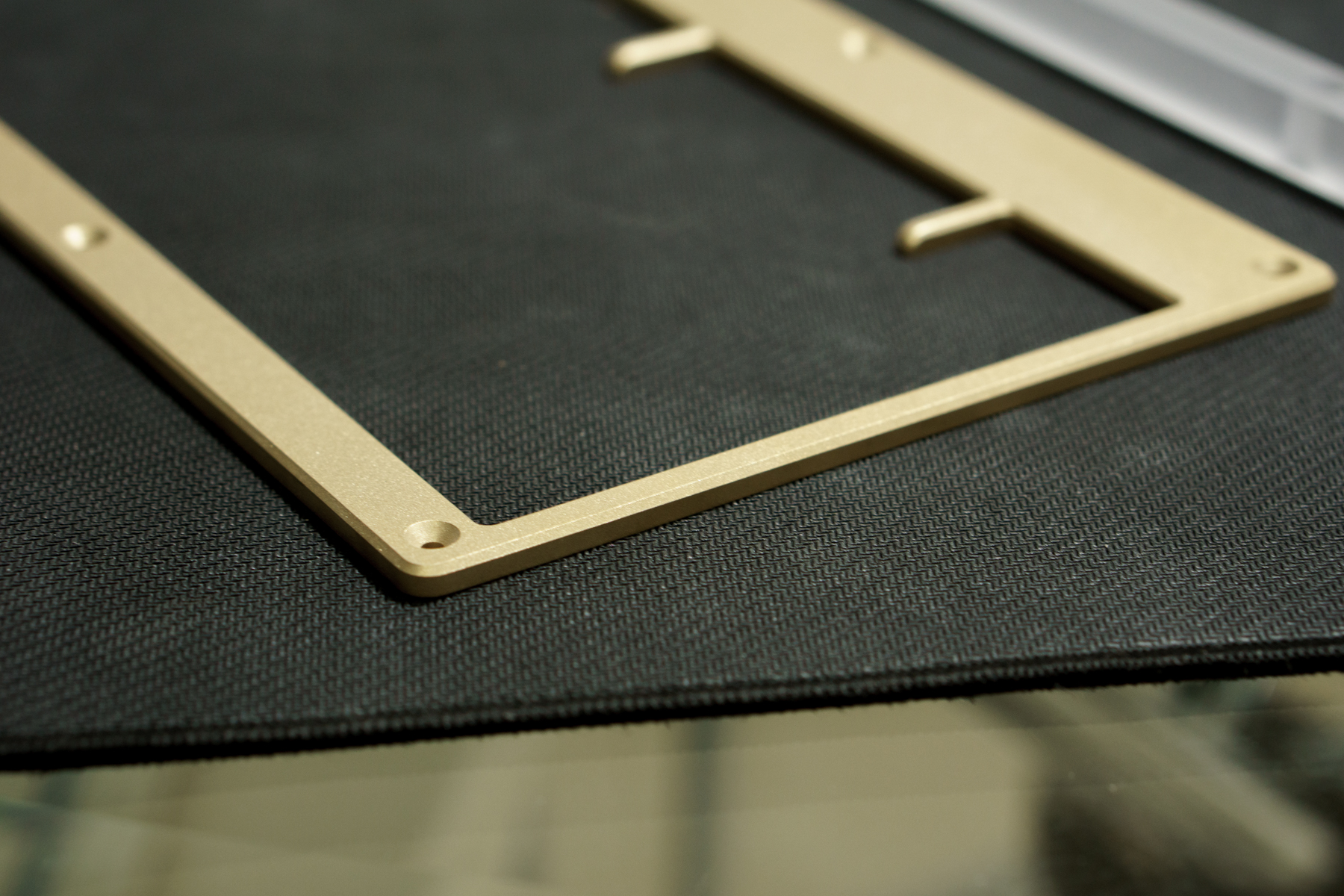

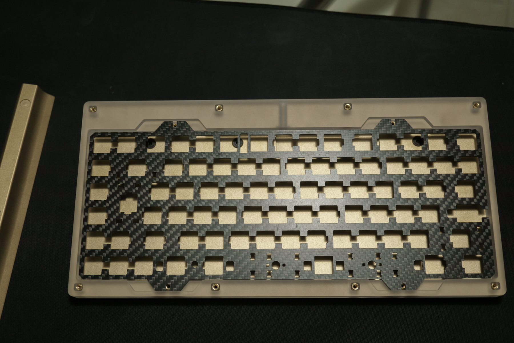

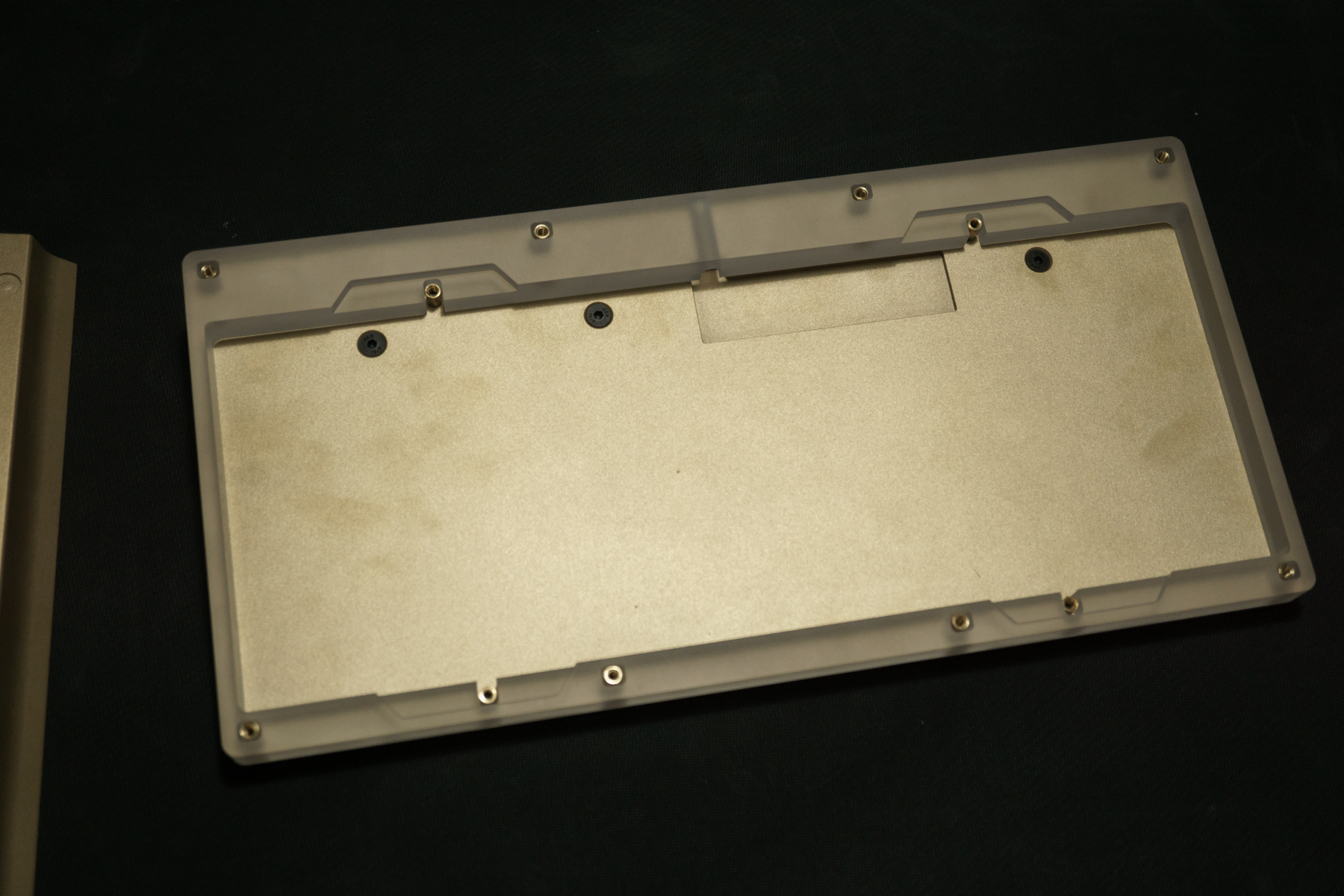

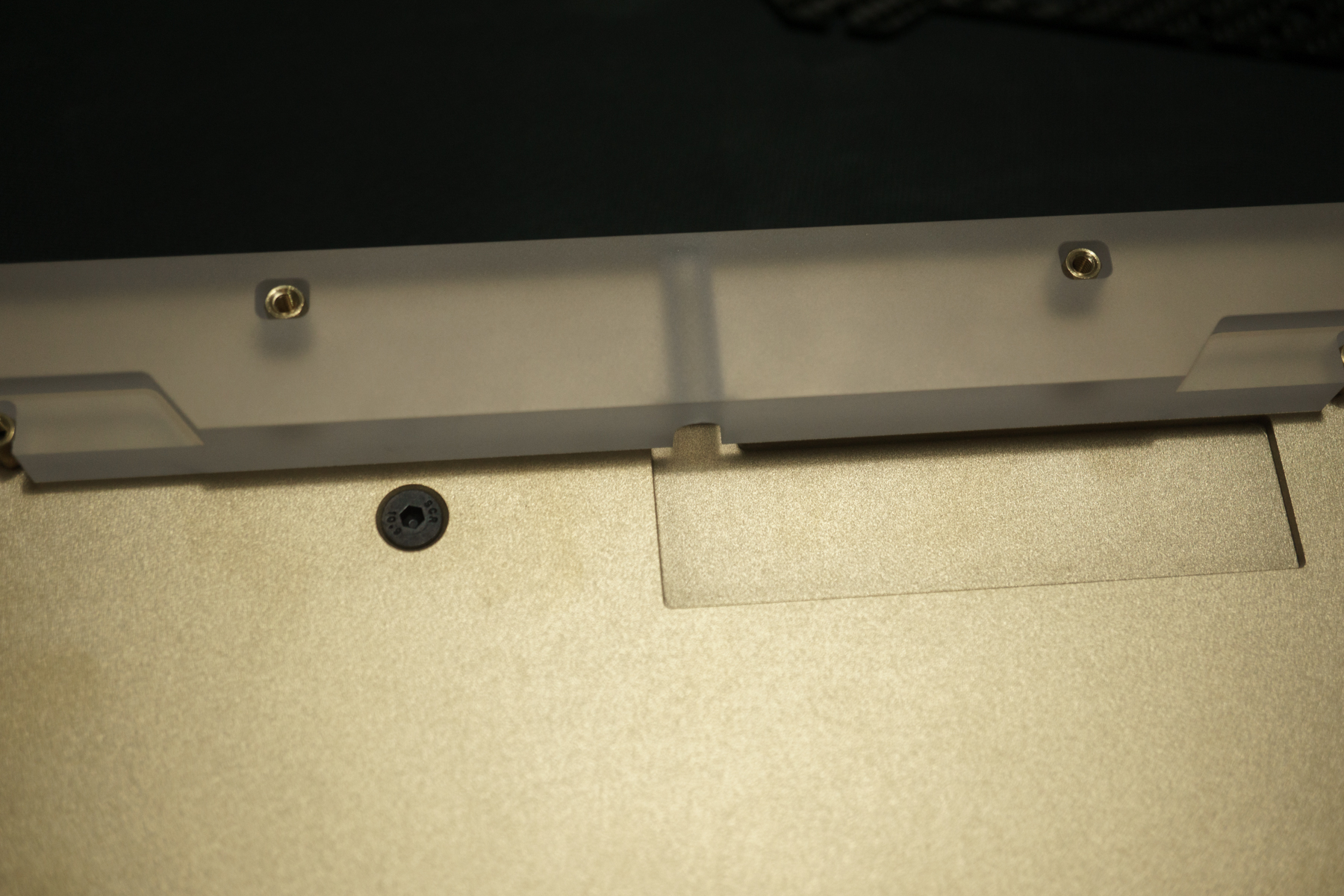

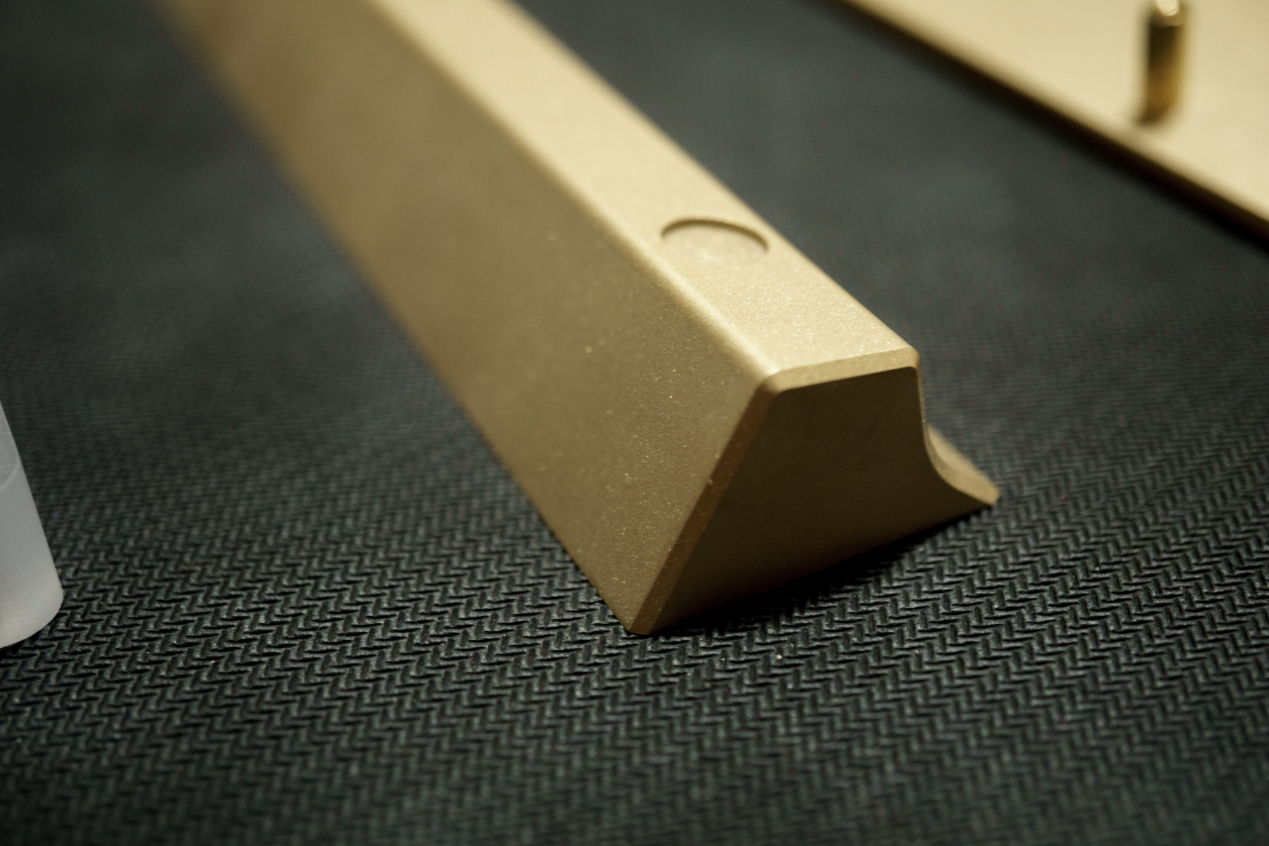

The Build
Plate deadtrap
Ease of modification ranking(higher number the better):
10.
9. SKCL/M (can modify without desoldering)
8. MX (can modify without desoldering, a bit more awkward for switch opening)
7.
6.
5. Topre (1 dead switch requires opening up the entire board, with a screw driver only)
4. Model M/F (1 dead switch requires opening up the entire board, with screw driver and clamps)
3.
2

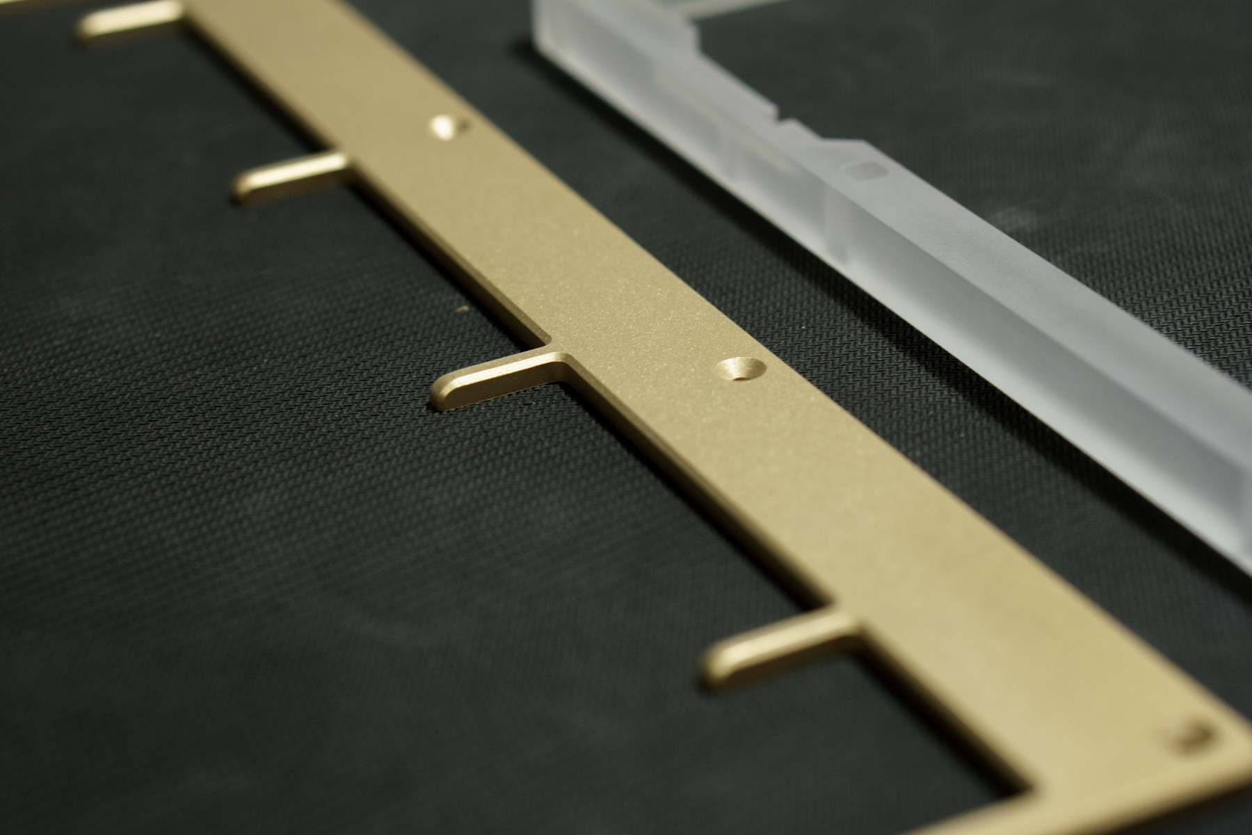

1. Omron B3G-S (cannot modify switch after soldered, 1 dead switch requires desoldering of the entire board, finicky switchplates)
Omron B3G-S switches clip onto the plate from below, and there is no way to unclip them unless you desolder the entire board, then turn the plate over, and unclip from underneath. With softer plate material, aka plastic, you can force pull your way, but with tougher plate material you have to desolder the entire board. To combat this problem, the plate for Omron75 are designed with cuts connecting switches of the same row. Instead of having every switch clip into the plate, only switches that fall onto the red line clip into the plate. To unclip the red-line switches, you just have to desolder one extra switch next to the red line

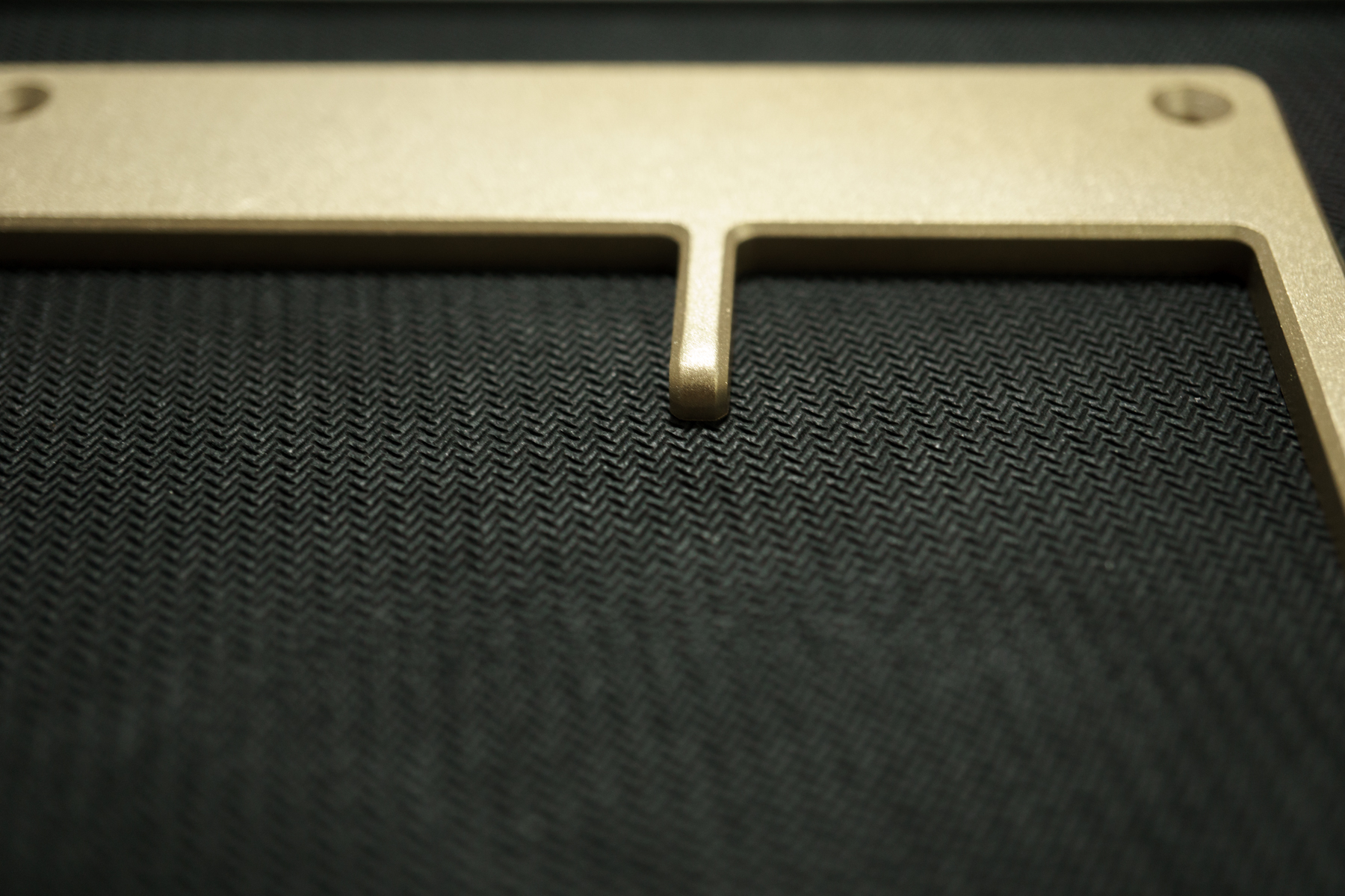

Omron stab hooks are also deadtraps No way to take them out once they clip into the plate

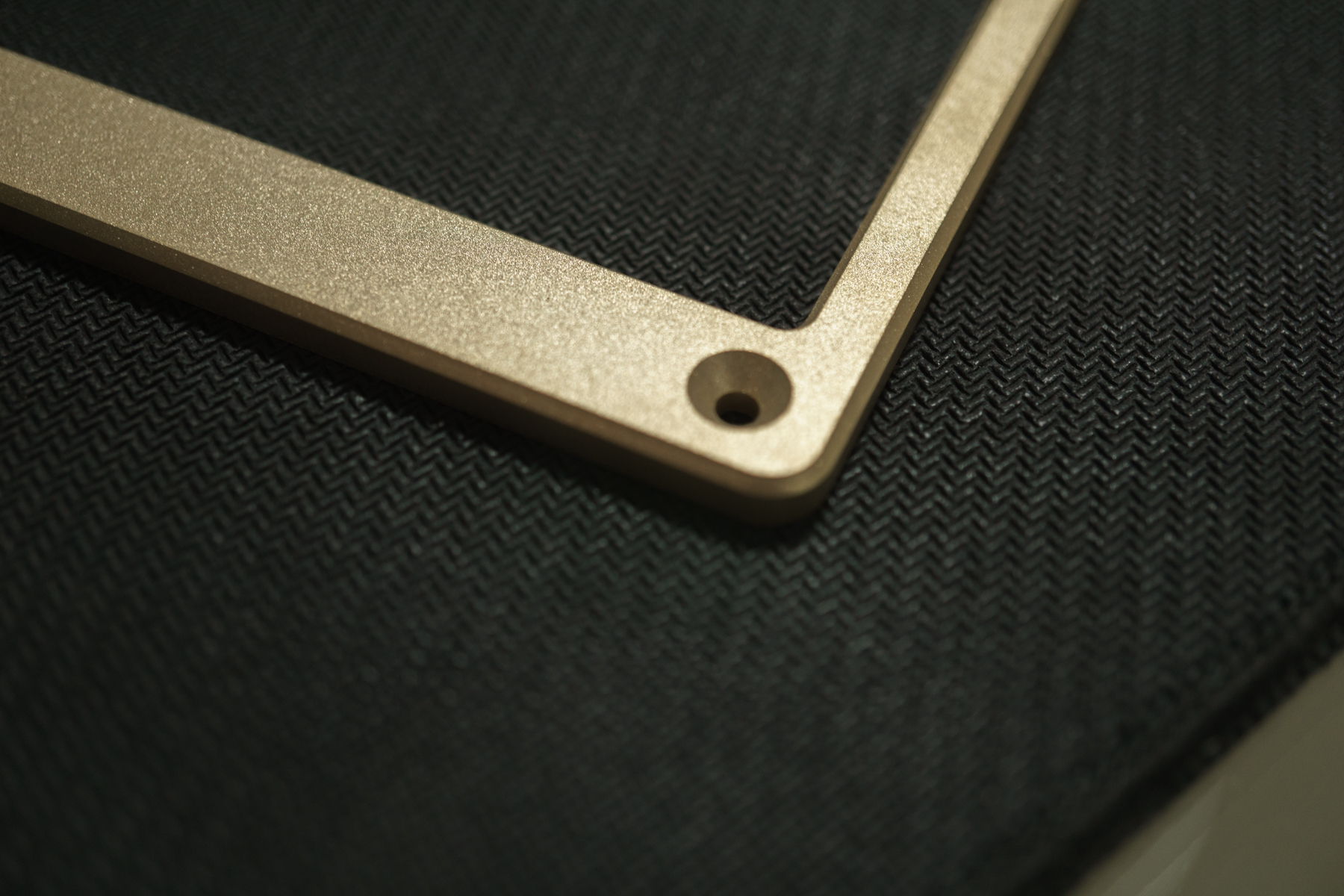

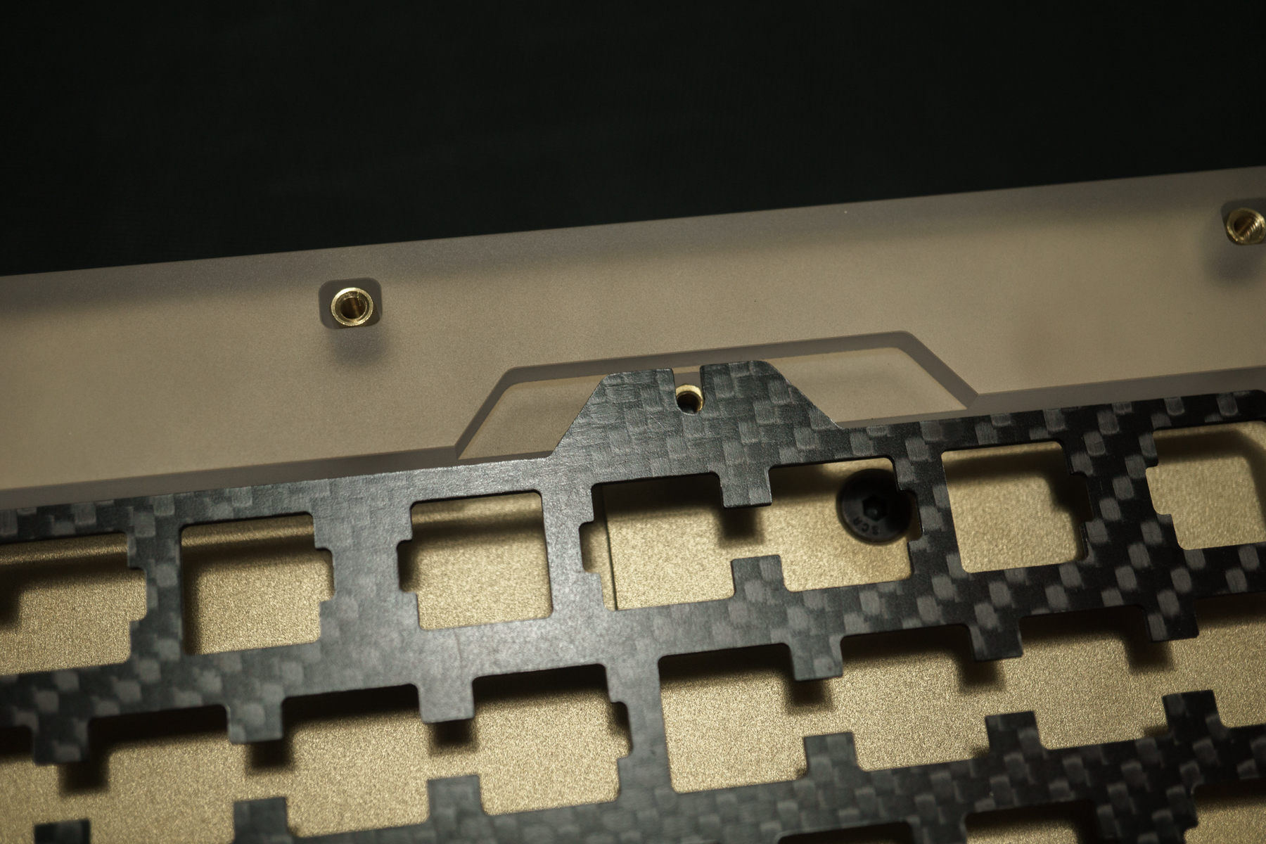

Dogbone stab hook cutout on plate Due to minimum cnc tip from the factory that I use, I have to use dogbone cutout to ensure the correct dimensions for the stab hooks

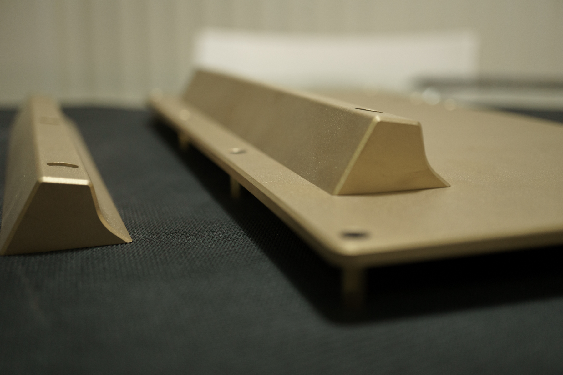

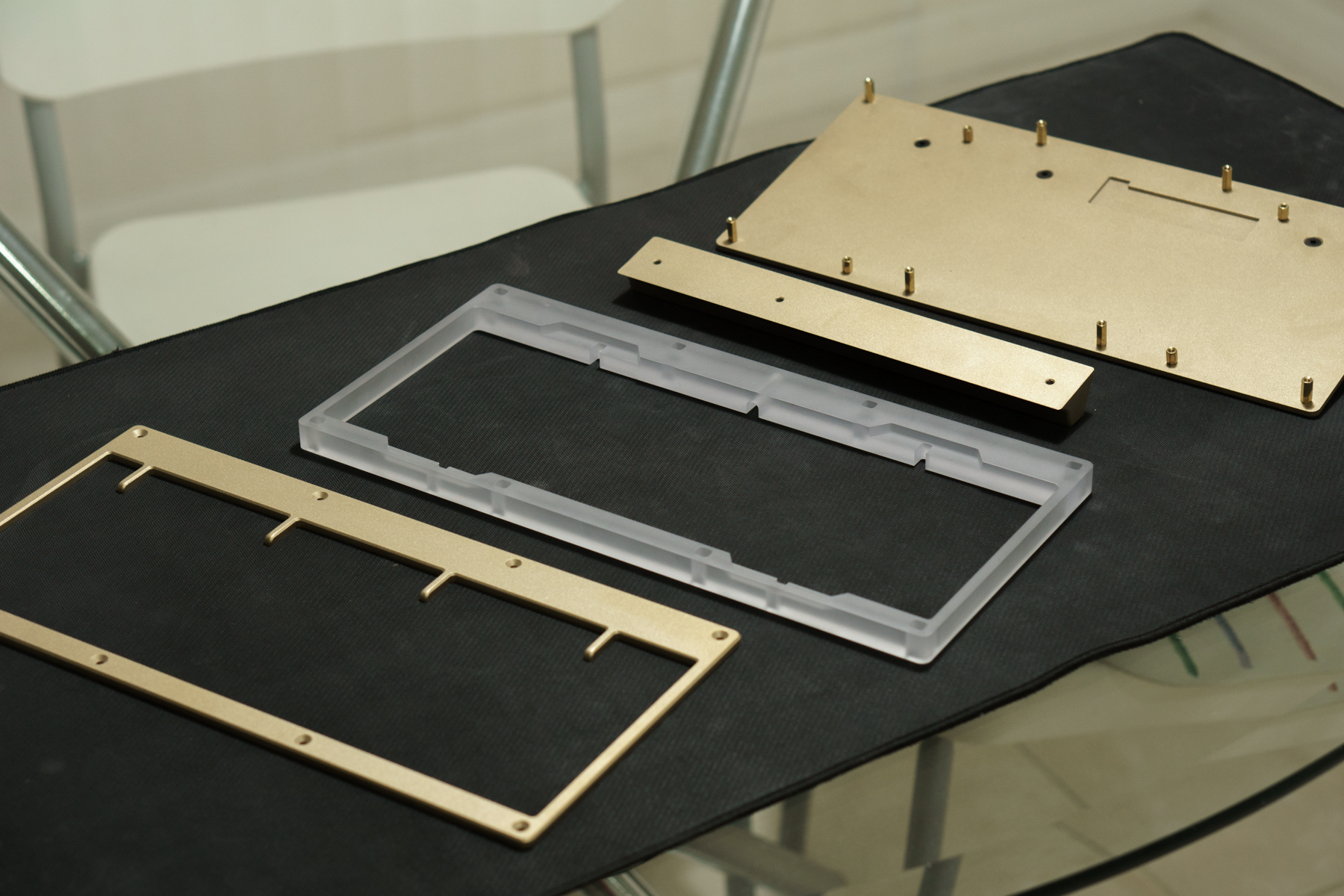

The case in brass At first we want Stainless Steel, but SS pricing is not reasonable at all due to the difficulty of cnc SS.
Case assembly
Delirious
10 Jun 2019, 04:38
Plate spacers are shorter than the polycarb mid piece to make sure the plate is rested on the polycarb mid piece only, no metal touching metal.
Closed up of Cerakoted and Homage to Next Non-ADB
If you made it this far, thank you for reading. For the full album, please use this link.

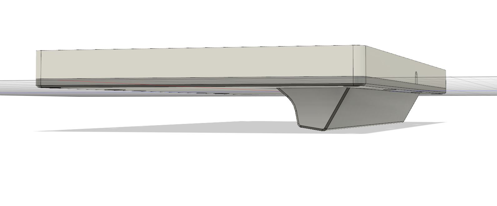

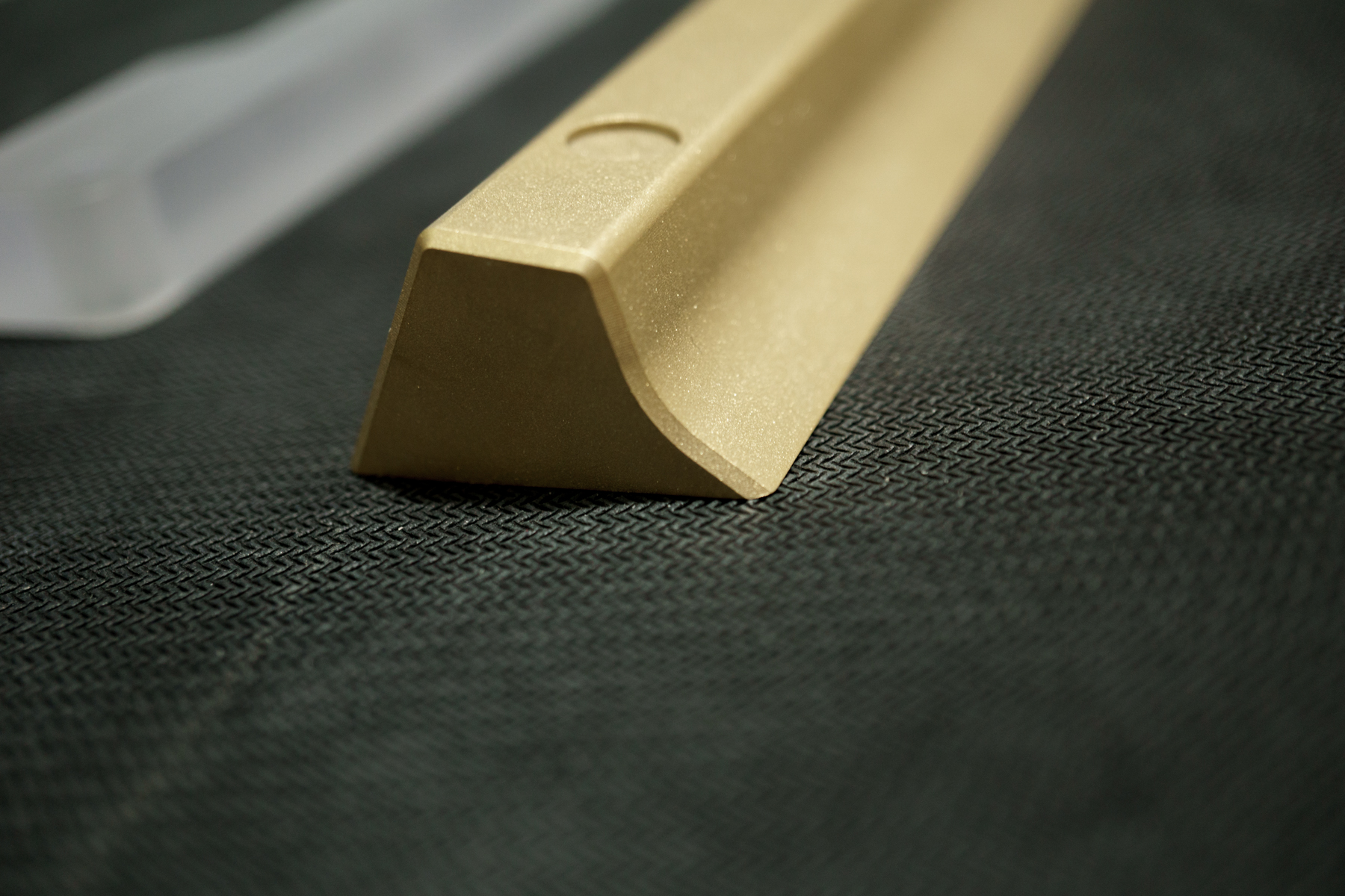

I am not happy with how the cone feet turn out, second prototype is coming with changes. And I will update this thread once it gets here.

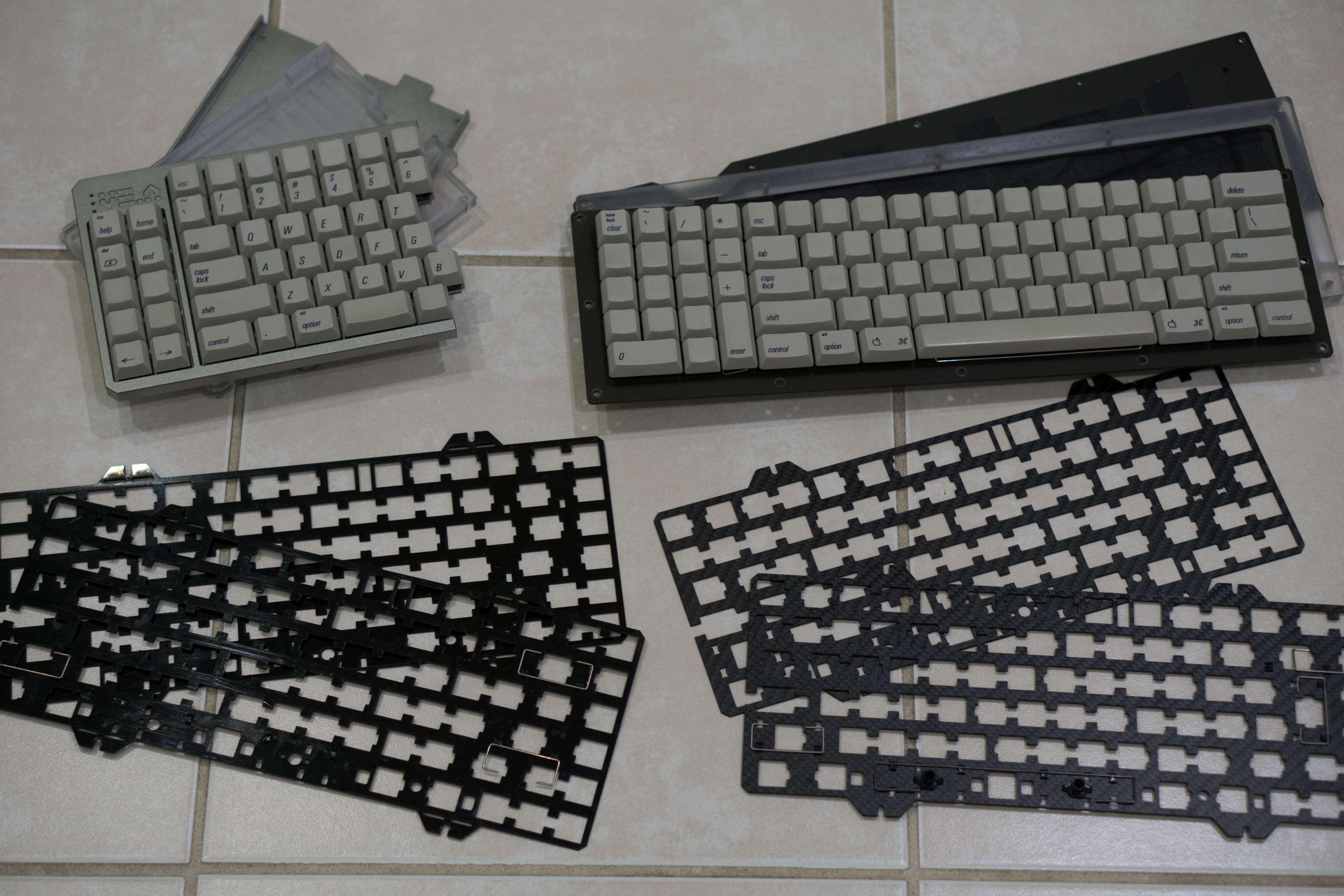

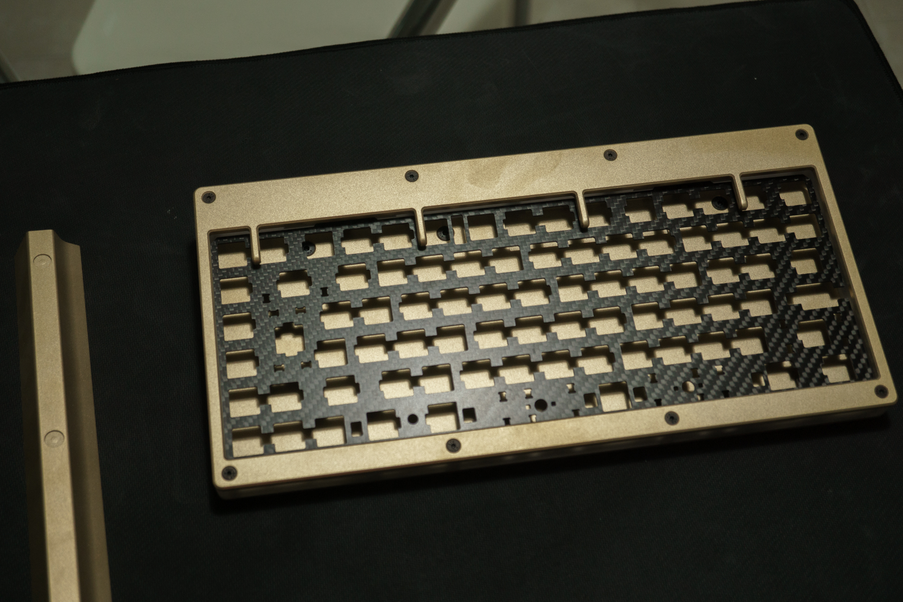

Impressive. Can you talk a bit about the plate? It's certainly not a run-of-the-mill acrylic or aluminum plate...
Delirious
11 Jun 2019, 00:36
depletedvespene wrote: 10 Jun 2019, 20:59 Impressive. Can you talk a bit about the plate? It's certainly not a run-of-the-mill acrylic or aluminum plate...
Matte finish, 1.2mm Carbon Fiber plate
11 Jun 2019, 00:40
Delirious wrote: 11 Jun 2019, 00:36
Why was carbon fiber chosen?
Also, is that gray-on-gray plaid texture an inherent property of carbon fiber surfaces? 'cause I can imagine some people actually wanting cases looking like that... would that be a good or a bad idea?
Delirious
11 Jun 2019, 03:37
depletedvespene wrote: 11 Jun 2019, 00:40
Reason for CF: 40% sound and 60% look.
CF was something E3E suggested. The original goal for Omron75 is to replicate the typing experience of the Monarch and VE.A: tough plate resting on a plastic housing/inlay.
-Tough plate for the most consistency all across, some of the best boards are just regular OEM boards with steel plate (Leading Edge, Alps Bigfoot, F_AT,....) and we want to keep that tradition
-Plastic mid piece for warmer sound.
At first I was thinking of going for the typical aluminum or steel plate, however the plan of SS case didnt work out. Brass is "louder" in term of sounding comparing to SS, so I looked to CF to compensate for the sound.
I also tested the board with POM and ABS plate, and SS is going to be next on the list anyway. All of these amount to very little changes anyway because the B3G-S housings are very self-contained.
We all know the real reason is look.
The plaid texture is indeed the inherent property of CF. It actual serves a very practical purpose: to strengthen the material depending on the pattern. You can read all about the patterns here, each works best for different industry. For keyboard you probably want to start with something not so 3 dimensional, something that is tough enough but also easy enough to machine.
Without mid-piece
https://imgur.com/nznE1BG

Hey guys, long time no update. I just received the second prototype today and I have 100% happy about the aesthetic and 95% there with construction, this was my fault for mixing up between m3 and m4 spacers without double checking.
Here are the changes:
1. Exaggerated the chamfers to equalize the overall roundness more.
2. Changed to footbar instead of cone feet
3. Changed the angle from 7 degree to 9 degree.
4. Interior: extended the plate's wings by 30mm each to normalize the downstrokes. I noticed the corner keys and middle column were flexing more than needed for the first revision.
Next step:
1. Cerakote and meetup with mike52787 and Zod for second opinion.
2. Send the prototype to Snackthecat at the end of August for third opinion
3. Groupbuy somewhere in September.
Without further ado, here are the pictures. Enjoy.
