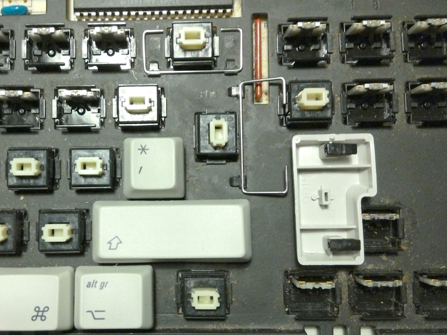

I was trying to take picture of the stabiliser on my Matias Tactile Pro in nordic ISO when - in true show of Matias ´quality´- one of the stabilisers came off. :D
After battling for 5 minutes with the slippery over-luber stabiliser, I manged to get it back in and get you a picture of it.

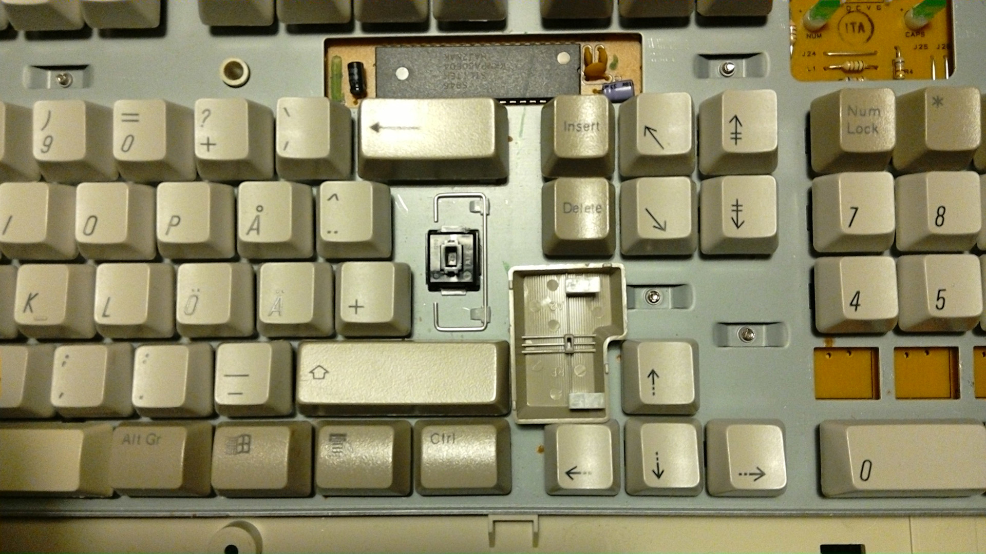

I had a (modified) Dell AT102W on the desk just now:
... because I was comparing it to the ISO AEKII. Not the Enter/Return key you want, but it has the same stabiliser.
Huh. The 0.25u narrower Apple key does fit the AT102W (with a gap) and vice versa (without the case top).
But the Matias and Dell keys are not compatible: although they are the same size and have the same type of stabiliser, the switch position is shifted 0.125u.
Besides Matias, Tai-Hao has also made Alps keycaps and Cherry MX/ISO keycaps, but I dunno about Alps/ISO keycaps.
Inserts for Costar-style keycap mounts (Cherry MX mounts), allowing you to mount a keycap with Cherry MX mount on the stabiliser to Alps snaps on the plate were shown in another thread recently.

My AT102 made by ALPS has the exact same stabilizer system, the board was made in Ireland so it has the UK ISO layout. It is a weird a board i have only came across one other like it but the sticker on the back was different to mine i will upload pics of my board soon.
