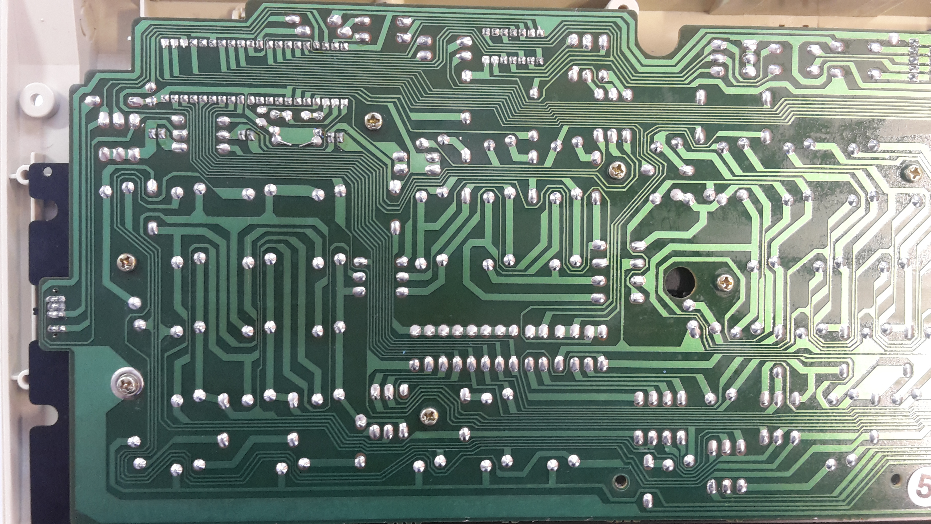

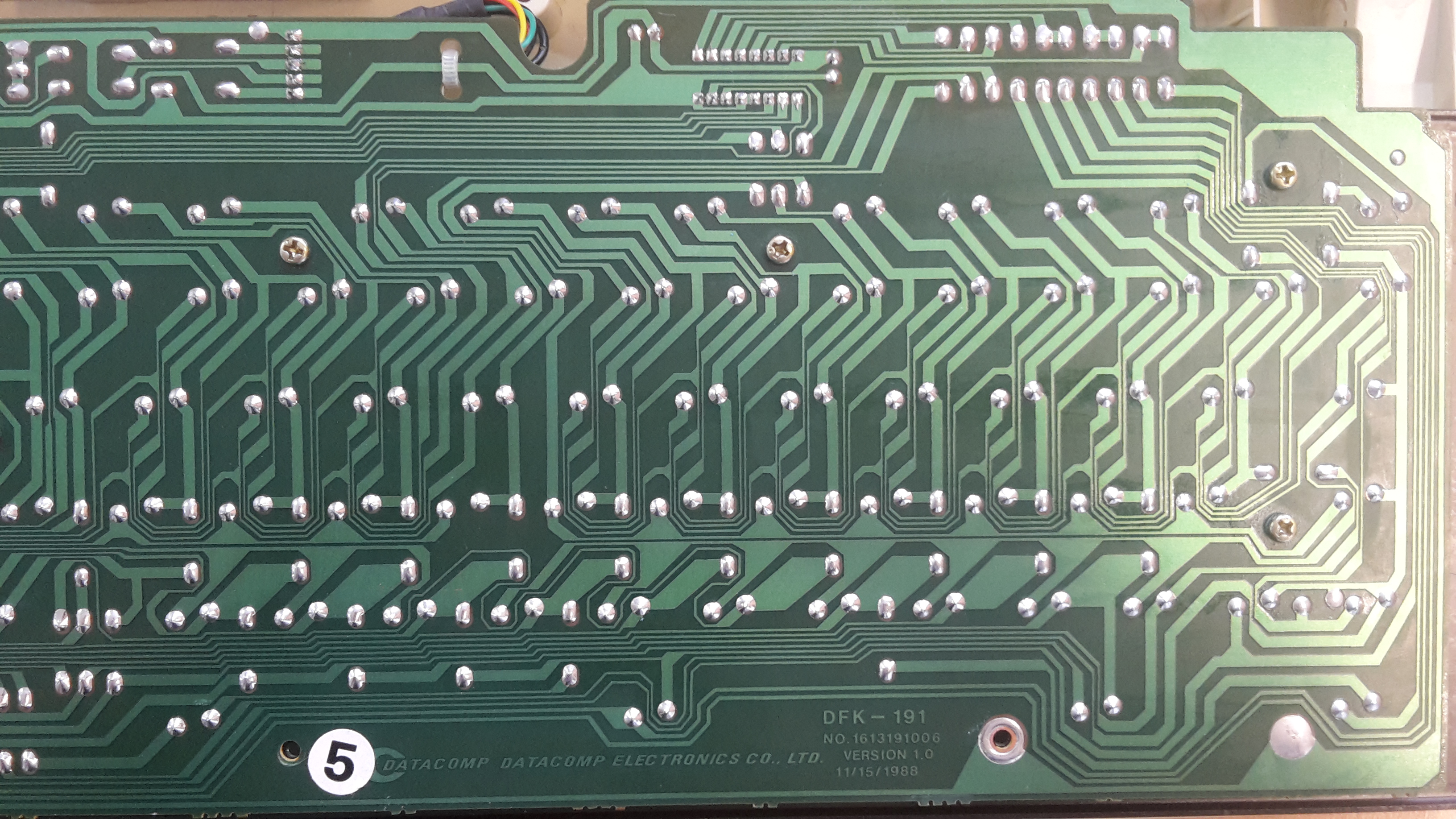

That is what I can see:
I should look for corrosion or some "rusty" spots, right? But I doubt that there exist any, but I do not have any knowledge.

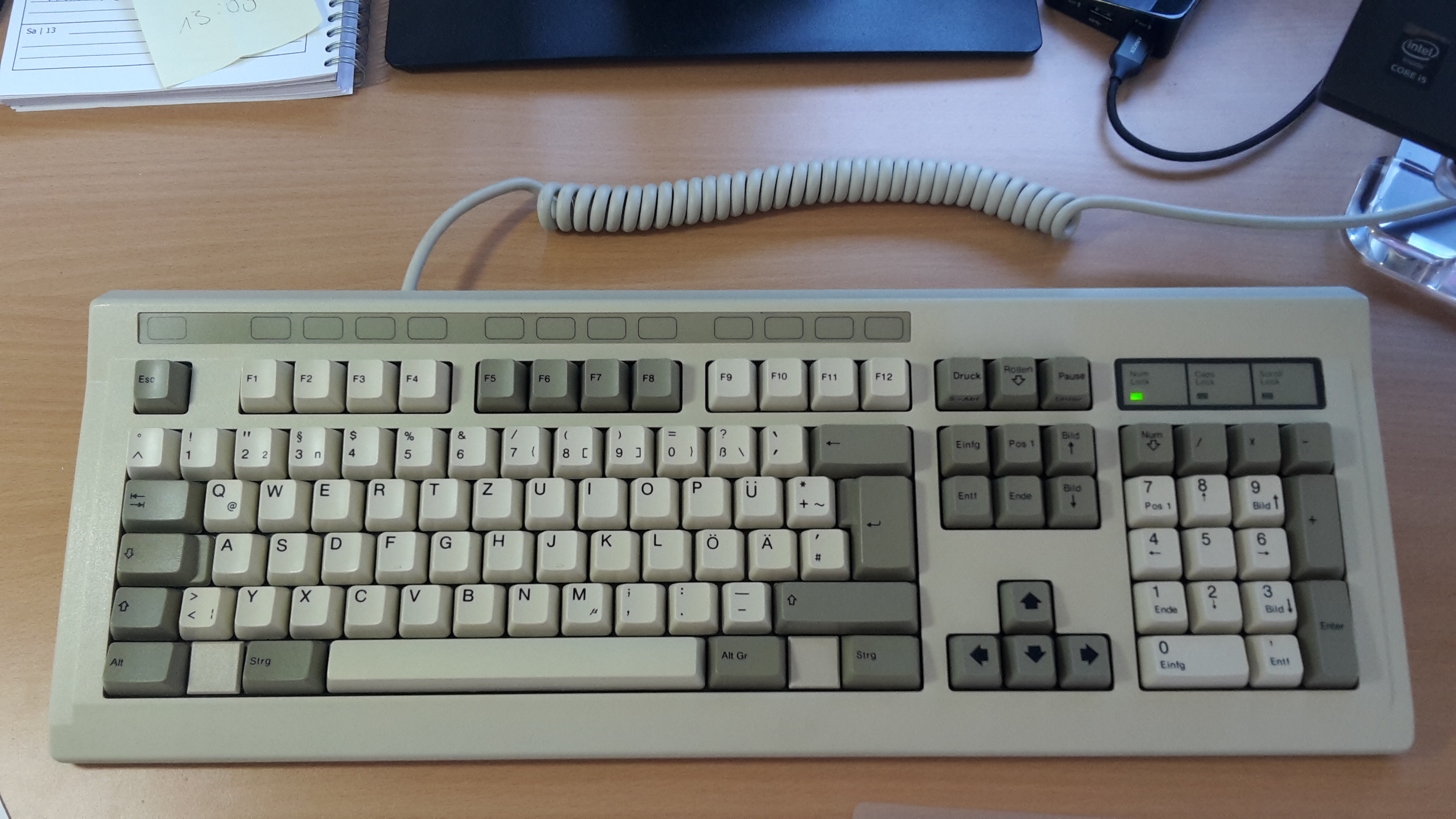

At least please enjoy my Datacomp DFK 192 now in a cleaned state....and even working :)
Still I want to learn more about these beige 2nd gen. SMK clicky switches with ALPS mount.
