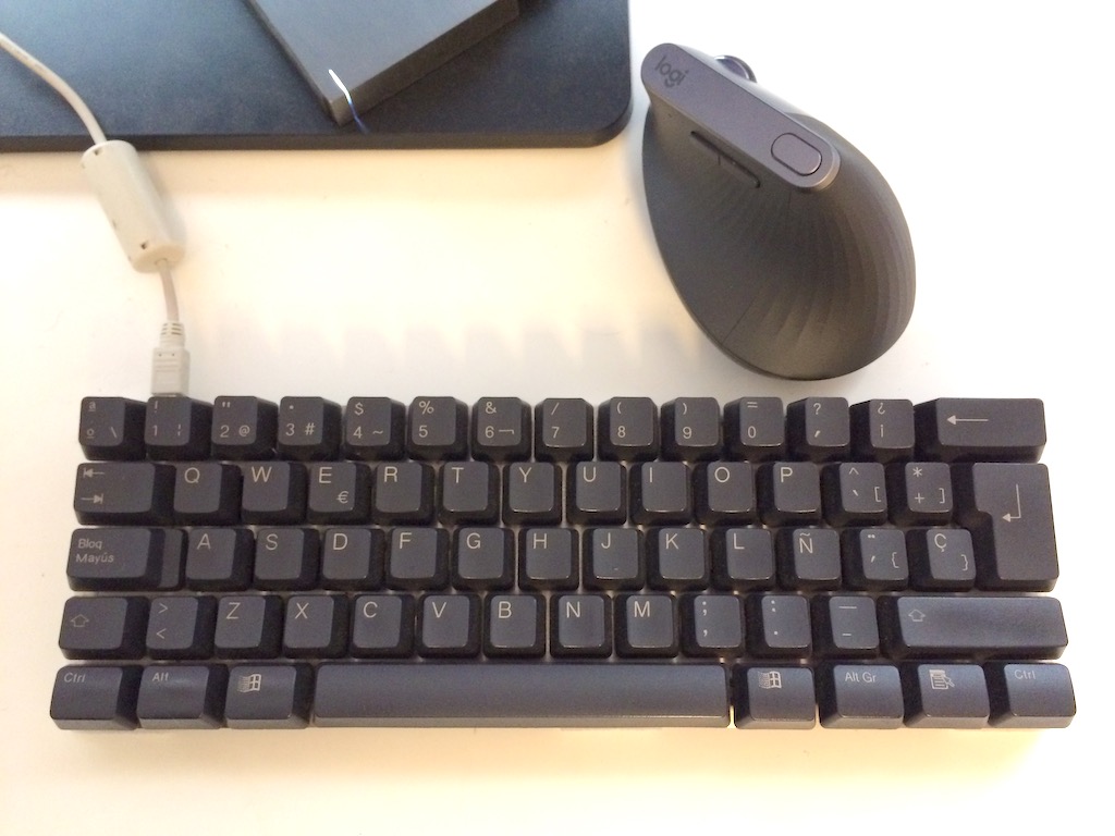

ramon0xff
22 Apr 2019, 10:17
And here is the result! Keys from an ISO AT102W, 1.2mm steel plate from laserboost, 30 ALPS SKCM Blue + the rest Matias clicky.
I'm waiting for a nice wood case. :D
Finished 60%
Finished 60%
