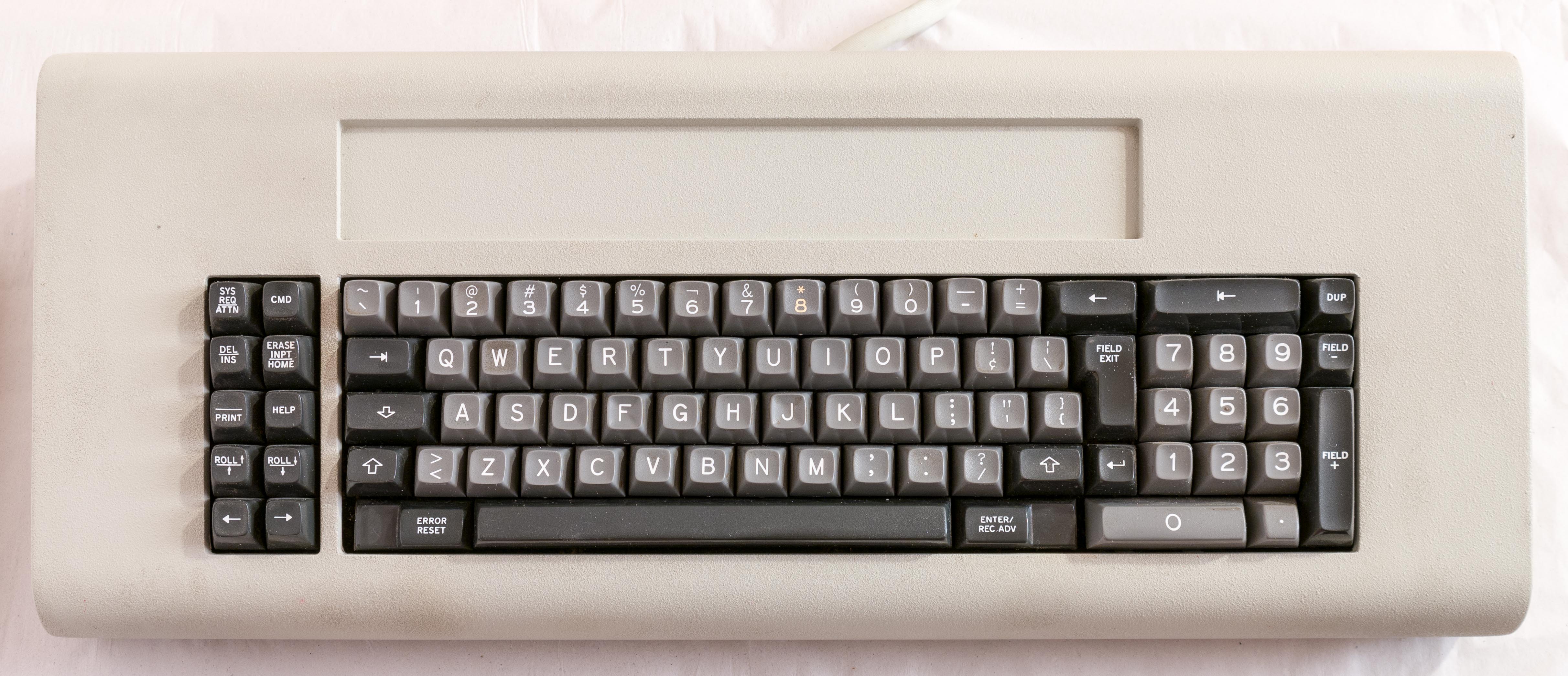

Condition

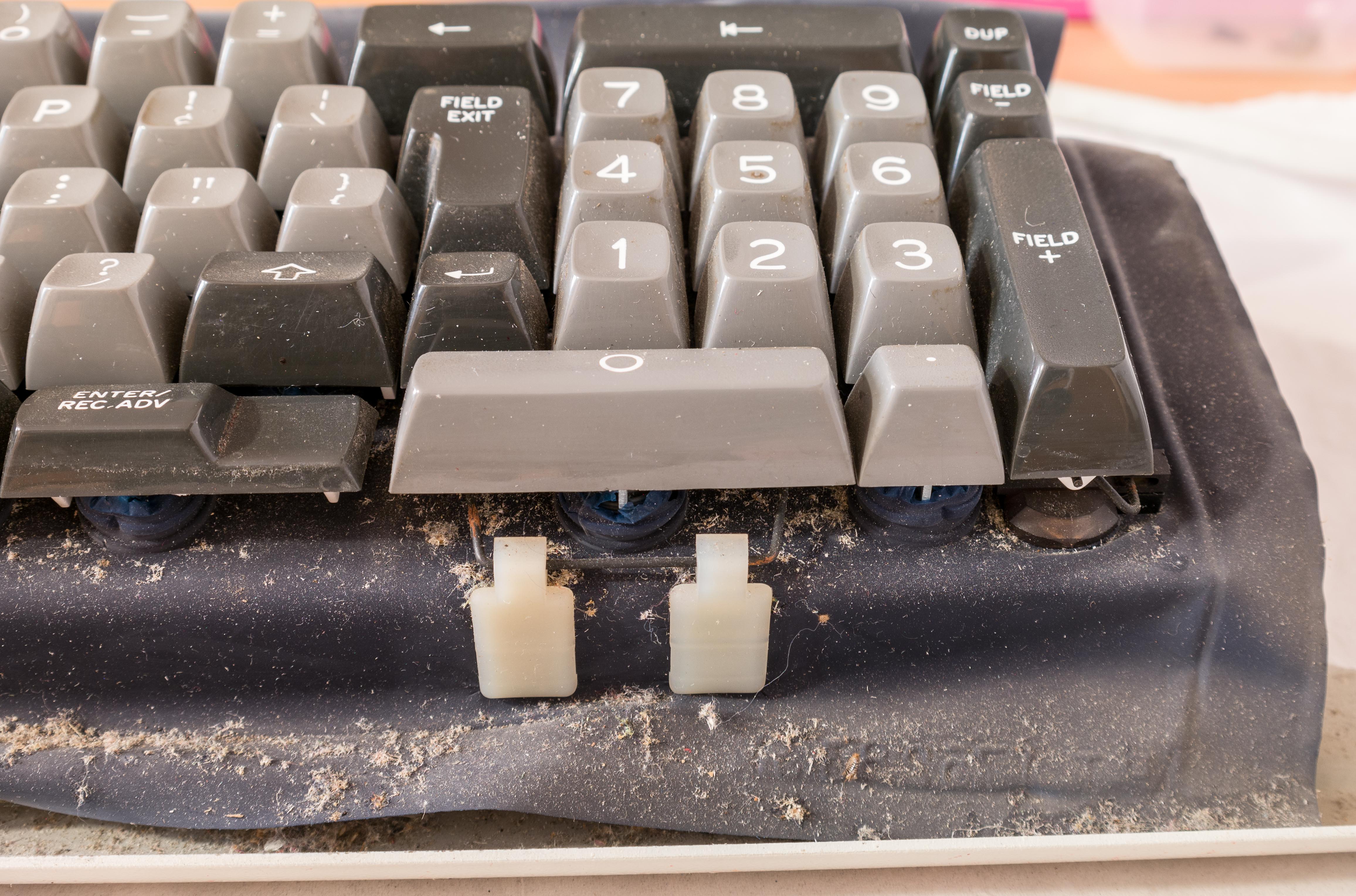

That's the condition, I got it in. Pretty nice, although the case was quite a bit dirtier than it looks in this picture.
There was a little chip in the plastic part of the case - down on one side, but it was glued back, so nothing's missing. All 4 feet were also there and in decent condition.
Only missing part was the original top row <8> keycap, but it came with a replacement that looks nearly perfect, apart from the legends that have yellowed in contrast to the originals.
The main reason, why I still had to take it apart completely, was that the switches were very very very loose. When I pressed one key, all the surrounding key were bowing down towards it, which looked quite disturbing.

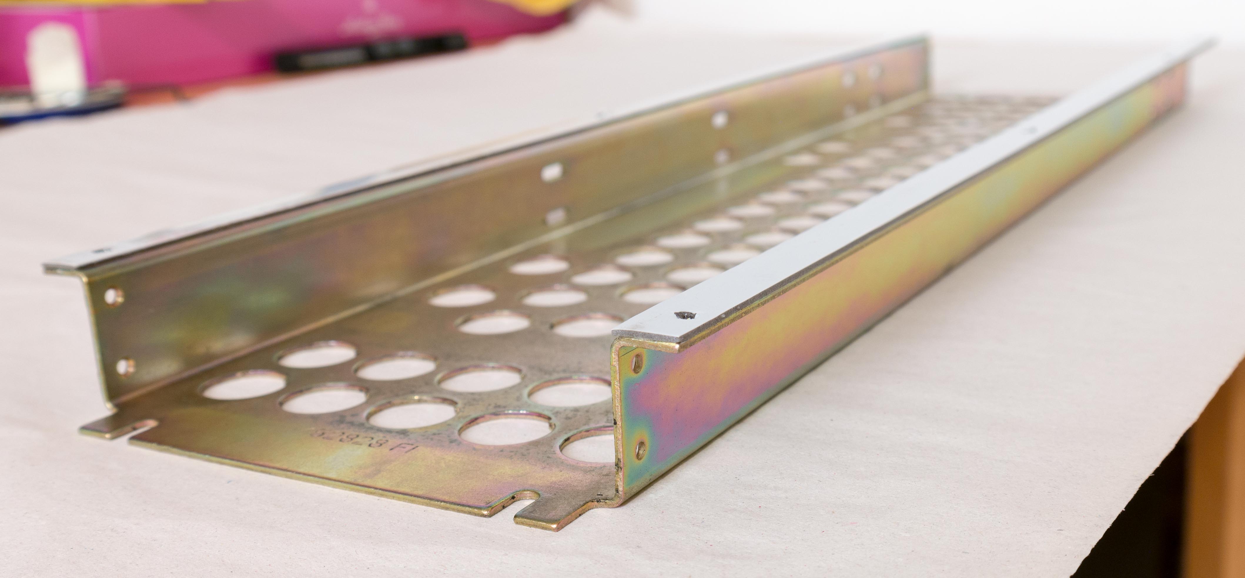

A lot harder was the metal base of the case, which had red streaks on it, as if the paint of another metal part had rubbed off on it. Nearly nothing could remove that properly. With metal polish I managed to remove most of it in the end.

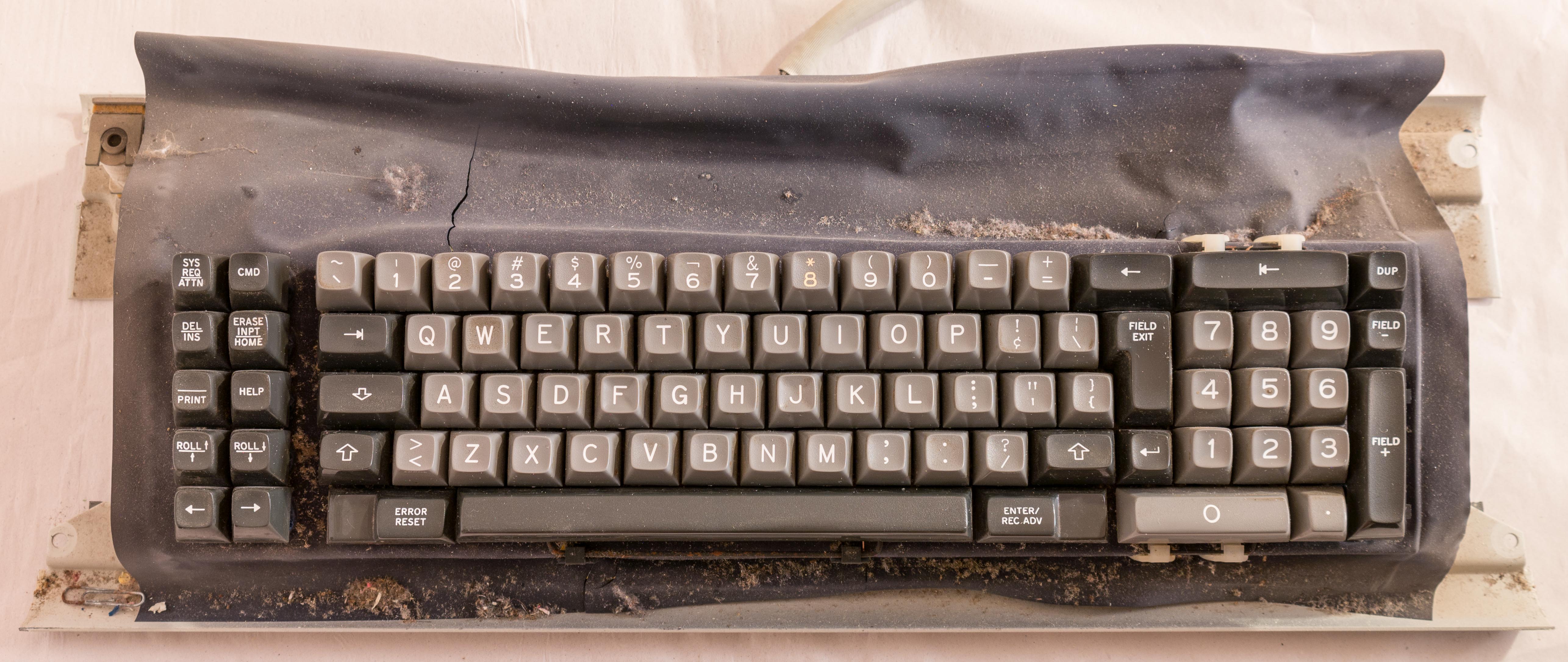

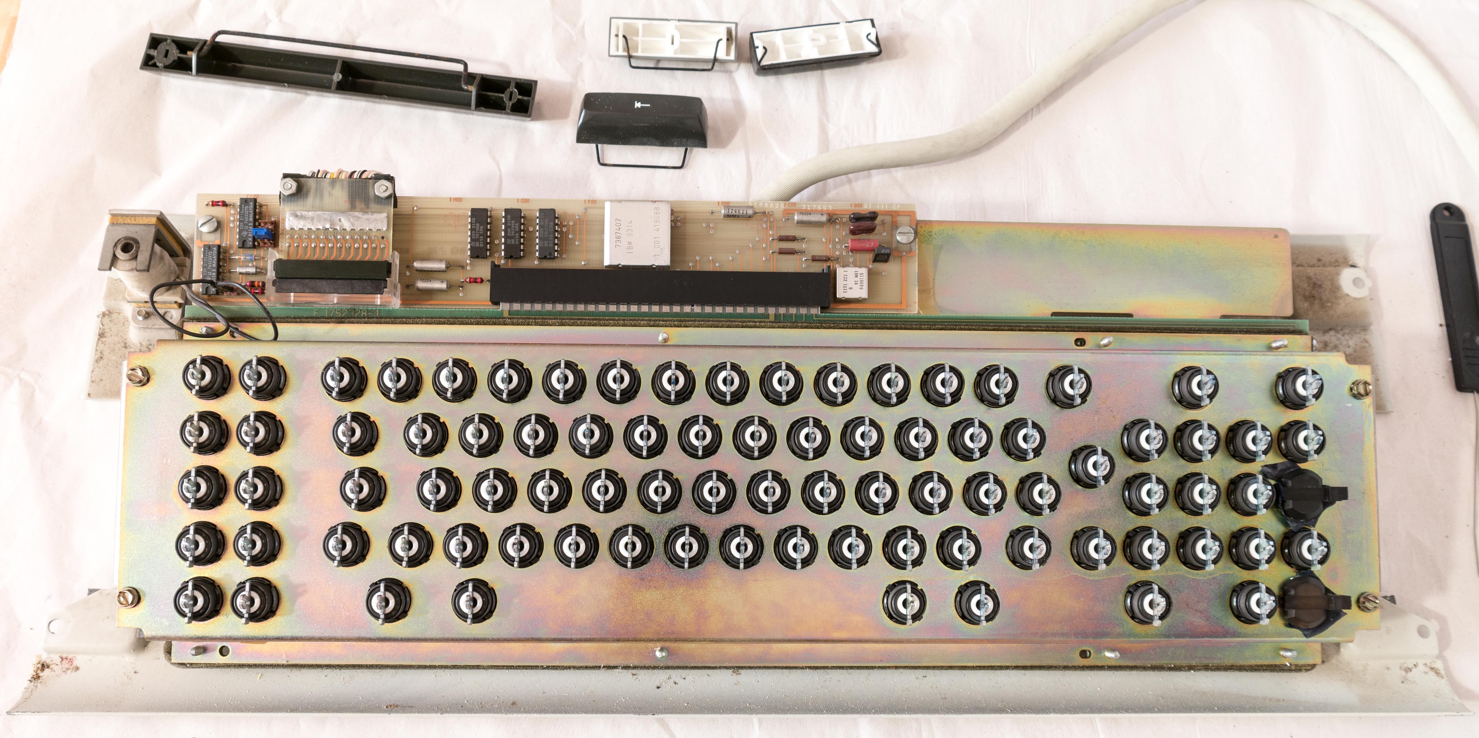

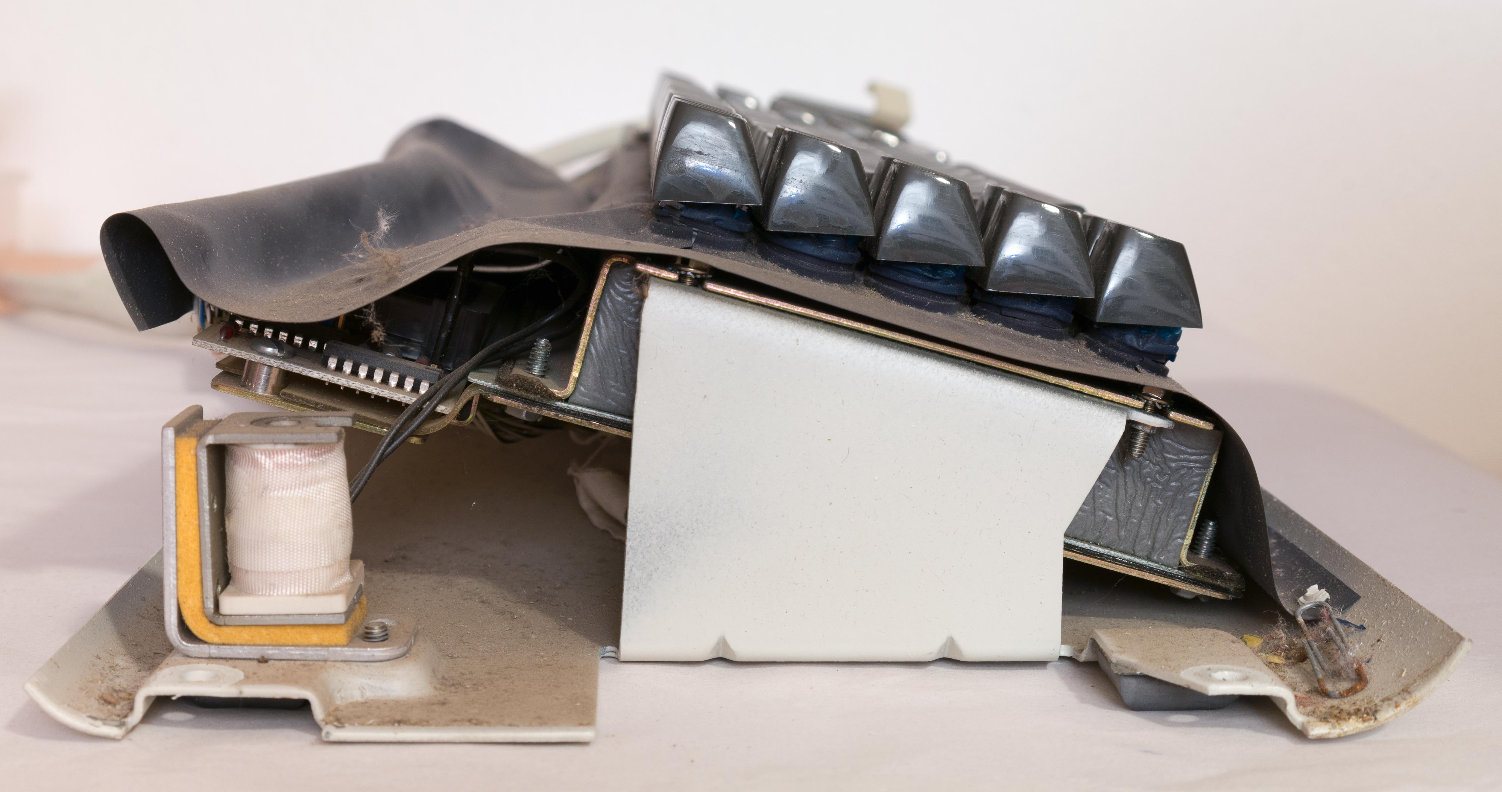

Now a few pictures of the freshly opened case. In general I would say "Yuck!" to such a sight, but here it was more a deep satisfaction to find it in untampered state – like an archaeologist finding an ancient tomb unopened and intact. :mrgreen:
The contamination shield ....
.... having done a brilliant job:

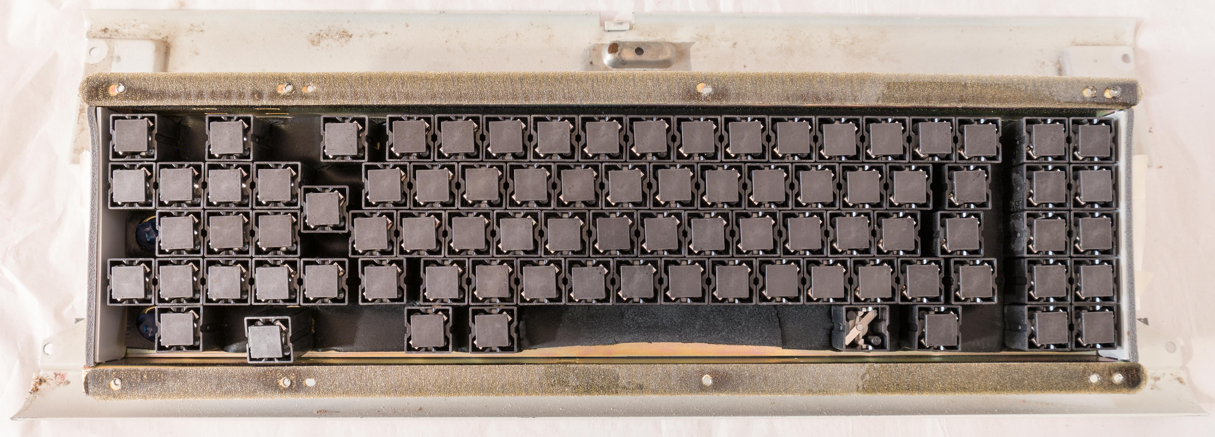

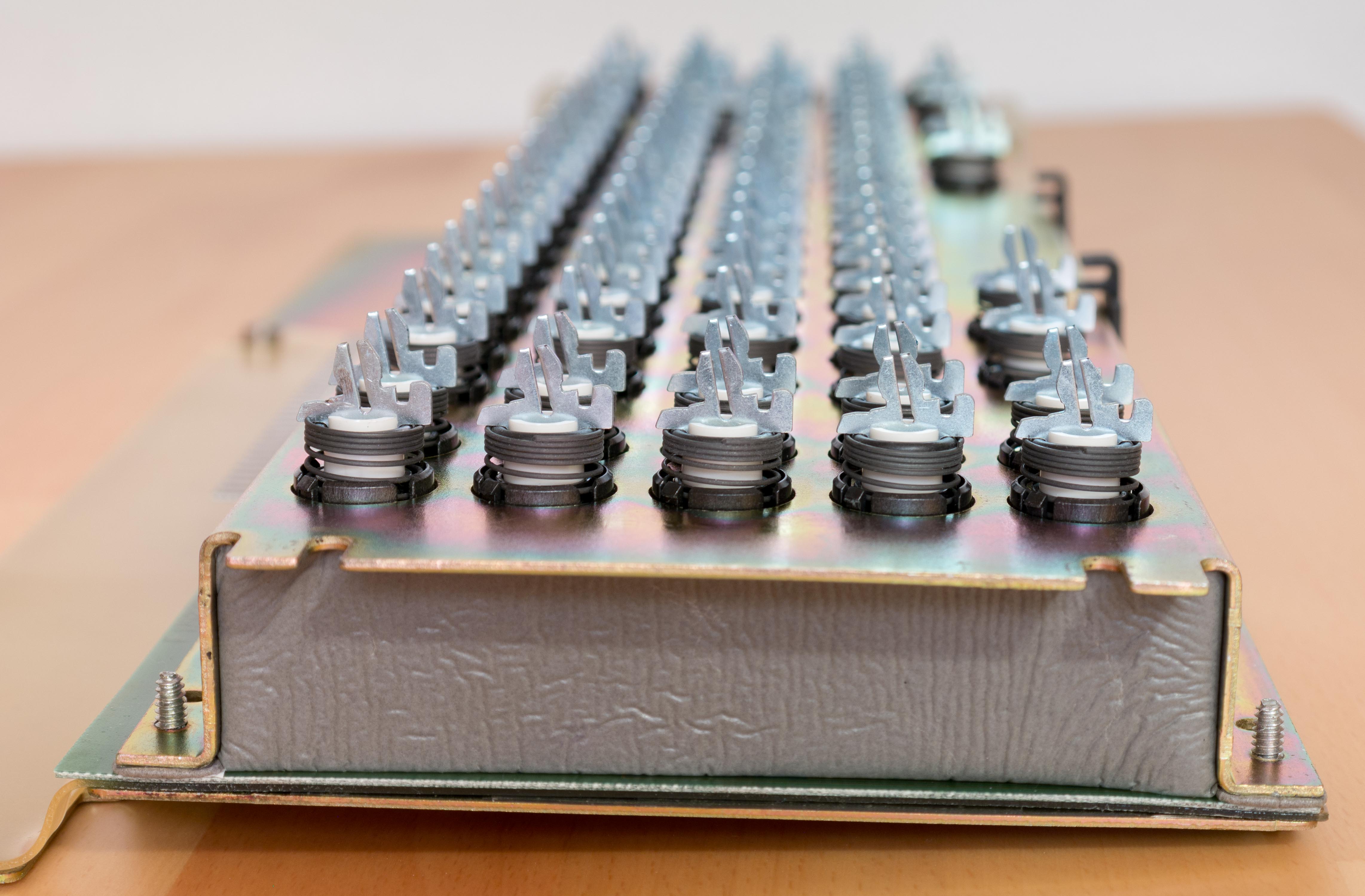

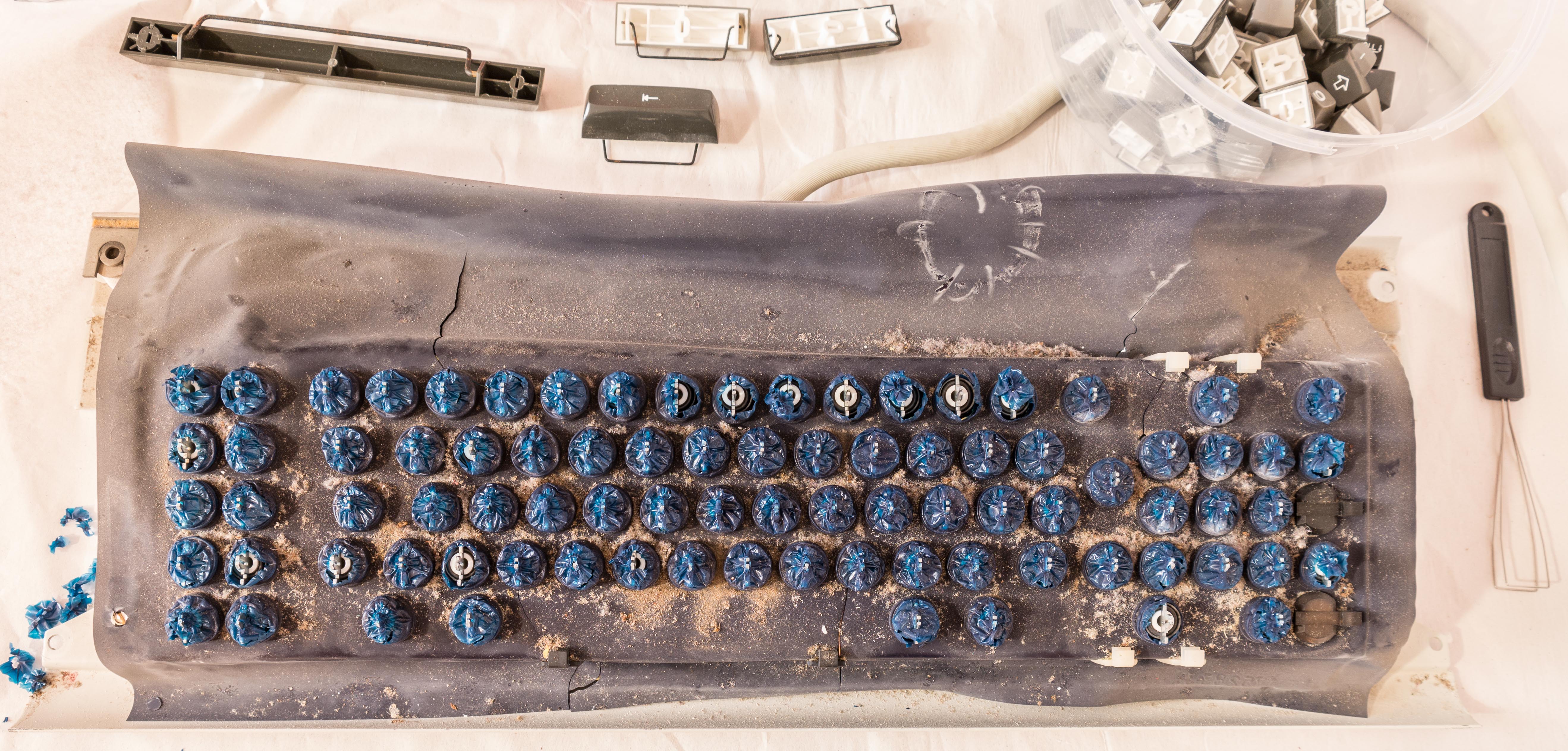

The inside – looking fine, even the visible part of the foam looks surprisingly ok, but under the switches it was of course all compressed to a thickness of nearly zero.
But this completely compressed foam was truly diabolic stuff. Removing that was the most disgusting and annoying cleaning work I've done so far. It was like tar that stuck to everything - sullying the previously perfect outside of that part.

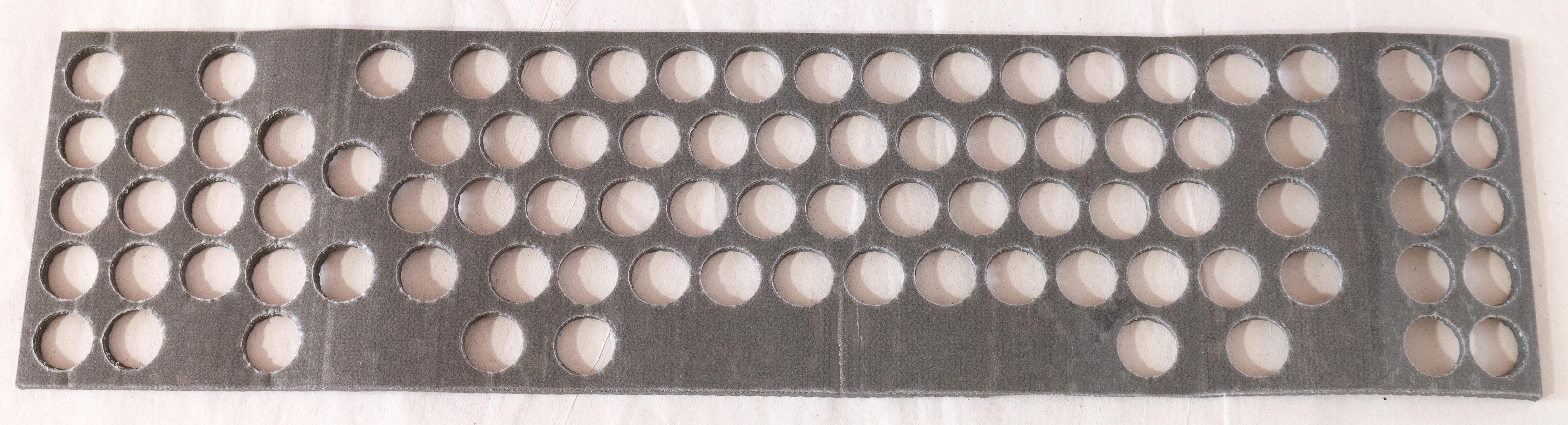

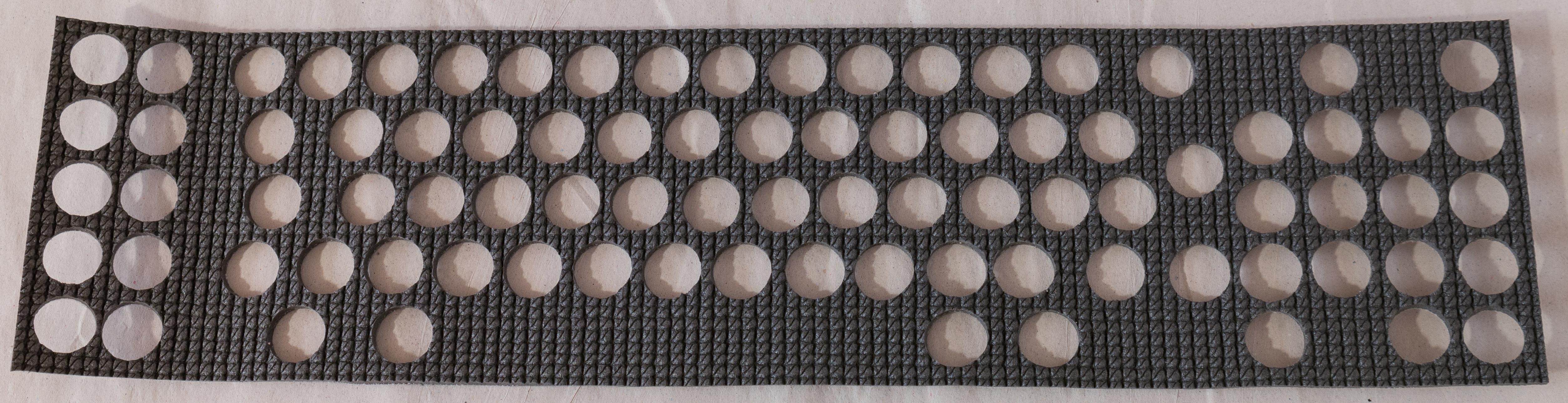

After the cleaning – with new seals, make from thick rubbery sticky tape. (I later cut them back to only a thin strip along the outside edge to make it compress more.)

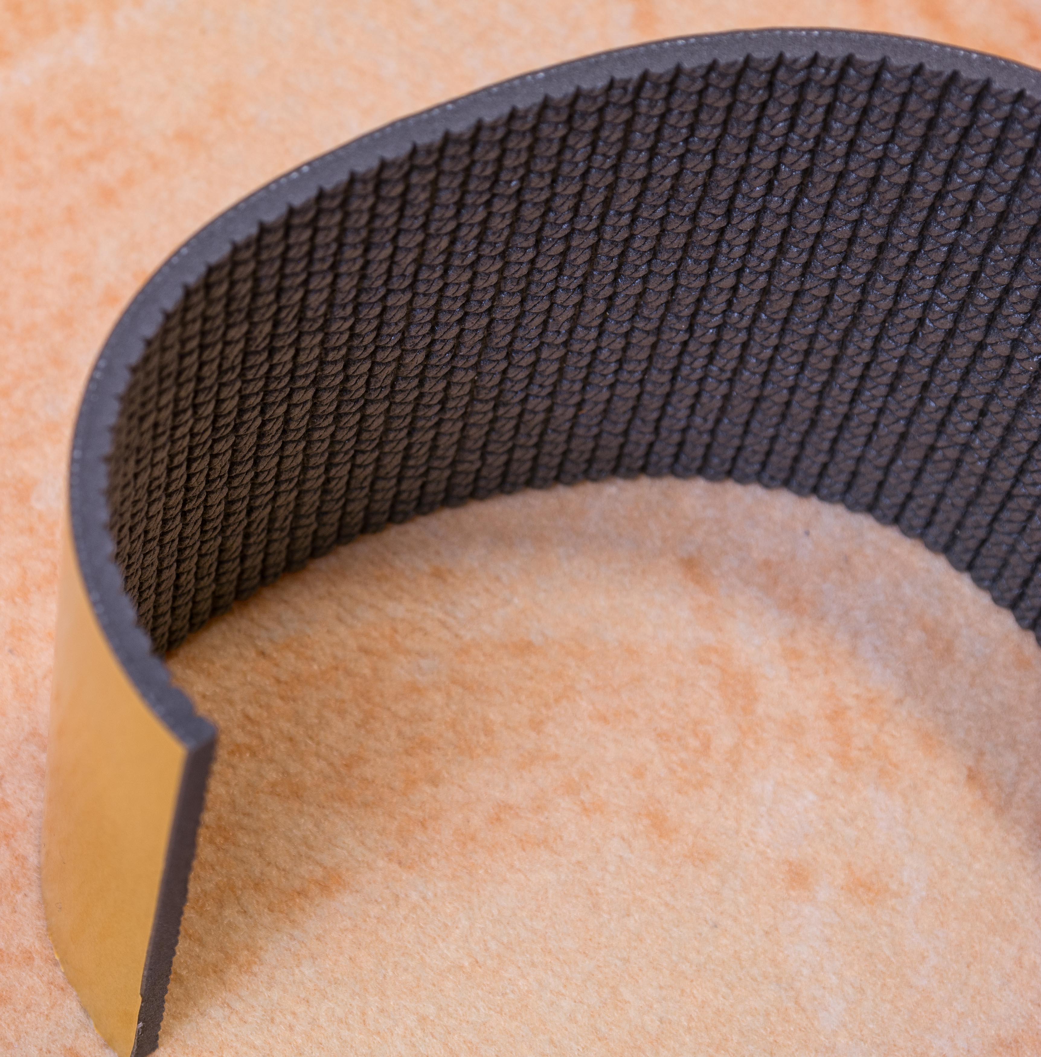

To find new foam in the thickness I need is always a challenge. Going by the amount of looseness of the switches I reckoned I would need something thicker/stiffer and in the end used a piece that I found in the workshop of my late father. One side is sticky and the other one has "pimples". No idea what it's called or what it's for.
On the sticky side I replaced the protective film (which obviously didn't stick very well) with clear film (meant for protecting the paintjob of a car). This side should be the one, where the switches would be pressed against.
The idea behind it:
- A bit more pressure against the switches. Through the stiffness of the clear film a bit more foam has to be compressed compared to just the small edges of the switches sinking into the foam. (As I found out later – probably not necessary)
- Instead of sinking into the foam, the edges of the switches can slide on the clear film, so the keys/switches can later be rotated slightly, should they look crooked. (I think that worked quite well.)

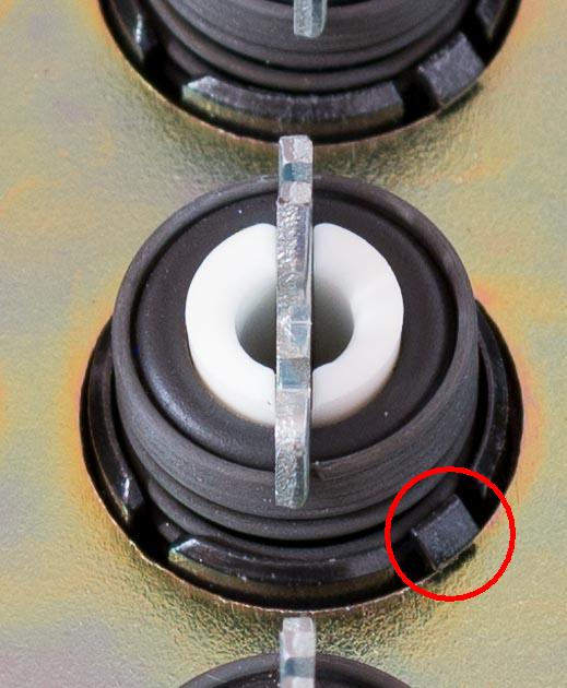

But as it turned out, the foam was too thick/stiff. After assembling, the switches of the middle row were often very scratchy. That was because the two little plastic hooks of the switches, that hold them (slightly) in the upper plate – together with the pressure of the back plate weren't strong enough to press the switch – against the foam – completely out of the upper plate (the picture, which I made later, shows a correctly positioned switch with "free" hooks, though).
If not completely pushed through, the little hooks were bent inwards and pressed against the spring, which resulted in an awful scratchy key feel (some keys were even completely stuck). The switches of the upper and lower rows were ok, because they are close the screws that hold all together. But as sturdy as the beamspring switch assembly looks, it still bends and I couldn't get enough pressure on the switches/foam in the middle.
If I do it again, I might actually think about a bolt mod – trilling at least two holes for bolts (below the return switch and between A and CTRL).
But this time I decided to make the foam thinner. Finding a new thinner foam and punching all the holes again didn't seem appealing so I decided to cut horizontally through the foam with a carpet knife. The result wasn't pretty, but it worked surprisingly better than it sounds.
Luckily that did the trick and finally everything came together nicely.

@AJM, Thanks a lot for the " little hooks were bent" tip, I had one switch just affected by this that I thought was somehow broken and now feels perfect after reseating the hooks.

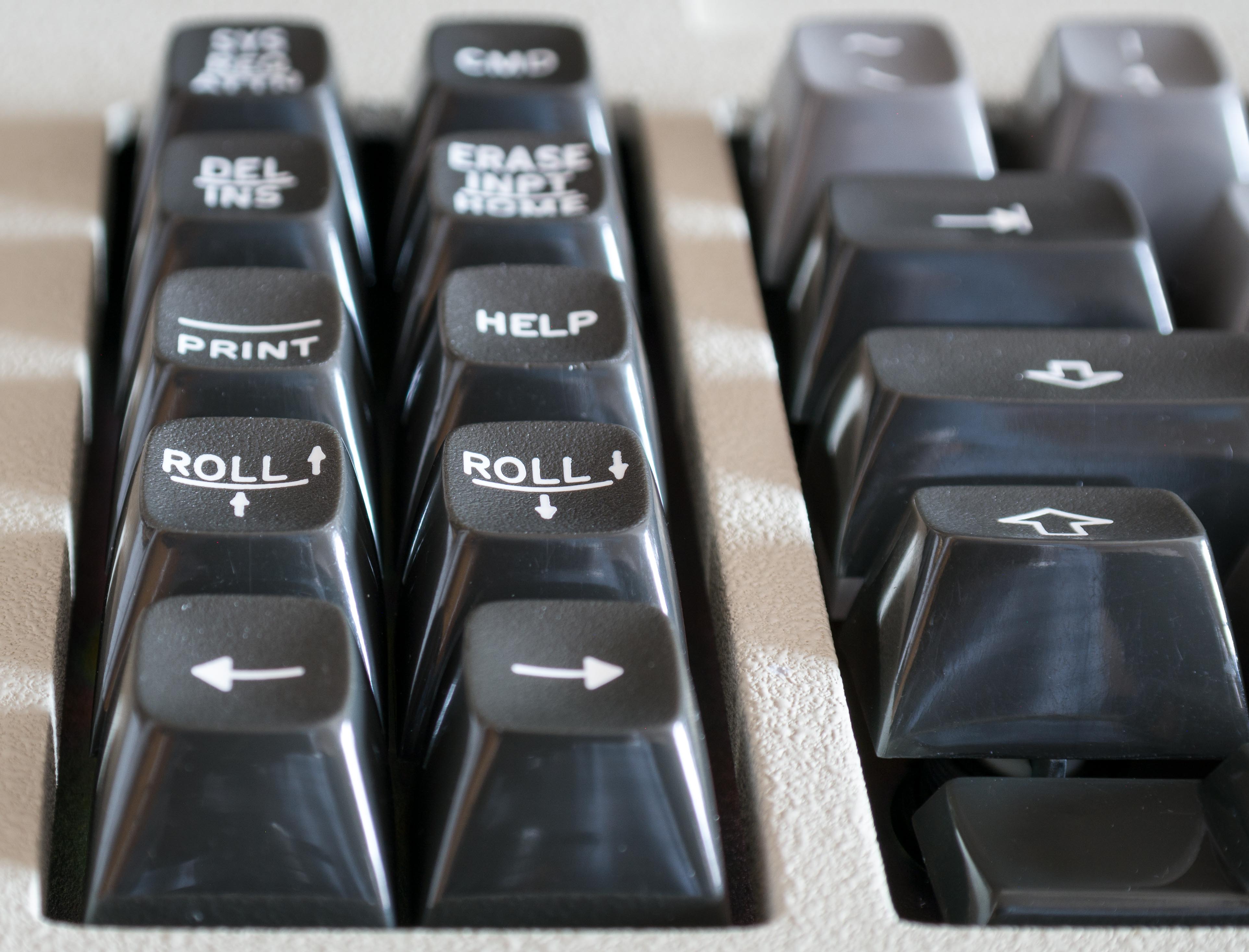

So I am now in the not sure what the keycaps are made of camp. I am waiting to hear back from the IBM archives guy. IBM developed acrylic injected keycaps in 1967 but I am fairly certain they are the clear relegendable ones on displaywriters, model f/ and pingmasters.
I tried the acetone on one black with white legend beamspring key and it sort of did something to the black outerplastic. No colour came off though onto the cloth. I could easily scrape off the slight discoloration and make it shiny again though on the black part so I don't know if it just has a laquer on it and the acetone did something to that laquer.
On the white plastic doubleshot inside of the same key, the acetone did nothing.
So the blackpart could be ABS although I have found no references to ABS being used in any manuals. It does say to never clean beamspring keycaps with alcohol of methyl chloride. This doesn't help much as we are not trying to tell the difference between pbt and abs. Most solvents will melt many candidates pretty equally. Also pbt wasnt really used until the 1970s.
The candidates I have been searching for are abs, acrylic, bakelite, polyimide, melamine, and other formaldehyde plastics. They could also be some variant of polycarbonate.
As for the PEI logo, I believe it is some kind of internal mold marking possibly a subdivision of ibm another company or an outdated material code. Most of the keys have mold marks like M-15 which is probably the specific mold to trace issues. The PEI mark doesn't look like those at all. From what I can tell Polyetherimide wasn't invented until the early 80s.
IBM did update their two-shot injection molding process in the early 80s for replacement keycaps, but it seems more likely they would have just used ABS. As well for some reason they decided to shoot the outer part of the key first then the insert. Perhaps there was some plastic bonding reason for this. Or maybe just nicer legends.
I do know that earlier IBM electric type writers had cellulose and bakelite keycaps that had laquer finishes. So I will wait for the archives guy to see if he has anything.
