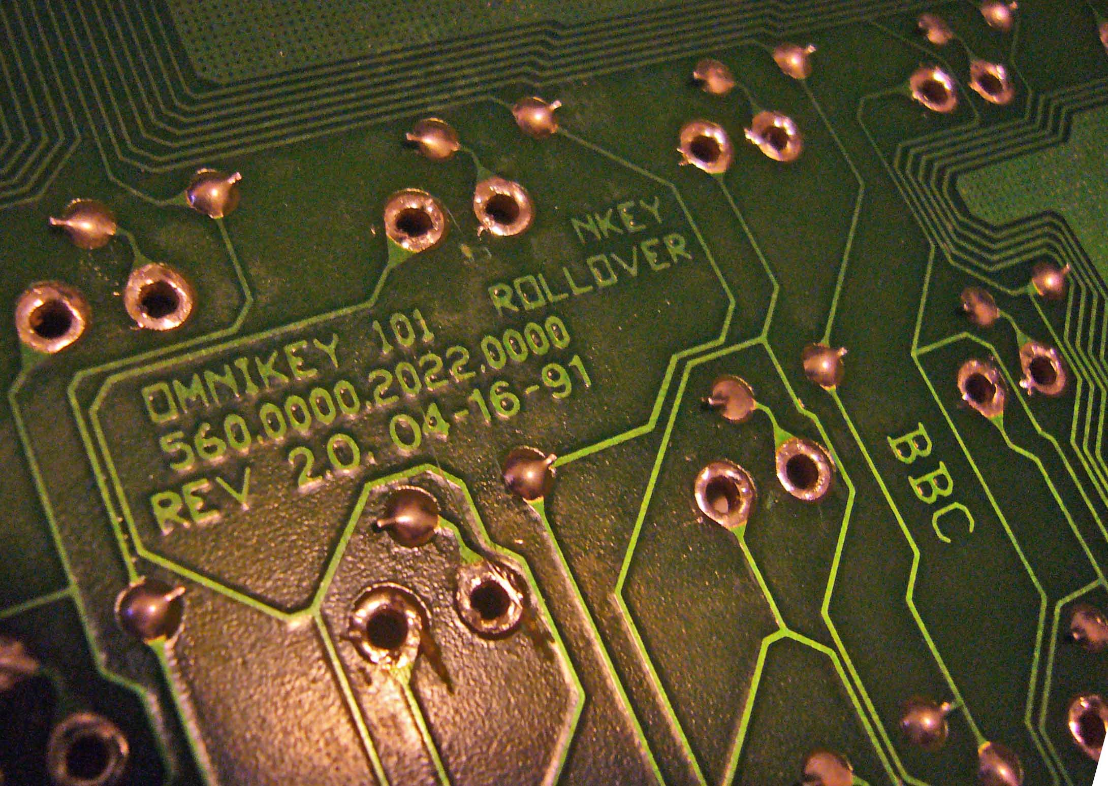

09 Feb 2019, 15:19
At least Northgate was nice enough to specify:
