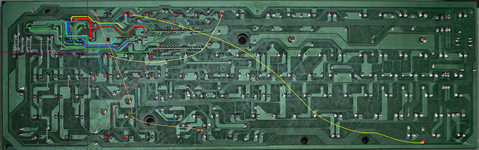

I even have an old wiring diagram that someone posted on Geekhack back in 2013. (I'm sorry I forgot to note down the username in the filename for attribution)

Forget the pcb, no need for it. handwiring would be easier than patching together a chopped pcb. getting the case to looks good after the cut is the big deal here. if you screw up the case on this though its really no big deal, at101ws are dirt common anyway. Its a pretty neat idea if you can pull it off successfully.
