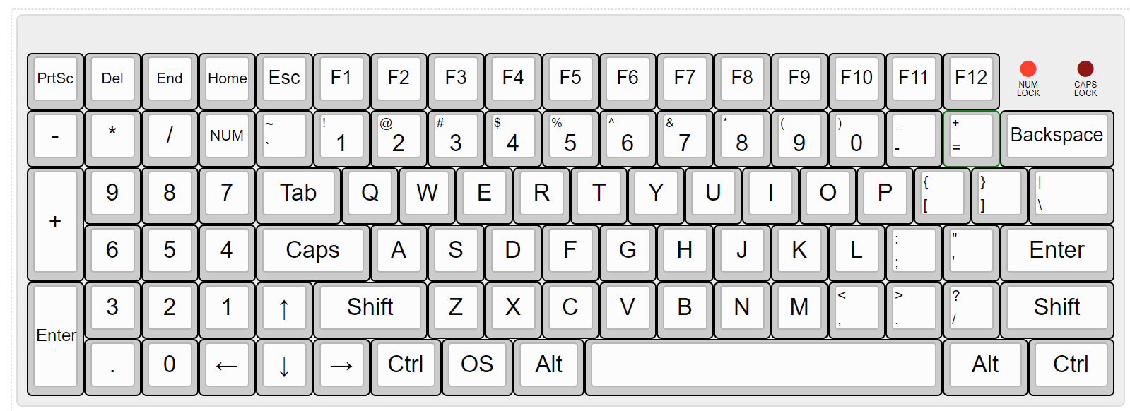

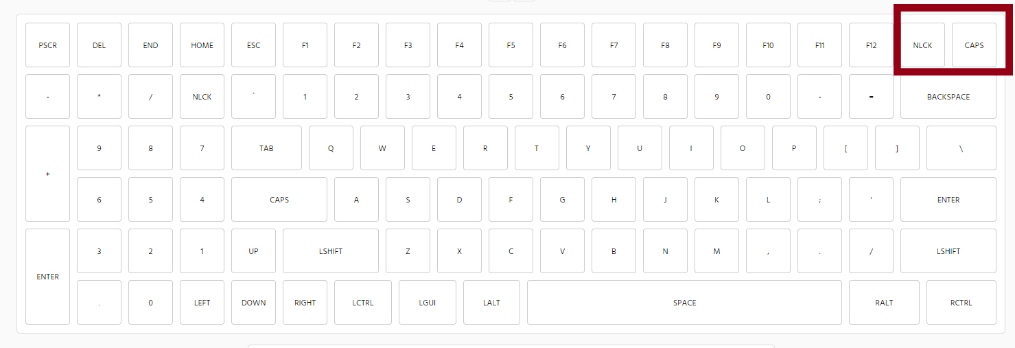

I am not entirely sure how the matrix works but have a vague idea. Vague meaning I know when a switch or combination of switches is pressed, that results in a unique series of closed contact points being sent to the controller. Other then that, I'm lost.
My matrix would be slightly mirrored but not exactly. As you can see the numpad is on the left and is mirrored to reflect what I thought would be proper. There is a proper way to type and I'm not there yet but learning. This seemed like the right choice. This also leaves room at the upper left for the num lock and caps lock indicators I'd like to include.
The idea is to make this a left handed board, work the bugs out and learn how it's done properly. After that I'd like to do a full on Russian keyboard, but with some changes that I need to understand in order to program properly. An example would be replacing № with @. There's no way I'd be able to use a keyboard without the @ symbol in this day and age with email lol. Can't see a time how the № symbol is relevant yet in the language but the @ is a must.
Little details in symbol programming, key spacing and correct footprint placement on the PCB will also need to be learned. The default unit seems to be 19mm from center key to center key. I'll need to figure out the proper placement in KiCad and go from there. Maybe you are correct on starting out with something more simple but I honestly have no use for a 4 x 4 pad at this point. Might be a good way to learn with less information though but still wouldn't get me to the goal of a full 104 layout.
ETA: By Correct Paths I mean the correct way to connect the columns in the matrix. The ANSI 104 is angled the further in you get on each side. Making the choices unclear for me as to what switches are connected to each other.

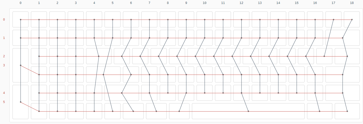

When you press an ohmic (contact) switch, one column and one row close a circuit between two pins of the IC or microcontroller. Every key is a unique combination of row + column and hence a shortcut between two pins.
Let's see a quick example, first I have this numpad:
And his matrix:
For example, * is the same as row 0 + column 2. Which is the same as B0 + B7.
You only need to be sure that every key is a unique combination. The page builds the code for you, nothing more easy than that.

I guess that's where the confusion starts to set in. Where are B0 and B7 coming from, the pins on the controller ?
Posted: 07 Oct 2018, 02:43
by PlacaFromHell
Yeah, they are physical pins of the controller, already defined. This will help you:

Okay, so I'm clear.. In the example pic below, * on the left handed numpad would be
B2 + C0 on the board ( Row 2 + Column 1 ) ?

This is where I'm lost. I had no idea you could choose the pins yourself ? Thought you had to pick pins in some sort of order ?
This is what makes it so confusing...
What would you put it for the layout below using the Teensy ++ 2 ? That's really the only way I'm going to understand this I guess.
Posted: 07 Oct 2018, 07:00
by PlacaFromHell
Just use the ones that the page gives to you. It's the safest way because these microcontrollers sometimes have oscilators or pins with weird outputs.
I couldn't tell you what combination was the key in the picture because I don't know what pins you have assigned by default (but also you can choose your pins if you want). When you are wiring your keyobard and you want to know what pin is what, you need to see the "PINS" tab. Pins are not necessary related with the row/column number and all of them work by the same way in two groups, which are rows and columns.

Posted: 21 Oct 2018, 00:13
by tedfs3
Can anyone explain how the status LEDs are connected and assigned ? It's probably simple but I'm just not understanding what to select in the Keyboard Firmware Builder.
The first picture is a potential layout. The second picture is the wiring generated by Firmware builder. Third picture is the key map and the LEDs in question are highlighted. The builder seems to be treating these as keys with wiring and KC codes. What's confusing to me is where is the option to indicate they are LEDs and not keys in the builder ? Or am I just missing something altogether ?
Posted: 21 Oct 2018, 13:19
by Anakey
you do not need to include LEDS in the layout editor, you can set LED pins seperately at the bottom of the pins page
