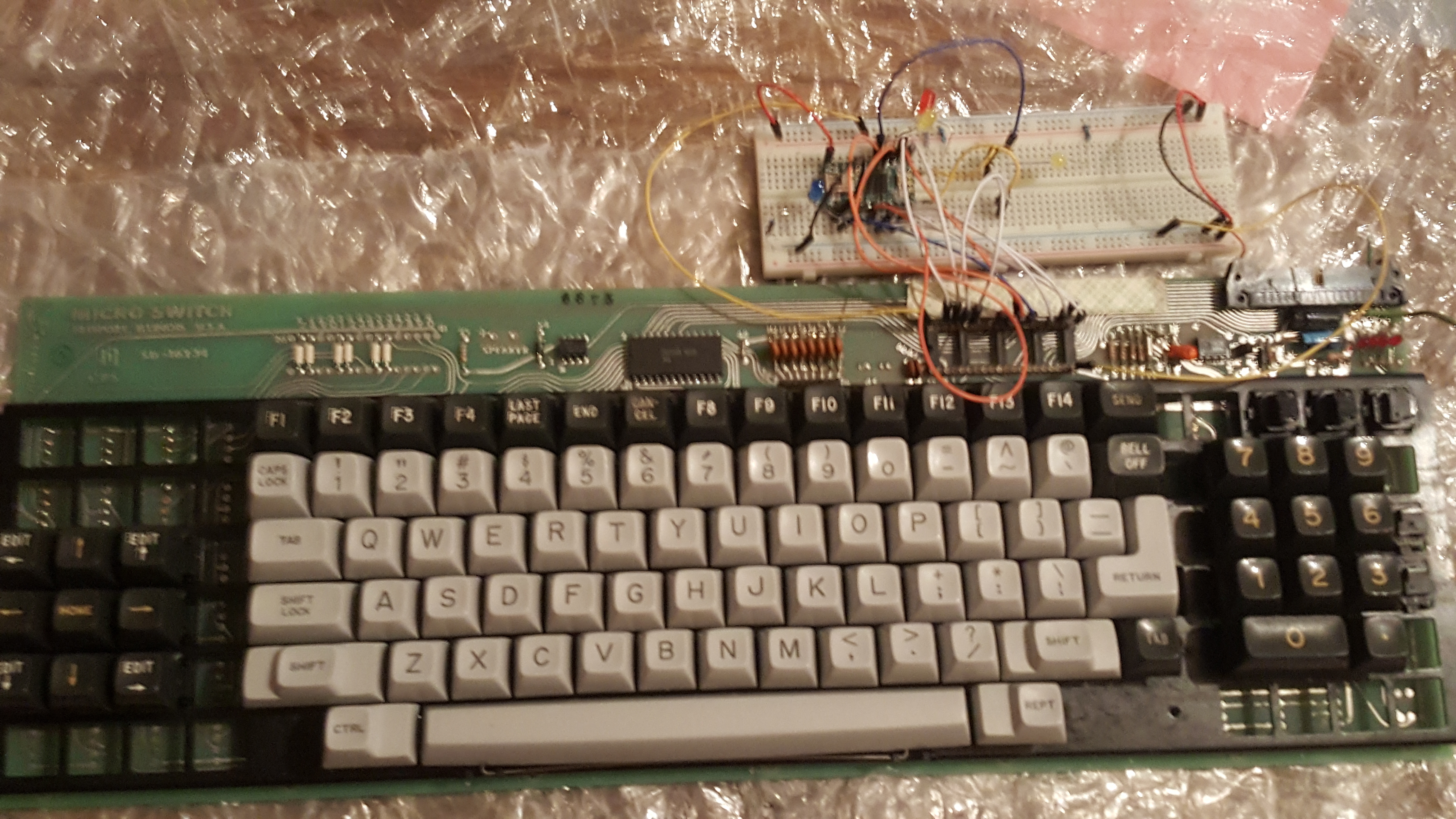

I made a power supply out of a cell phone charger that output 5v and began printing out all the documentation that I could dig up about the SD series and Honeywell in general, which is very sparse. There is no home of MicroSwitch keyboards like you have with IBM or SGI and the Wiki has just about everything that has been gathered about these interesting switches.
After a few days of waiting it arrived and I had planned on using some of my vacation from work to devote all my time to working on the project. I wanted to give something back to the community that had helped me so many times when I needed to identify a board or when I was trying to determine if a switch was authentic or a clone.
I wanted people everywhere to be able to use these old MicroSwitch boards. The feel of those keycaps and the dream of having something that sexy on my desk was also a big factor.
When I opened the box this is what I saw, When I depressed a plunger it slipped down with all its promised smoothness, this is the closest you can get to touching an angel I remember thinking. The deep clunk of the switch bottoming out was satisfying (something I always do on linear switches). I can honestly say it was one of the few times that I felt that the hype was justified.
This is what she looks like naked, I love the modular mounting system that would allow for awesome customization as far as I can tell there is no reason why you couldn't turn this into a Space Cadet type. I would just need to get more switches and have a keycap set made or just accept having a motley assortment of keys.
After carefully going over the board, I began to write down the part numbers for the different chips that had been placed on the upper edge of the PCB. A few of the chips didn't have anything to do with the actual operation of the keyboard, such as an optical driver for a light pen.
I used the datasheet of the TI 74154, which is a four to sixteen line demultiplexer to determine where the power and ground lines were, double checking myself against the big caps just below the original cable connector to be sure. I had soldered some female connectors onto a cell phone charger and I used this as my test power supply feeding the board with five volts dc.
I had already used the Multimeter's continuity tester and I really can't stress enough how much trouble and time it saved me. I think you can get away without having an O-scope but you can't get away without having a good Multimeter with a continuity tester(The louder the beep the better). Such a tester lets you with no power supplied to the board, place a probe tip on say a leg of an IC while placing the other on the connector pins to see how the connector is laid out.
Then using my Multimeter, I checked the eight test points that I had deduced were tied to one of the eight rows which I realized each corresponded to one pin on the cradle that had held an Intel 8748. I felt at this point I was making progress.
But my probes showed that there was zero volts on the test points with FIve volts supplied to the board. I checked various points on the board and found that they all had power. I asked my wife to press down keys so I could hold the probes steady on each of the test points in turn which I hoped would produce a voltage when depressed, still nothing.
Feeling defeated I went back to the SD Keyswitch document and found that someone had scribbled a diagram of a four pin hall effect, they had even labelled the pins correctly and I could clearly see that one of the pins was an input.
In a flash of insight I reached for a jumper and applied a voltage to one of the inputs on the de-multiplexor and once again probed the testpoints but was disappointed yet again.
So I rechecked the 74154's datasheet, combing through the short document. I laughed aloud when I realized my error. There were two enable pins on this chip, one had already been tied low but the other had a trace to a pin on the 8748. So running another jumper from it to ground, I tried again.
Powering up the board I used a jumper and applied a voltage to a single input on the 74154. My probe quickly found voltage on one of the rows and when I depressed a key the current disappeared. I released the switch and the current returned, if I were an athletic man I would have done a back-flip.
Now I just needed to program some kind of driver but I really didn't know anything about creating a USB device much less an entire driver library.
So starting small I wrote a simple binary counter that worked by bit shifting a one. Then set up a while loop to strobe the enable lines one column at a time. While I scanned the other port for any lines that went from high to low.
I quickly began to view the sixteen outputs of the de-multiplexor as the columns in a standard keyboard.
So my debug program was watching for any changes as it ran through a for loop enabling an input and then checked the 8 bits I gathered from reading the D port on my Teensy. I then set up a simple if statement inside two for loops, to keep up with where I was in the array so that I could print out a number to provide my location in the keymap.
This worked off the PRJC Debug Print function and it simply said KeyHit and then spit out the hex number of where the key was in hex.
It took me a little while to get the timing worked out right. I was suprised at how quickly I could poll the switches. Now this was progress. I now had a working MicroSwitch board with inherent nkey rollover I just needed a driver.
In the end I decided on the LUFA driver and as I said earlier I used the LMkbd project as a jumping off point.
I hooked up everything with jumpers to my breadboard.
| 8748 pin | Teensy 2 pin | Signal |
| 20 | GND | GND |
| 40 | 5V | +5V |
| 27 | PB0 | Demux Strobe |
| 28-31 | PB4-7 | Demux Address|
| 21-24 | PD0-3 | Input |
| 35-38 | PD4-7 | Input |
Once I had the driver up and running I began the laborious process of setting up my KeyMap.
After finishing this up, I connected everything more permanently with male to female connectors. I hooked the female end to the header pins I had soldered on earlier. I then drove the male ends directly into the cradle that had already been attached to the board making sure everything was well connected. This finally brought us up to this point.
So now I had a working MicroSwitch. I had done it, and a part of me wanted to go brag about it, but I'm still not quite finished because there remain a few minor annoyances.
My main problem is that several keys on my board have unique shifts and I couldn't get the proper HID KeyCode for them.
This is something I've noticed on several MicroSwitch boards the open parenthesis is placed over the eight and the close parenthesis over the nine. There is no shift over the zero so this moves all the alpha-shifts one row over to the left.
There are in fact more than a few keys that are non standard and so you have to just assign them to something that's close or just use what that position would be on a standard board.
To me, this was unacceptable but after doing some digging I realized that there was just no easy way to make your own key shifts. There is a way, but I didn't think getting each person to patch their kernel was really going to be a popular solution.
Using the board is a little tiring. The non-standard layout drove me nuts so I messed around with the Keymap until I had the modifiers I needed for my day to day computing. With the keymap arranged properly, I started to use the board as a daily driver.
The switches are nice but heavy and tiring. They have a long travel and being linear I always bottom them out. I love the sound they make, but after fifteen minutes of typing I feel like I've been running a marathon. It's almost a piece of exercise equipment for typing strength.
The construction of the board is top notch. The PCB is thick as hell and most of the boards basic components were all military grade. It has a modular top plate that allows you to move switches around in a grid based arrangement.

Here is a link to the source and the Hex file which is for a Teensy 2, you can use the pinout provided if the Micro on your board matches mine, this code should work for the 3 pin SD variants as well. I say should because I have never tried it myself but I took this code almost directly from a Space Cadet Conversion that another guy named McMM had done a while back, the Space Cadet uses the 3 pin type if I'm not mistaken.
If your board has a different Micro or it has a different switch type.
I really need to get more switches so I can understand how they work. I can't understand why MicroSwitch would manufacture a Hall Effect with four pins and one of them be redundant. All the modern digital Hall Effect switches that I have found that are similar in type to the ones used in a MicroSwitch board are 3 pin. I really thought the enable pin was just something that they had done for the logic scan thing. It seems they just took an And gate and tied one leg of the Output of the transducer and ran the other leg out of the casing of the component which is a great solution to the whole n-key rollover problem.
But since I don't have any of the other signal types I really can't say much about them. But I have been looking at the the Wang Board(phrasing) I think it could be converted with just a daughter board a multiplexor and a teensy 2 but I'm an optimist(not really) But it should be possible without to much rework but I can't say without understanding fully why the switches have two pins that emit the same signal.
Here is the link to the source and hex
https://github.com/lessthan0/microswitchkbd?files=1

Hey cool! thanks for the PM. I have this exact KB. I only had time to skim this before bed but I'll read it in depth and have a look at maybe getting mine worked on.
I did get the "bit paired" layout to match what's printed in the keycaps by implementing "shift' as a function key, and the "shift" function layer outputs a macro for each key that's <shift><keypress></shift>. This works to get capital letters and anything you want out of the number row. Note that bit paired keyboards also often have something weird on the 2 (usually ") and have other differences. I switched back to normal keyboarding and ignore what's printed on the number row after I got better at touch typing.
I have a silent 700 that I have drilled the PCB and can quickly wire up any way I want, The only thing I'm missing is firmware. I'll see what I can make work.
Oh and as a "bounty" for helping me work on hall effect, I might have some extra keycaps with the legends you are after. I'll have to check through my collection though.
Finally, SP can make new hall effect compatible keycaps. You always get a few with the yearly grab-bag that they do.
Cheers!

Hey, the kb works great with your hex! Keys read just fine, there's basically no lag, and I count 6KRO.
but I'm having some issues with the keymap. Basically F1-F4 send weird keycodes (aquakeytest says they are bios code 0x67 windows key 0x7f for F1 for example). "Last Page" sends F5, the next key "end" is escape, they key after that and F8 do nothing, and F9-12 work great. F13-14 send "weird" keycodes and "send" is letter O. Most of the alphas are fine except the key labeled [* :] which sends letter "H" Most of the tenkey is fine except 6 sends letter "Q"
I need to head out now, but I'll double check my wiring on the inputs. It's entirely possible I have a wire crossed somewhere. I didn't have a chance to double check my wiring before my girlfriend wants to go to the county fair.

Awesome news awesome, I will check the source I can fix the function row I just used the standard f-alphs as placeholders while I was debuging and forgot to replace them. The switch which corresponds to 6 numpad is broken on my board so I never set it. I can update the hex in the morning I just need to find the duplicate 'Q' and 'H' then replace them with the proper keycode. Good deal, have fun at the fair.

I've updated the source and HEX files fixing the keymap.

Still getting some errors with the layout. I think I'm going to see if I can figure out how to compile your source code into a hex file and play with the key assignments myself.
In other news I reverse-engineered the entire circuit Here's the schematic for most of it. Missing are two components that might be diodes (?) near the crystal and the output of Pin 5 of the 75451 (which is shown above). Grey are the pins on the output connector in the front. PIns 11 and 25 (ALE and PROG) on the 8041 appear to be not connected.
Here's the matrix. The number in the square is the numbered switch on the back of the board. They go across then down from left to right so it's easy to see what the number is from the top. Note that switches 1-4 are wired up to the row of jumpers located at the top right called 26-41 on the PCB. These can be arbitrarily wired up. I have put them in the matrix where they are assigned on the texscan (1-3 are the same for the board here and 4 is not connected at all)
(its tab separated so it doest come out right. Paste into your text editor for a better look) I have also uploaded it here as an xlsx spreadsheet.
The columns across the top are the logical outputs of the 74154 which are labeled as 0-16 in the datasheet
The rows correspond to the inputs of the microcontroller which are also connected to test points TP2-9 and pins 35-38 and pins 21-24. In the 8048 datasheet, these are called "P20-P27" I know this doesn't apply to the board we have here, but it's very relevant to the texscan MSI boards I have as well as any other keyboard using this assembly form microswitch.
I'm still not able to get any output from mine with the 8048 microcontroller. I've traced the "issue" back to the fact that the demux output enable pin never enables the demux output, so the columns never turn on and the rows never send signals. I have a button that is connected to the "reset" pin of the 8048 but it doesn't appear to work.

https://www.flickr.com/photos/dork_vade ... 7779985502
awesome. Can you tell me what kind of silent700 kb you have? I have a box of teensys and a soldering iron ready to go. I even drilled a PCB on one so I can wire it up however I want.LessthanZero wrote: I was speaking of the keyboard that I converted, your TI code would not work on my board and the code I use wouldn't work on the TI. In order to change the driver to work on the TI I just need to change the scan module slightly, instead of using the four address lines of the demux I just strobe the enable lines directly.

Do you have a picture of the third board as well?dorkvader wrote:Unfortunately this is only true of some of them. The early 1973 models have a different pinout completely. (i suspect they have card-edge connectors like other hall effect keyboards of their time) but I've never seen one to confirm. Of my three silent 700 boards, two of them are completely different. Even though the pinout power/ground is the same, the keymap is different between them. One is a 63SD17-2-A from 21'st week of 1979. the other is a 58SD17-2-B from 29'th week of 1979. The internals of these units were also completely different despite being made weeks apart. But this is not the silent 700 topic (unless we want it to be)
