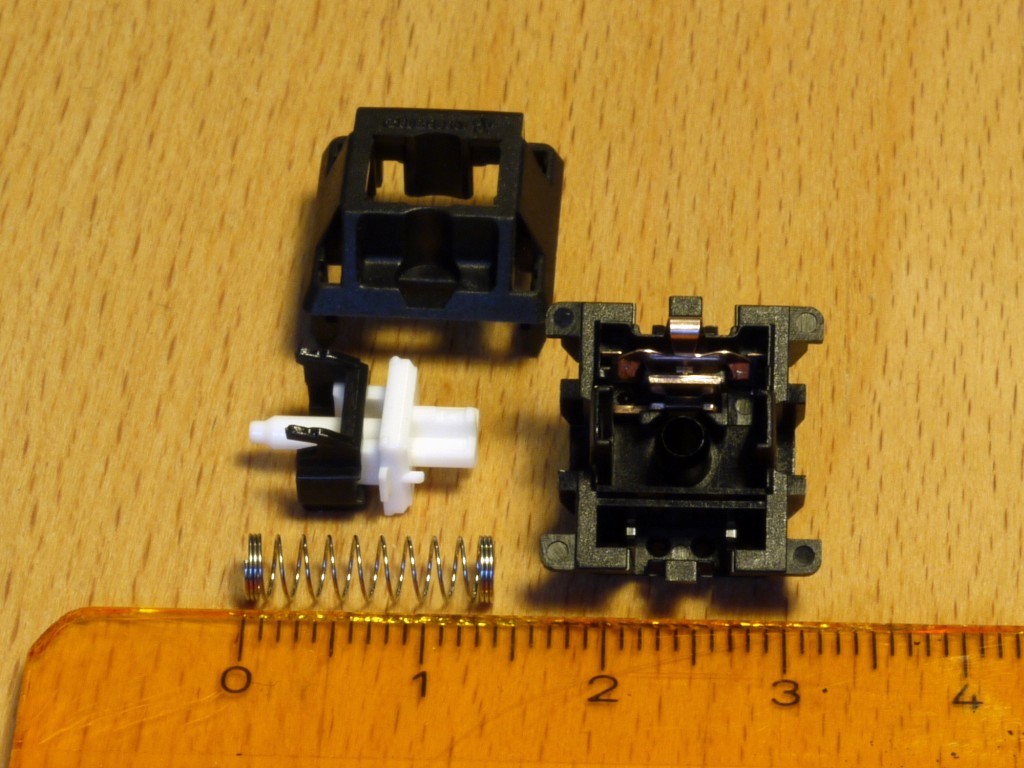

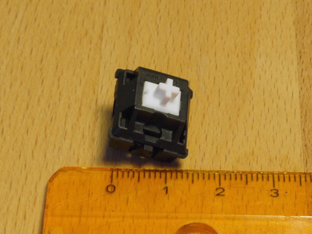

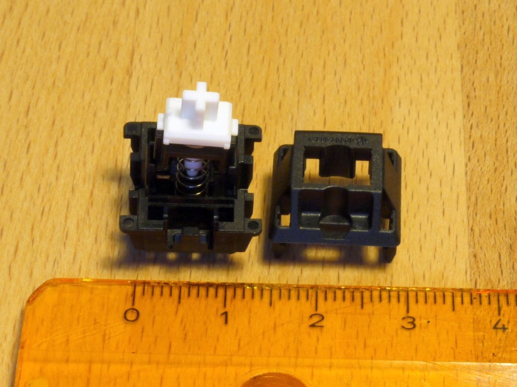

Hi there,
I've got this switch from Conrad electronics. It looks just like a Cherry White and it is actually sold as part number MX1A-A1NN which is the correct code for plate-mounted Cherry Whites without LED.
Over at GH, I asked about it but I got no clear-cut answer. What do you think?

- P1050787res.jpg (134.62 KiB) Viewed 8853 times
- P1050786res.jpg (157.55 KiB) Viewed 8853 times
- P1050785res.jpg (166.64 KiB) Viewed 8853 times

Maybe it is actually a new model that we somehow missed and which came out recently. Looking at the pics again, it indeed seems as this is a solid white version, while the older vintage version from 1986 is more clear - in fact identical to modern MX clears.
If you have access to clears, could you take a pic next to them like I did above?

Btw. : If you look at the stem bottom of the switch that Kurrk posted you will see a difference compared to this pic of a white switch in the geekhack wiki img src

So I talked to Bruce this morning (since they also have some in stock) and it turns out that he just ordered them based on the old part number. The stock they received is from 2007, which is still 20 years later than the last ones we have seen used of these. That must mean that Cherry still made these, or even still makes them for replacement parts and such, and no one ever noticed. Mind blown.
