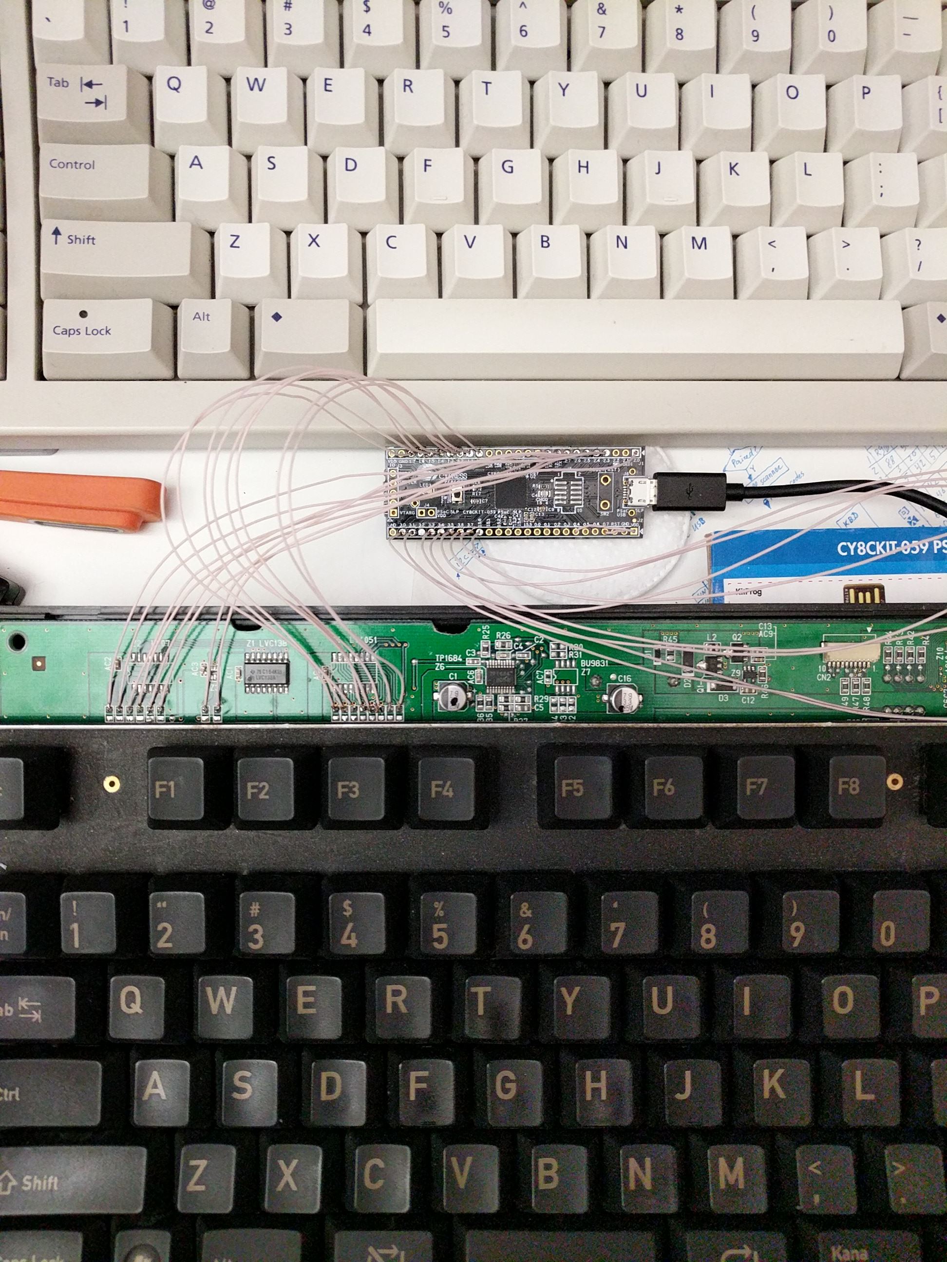

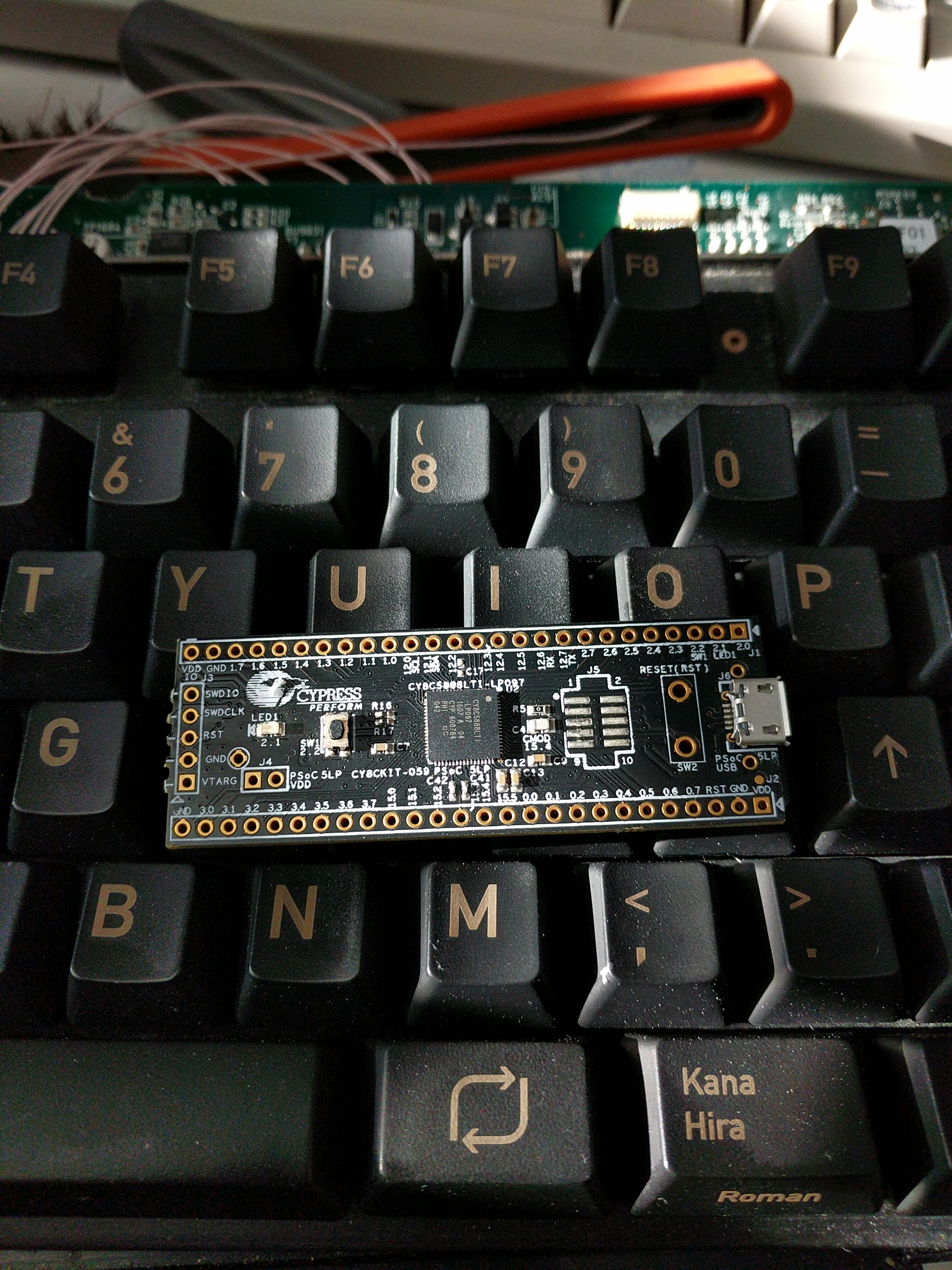

I'm typing this on a "dharma tactical keyboard", converted to commonsense.
NOT using TP1684 chip. Just the CY8CKIT-059 connected directly to the Topre PCB.

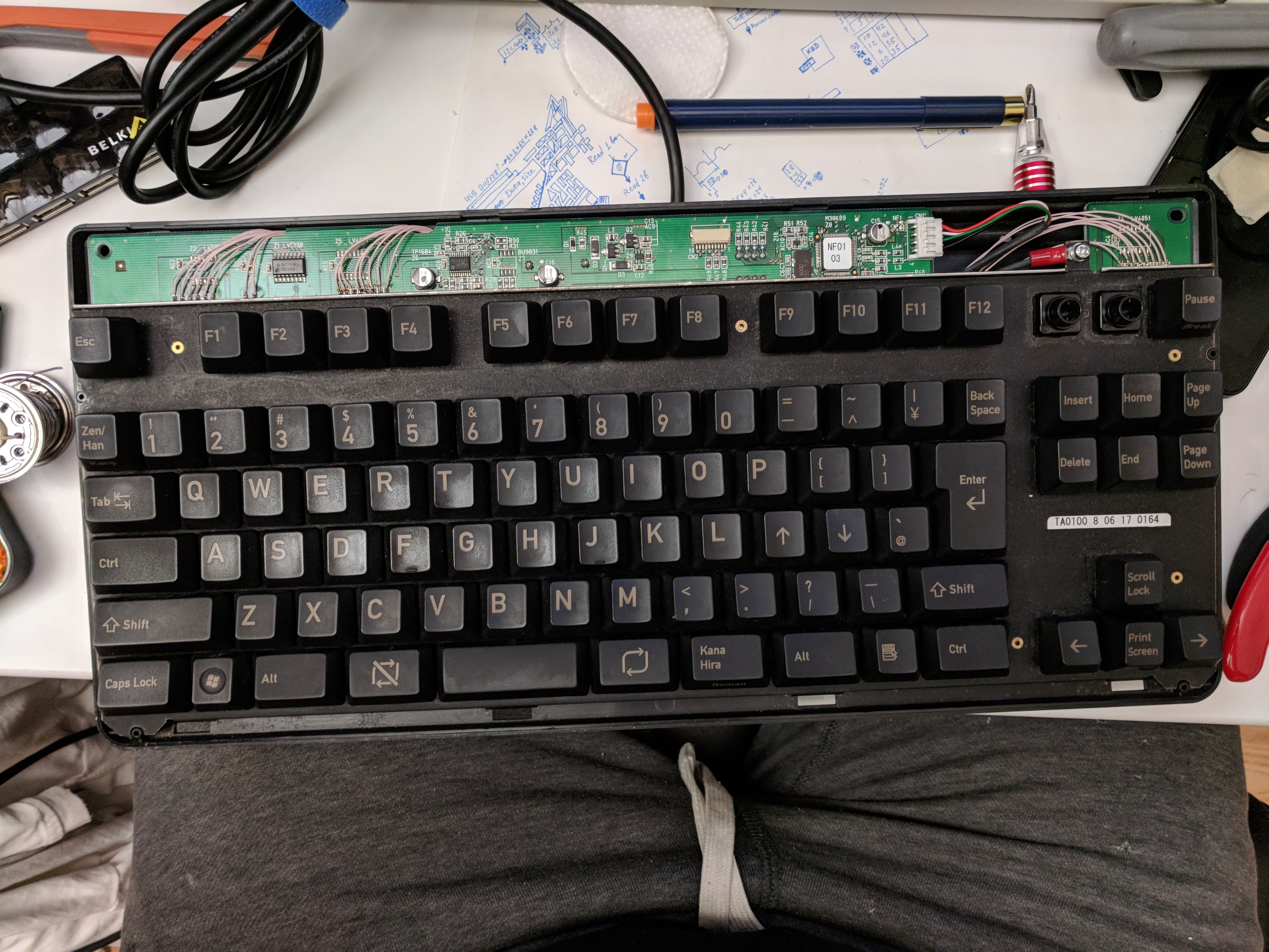

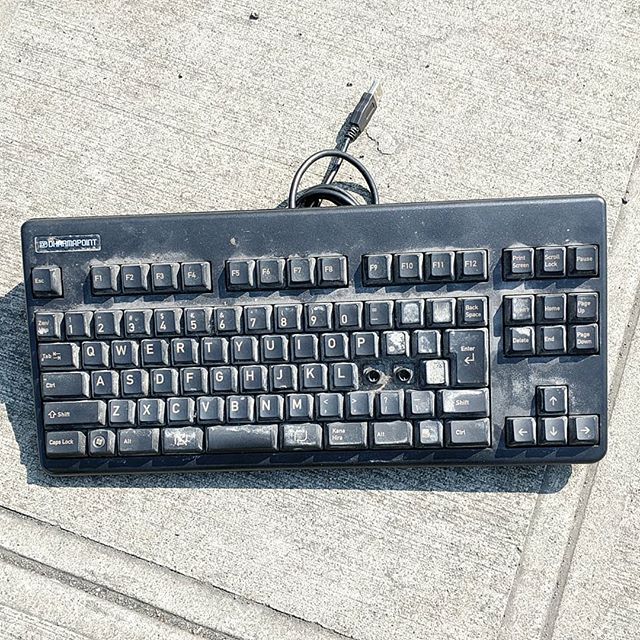

The keyboard was donated to me after being soaked in a plumbing incident several years ago, and looked this way:

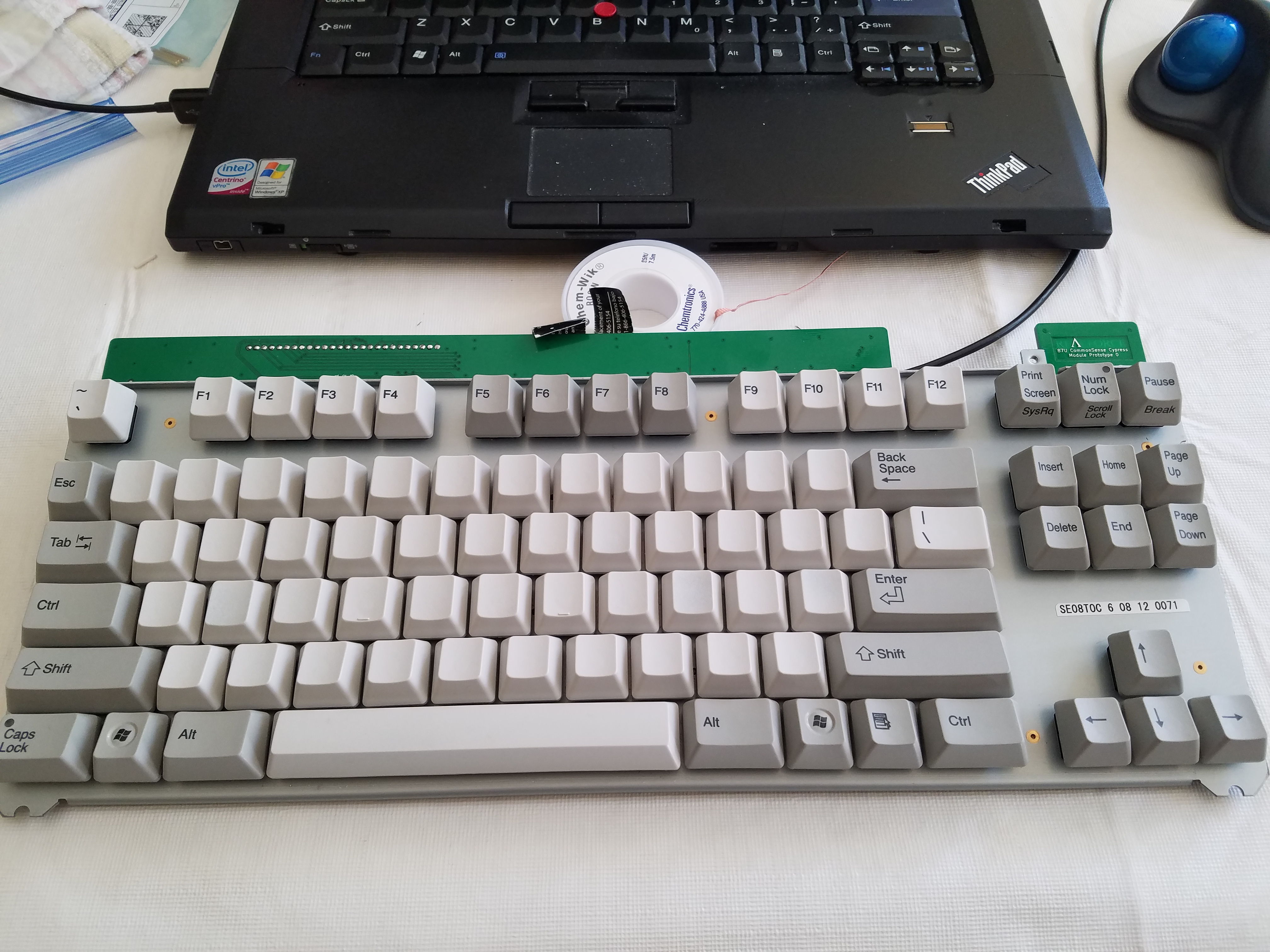

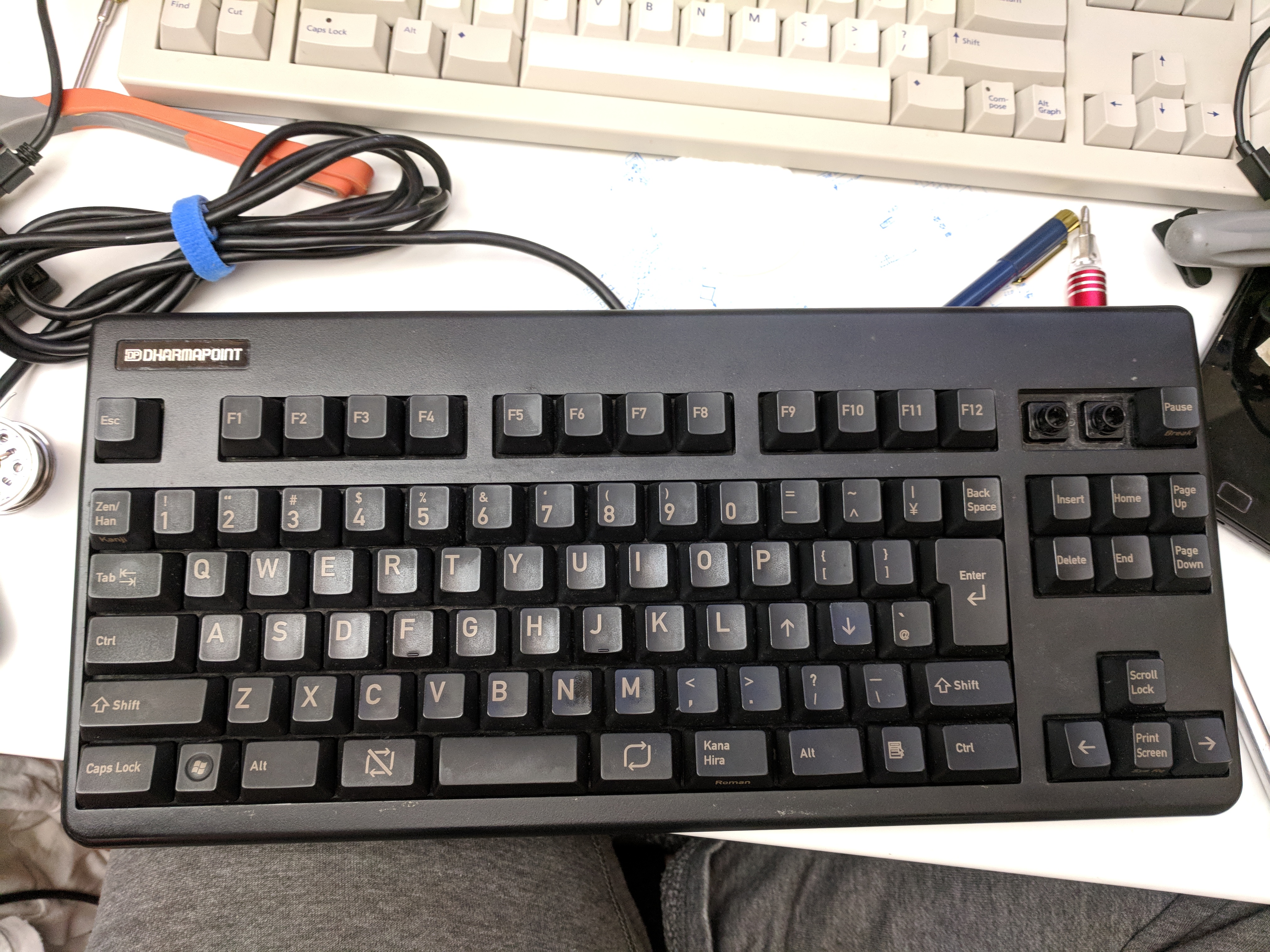

After some dishwashering and an isopropanol bath, it looks thusly:
But the interesting things are inside.
The last virgin controller I have. No more experiments until I buy another batch.
Top case removed:

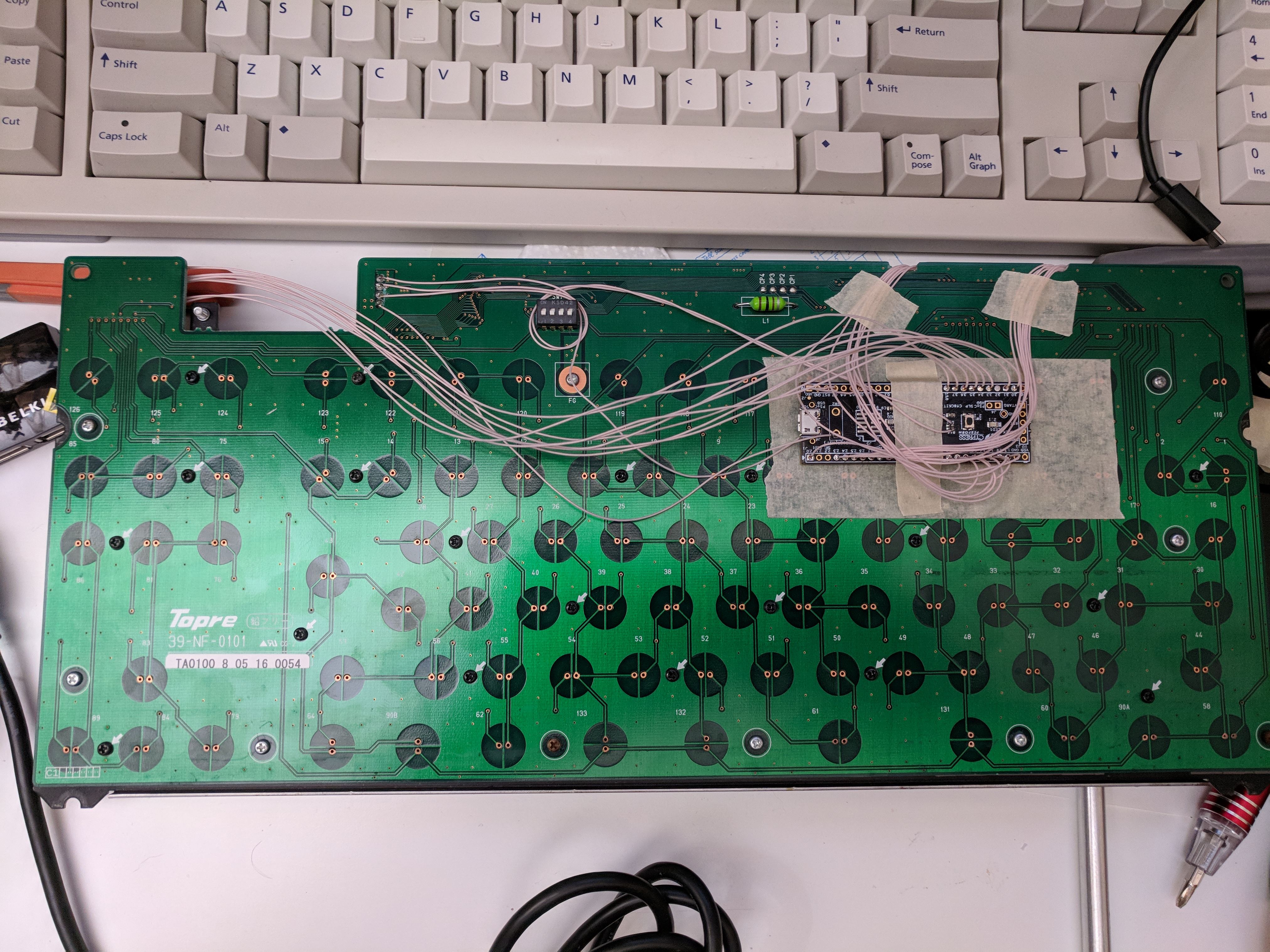

PCB bottom, controller taped to prevent running away:
Of course it's not a prototype if you don't fuck up. After all, "prototype" is coming from Greek where it meant "to fuck up" :)
Cut wires to length just to solder everything, turn it on and discover that I swapped rows with the left half of the columns.
Actually I want to say a word about topre PCB. It looks like it's at least 4 layers, and all 4 layers are ground. LOTS of ground everywhere. The prototype was run without connecting ground to controller - pure mutual capacitance - and I was able to get decent readings anyway!
So.. custom topre, anyone? Everything is proven, one just needs a donor (which is insanely big $$$, I admit). PCB requirements are practically nonexistent - look at the length of those wires going across all the board to where the right 4051 was. Unshielded. And yet it all works without a hitch.

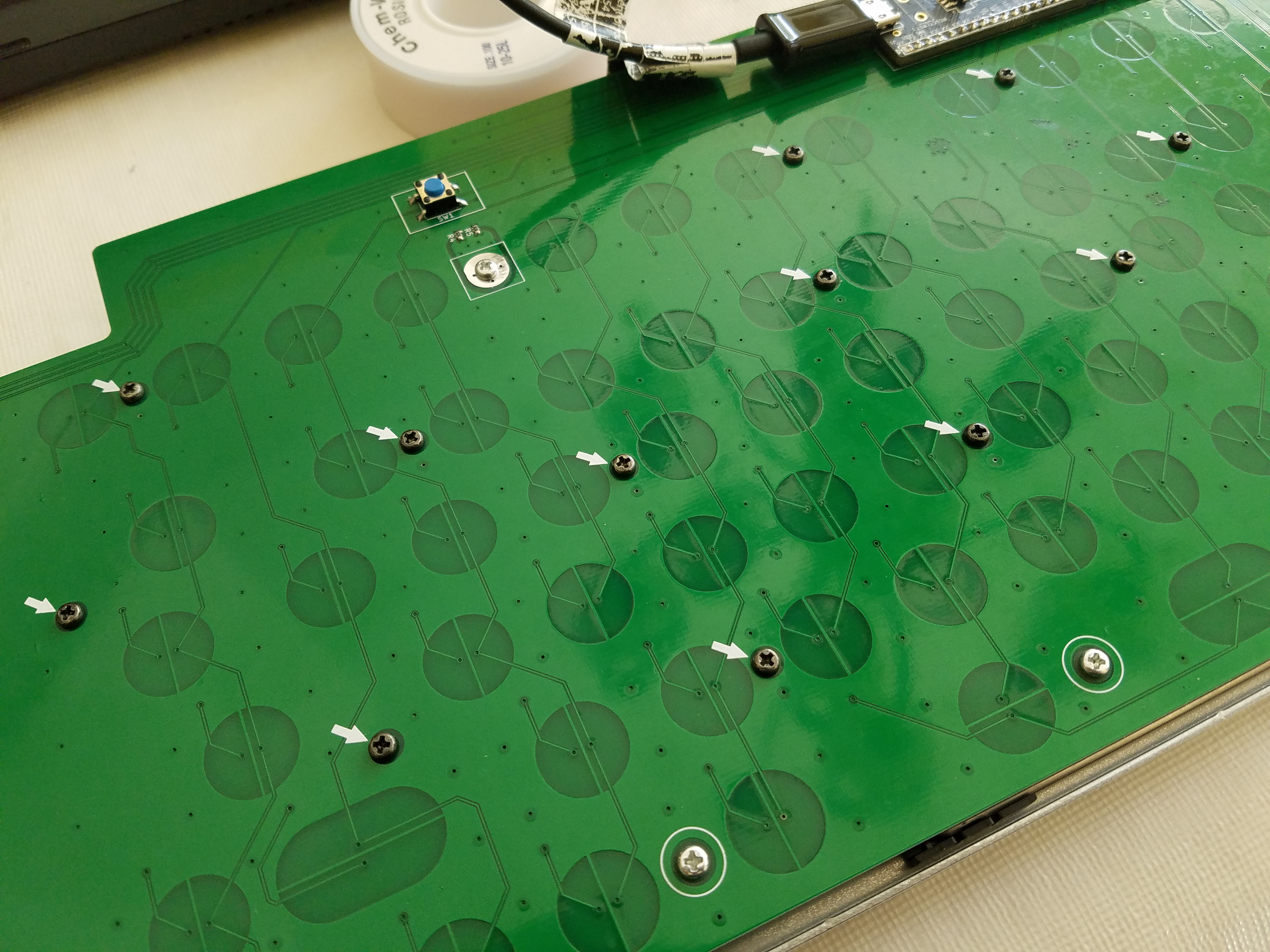

Made a RF87U PCB for CS, and it is now working perfectly (with extra help from DMA!)
I'll be redoing the board this week to put the PSoC on the PCB and maybe add a few other features.
20180826_091011 - Copy.jpg (3.02 MiB) Viewed 6695 times
20180826_091421 - Copy.jpg (4.14 MiB) Viewed 6695 times

Jampu wrote: I'll be redoing the board this week to put the PSoC on the PCB and maybe add a few other features.
Use TQFP, Luke! Those QFNs are the easier-to-solder QFNs, but still pretty damn hard to solder. I have a good stereo microscope and STTC-045 for inevitable touch-ups, but your mileage may vary considerably.

PCB is no longer a problem - if you'll look closely, Jampu's PCB is custom. Look at those long contact pads. You won't see those in topre land.
