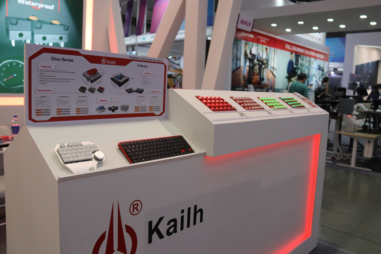

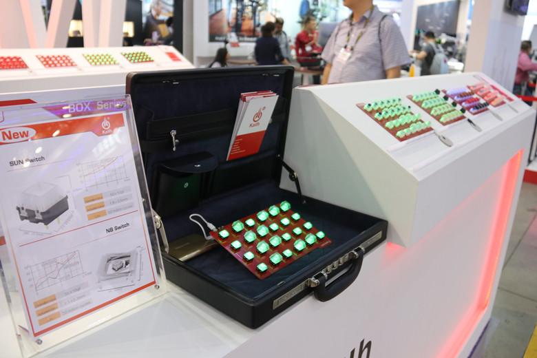

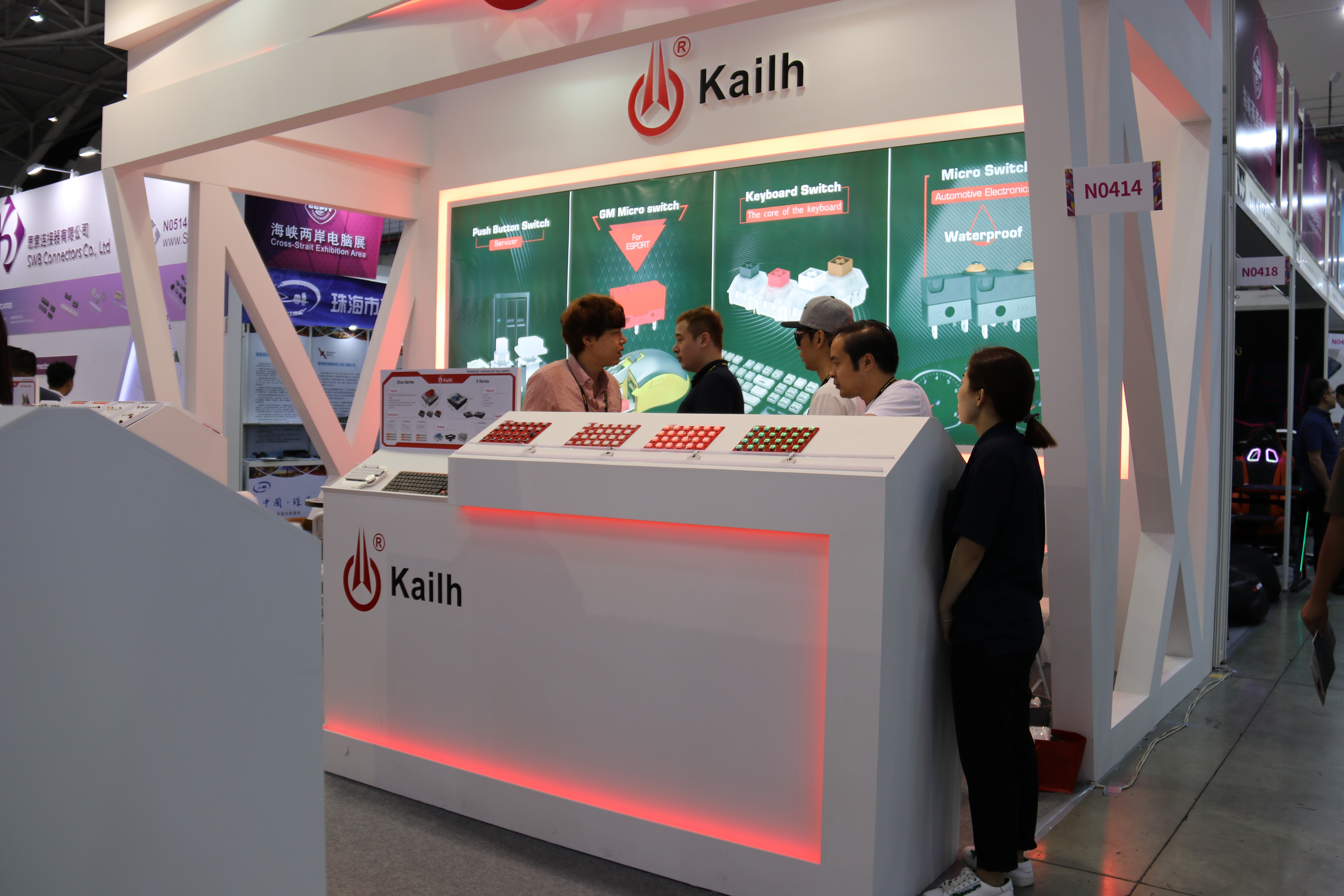

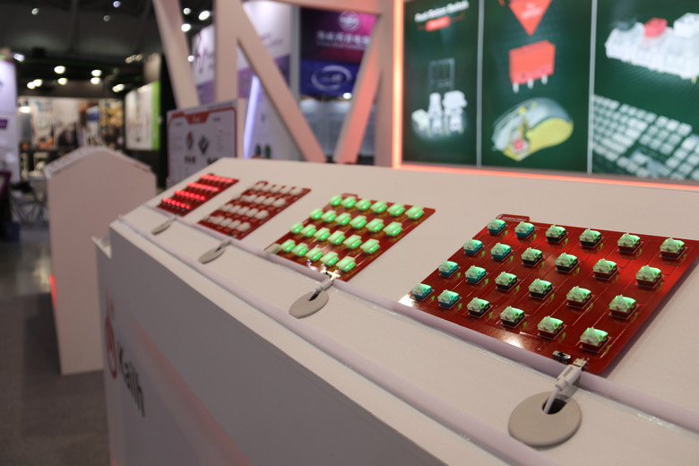

Kaihua released the new product Sun Switch PG1511B & Notebook Switch PG1316 on the Taibei Computex 2018.
Below pictures is our computex booth

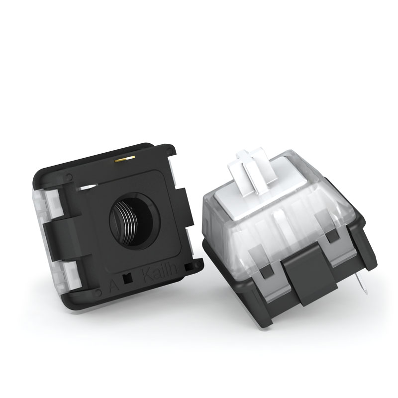

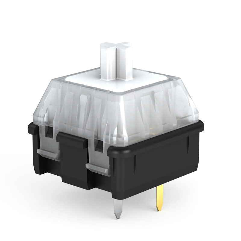

Kailh Sun Switch PG1511B -the centre lighting design, the keycap is compatible with MX switch keycap,but the pin design is different from mx switch pin direction.Now we only have clicky edition mechanical key switch.
Specification:
Operation Force:50+/-10gf
Tactile Force:55+/-10gf
Pretravel: 1.8+/-0.5mm
Total Travel:3.5+/-0.3mm
Lifespan:50 million cycles
Sun Switch CPG1511B01D03 Specification
Sun Switch CPG1511B01D03 Specification.pdf
(303.8 KiB) Downloaded 263 times

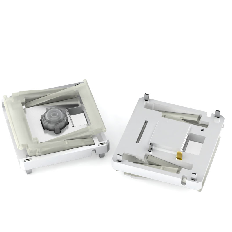

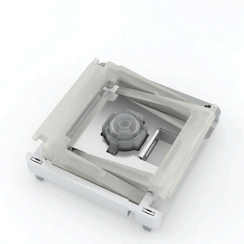

The Ultrathin Notebook Switch PG1316,the height of switch is 4.36mm,ultra-thin body and long travel feature,it also has the mechanical feeling.
Specification:
Operation Force:55+/-15gf
Pretravel: 1.1+/-0.3mm
Total Travel:1.9+/-0.3mm
Lifespan:20 million cycles
CPG131601D01-1kailh notebook switch CPG131601D01-2
CPG131601D01 Specification
CPG131601D01 Specification.pdf
(691.46 KiB) Downloaded 339 times
Many Korean Media took photos for our product,such as Quasarzone and Danawa as well as Giggle Hardware Company. We made detail teardown Box Switch and low profile switch feature.
In the exhibition,there also had many media from Asian and Europe as well as American media made interviewed for our new switch.
We also had a nice chat with Wooting and they also recorded a video for our all products

kailh wrote: ..,but the pin design is different from mx switch pin direction.
That's too bad that both pins are incompatible. Designing PCBs that support multiple switches is already a bit of work, and you would have to leave some designs out.
I think there was an DIY ergonomic design that was supposed to support both Kailh Choc and Cherry MX, but eventually it was released as two different PCBs.

16 Jul 2018, 17:33
I found that the CPG131601D01 Specification is deficient. It lacks measurements for finding the centre and for referencing the switch pins from the other features.
And... which way is up?

Has anyone found a keyboard in the wild with the new Sun switch?
Or do we need to wait a year or two before they come out?
I really like the idea of a switch with a Cherry MX stem and center lighting. This is much better than what one large manufacturer is doing to get the same effect.
Anakey
09 Sep 2018, 13:38
the biggest problem is that the pinout is different so would need to be a custom made pcb. you could use handwiree but then you would have no way to secure the LED so those two things limit the uptake of the switches outs#ide the mass produced consumer market
