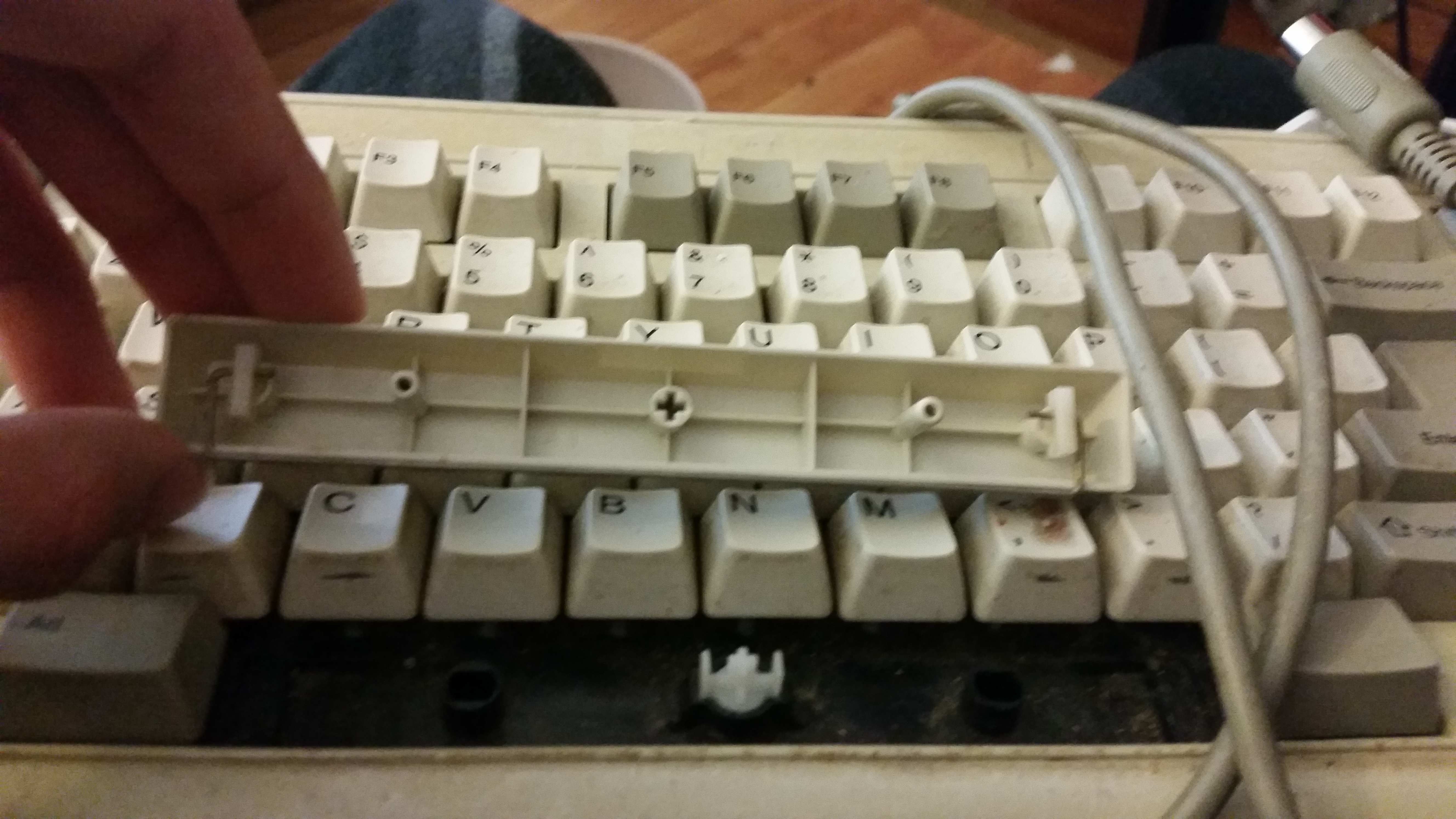

Does anyone know how to attach the space bar on this SILITEK Keyboard

Hello I took of the spacebar from my silitek sk4100r-1u keyboard And i cant seem to put The spacebar key on I have tried fiddling with the wire stabilizers but i cant get it to work
- 20180609_190506.jpg (3.87 MiB) Viewed 1418 times

Are you reaching under the key with a small flat screwdriver to set the wire in place?
Just a suggestion, I have never had that keyboard.

spongebob1981
- Location: Argentina
- Main keyboard: IBM/M
- Favorite switch: ALPS
yep. remove the alphas around it first.
After that, I'd present the space bar keycap to the switch stem but not press it down all the way.
Use a small flat screwdriver to press on the stabilizers in their slots,
finish pressing down the keycap into it's stem and done.
