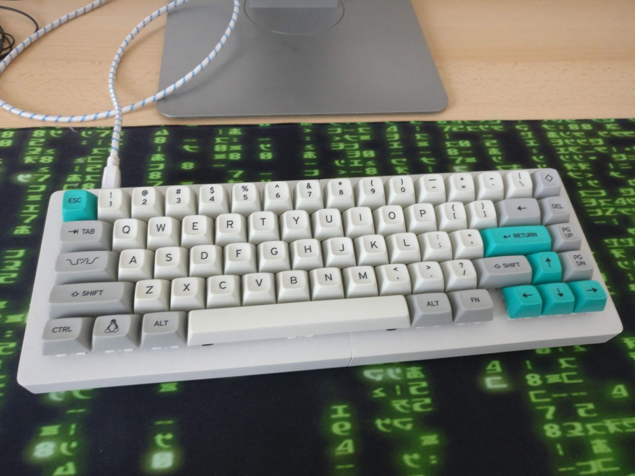

Posted: 18 Jun 2018, 18:24
by matt3o
And this is the end result! Hand wired on /dev/tty keycaps :)
Posted: 25 Jun 2018, 21:45
by green-squid
Looking good! These are the caps you designed, right?

Posted: 27 Jun 2018, 10:31
by matt3o
green-squid wrote: Looking good! These are the caps you designed, right?
they are indeed!
