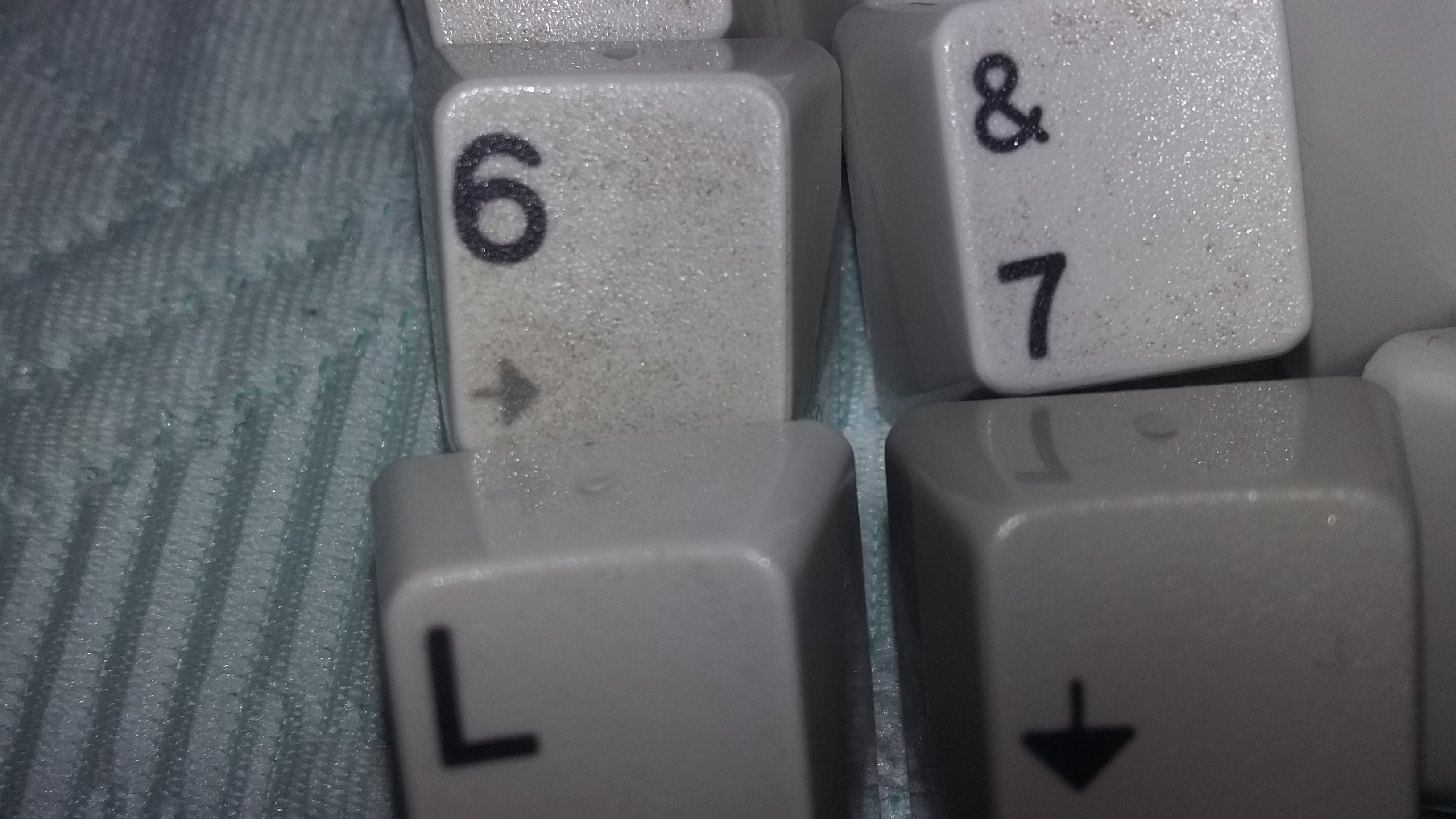

Model M keycaps have weird dirt on them that I can't get off
- Location: --
- Main keyboard: --
- Main mouse: --
- Favorite switch: --
Yesterday I washed the keycaps from the M and turns out, some of them have a weird type of dirt that I can't get off! It's forse on some than others. What should I do? Ultrasonic cleanimg is not an option. Should I use bleach?

Okay! We have that at home! Thank you!

You can also try a citrus based cleaner like Goo Gone. Works for me.

I use powdered laundry detergent and hot water. Bad specimens need maybe a bit of scrubbing with a toothbrush.

Baking soda worked great! I will post pictures once I'm done with everything. Thank you Mattr!

I'll add Oxiclean to the list.

I had this exact same problem with my Model M. Tried bleach and alcohol already and they both didn't work :/
OP said baking soda worked, is there a specific concentration or solution that I have to use? Thanks.

Powdered laundry detergent (+ Oxi-clean for more power) is the way to go. If soaking with a hot water solution isn't enough, a light scrub with a toothbrush (with or without a bit of powder on it) will almost always do the job.
Bleach and alcohol are seldom the answer, although alcohol is good for some inks.
